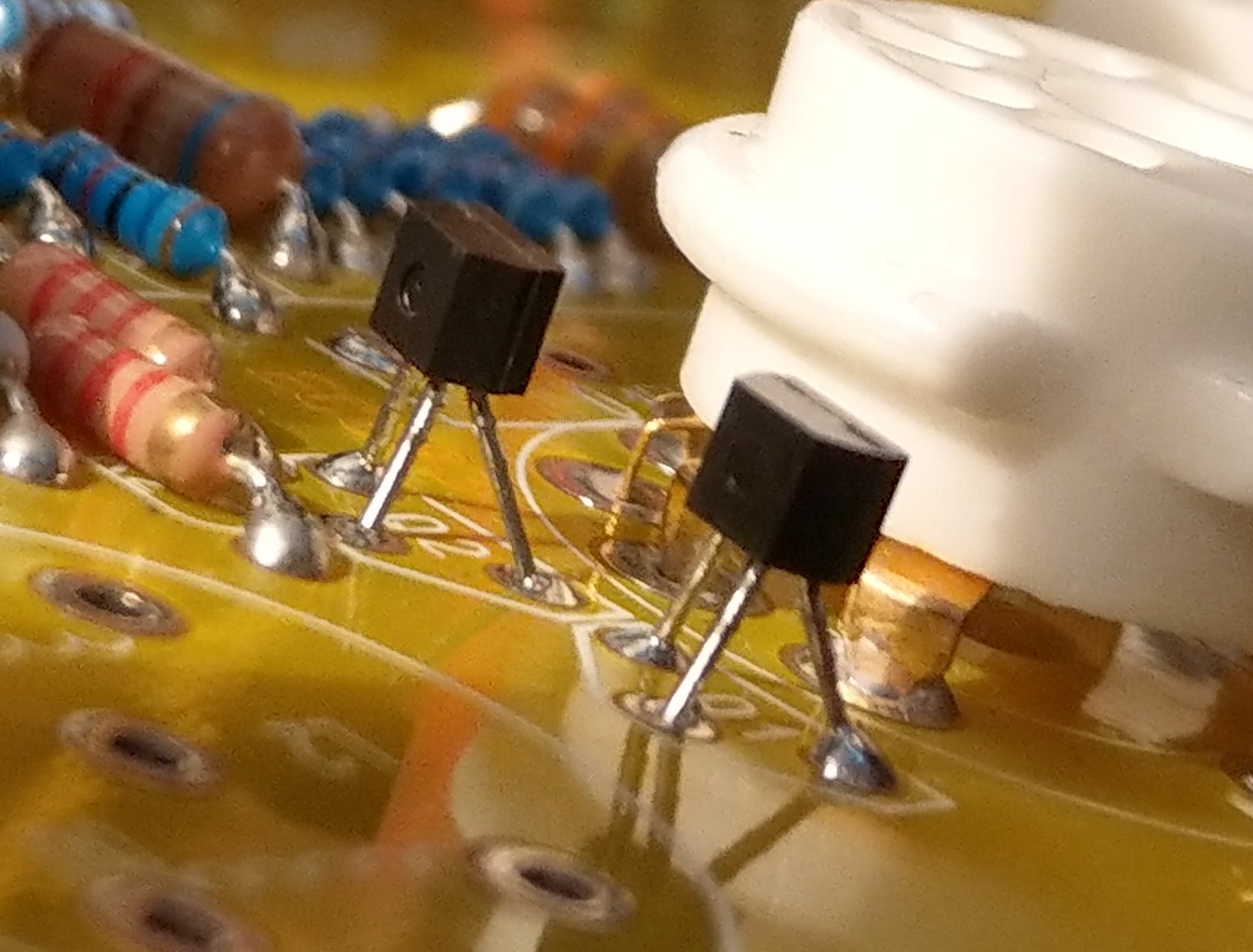

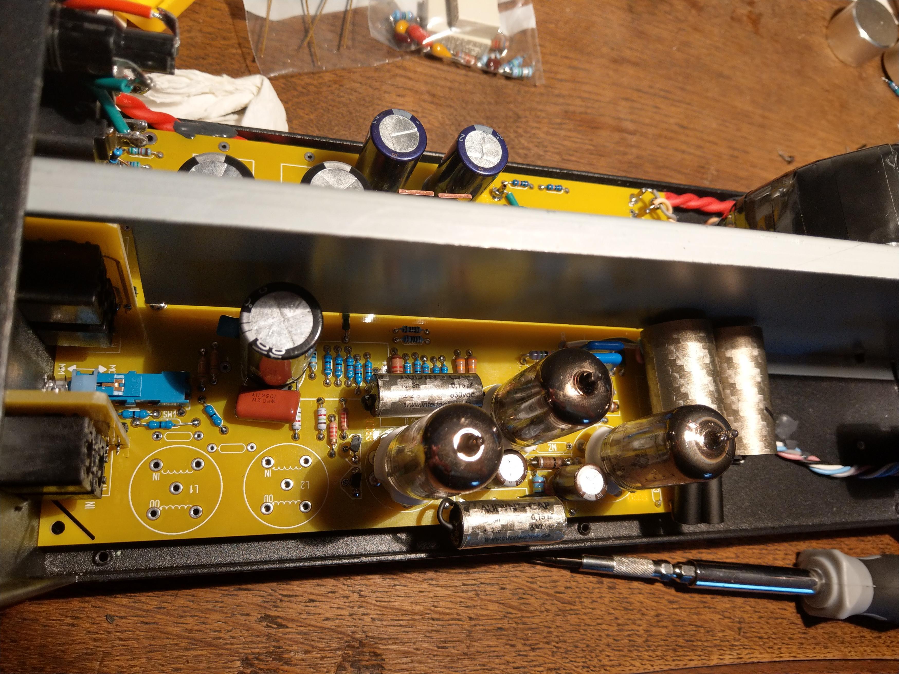

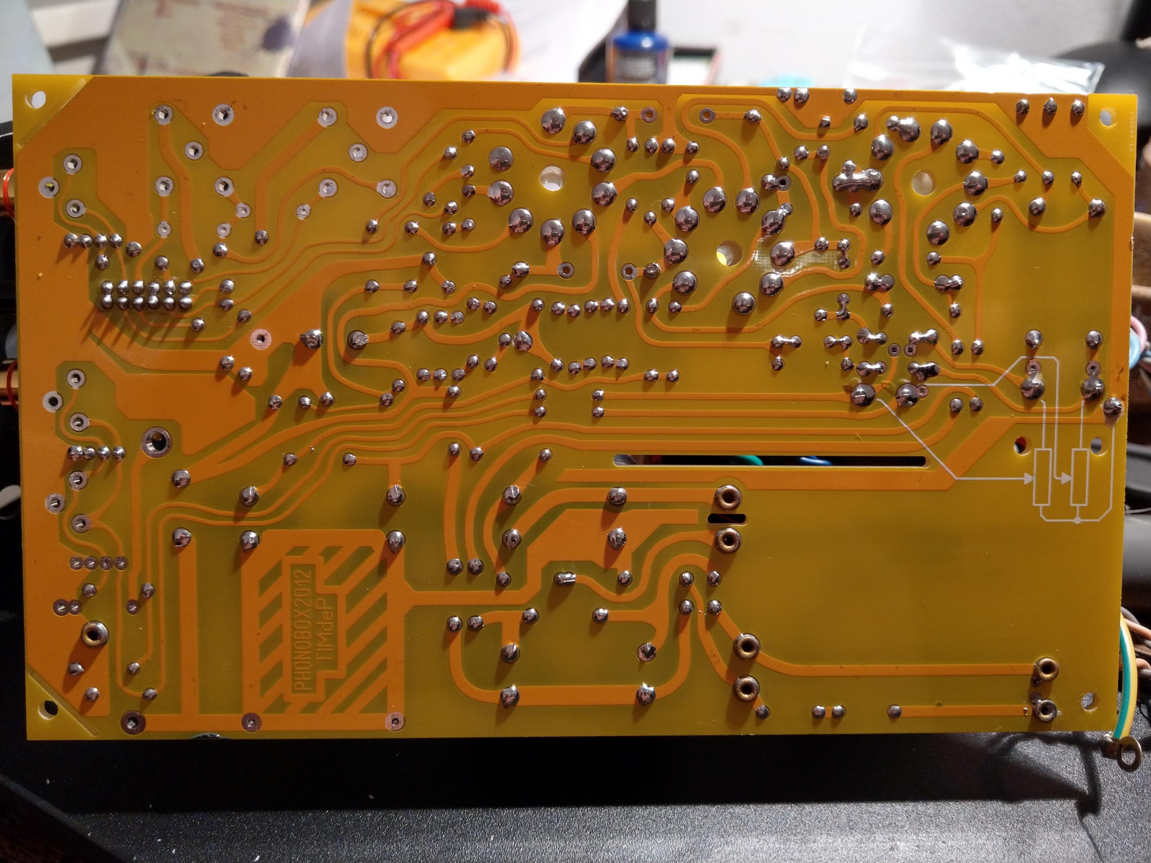

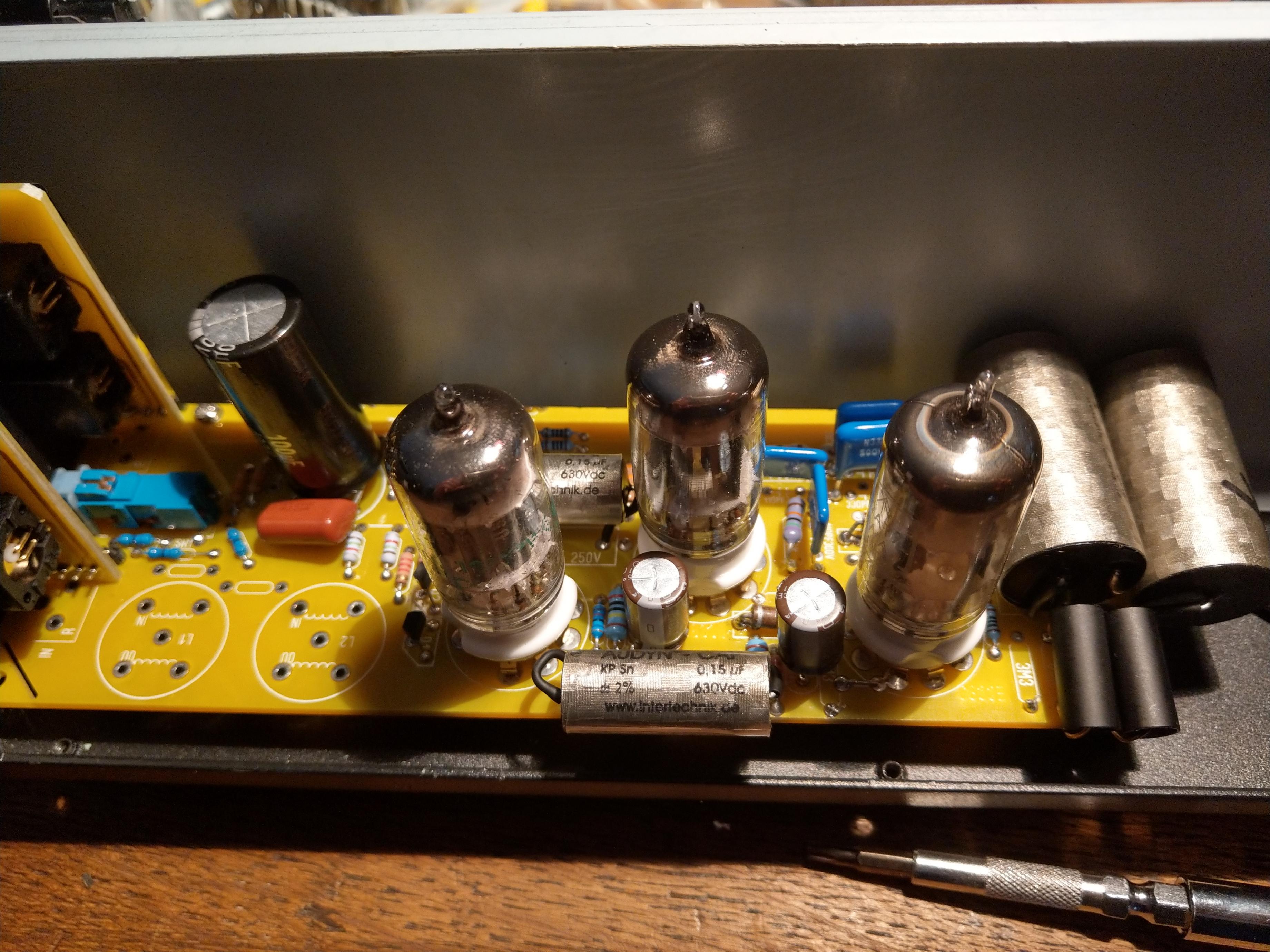

Sorry for keeping you waiting. Whenever I think that I have got a speck of time, brand new problems jump up and materialize themselves left and right. I actually got the amp done last week in about two short evenings, but I initially had the plan to only post when I had the schematic ready. I haven't completed it yet, but it's pretty far along. I will finish it one of these days, I hope.

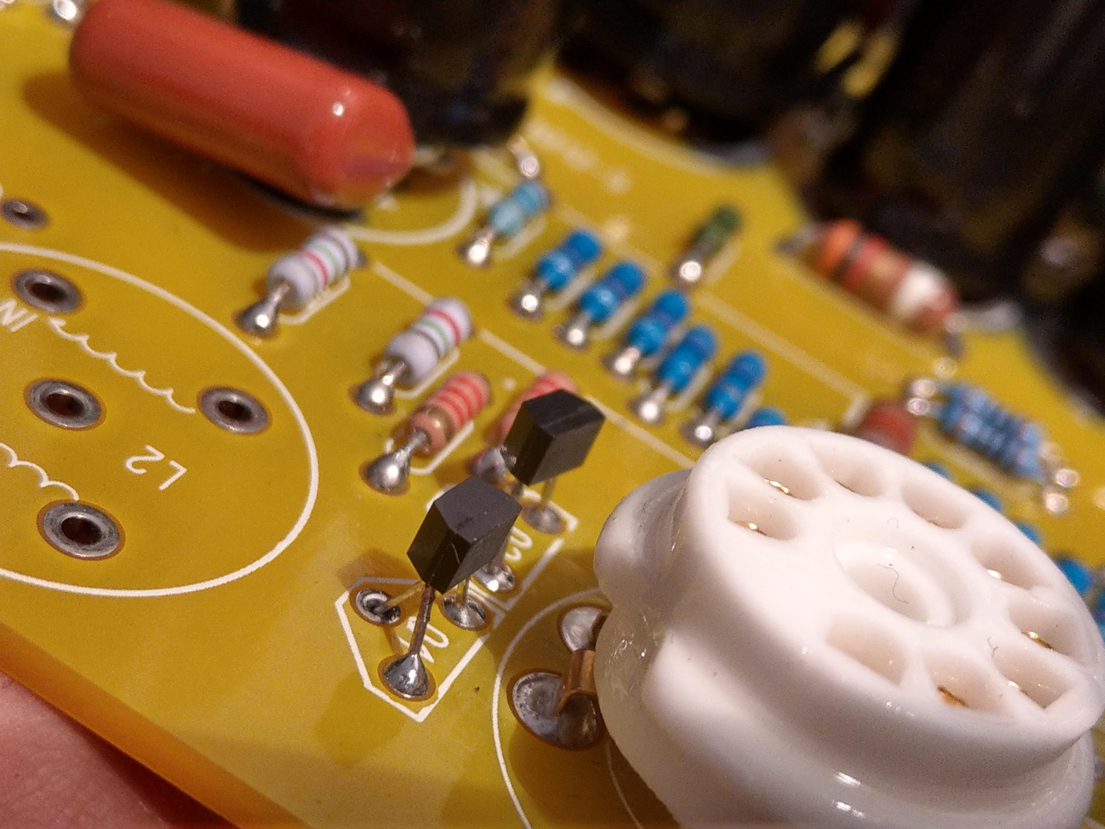

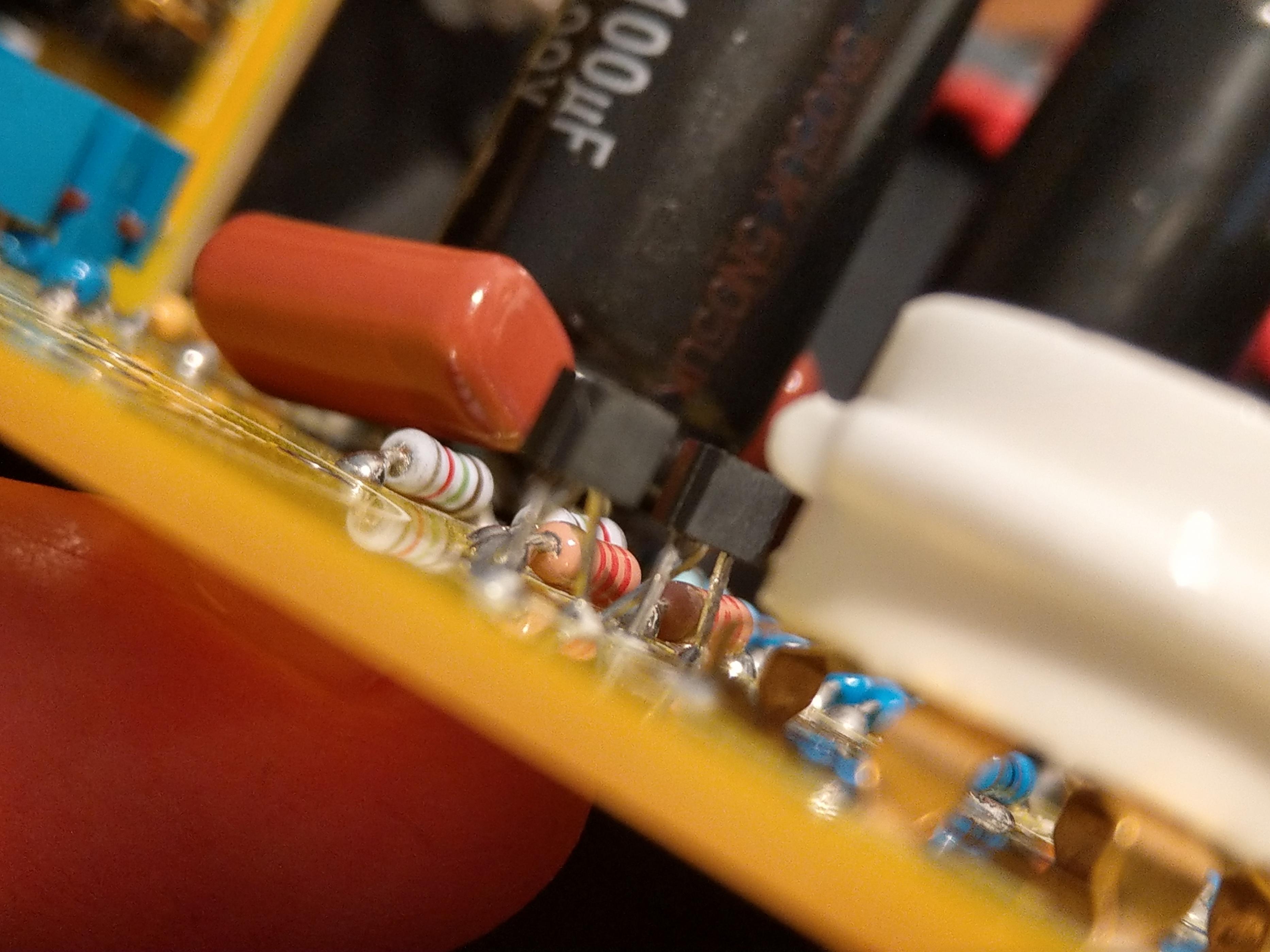

1) The FETs are indeed cascoded with V1, they are the first thing the input signal goes through. Sadly, as you can probably make out from the photos, there is no information whatsoever on them.
2) The Power Transformer does have some numbers on it, but it's jibberish. Judging by the size, it should be 50VA.
3) The many little resistors are in series and together form the load resistor of V2. It seems to be about 110k short of the 330k given in the original schematic. What a really ridiculous move to alter the board for a few cents saved...
4) I am an idiot starting work without proper desoldering equipment. Had I spend a few bucks more, I would have been finished in half the time.

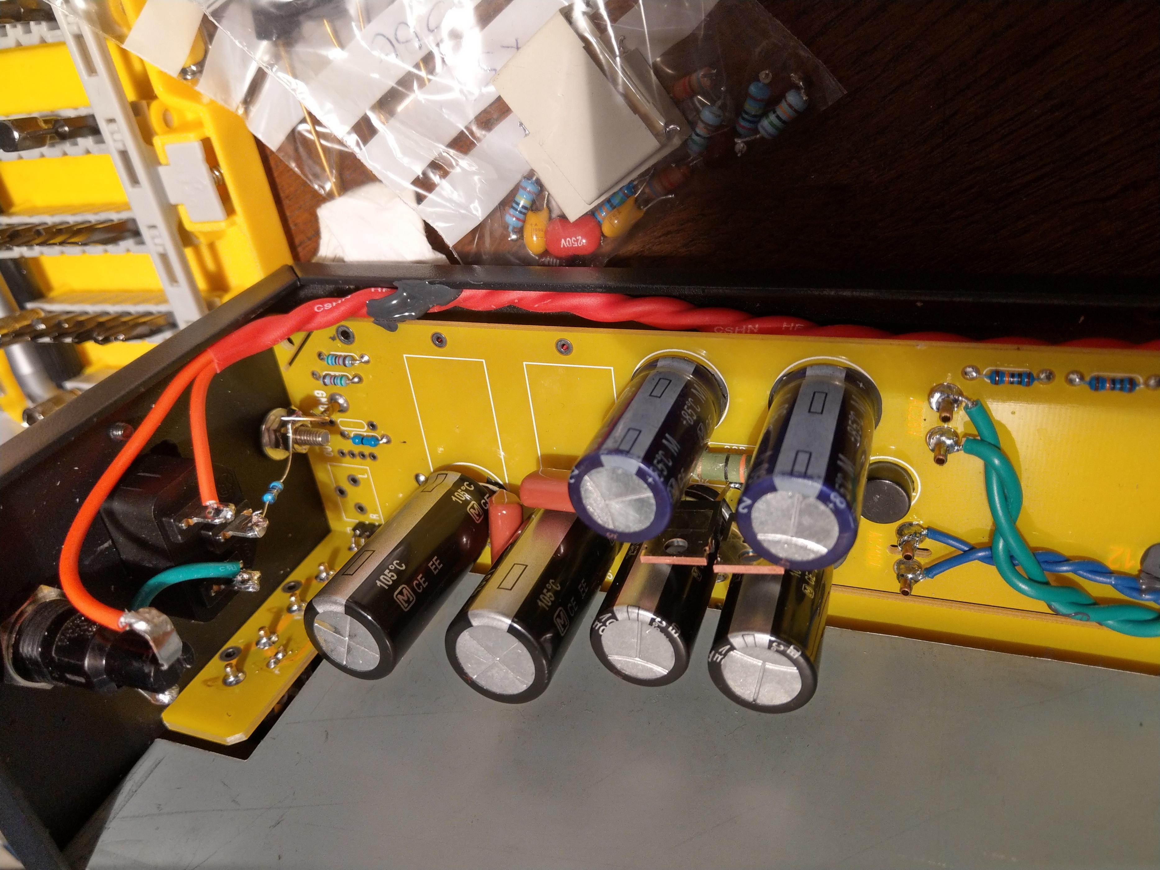

5) I changed a few cathode resistors to Amtrans and the RIAA to Shinkoh, the cathode resistor of V2 to an Elna Silmic II (ended up not bypassing that with 1uF...), all the Caps of the B+ PSU to Panasonic 100uF 400V bypassed with Panasonic 1 uF film caps, the diodes of the B+ supply to Vishay Ultra Fast Recovery Soft Switching and the coupling caps between V1 and 2 as well as V3 and output against Mundorf Zn. The RIAA caps were substituted with Charcroft Silver Mica of the same values. I removed the resistors and caps between V2 and 3 and the one from there to ground and substituted a 100R Allen & Bradley Carbon Comp. I found so many people who did this mod and nobody wrote about any problems with it.
The amp sounds noticeably different, I would say. Where it was good before albeit maybe lacking emotions a bit, it is now sparkly and alive.
I still think, this little amp is one of the best deals in hifi at the moment. A few little tweaks might make it something really sweet and worth having.

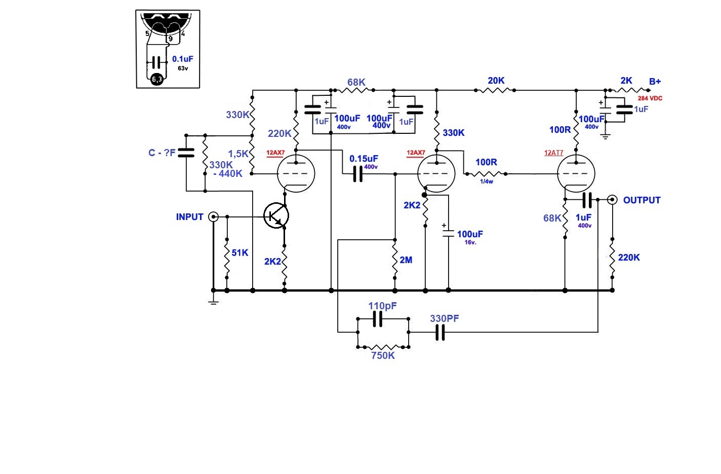

If I am looking at the values and corresponding it with the OPs trace correctly, then there 2x 2.2K and 2x 1.5K.
The 1.5K resistor is connected to the gate of the FET and the 2.2K is connected to the cathode of V1?
Edit: I located someone elses attempt at a rough schematic:
Apparently the Tant the OP removed was bypassing the 330K?
(Click image for higher res)
Although that seems pretty high for B+ from what I have seen elsewhere. I don't follow his chicken scratch well. Can anyone make sense of it?
It's an extremely strange layout, maybe for cost concerns but maybe also a plot on TDPs part to drive us all nuts ;-)
I meant V1. They make about 220k at the anode of V1....
The scratch Looks almost like what I drew up.. Except that the 1M resistor is 330k on my board. And the cathode resistor of the FET is 2,2K.
Here's what I have. The part between V2 and V3 and the RIAA are obviously already changed to the modded version, as are the PSU capacitors and their bypass. I didn't bother to change any of it back, because the board is true to the original schematic there (first page, first post). The main thing is the input stage, and this I think is halfway acurate. The one resistor I couldnt properly identify by the color codes and also readings on the meter changed towards bigger values. Maybe it's 330k, maybe it 440k, maybe its even more.

The JFET should not be critical(*). Most any JFET will give a noise-figure at 1mA lower than the 2.2K source resistor, which is not large compared to the pickup noise impedance. 2.2K will also swamp-out JFET transconductance variation. I'd just use the same type and lot for both side of a stereo.
(*) That last plan can not be right. Assuming high voltage supply (over 70V), it runs the JFET at half the supply voltage. So for 200V supply, 100V, across a device rarely rated much over 35V. A 330K:68K divider might be OK for lower B+. 330K:33K may be even safer. There's no reason for more than a few volts across the FET.

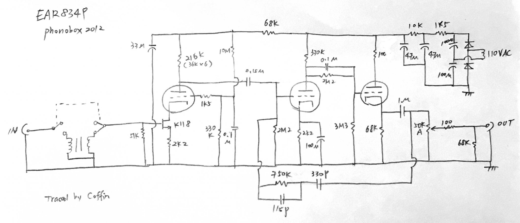

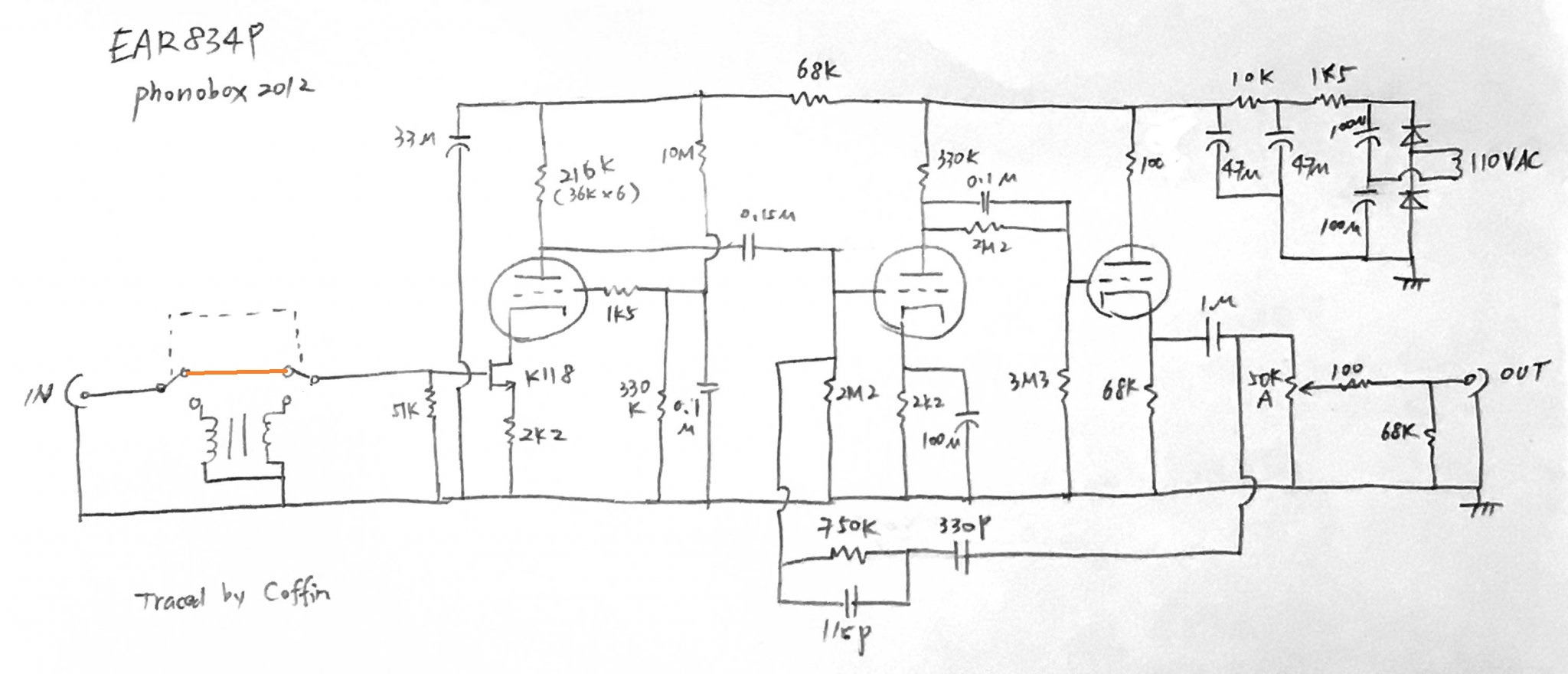

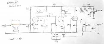

I just purchased the 834 clone kit, and I took some time to trace the PCB. According to the above thread and my portable analyzer, this is what I get.
Notice the plate resistor is 36k series to make 216k. This technic was used on the older 834P model, which the plate resistor is 56k series to make 330k.
The only issue is the MC step. I cannot find the miniature size to fit this PCB.
cheer

Have a read of these 834 mods by Thorsten Loesch. https://www.audioasylum.com/message...ch-non-definitive-ear-834p-modification-guide
I've modified an 834P and scratch-built two. One of the Thorsten mods, I didn't try this, is to delete the cap between second and third stage. This will require changing the resistor in the third stage's cathode (the cathode follower resistor) if you retain the 12AX7 or leaving it the same and using a 12AU7 or 12AT7 (AT7 would be my choice).
I also had to use ferrite beads on the input wiring as close as possible to the board to kill RF interference.
Thorsten recommends Stevens & Billington TX103 MC transformers but I bet these wouldn't be cheap.
My preference would be external MC transformers to get them away from the preamp electronics and also use ones with multiple ratios you can set e.g. 1:5 and 1:10 or 1:10 and 1:20 step-up ratios.
I've corrected your schematic, see attached,
Steve

Thanks! I forgot the trace.
Is Schematics of Thorsten's mod same as old 834p schema?
