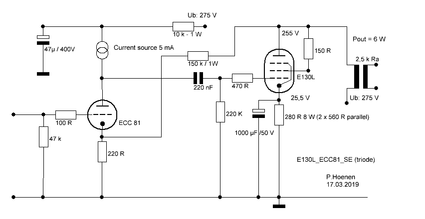

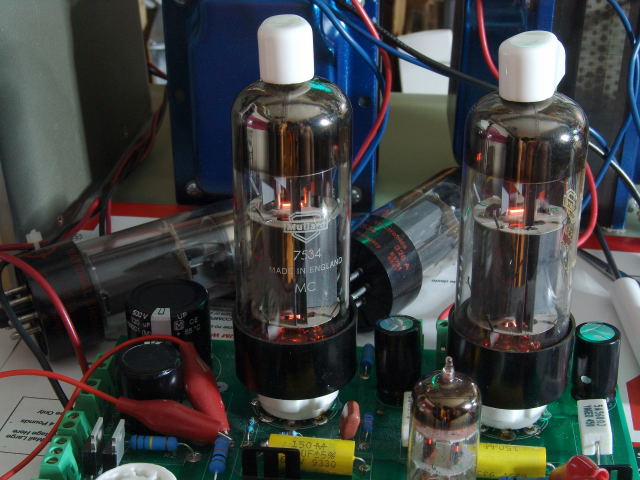

I have been digging into remote corners of my warehouse and finding some lost treasures. Last weekend's find was some WE 367A's and a box full of E130L's in several different brands. I modified a Simple SE board to test these tubes. The current setup uses 5K ohm OPT. I will try 3K transformers tomorrow. The Mullard (mand in England) tubes work the best distortion is 0.48 % at 1 watt. AT 8 watts the distortion is 2%. The Tungsram tubes have almost twice the distortion of the Mullards. The amp is wired in triode with no feedback. B+ is adjustable, but I have been using 350 volts. There have been no issues.
Hi George, don't go over 150v on screen
I have been warned! The data sheet that I have shows a maximum of 250 volts on the screen, and a maximum of 250 volts in triode mode. I dissected a broken tube and found the heaviest grid construction that I have seen, but they were closely spaced. Monster cathode too. I put these in a Simple SE in triode because that is what I have on my bench at this time. Long term plans are for a P-P amp with regulated screen voltage at a safe voltage level.
Last night I tried some National branded tubes that say "Made in Hungary", so I assume that they are Tungsram. I ran them at varying voltages up to 350 volts in triode. That puts about 325 volts across the tube. At about 350 volts the output breaks up into total distortion, but the tube current goes down. This appears to be a VHF oscillation. Both tubes exhibited this effect.
I also tried some Mullard branded tubes that say "Made in England" on them. The distortion numbers were about half of the National tubes. The breakup effect did not occur, but I did not go above 350 volts.

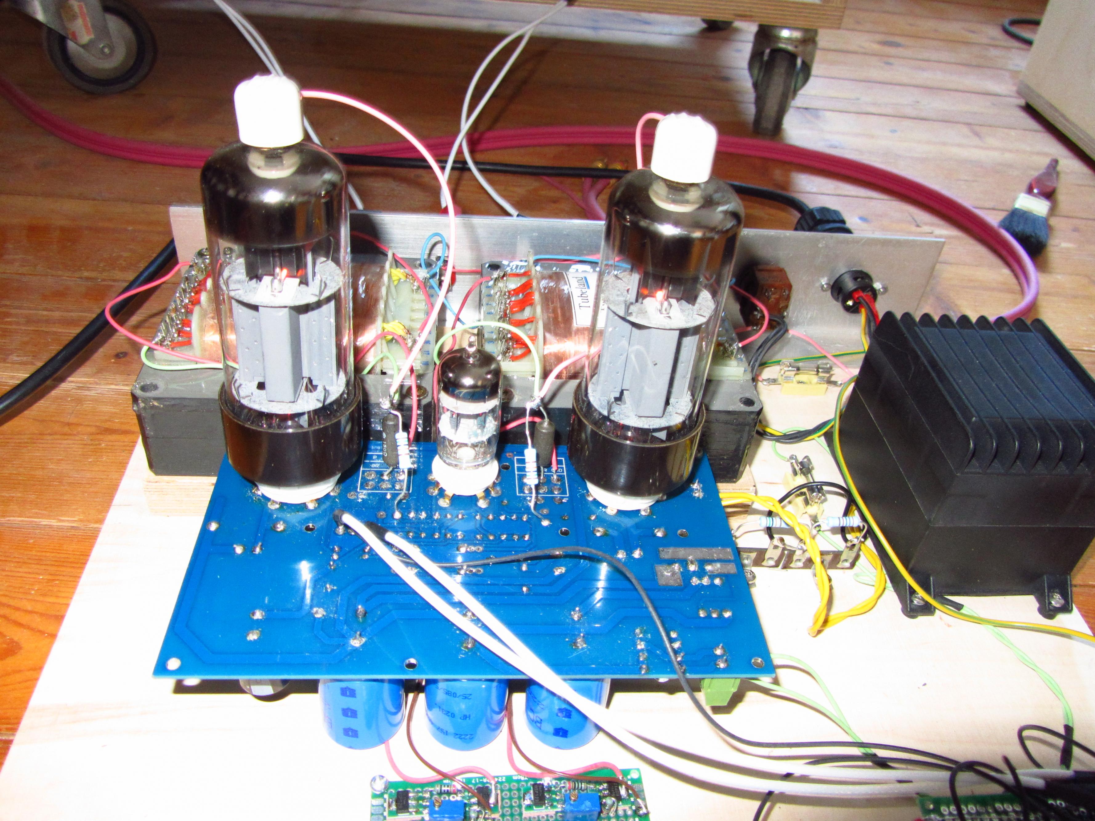

I bench tested the combination of Tubelab SE board, Hammond 272JX, and Edcor 5K OPT and found it to be excellent. I started construction on a complete amplifier several months ago using these components. I was working on it in an evening woodworking class that I was taking. The local school board abruptly cancelled the class due to "budget". No further progress has been made. I will finish it at some time, but I must do my wood working outside on weekends. This is unlikely in the Summer in south Florida. The daily temperature reaches 95F (35C) and it rains most every day.

I played music through the amp for 4 hours tonight. It does sound sweet. Tried 3K OPT at 250 volts B+ and 120 mA of current, and I tried the 5K OPT with 350 volts and 65 mA. The higher load / higher voltage sounded best to me. The numbers are hard to believe but they are correct. There is 36 volts across the 560 ohm cathode resistor, yielding about 65 mA of tube current. I loose 5 volts across the OPT so the plate voltage is 345 volts. The tube sees 309 volts and 65 mA which is a dissipation of about 20 watts. I am getting 8 watts out of this thing in triode mode at 2.5% distortion. That is 40% efficiency!
