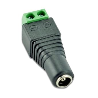

Hi Guys,
sorry to pick up again this thread for a question.
I wonder what could be a nice way to power a usb powered audio interface.
I understand that usb bus power is low and dirty.
What is your solution ?
I am trying to build a +5VDC injector with this cable here.
the idea is to cut the power wires coming from the pc and place a female socket
in order to be able inject some clean and powerful 5V.
I have already some nice 5V/3A smps to try.
So in the end i am here to get some kind advice about a nice 5VDC power supply solution.
Thanks a lot to All !
gino

This would work:
https://www.mikrotik-store.eu/en/MikroTik-5V-USB-Injector

Hi thanks a lot for the very helpful reply
I wonder if this cable isolates electrically the pc from the usb dac
Why is there always a generalisation that USB power is going to be dirty.... Is every source of USB power going to be the same... it seems to be a generalisation that is becoming a defacto audiophile myth... and if it is dirty (not often the case as gear has to pass EMC regs.) why not filter the noise with a SM choke or ferrite.....
Hi and yes this is a common opinion around
I cannot check because i do not have a scope but I understand that there is a limit of half ampere for port so only 2.5 VA available this is very little
I have 5V/3A switchers at hand maybe not very clean but very much stronger
Another solution could be a dual head usb cable?
Thanks and regards
Gino

If you mean the power, it cuts off the power from the PC, replaces it with your "clean" power, and passes the data as normal. As far as I can tell.
Yes! I meant exactly that
I will buy it then
I have an interface that works only with a dual head cable but I prefer to try an external supply
I should get a very powerful one soon
I will do some tests with different psu compared to pc power
I am very curious
Thanks for the very useful advice
Kind regards gino
