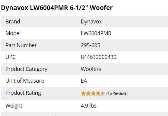

Dynavox LW6004PMR first impressions
Available at PE for About $70 odd, this is not a cheap driver.
I saw it a few times but never found any user input for the driver. Lots of people asking about it but no real feedback, so here I am with the first "subjective" impressions:
1) Build Quality: Pretty solid build. This is one heavy 6.5" driver with a realitvely small magnet (in terms of weight of magnet vs basket). The weird thing is that the fit and finish are not what you expect from a $70 driver... Paint overflow is evident in a few places. Binding posts are not very robust. It seems like a kit was bought from an OEM and put together (bolted up) in a basement somewhere... On the flip side, the materials that count, VC former/ Cone/ Spider/ Surround are all good build quality. And thats the important part.
2) Installation: Not the easiest to install, the rear can be described as 3 thick metal rings bolted to one another by hex bolts. (See the picture at PE). However due to the thickness of the rings, the rear air gap (exhaust) is constricted due to limited space. Thus when mounting on a thich baffle, you could suffocate the driver. Best mounted flush or thin baffle (use 1/8" aluminm baffle ?) If you solder the connections to the driver make sure the wire does not twist and break the posts away, they are not very robust as mentioned.
More later:
Continuing on the last post:
3) Design: Originally, this was a 2 way , with a 6.75" Swan (Stryke 071) with a Vifa dome tweeter. The sound was good but the bass drivers fail twice mechanically. (Coil rubbing plus flex wie disconnecting under the dust cap. Since I wanted a replacement to be "dropped" in, I considered several 6.5-7" drivers. Finally the Dynavox seemed to fit the bill in terms of basket size etc. I put it in my wish list for a while... finally WINisd'd it and placed the order after delibrating for a few months.
4) Crossover: The Stryke had a 2nd order 4k X-over. It was reasonably detailed but not all that smooth. After Dropping in the Dynavox... Initially, the sound was midbass heavy, ( I didnt expect it to "sing" with a non-optimized crossover but still...so I began "de-fanging" the crossover untill I removed it completely... I have to say it sounds better this way. No crossover whatsoever.
5) Subjective sound impression: It sounds pretty good... I'd say the mids sound like the Vifa P13's I have. Smooth, warm and not harsh. Did I say , not harsh? The downside is, it is not ultra detailed... so you take your pick.
6) The imaging is just awesome... My wife commented that it seems like the singer is sitting between the 2 speakers. It is very holographic (again imaging), I hear things from the side of my head and even behind my head... !!. Handles power pretty well. I have it hooked to a 200wpc Forte Power amp. Takes in a lot of power and amplifier clips before this guy distorts. Then again placed in a 0.25cuFt enclosure, I'd expect that.
Overall I am pleased with the driver. 4/5 for Sound. 3/5 for value. 5/5 for imaging. Overall I give it a 3.75/5. If it were priced at $35-40, I would have given it an easy 4.5/5.

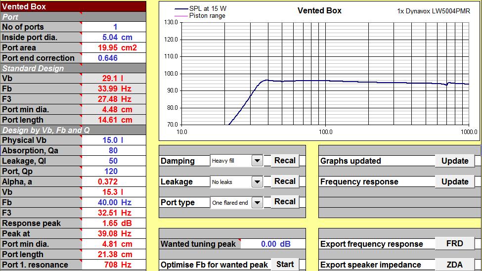

Correction- a single LW5004 in 15 ltrs vented yields an F3 of 32Hz. This is the alignment I've referred to many a time.

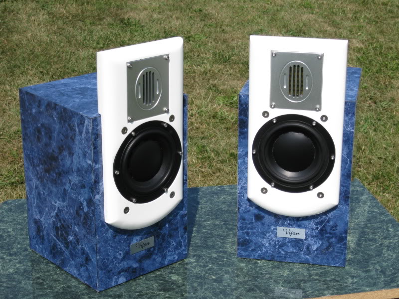

I heard this in the 'Ze Clonads' built by Shawn A over on PETT back around 2007/2008. He paired it with an Usher 9950, decked out in Madrone Burl veneer, and they sounded amazing.
For my Vijon project shown above, I went simple sealed in the end after the MAPD did not pan out well for bass extension. These are a design I hold quite dear, and have never published the schematic.

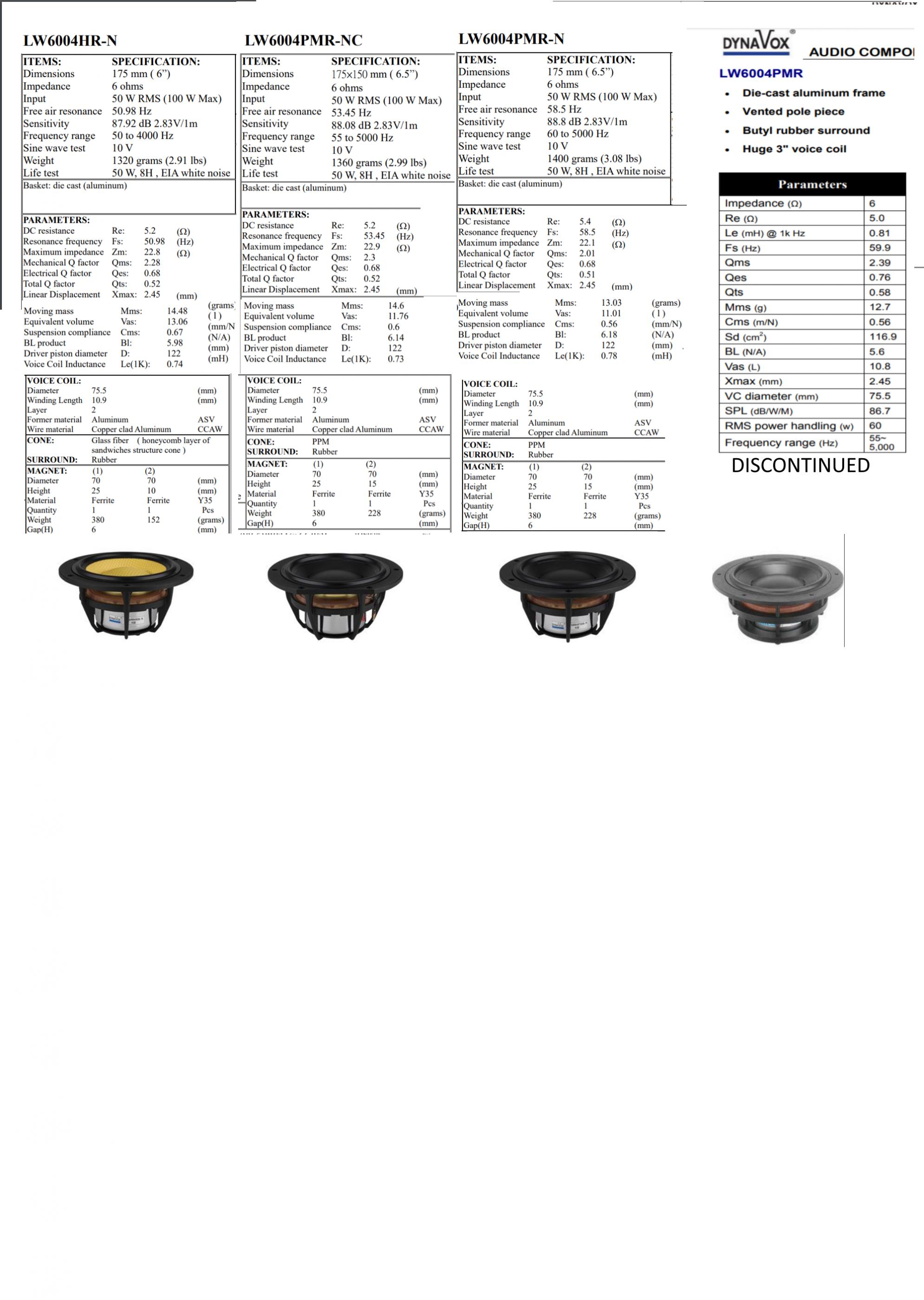

The lw6004pmr and their 8 and 5 siblings seems to be discontinued.
There are three new 6" models, all cheaper and with smaller magnets. Looking at the specs, and the ones in PE in the web site do not accurately match the manufacturer specs.
Below is a comparison of all existing 6" Dynavox

I would not think the magnets are smaller. In fact- if anything, the magnets are larger. The BL went up from the old to the newer models.
PMR-N and PMR-NC are supposed to be the same, just a frame difference. If you had a square tweeter and wanted to butt the edges together, I'd choose the NC. Since you don't, that leaves the N and HR-N.
Modelling with the 5" (already loaded in Unibox), for those reading...
The PMR-N tuned to 42 Hz in the same 15 ltrs yields an F3 of 36Hz, but it's about -1dB from 200Hz to the knee before rolloff whereas the former model 5" had an inherent rise to the knee. This will change the tonality, and likely is similar to the old vs new 6".
My guess is that half a cube might be a bit small for the driver. You might want to look up 'Simplicity' by Eric Levenchuck (brkitup) over on PE too. He built with the 6HR-N in a sealed box.
The driver FR is likely to be of more concern for your build, as the honeycomb-kevlar does have a different FR curve to the poly-mica.

I have no solid data regarding the size of the magnets other than the overall weight increase of the older unit, LW6004PMR, about 2 lb heavier than the new ones (5 lb vs 3 lb). My assumption was that some of the difference might be due to a different magnet as it does not seem that the older basket design can have two extra pounds of material. Also, the older unit has 20% more power rating than the newer one. That said, I might be completely wrong as my understanding of the speaker parameters is limited.
But it is really cool to know that the old and new, LW6004PMR and the LW6004PMR-N, are equivalent.
