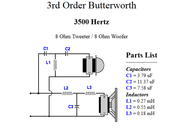

Just calculate for BW3 and 10R bass and 6R tweeter and 3500Hz, and the values drop out: 2-Way Crossover Calculator / Designer

The reason that a highish 3.5 kHz crossover works in two-ways with big, badly time-aligned woofers is something the BBC discovered 50 years ago.
Rogers Loudspeakers › LS5/9
See with a big woofer, your time-alignment problems to the tweeter come down to about 5cms.
Well, at about 3.5kHz, it happens that the speed of sound, being about 340m/s, to be about 5cms as a half-wavelength.
Hence these negative polarity classic BBC designs: Rogers Loudspeakers › LS5/9.

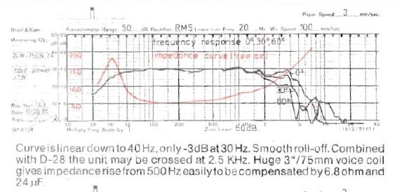

The crossover frequency with such an unusual 2 way set ought to be on the lower side. Tweeter is capable of performing nicely at 2 kHz, so in that region it would be wiser to high pass it. A good compromise between tweeter power handling and off-axis response of the woofer. If you ask me.

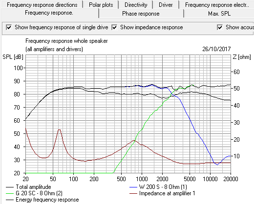

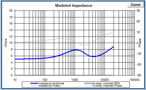

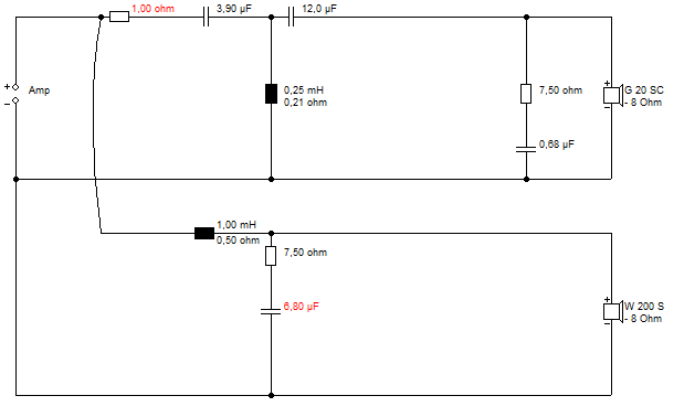

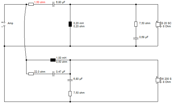

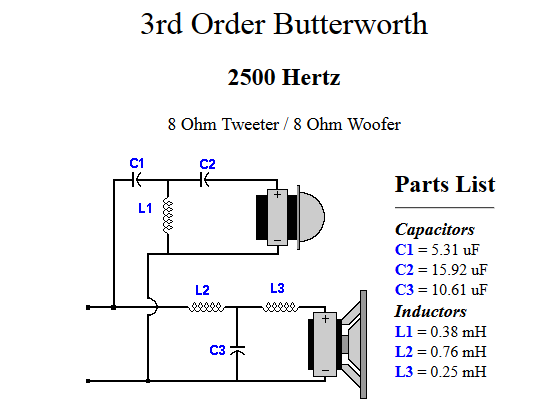

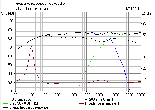

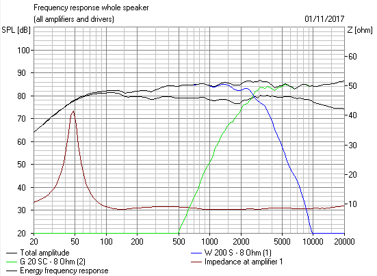

I did a bit of work on this today. My great inspiration on 8" plus 1" is Troels Gravesen: DTQWT TWEAKS
Now, TBH, I figured out most of this approach on my own... because I build speakers like this. o

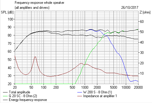

I simmed it time-aligned on a typical 1" 88dB tweeter. And any old 8" bass. I set the tweeter back 5cms. Which flipped the polarity to all positive.
I think these sort of circuits are worth a go. The ca. 6kHz tank notch ( I'd try 0.47uF or 0.68uF with 22R) is interesting. It certainly does something to take down the cone breakup from the bass and clean up the sound. Tweeter level, as always, is adjustable to taste.

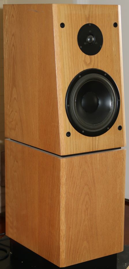

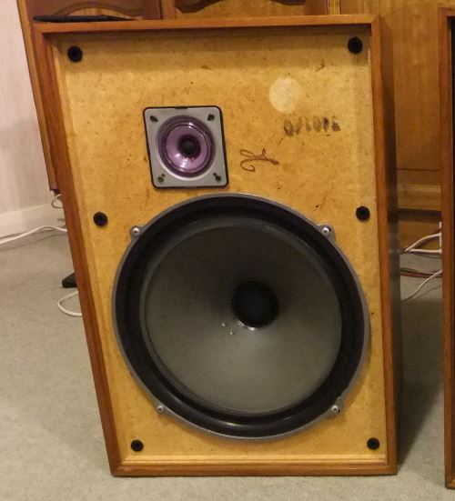

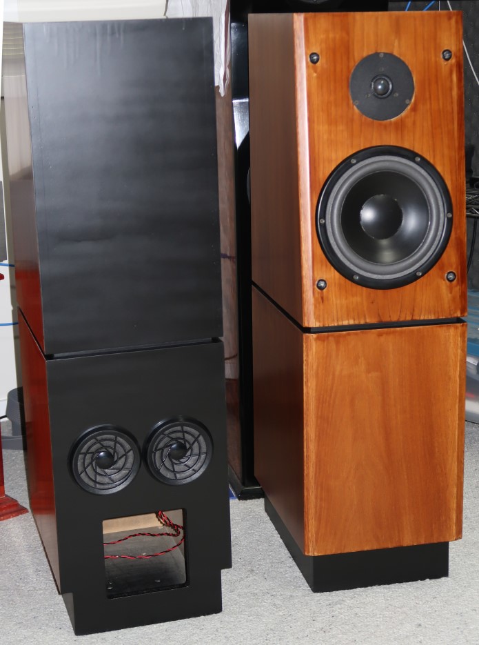

Finally got the drivers in late last night.
So here's some fresh pics, info, and sweeps...
The owner wanted the cabinets darker to try and help with WAF.
So I've sanded them back and used a tinted oil based varnish (one coat) then three coats of clear.
I filled a few holes on the back panel before respraying those in the original satin black.
Cabinet info; All 16mm chipboard.
Upper two sections have 'egg crate' foam on most surfaces.
Top section 44.5 litres - Internal, 260mm wide, 308mm deep at top, 365mm deep at bottom, 510mm high.
Three Variovents feed into bottom section.
Bottom section 23.2 litres - Internal, 260mm wide, 365mm deep, 245mm high.
This has two Variovents on the back panel.
Foot section 18 litres - Internal, 260mm wide, 365mm deep, 190mm high.
This is sealed of from the upper two chambers and was used to house the original power supply and amplifiers.
As the amps are beyond repair it will now hold the passive crossover.

D28/2 Tweeter - I've put new diaphrams in both.
24w75 Bass - I've refoamed both.
On to the pics
Yes the cabinets aren't perfect, but I've done what I can.
Re-veneering would be nice, but it's out of the budget.

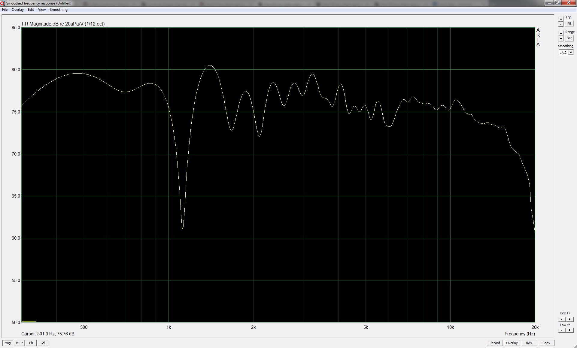

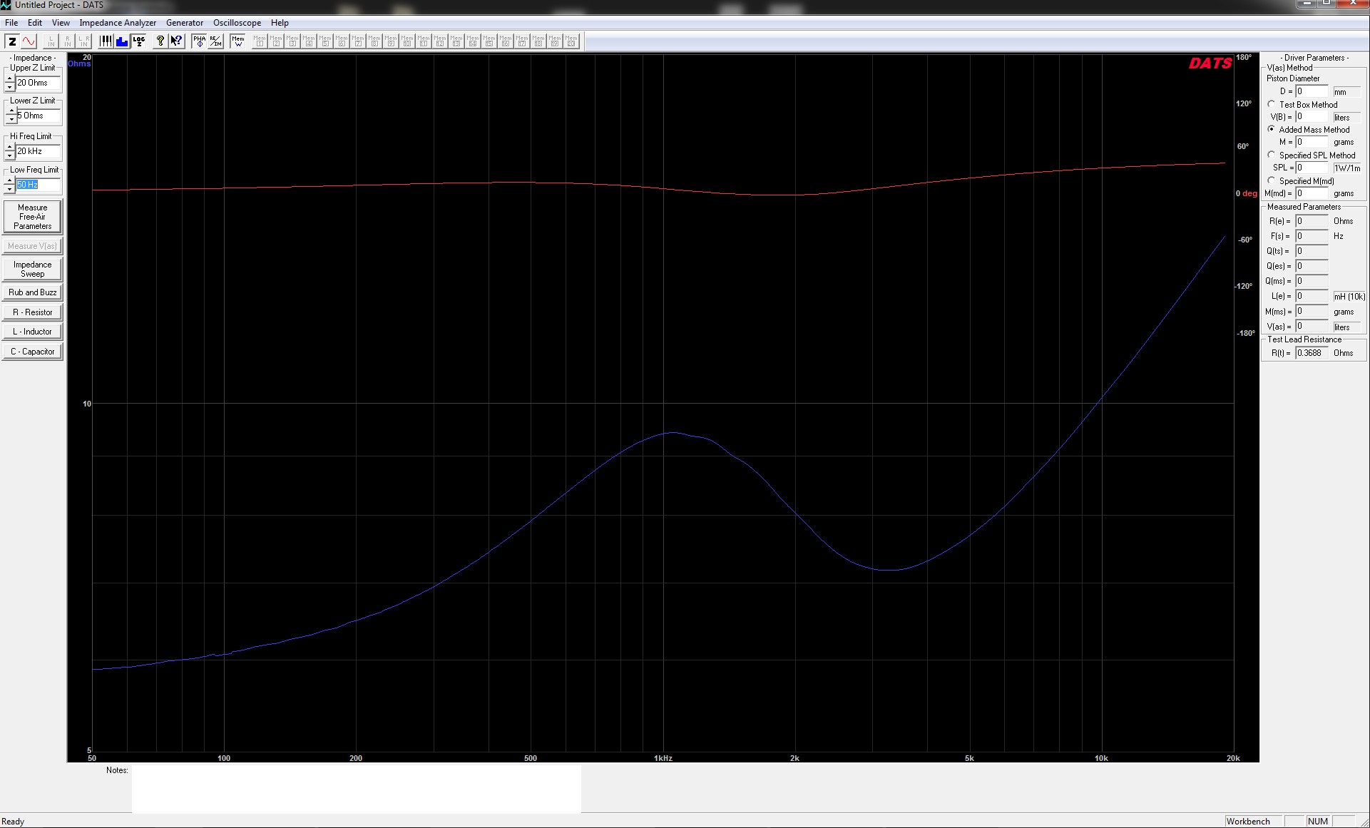

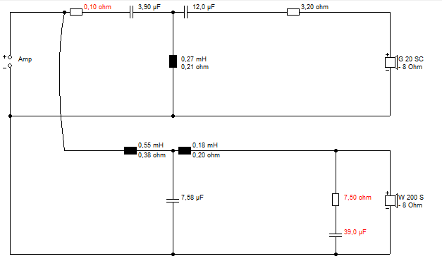

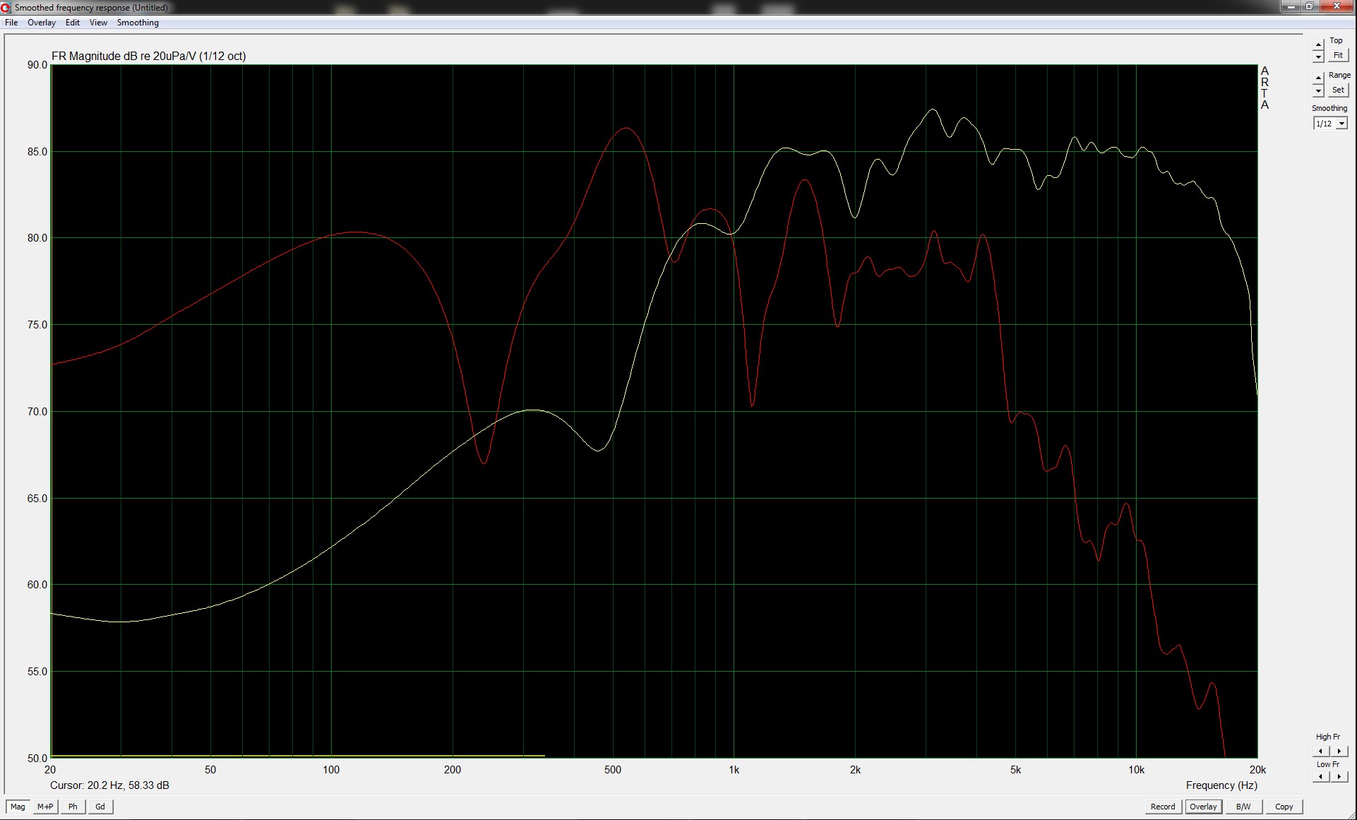

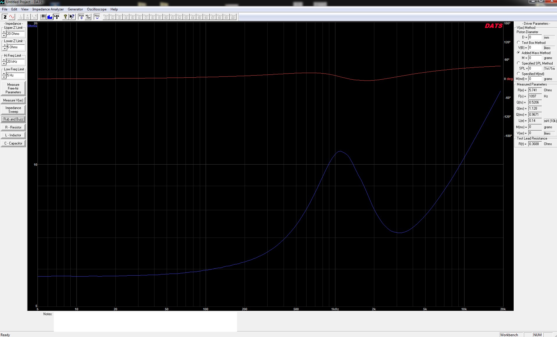

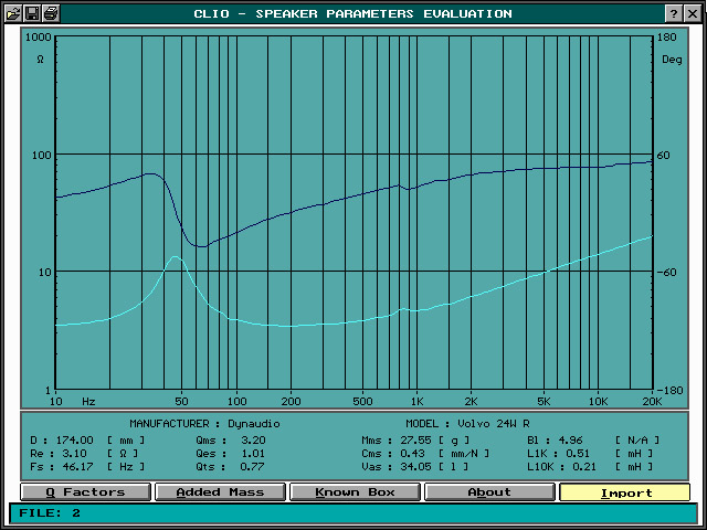

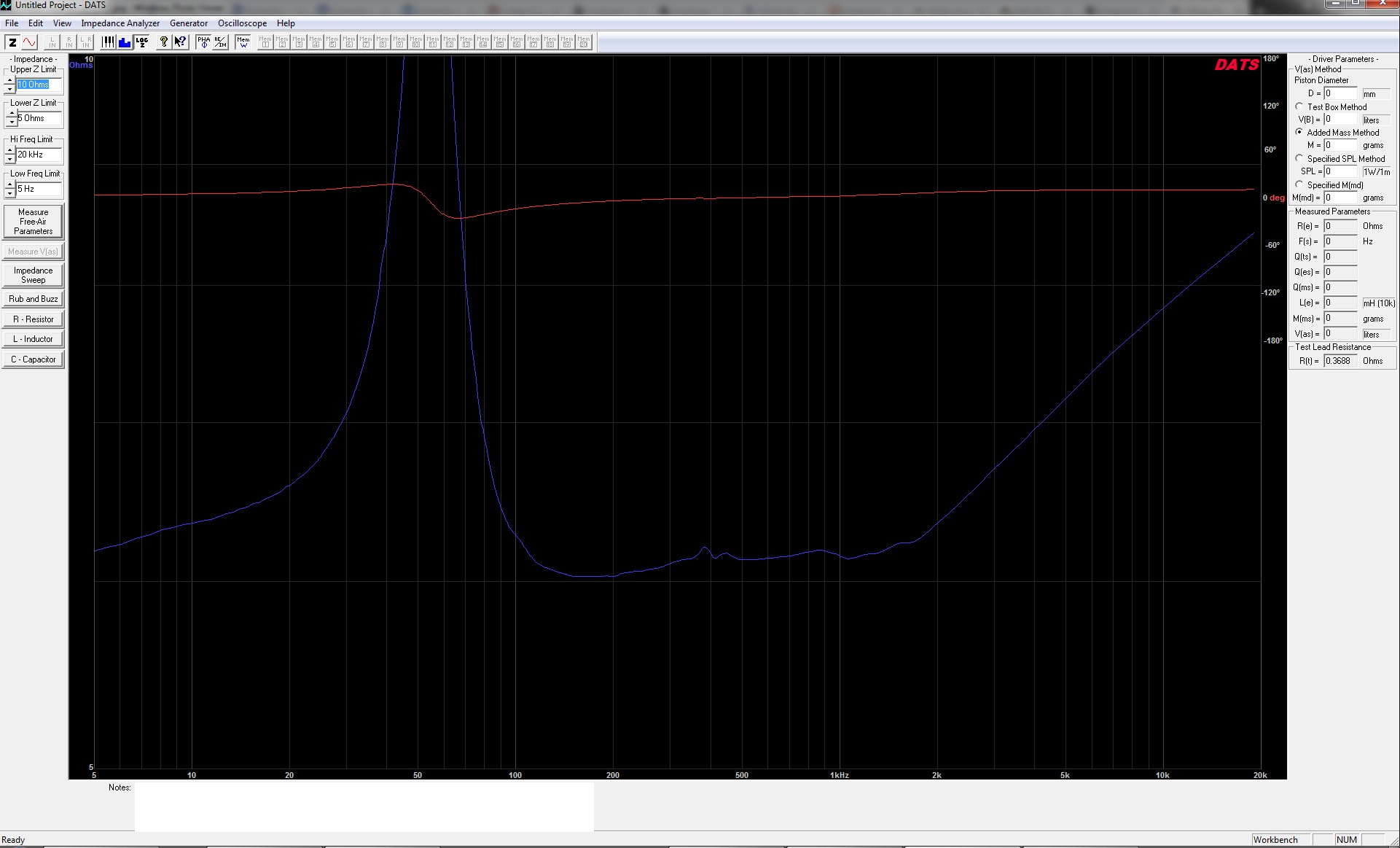

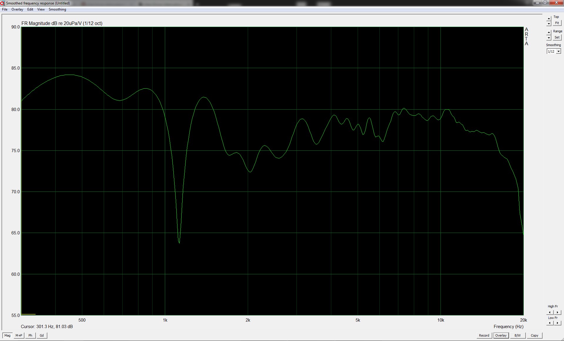

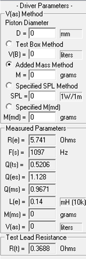

Arta sweeps are of the bass and tweeter at 1 meter on axis. same volume. straight from the amp.

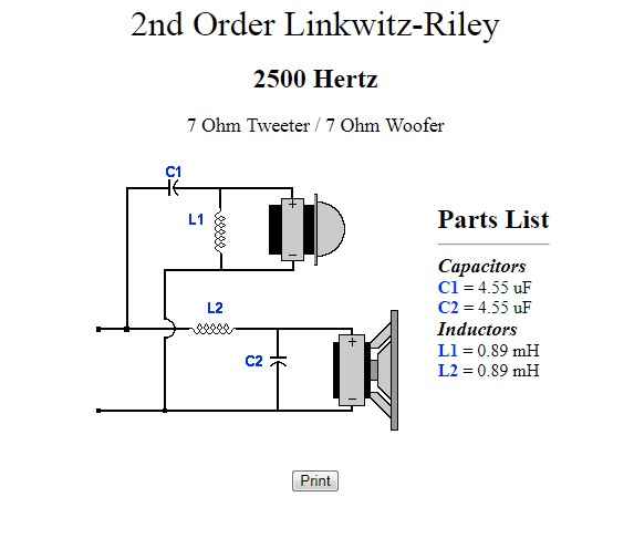

Looks like maybe I'll go ~2.5k xover, tweeter padding, and of course a zobel for the bass.
Been an awesome day.
Managed to do so much despite the !@#$%^& usb microphone dropping out constantly.
A zobel of 18uf and 10ohm seems to give the smoothest impedance for the bass driver.
I threw together a 2nd order LR at 2.5khz, with a tweeter l-pad of 3.6ohm series and 7.5ohm parallel.
But this gave a big dip at the crossover area.
It was clearly audible too.
Then I decided to try Steve's suggestion of a 3rd order Butterworth.
This should boost the crossover area by about 3db.
Just what it needs to get a 'flat' response compared to the LR.
Again needed to put an l-pad on the tweeter. Currently using 2.7ohm series and 12ohm parallel.
But presto, with the same 2.5khz crossover point, the dip is gone and even with bottom end parts it sounds a heck of a lot better.
Later when I can be bothered ill reverse the tweeter and see what sort of 'suck out' it does.
Oh, and I'm basing my crossovers on 7ohm bass and 7ohm tweeter.
If anyone thinks I've done wrong or can do better, feel free to say so.

Could you be more specific as to what values that LR filter was? Have you thought of simulating in the usual way, taking measurement of both of the units, frd's and zma's, assessing Z offset, noting baffle driver coordinates...etc as it had been discussed over here many times? I am attaching my measurement of Dynaudio D28/2 that I exported into Response Modeler. It appears that your version has suspiciously high voice coil inductance, assuming you took raw driver IMP measurement. I am using Clio measurement suite.
Sure thing.
I used 4.7uf and 1mh.
Not exactly what the internet calculator suggested, but I thought it would be close enough to get it going.
Ive used dayton dats for impedance sweeps.
Dont forget I also replaced the tweeter diaphrams using aftermarket ones.
They are stated as being 'suitable for the d28/2'.
But we all know that might not be 100% true
Ive just done a new dats sweep of the other tweeter, with a close up of the measured parameters.
Hopefully that helps you

I've had a look through arta, as far as I can see I can only export files as ascii or csv.
The att bass driver sweeps are measured at 1 meter, mid point between bass and tweeter centres.
And right now, thats all I can do.

I'm not actually having a good time with this one. AFAIK, because it is time-aligned, which I simmed with 5cm recess on the tweeter, all our butterworths are becoming phase aligned, and creating a +3dB peak at crossover. And the linkwitz-rileys are showing a hole in the midrange.
I'm not too sure at all what I am getting here. I've got enough for a couple of bass light builds with nice impedance. You can ignore the bass adjustments which I did for an 8 ohm woofer and just insert your own impedance correction. Which must be around 9R and 22uF.
I found with the 2500Hz circuit, it looks better with 1mH and 10uF second order, but that mucks up the impedance. A peak at crossover isn't the end of the world. It sounds OK off-axis. So don't toe them in.
