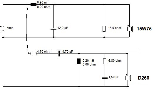

I think we can divide this question into two parts.
Firstly, enclosure. 15W75 6" driver is Qts 0.4 and Vas 7.5L and Fs 55Hz. Allegedly suitable for 5-10L closed or reflex box. The Impresion is 11L reflex, and I leave it to m'learned friend sreten to say what is best, since I believe he is good at reflex. Closed box is a bit awkward with this driver Qts, IMO, but hey, you could always stuff a sock in the port to try it. :)
I'll have a go at the second part. BOTH the suggested crossovers are a bit naff, IMO. 2nd order bass and first order tweeter is about as awkward as it gets on phase and overlap, and is not my cup of tea at all. I'd suggest this spiffing system7 conversion of the Dynaudio Sirius crossover to pure second order and the 15W75-04's properties will work nicely and the two resistors give you a bit of adjustment. The 4.7 ohm damps down the treble energy, and the (optional) 16 ohm damps down the midrange from 1-3kHz by 2dB which is female vocal range. It's an unfussy circuit which is rather good for your purposes IMO. I just amaze myself sometimes. :D

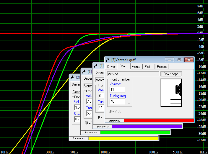

The solen x/o is first order electrical on both the bass and treble.
They are similar to the Dynaudio x/o's, but without added impedance
compensation, or the added LC delay ladder for tweeter matching.
Consequently an inverted arrangement might sound better, as
S7 said, phase matching can be a headache for low order slopes.
I really can't comment on a x/o presented simply as the values.
I'd have to fully model it, including BSC etc, and it would still be
only approximate due fine voiciing issues, e.g. distortion etc.
rgds, sreten.

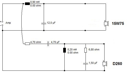

Aha, you are good, sreten! 7.5L reflex optimal, eh? Very nice diagrams. :)
I've had second thoughts about that 16 ohm damping resistor, since we are getting very low on impedance here. I think this is more amp friendly around 5 ohms minimum, but I still like it over anything I saw with first order here.

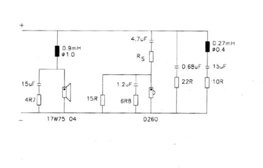

I'll explain what I found with the 17W75 which is Le 0.17mH and 3 ohms Re. It's an extraordinary driver that is flat to 3kHz, then rolls off the cliff beyond that to next to nothing. The 15W75W (Le 0.15mH, Re 3 ohms) is much more gradual rolloff to 8 kHz, and seems to need more treatment from the crossover and more careful matching to the tweeter.
The lower inductance leads to a Zobel nearer 12uF and 4.7 ohms. You could use the Sirius crossover with just the smaller capacitor on the bass Zobel, but I still think it stinks on phase matching and overlap.

At the turn of the century, I tried a number of crossovers with a D260 and a 17W75 XL. The Foccus crossover (which is designed for the D28/2) sounded fine. In fact, it sounded better than the Sirius which was designed for the D260. I attribute this primarily to the ladder delay (a.k.a. allpass) network on the tweeter. (Likely due to System7's concerns about phase matching).

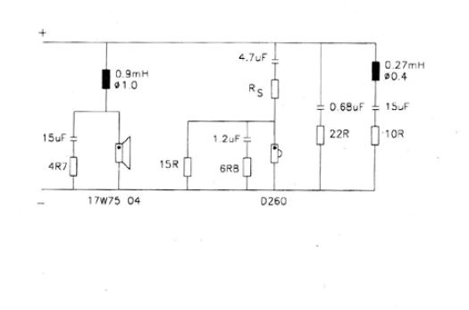

I've had a good look at that Sirius circuit, trunkline. By all means try it, but everything I do with the first order tweeter gives a horrible phasey suckout between 1 and 5kHz.
This is where I'd go if you abandon the Sirius design and go second order filter. The 1 ohm resistor and 12uF capacitor doesn't look like much of a change, but it shapes the phase and Q on the mid/bass to match well and not shout too much. I went for a 0.22 mH coil on the tweeter because it's a preferred value, but 0.2mH is OK too. The 3.3 ohm attenuator is really select on test, because we don't know how efficient the tweeter is really, but I'd start there. :)
Oh, whoops. I didn't update the Zobel to 1.2uF! You'll have to ignore that 0.68uF value. It should be 1.2 uF.

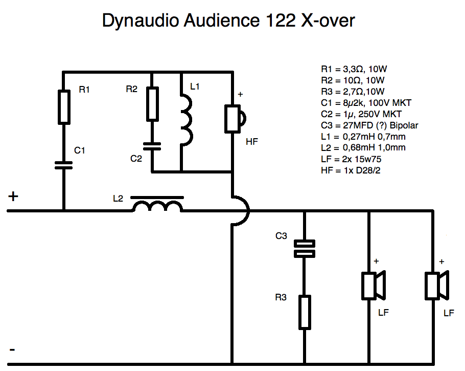

I'd like to chime in on this topic.
I'm currently in the process of revitalising my pair of Dynaudio Audience 122's. These are equipped with 2x 15W75 and 1x D28/2.
I've always enjoyed these speakers, except for the cross-over region, which is specified to be 2kHz. Especially at higher volumes, they start to shout at you, which I don't particularly like. This problem gradually became worse over the years, which led me to think it might be due to ageing of the x-over components. I've started replacing the standard components with higher quality ones, and the difference was immediately evident. More space, more 'air', less shouting. In short: more enjoyable to listen to. More "transparent", if you will. The rest of the components yet have to come in, so I'll continue later. Then I also plan on swapping the standard wiring for Kimber 4tc. The wire to my amp currently is Kimber 8tc, fitted with WBT connectors.
But: I also came across a pair of D260 tweeters. As I understood from this topic, these are more or less identical to D28/2 sensitivity and impedance wise. But how do they sound in comparison to the D28/2? Will it be worth my while to spend some €250,-- on a used pair? Even after the rest of the update is finished? And can I just swap them? Does the x-over allow for that?
The cross-over diagram of the Audience 122 is attached. Inductor values were kindly supplied by Dynaudio.
Ernst.
