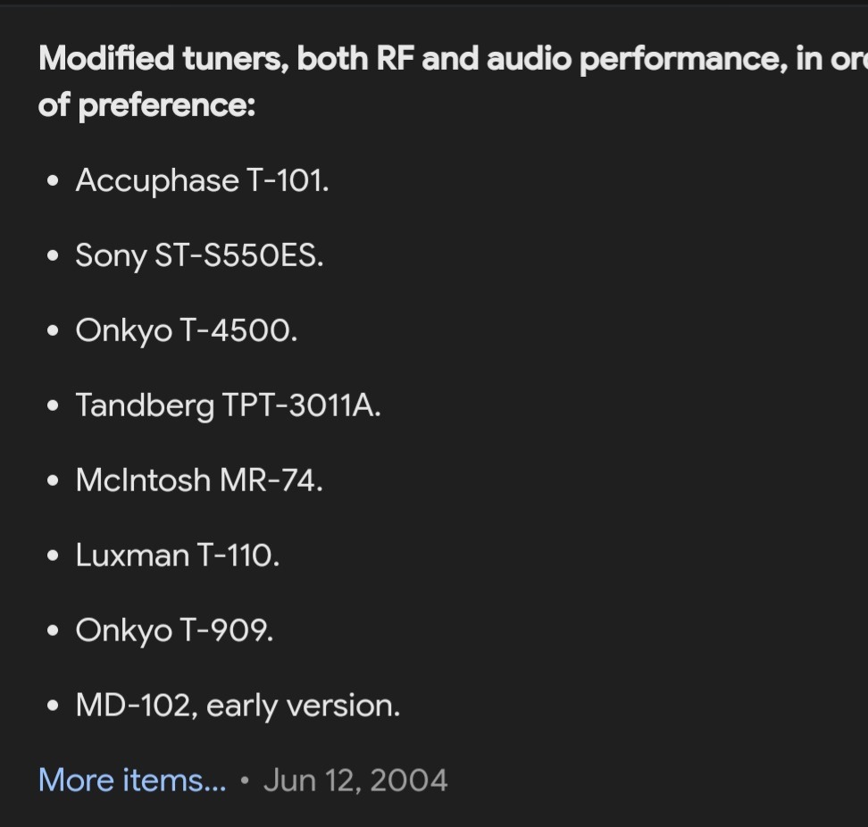

I had kenwood briefly, replaced it with 9gang technics. Had that for long time, till i discovered sony. Now i have 5 (yes five) of the same sony tuners, one for each system.
Had many other tuners, lux, marantz, pereaux, nad, onkyo, all sold. Except i keep one magnum dynalab for nostalgia. Otherwise all sony. Just a random discussion from net.

Hmm, I must admit I've never looked at the Sony tuner. They seem to be unloved. Mostly, I think, because they fell into the digital tuner era. Did you do anything to them?
