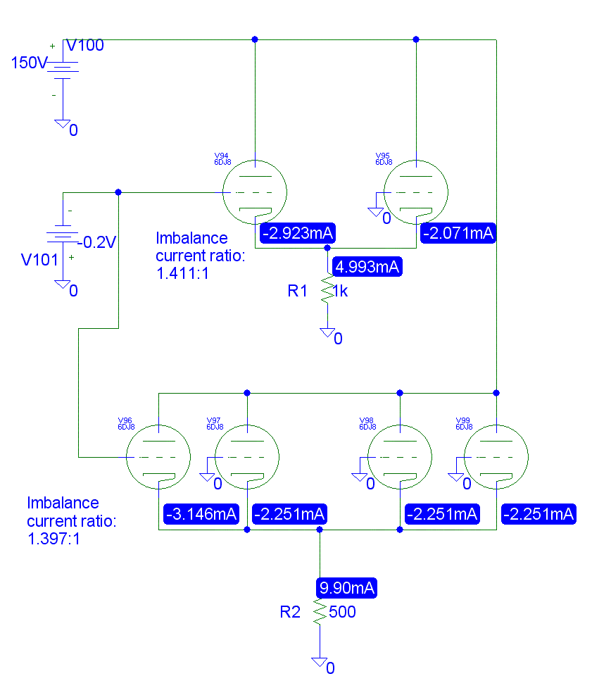

I also found it rather funny to save to the extent of using a common cathode (bias) resistor for all four EL84s.
While this trick does save the cost of one power resistor and one cap section, I think there’s another, slightly more noble, reason that Dyna and a few other manufacturers used a shared cathode bias resistor among the four tubes in both channels. As the tube characteristics drift with temperature and aging (or if poorly matched tubes are used in a replacement), the cathode bias voltage is held at the average value for the four tubes. Any one tube going somewhat errant won’t change the average Vgk very much. Channel separation is maintained to the extent that the bypass cap provides a good AC short to ground. At very low frequencies where channel separation is generally acknowledged to be less critical, there would be some channel-to-channel crosstalk, but these effects are suppressed because the crosstalk is in the common-mode both to and from each push-pull pair. From the perspective of a trouble-free design for lowest common-denominator users, this approach made some sense.
However, we avid DIYers can and probably should separate the bias resistor and bypass cap, one each for each channel, if we don’t incorporate some more sophisticated biasing arrangement (fixed bias, LEDs, servos, or whatever).
the ST-35 runs the 6BQ5 way beyond its ratings...IIRC the screen and plate dissipation in the ST-35 probably exceeds 14W per tube.
This problem is a bit more vexing, especially with today's higher average AC line voltages. Besides taking steps to drop power tube voltages and/or currents, thermal support is useful.
I have an SCA-35 which has been undergoing a gradual transformation. In the SCA-35, the four 6BQ5s are arranged close together in a diamond arrangement. They are too close to each other for comfort and the heat build-up is alarming. The adjacent power transformer doesn’t help this situation. Often the PCBs in the SCA-35 are charred looking from all the excess heat over decades of time. Despite the perforated top cover, air circulation is not enough to keep inner chassis temperatures reasonable, in my view. I found a tiny box fan, just over an inch on each side, which I mounted on the inside of the perforated top cover so that the fan fits just within the diamond pattern of the four tubes with the cover in place. It is close to, but not touching any of the tubes. The fan accelerates air out of the top making the diamond shape into a bit of a chimney. The fan alone is not enough to protect a severely over-stressed tube, but it helps, and it keeps other components inside the chassis cooler. The ST-35 should run cooler than the SCA-35 due to its more spread-out arrangement, but a pair of small, quiet fans on the ST-35’s output tubes might be helpful too.
The single cathode resistor makes it more sensitive to tube imbalance - a tube with grid emission will run away for sure with such a low value. But matched quads of 6BQ5s were cheap then... I think it was done to squeeze the last fraction of a watt out of the 6BQ5s, albeit one channel at a time - it won't help with both channels driven.
Tom,
You are right about one tube in runaway. The lower-value shared resistor provides less negative feedback at "DC" to that one tube if it goes wild, which I have seen in my own SCA-35 with a glowing Ei EL84 (actually a relabeled 6P14). But, push-pull balance is still slightly better, as you can see in the sim result below. I used a small grid bias to unbalance one tube in each of the two cases (two tubes versus four tubes). By the way, total power supply current stays more constant with a shared resistor too. Admittedly, the improvement in push-pull balance is less than I recalled (in this quicky sim of 6DJ8s anyway), but it's definitely in the favorable direction.
I don't see how the shared approach could squeeze any more power out of the amplifier in the audio band where the bypass cap is an AC short.

The ST-35 normally runs very warm. High line voltage will walk the power transformer core up the BH curve towards saturation, and that will result in a lot of additional heat.
Long term solution to excessive line voltage (if that 124V was not a fluke) would be to take a >3A 6.3V filament transformer and wire it so that it bucks the line voltage down to a more reasonable 118V or so. Mount it in a box with a duplex outlet and you will be all set. Include a slow blow fuse rated at about the secondary current of the transformer for safety.
