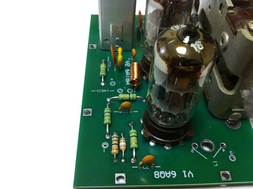

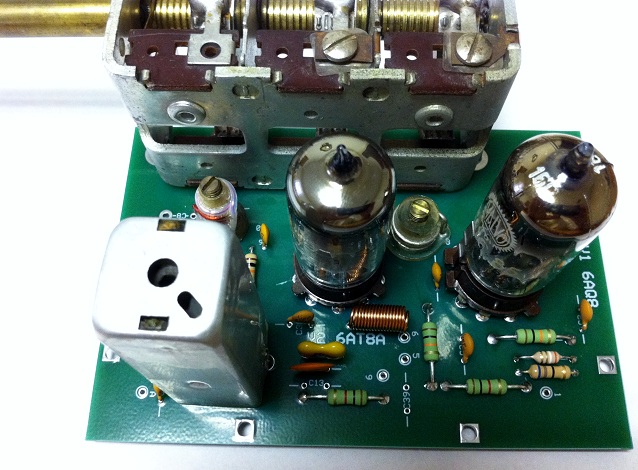

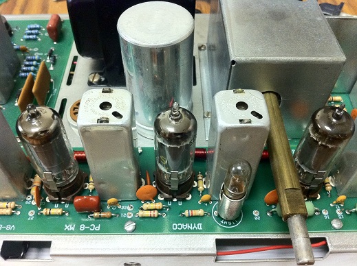

So this is the front end with the first IF?
Looking good.
Yes it's the first stage,I should have the next stages w/ discriminator real soon.
One of the new components for oscillator circuit, the trimmer capacitor can be adjusted above board which really helps on the RF alignment. Thanks
That board looks really good. Perhaps there is enough interest here that you could eventually offer these as part of a group buy.
Yes I am seriously considering it, there seems to be a huge intrest today in Dynaco gear, and the FM-3 is gaining on the other Dynaco products. I would hope enough intrest to begin manufacturing of the parts that are hard to find such as the IFT's needed for tube tuners.
You'd have no competition as far as I know so this could be a viable business. No question that these boards would make for a more stable and predictable tuner over time. Taming thermally induced local oscillator drift was a challenge in the original design, presumably you have kept the original ceramic caps or replaced them with devices with the same tempco. (Potentially some minor tweaking required here.) FR4 or G10 should be a lot less hygroscopic than the original phenolic pcbs and less lossy which hopefully result in somewhat improved overall performance. Definitely looks a lot better which is good enough justification IMHO, and the other new parts should help stability as well.

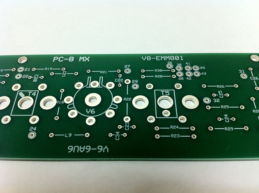

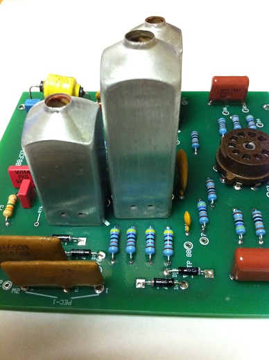

I will have some PC-8 boards some time at the end of next week, I have already done PC-12,so I will have a FULL set,some already populated,I could work an exchange,old for the new,which will lower the cost,plus give me the components I need to populate the new boards. I can PM you when I get those in,Thanks.

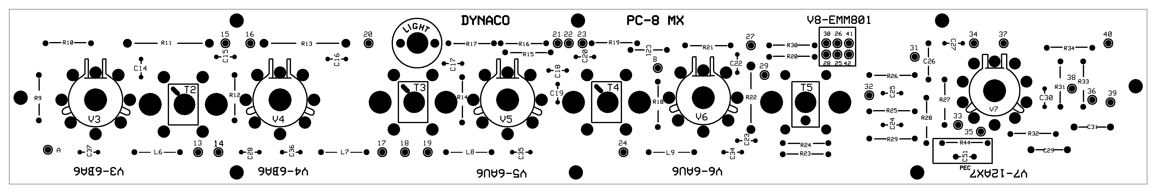

Here is PC-12. When I was first working on the design,I was using the old board as a pattern,so I didn't design the new board to accomidate individual components for the PEC filters,although I know there are modern PEC modules available,I just decided to use the old. In the newer design I will make space available for the PEC components.

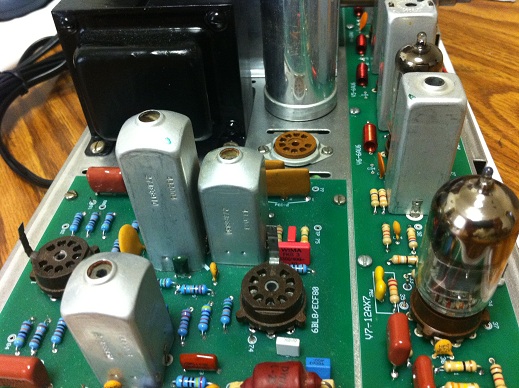

Here are picks of boards installed
Wow, looks very nice.. Unfortunately I don't have an FM-3, I will however tell some of my friends about yours.

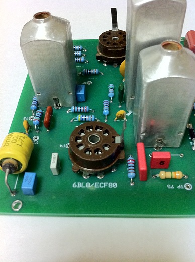

Sounds good,I already have several boards populated already,but I can supply you with a BOM. In addition to resistors and caps,I have only made two other changes in replacement of the old components.
PC-7 C8 has been replaced with an Air Dielectric Trimmer Capacitor made by Sprague Goodman Part No.GAA10006
PC-7 L2 has been replaced by a choke made by Fastron Part No.
MICC/N-3R9J-00

PS In the original design,I simply used the old boards as a pattern,so PC-12 doesn't accomidate the individual components for the PEC filters,so I am updating the design for that.
