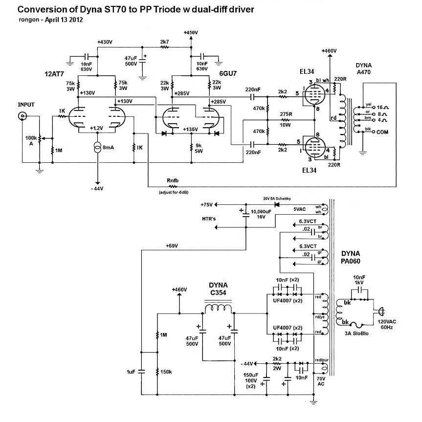

I updated the schematic from April 17's post. It should show the corrections. It also shows the new feedback resistor value (see below).
It also shows some of the updates that resulted from last night's testing. And speaking of testing...
The amp makes 10 watts per side before clipping. It clips very symmetrically, which is nice, with no crossover notch at all.
I listened to it originally with a 33k feedback resistor. It turns out that was 12dB of NFB. No wonder the amp sounded so squeaky clean, but not as "involving" as I like. But the input sensitivity was good for playing sources straight into an attenuator and direct to the power amp (no preamp needed).
Open loop, the amp got to its 10 watts out with a little more than 150mV pk input. I added 5dB NFB to get that to 300mV to full power. This was measured on a nice analog RMS voltmeter with decibel scale.
Open loop bandwidth was -2dB at 18Hz and 34kHz (approximately, I was a little rushed). Bandwidth improved to -2dB at 11Hz and 170kHz after adding the 5dB NFB.
Square waves looked just OK open loop. Perfectly fine 1kHz square wave at 1W output, and just slightly rounded leading edge at full power out (open loop). After the feedback, the 1kHz square wave looks fine all the way to full power.
Full power 10kHz square wave still looks recognizable w/o NFB. Looks better w/ NFB, but still rounded off a hair, and with a hint of overshoot peak right at the leading edge. But really not too shabby for what it is. I forgot my camera, so no pictures. I'm sorry about that.
I looked for oscillations but didn't find any. That was on a 60MHz scope. I think the amp's A-OK.
The power supply rails have like 10mV of ripple on them, but the diff-pairs don't seem to care. The amp is very quiet, the closest to noise-free of any amp I've built. I'm really happy about that.
There's just a little 60Hz switching noise on the heater windings. The 10nF caps bypassing the 6.3V windings to ground didn't kill it off, but it did reduce it some.
My only gripe is that the amp is a bit too sensitive for my stepped attenuator. My attenuator has very coarse steps (2dB). In other words, it gets really loud at low settings. I think I'm going to try changing the input LTP to a 6FQ7. A 6FQ7 should give me about half the gain of a 12AT7, so a -6dB difference in input sensitivity, correct?
I'll be able to listen to it at a reasonable level later today. I trust it well enough to go into the main system (Pioneer PD-D6-J SACD player, Intact Audio inductive attenuator, Snell Type J/III speakers).

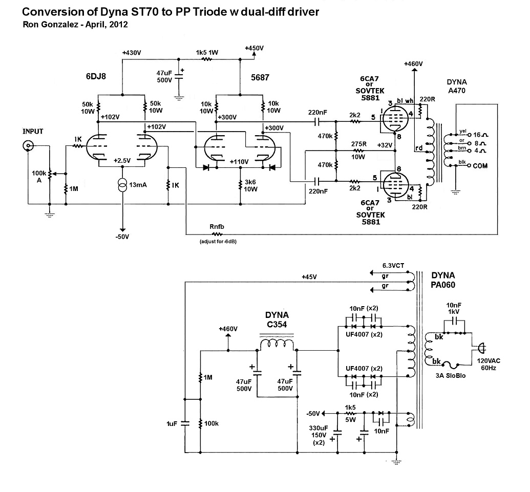

Incidentally, this turned out to be a mere tweak of a circuit JC Morrison published in The Tube Audio Primer back in the early '90s. That, in turn, was nearly identical to a circuit by Arthur Loesch published in Sound Practices, in the "Few Stones Left Unturned" article. It still sounds really good.

OK, so I think I learned something...
I think I really like the sound of the last round of changes.
The amp measured very well, with good square waves, high frequency response -3dB at 170kHz (with loop feedback), -3dB @ 32kHz open loop. Good square waves, well damped, etc. Low frequency response -1dB @ 11Hz (closed loop).
I was happy, until I got it home and listened to it a while. I didn't like the character of the sound. It seemed overly "dry" and maybe a little "harsh" in the upper mids and highs. But why?
I decided to investigate the sound of the first stage. I had it with large plate resistors for a flat loadline. Low current, though, only 3.5mA per triode in either a 6DJ8 or 6CG7. I figured I didn't need any more gain than a 6CG7 would deliver, so let's optimize it for that tube, with 7 or 8mA per triode. I had to squeeze a couple of LM317's in for CCS's. (I'm sorry, I just can't fit a little board in there for cascoded DN2540's.)
While I was at it, I reconfigured the 6GU7 driver section, reducing the plate resistors from 22k down to 15k, so the tubes would have more voltage across them. Maybe the loss of linearity would be compensated for by increased headroom. Worth a try.
I fired it up for the first time this evening. It sounds way better. Really good. I'm very happy right now. Lee Morgan's trumpet is like it's in the room. You can easily hear how much they've squashed the latest Blue Note reissues with dynamics compression. Like the radio, but on a CD. Yuck. But it's mastering studio clear now, and much more fun to listen to.
Let's see how I feel about it after I get a look at it on the test bench, and a week of listening to it.
Schematic below.
Schematic below.
The loadlines for the 6CG7 (input LTP-phase splitter) and the 6GU7 (push-pull driver).
They're certainly steeper than the ones I used before, yet they sound better. Higher current operation in the first stage sounds better? Maybe I like a bit more distortion from the second stage? I dunno...
