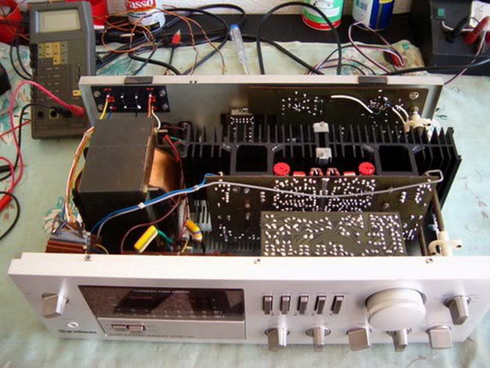

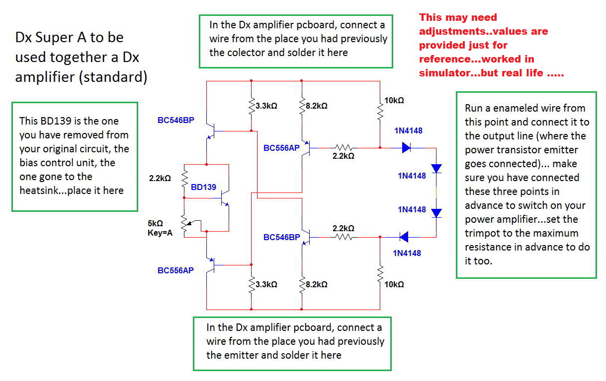

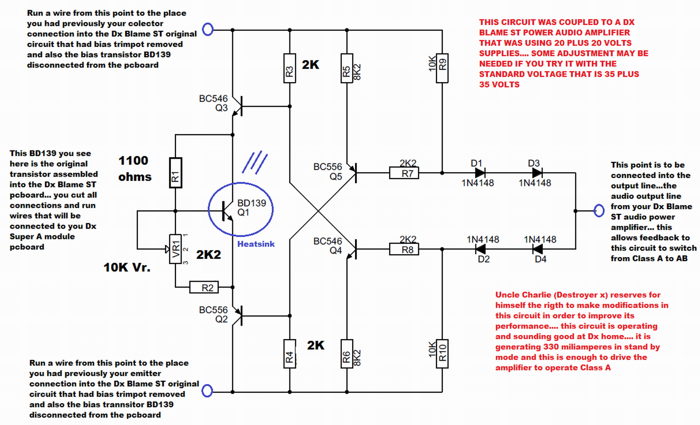

Dx Super A - a module to be coupled to Dx amplifiers
It can be used with other audio amplifiers that uses emitter follower and needs bias generated reference voltage from 2 to 2.4 volts Dc.

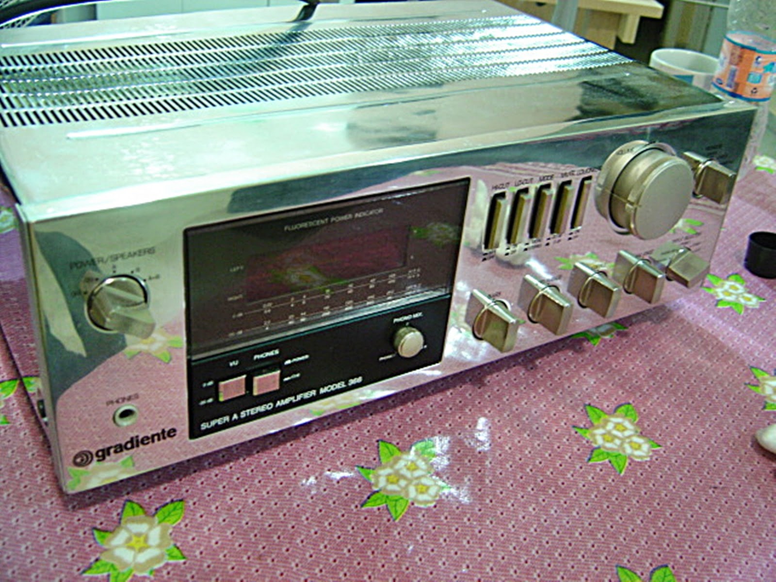

This circuit is adapted, or almost a copy, from the Super A used in the Braziian Gradiente factory (already closed.... factory not operating anymore)....it was used in one of the most famous models of this brand, called Model 366.... it was a license from JVC, the one have created the system down the seventies.
The Super A works setting a high level of bias (300 to 500mA) and switches this current to a lower value (Class AB) when the output power increases above some pre decided level (in our case 4 volts RMS aprox.) ... this way you have a couple of watts in Class A (non switching in the transistor crossover region) and does not have the heat that comes together a Class A amplifier.

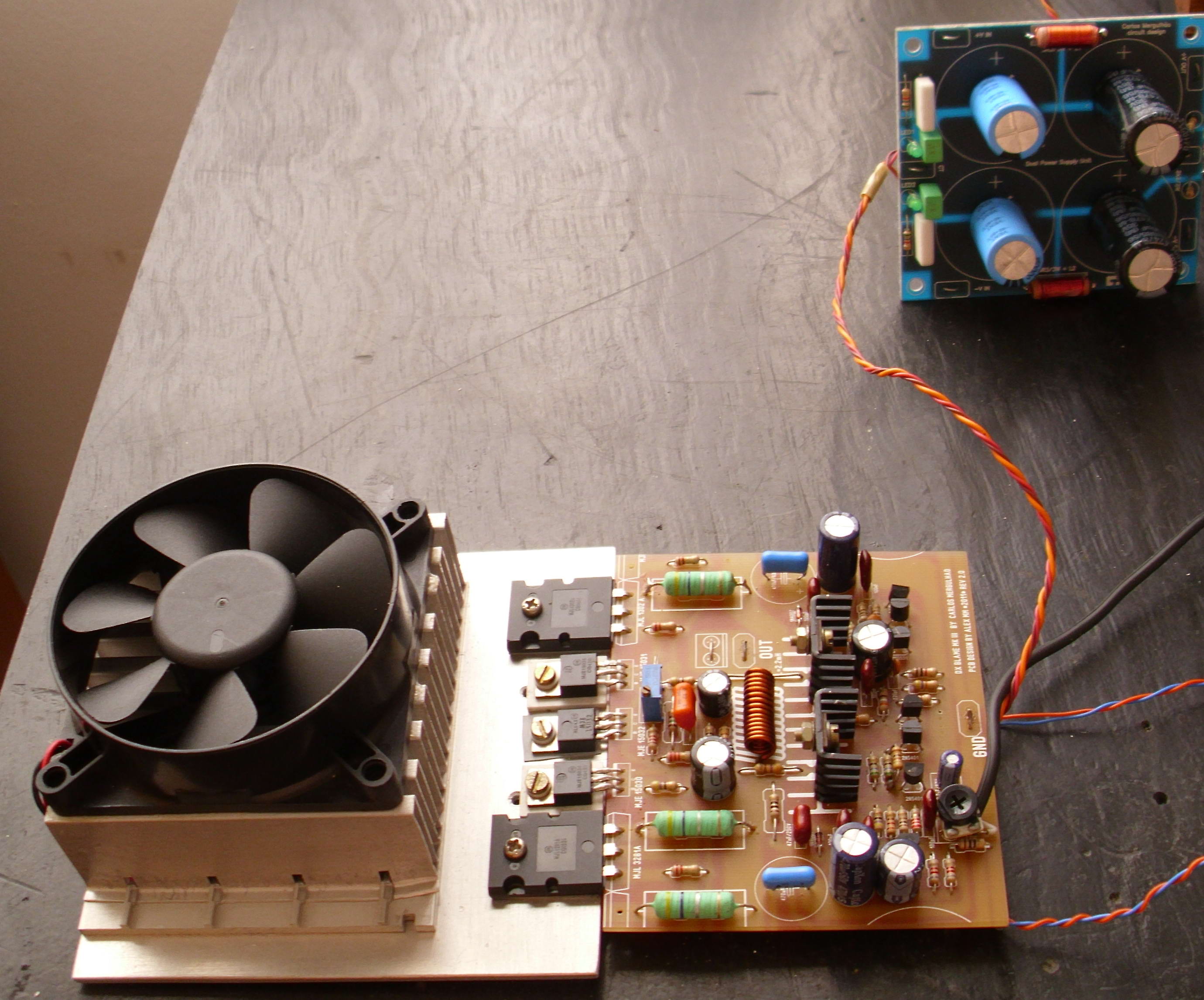

This was tested in a Dx Blame ST amplifier, and i did it with one that had 20 plus 20 volts supplies...soon i will be testing together many other models from the "Dx Corporation - the audiophile union"
This circuit is in testing and may receive some modifications...and i will publish the revised schematics.
Here you have the video with the last test made with it:
Dx Blame ST, Super A approved! - YouTube
regards,
Carlos

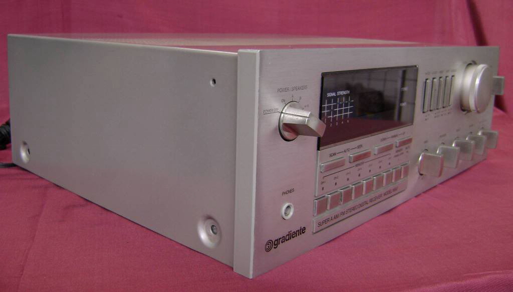

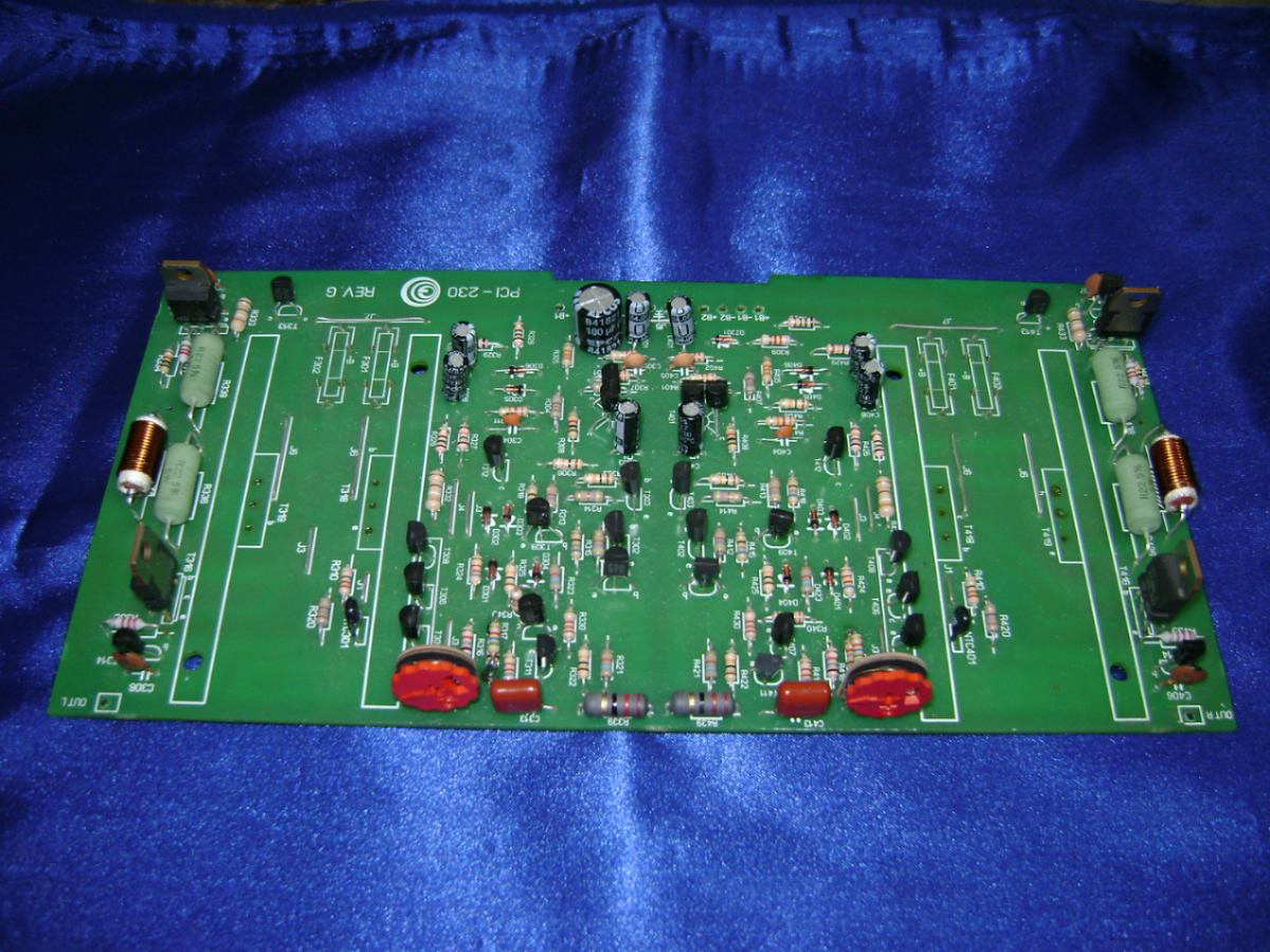

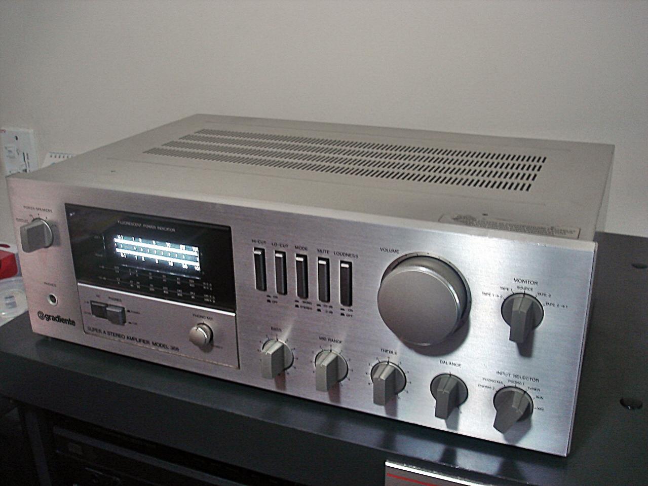

More images about the Gradiente Model 366 - the SuperA unit
This one is famous and audiophile goes to buy it and pay 500 bucks without discuss.
There's someone in the Brazilian free Market (Mercado Livre....alike Ebay) selling audio power pcboards for this model... a copy from the original Gradiente pcboard.
regards,
Carlos

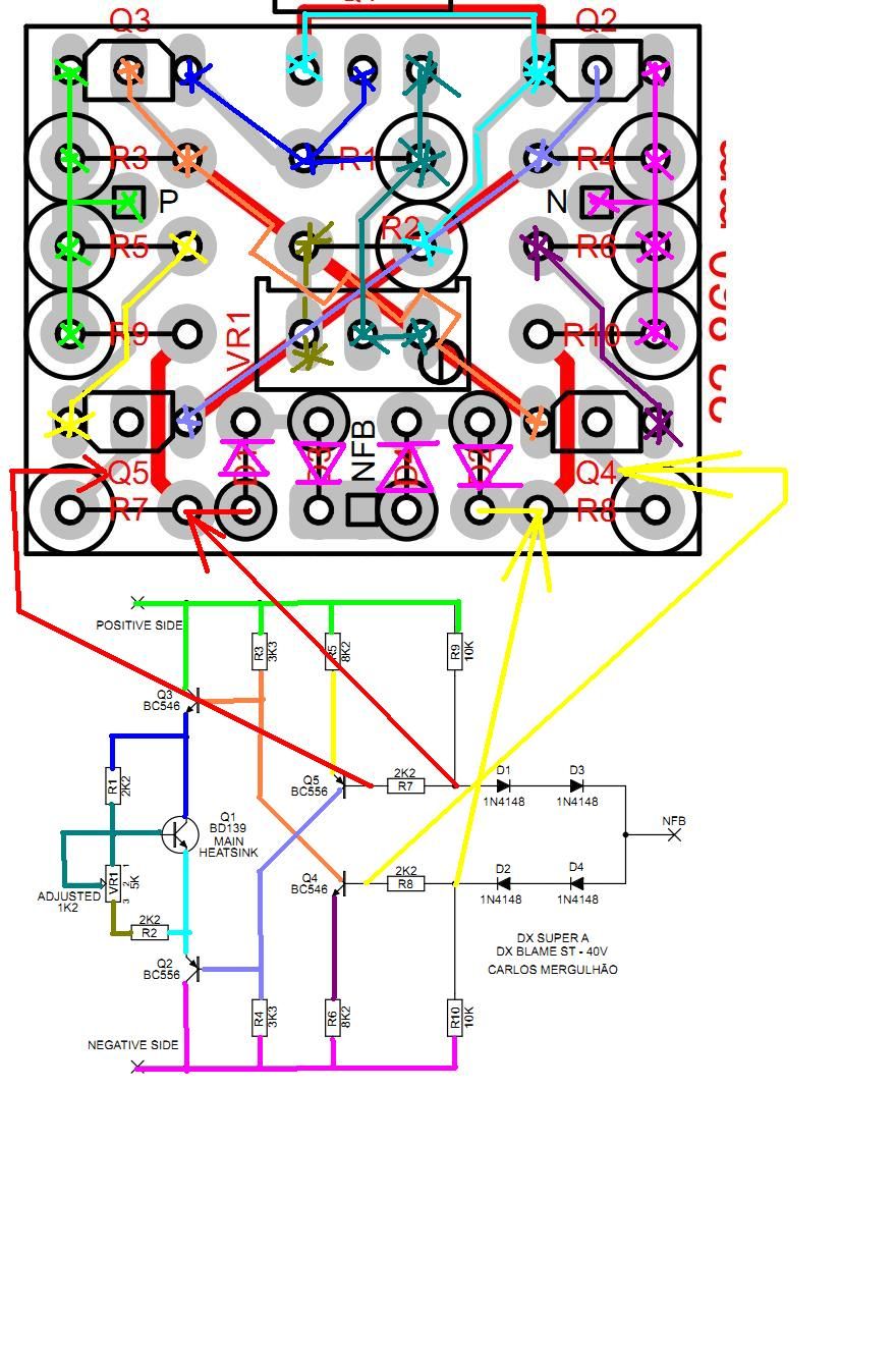

Here you have some diagrams...but this is a reference only
Values are being changed in order to adjust the unit to different demands and different power amplifiers.
Just publishing to show you some "standard" of values that may be a start up.
regards,
Carlos
  • Dx Super A, pcb top view with values applied just for reference.pdf
  • Dx Super A, values just for reference.pdf
  • SUPER A DX AMP JUMPERS.pdf

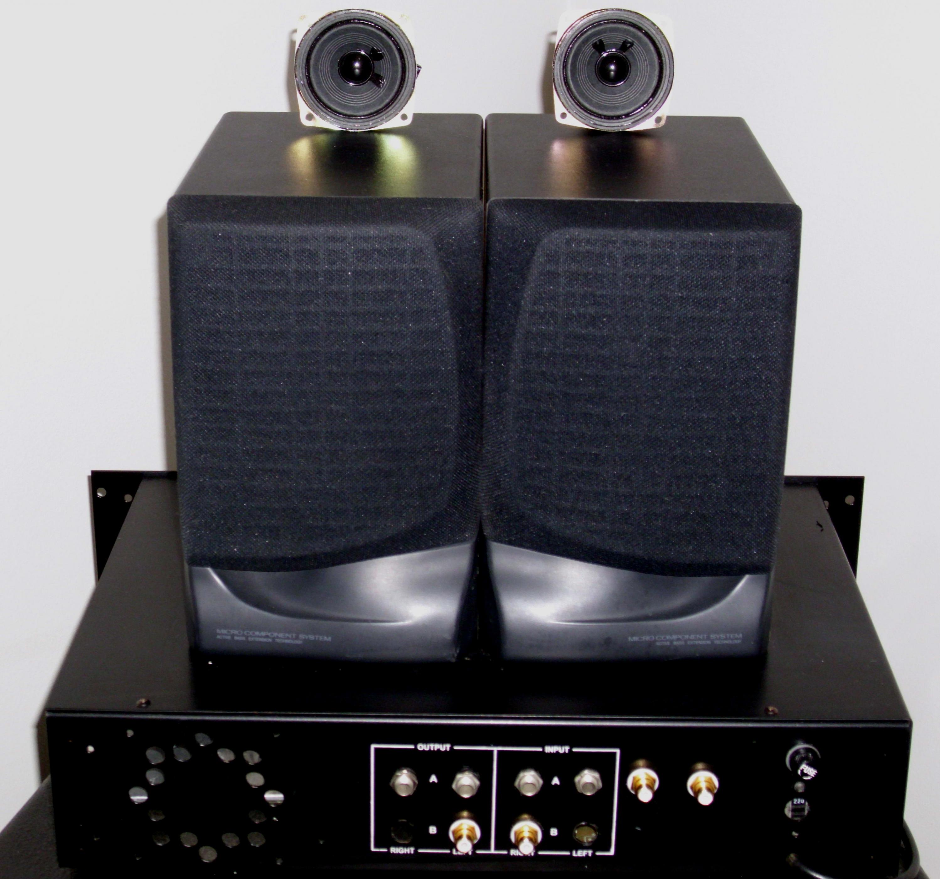

I have being working on that these last two weeks
And something was posted into the Dx amplfiers thread, also the Dx Blame ST thread and something was said in the Dx Blame MKIII Hx thread too....but just to inform, as i was not sure if i would like it or not.
Now we have a thread and all informs will be here.
I have perceived the sound muffled...but this may be my damaged tweeters..now i will evaluate better...give me a couple of days and i will say what i think about...for a while i am appreciating a lot the advantage not to have all that Class A heat and also the quality in very low levels (1 to 2 watts reproduction).
Well...we listen at this level almost 80 percent of our time.
regards,
Carlos

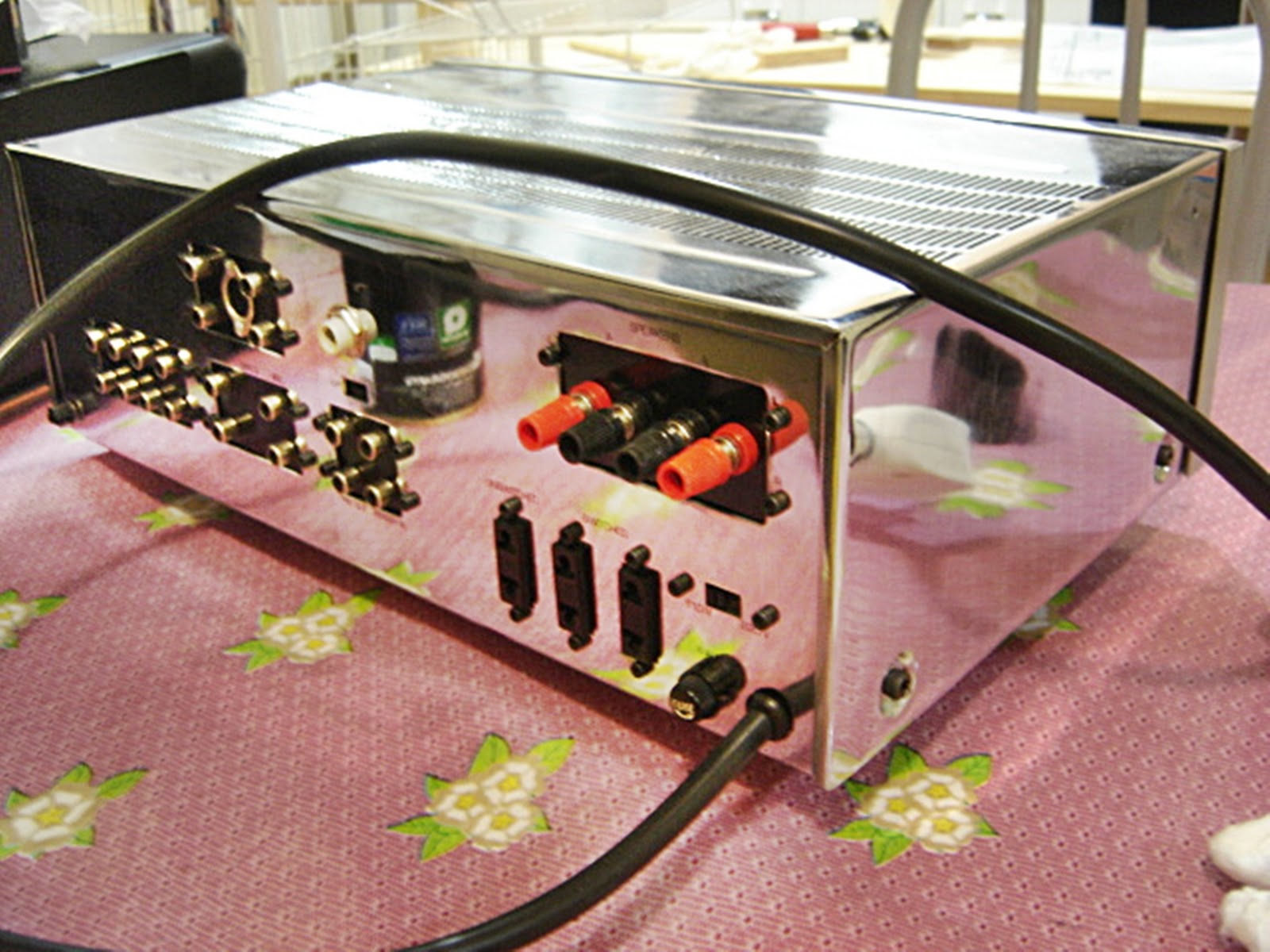

Here you have one of my cameras used to make these videos:
This is the Mitsuca! - YouTube
Pictures attached show the Kodak Playfull Ze1 and the Dx Blame MKIII Hx used together the Dx Super A module (first try)
regards,
Carlos

I am glad you like it Bigun..it is easy to find in several repair shops junk
Here you have a new video about the test made with the Dx Super A together the Dx Blame ST operating 40 plus 40 volts supplies:
Dx Super A together Dx Blame ST operating 40 volts - YouTube

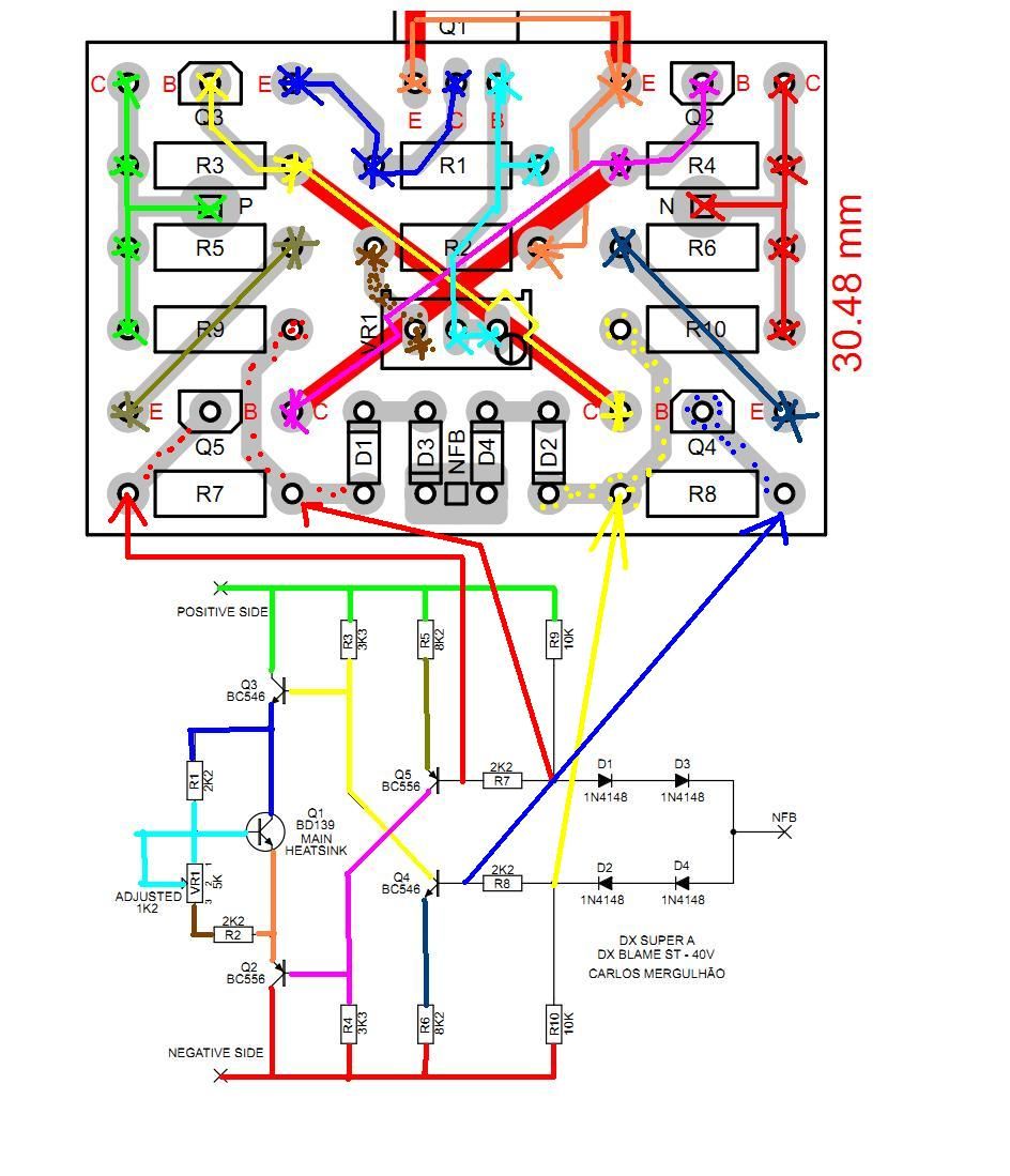

Also you have now the correct values applied to the Dx Super A module.
Herman is fixing the schematic and including real values....soon we gonna have them with real values.
regards,
Carlos

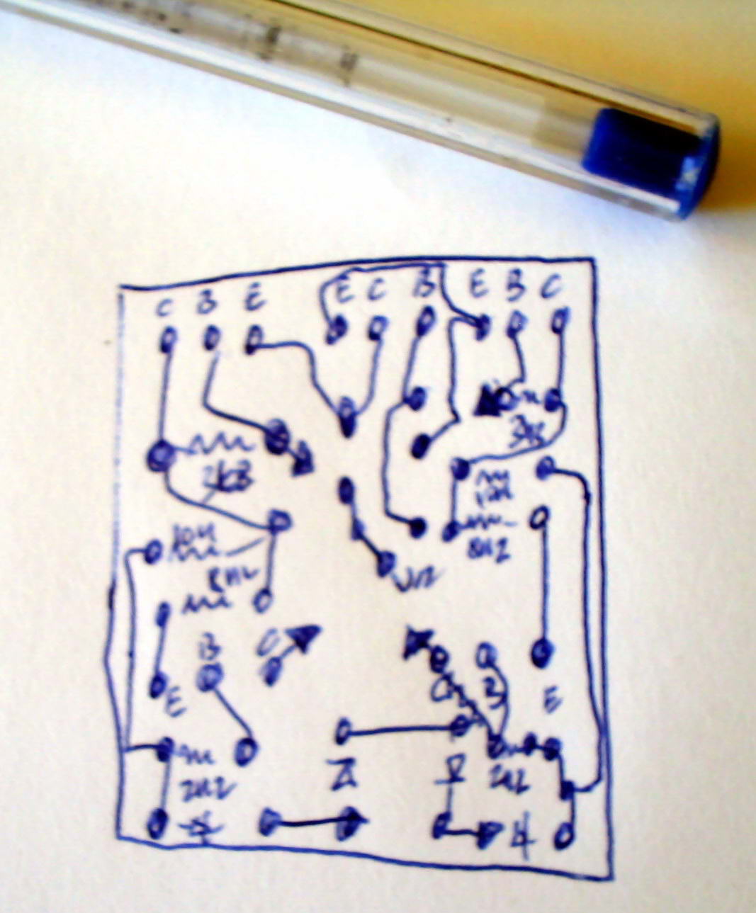

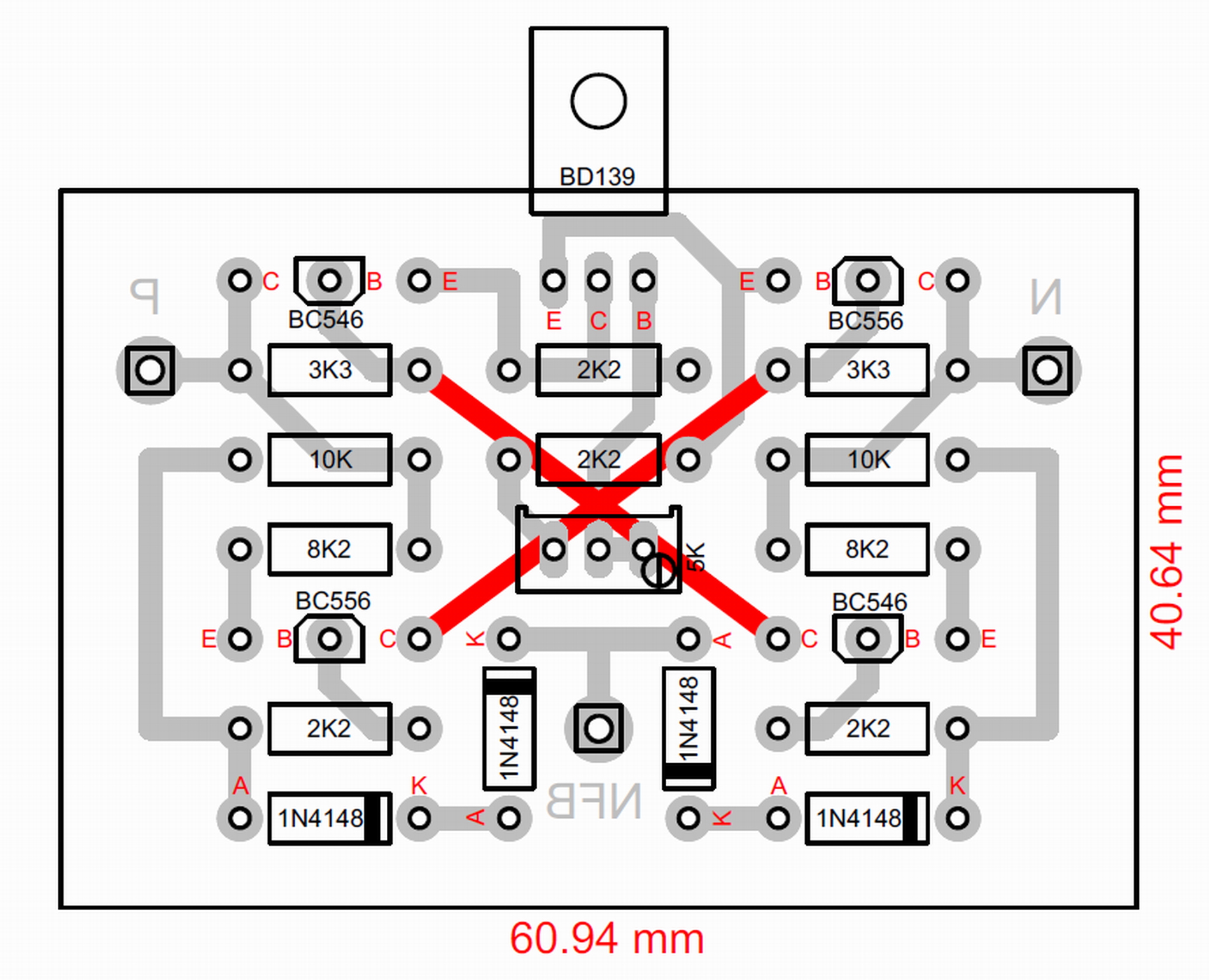

I do think this pcboard is too much big to be assembled alike floating
Above the power amplifier pcboard....it looks huge to my eyes...can be reduced 50 percent with vertical resistors...i will ask Herman to reduce it.
I want it tiny like a fly landed over a transatlantic.
regards,
Carlos

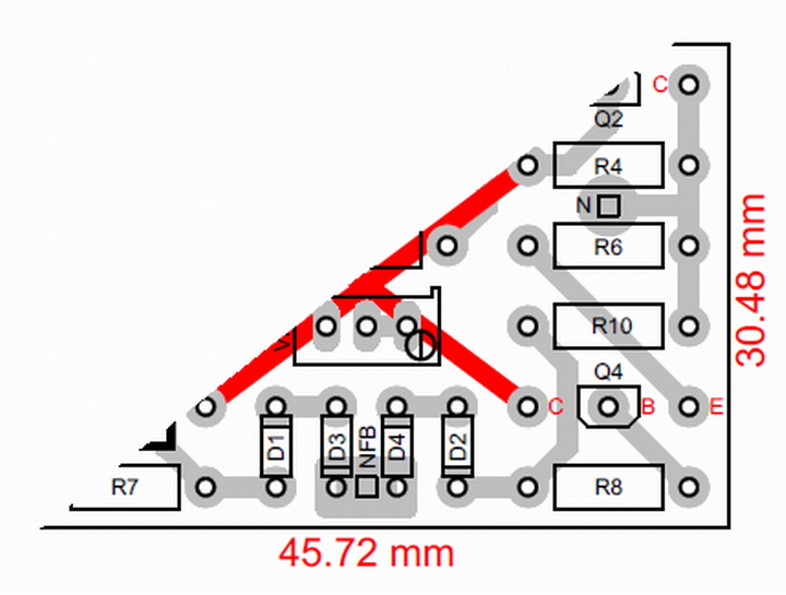

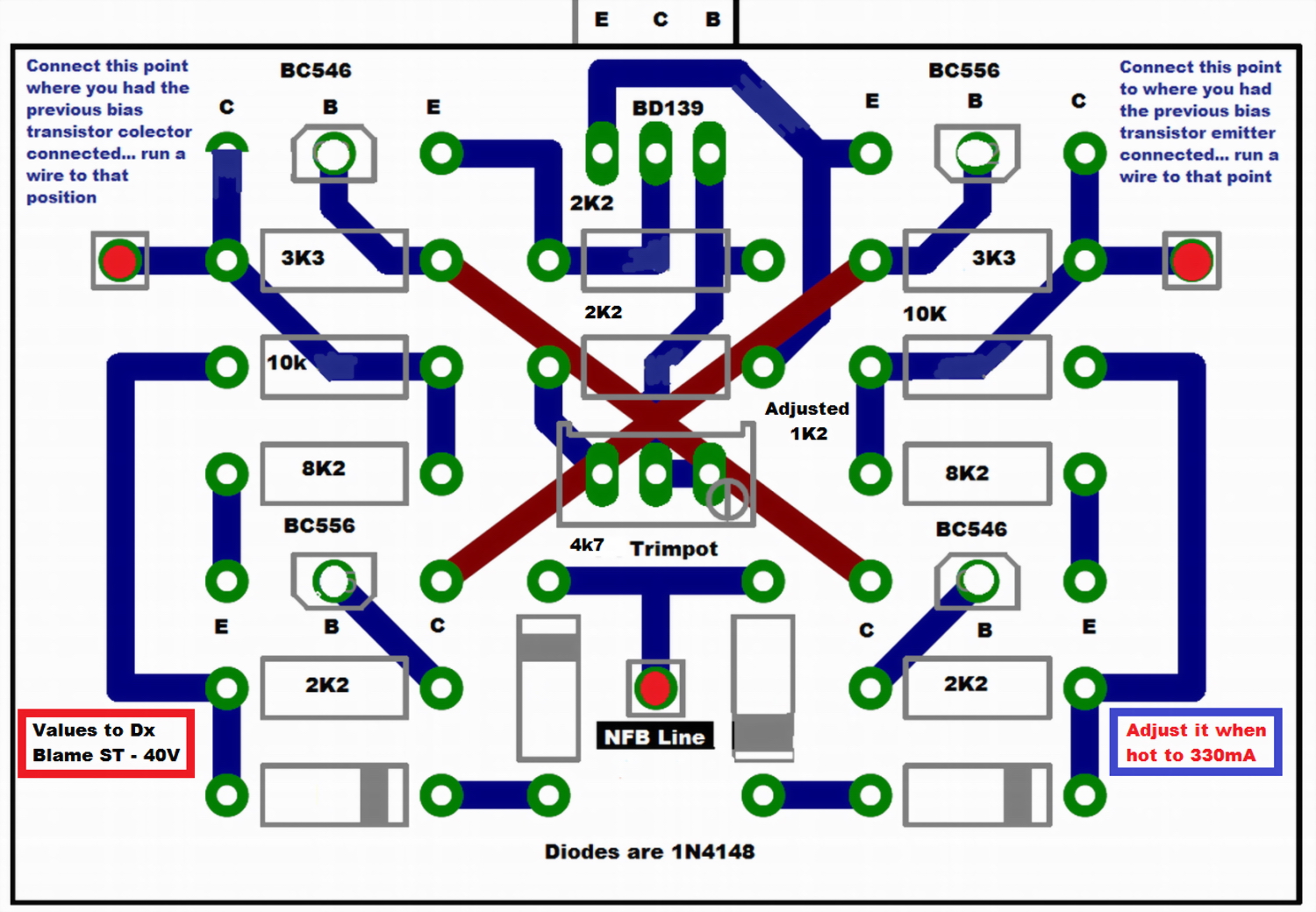

We are constantly and continuously improving the pcboard
The one is making is Herman...i am giving him suggestions (and terrible demands too).
He does not want me to show the board...because not finished yet....as i do not agree with him...them 50 by 50.... i decide to show half the board.... well...this way i am doing what he wants.... he said not to show the board...i am showing part of the board.
I want him to put transistors in vertical position to reduce board size...it is being a trouble to convince the guy.
heheheheheheh.
regards,
Carlos

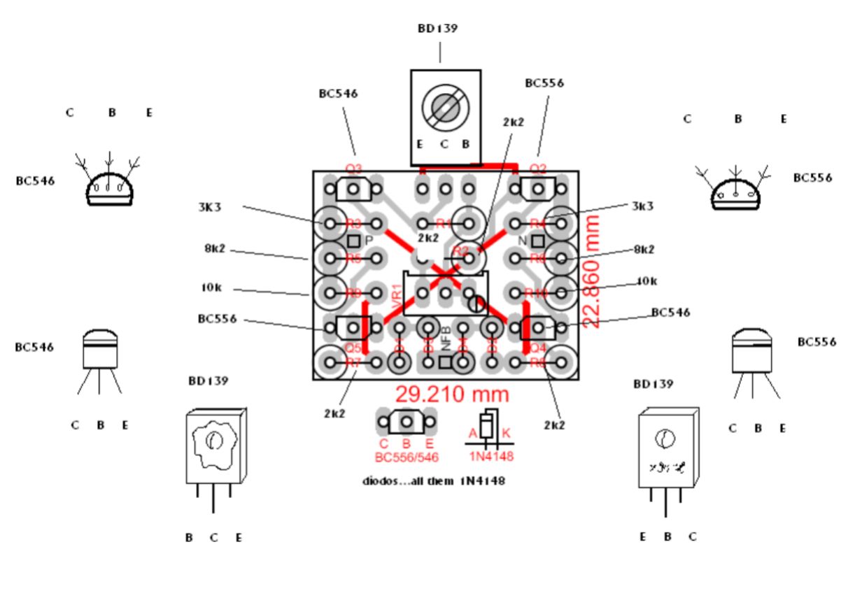

Dx Super A pcboard update, revision, images attached
Here you have values:
Q1 - BD139
Q2 - BC556
Q3 - BC546
Q4 - BC546
Q5 - BC556
R1 - 2K2
R2 - 2K2
R3 - 3k3
R4 - 3k3
R5 - 8K2
R6 - 8K2
R7 - 2K2
R8 - 2K2
R9 - 10K
R10 10K
D1-1N4148
D2-1N4148
D3-1N4148
D4-1N4148
regards,
Carlos
  • Dx Super A - components view.pdf
  • Dx Super A - copper tracks.pdf
  • Dx Super A - Transparent view.pdf
