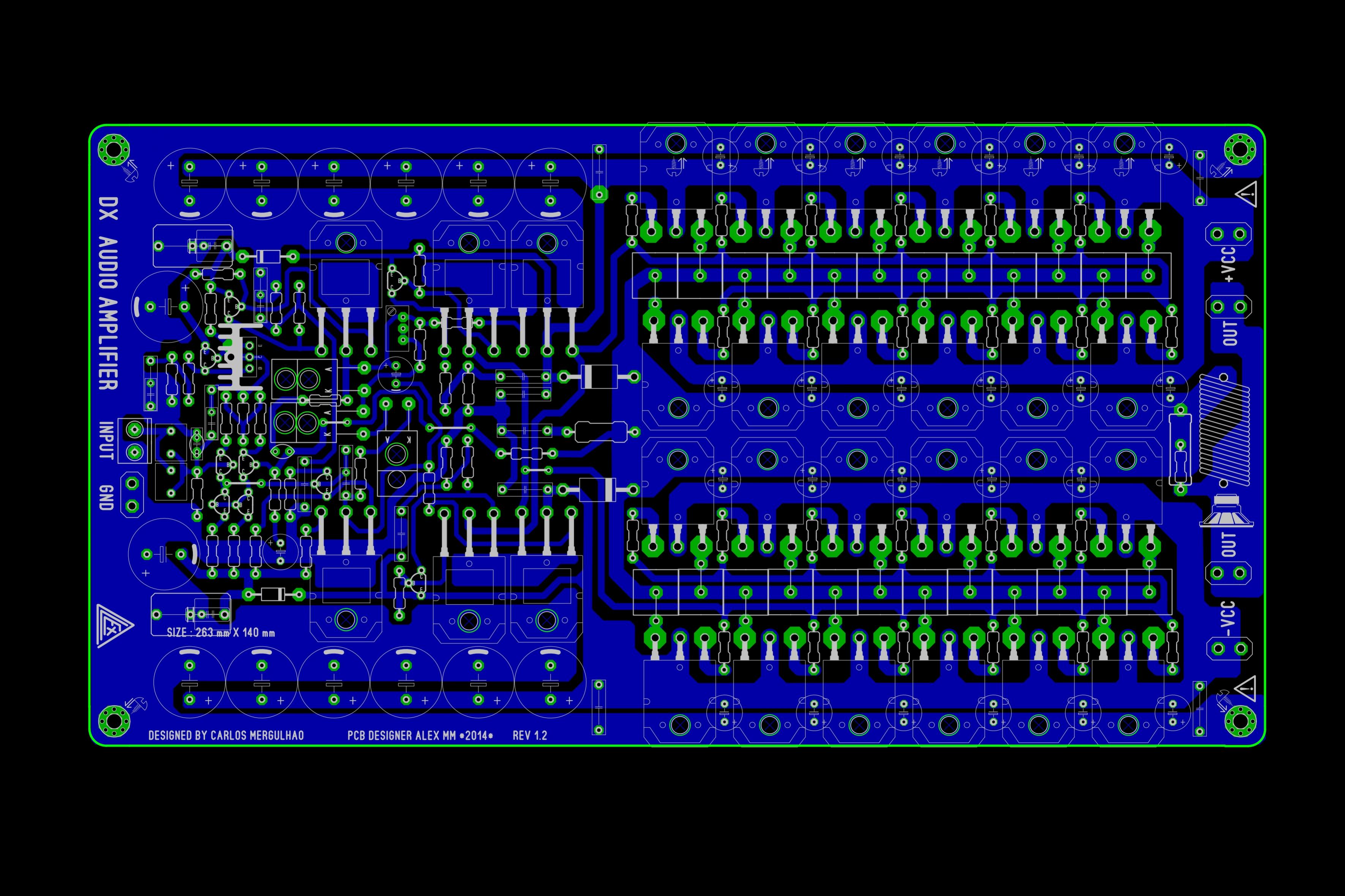

Dx Juan layouts ideas PCB

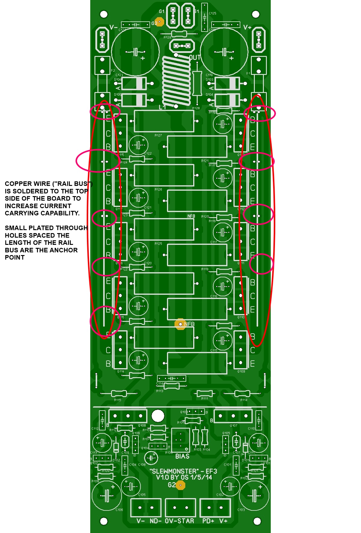

Rail bar

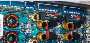

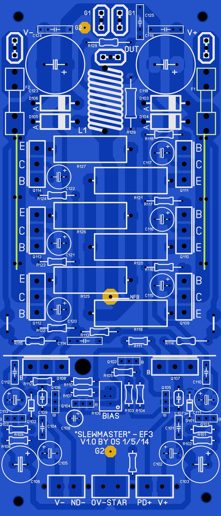

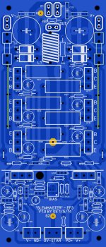

Yes Ranchu nice idea I was reading the thread of OS
"SLEWMASTER" - EF3" and is a lot of material to cover and read and I might incorporate the design style to the one I'm making,
I see what you mean about the rail reinforce for better current handling I have seen that before in high power amplifiers specially car audio amplifiers :)
Juan

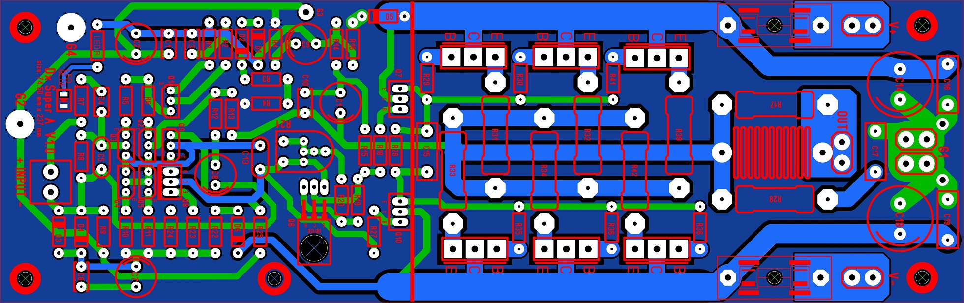

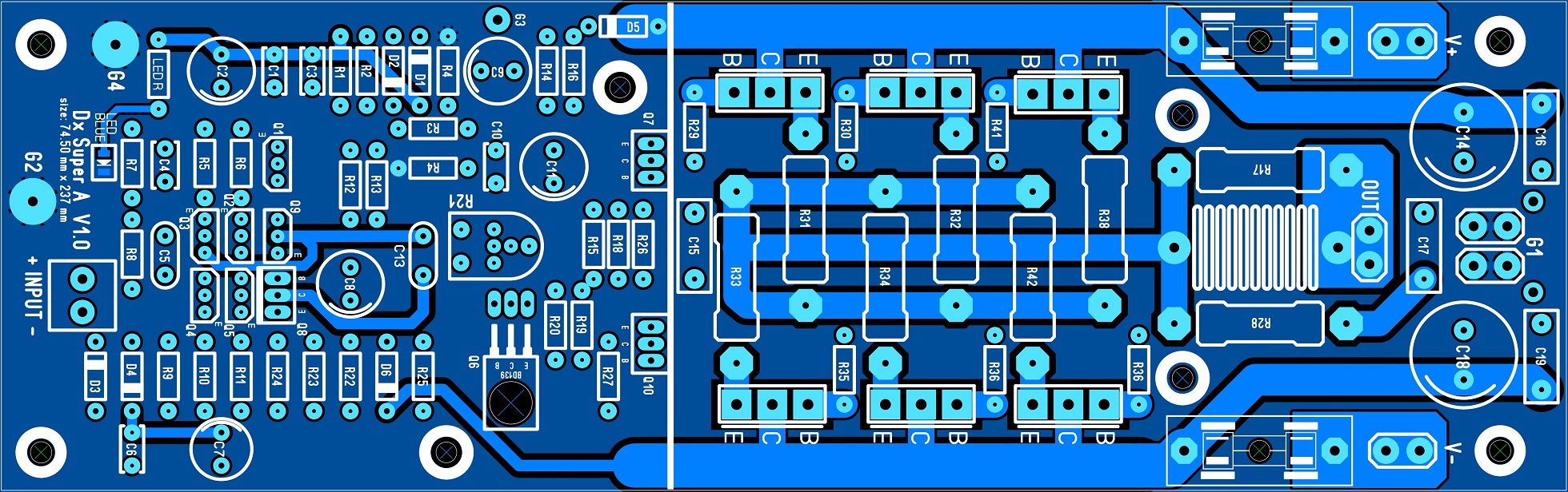

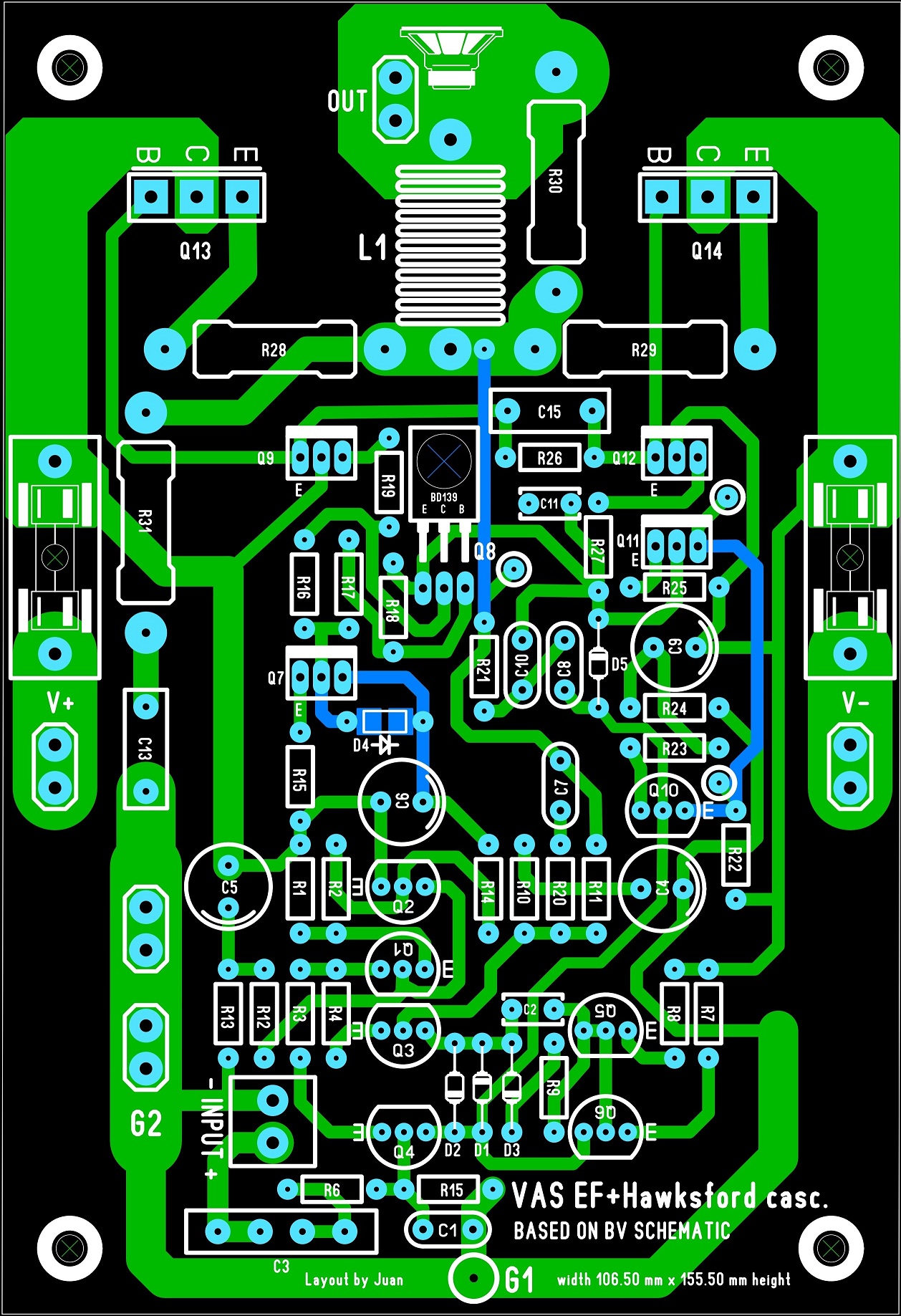

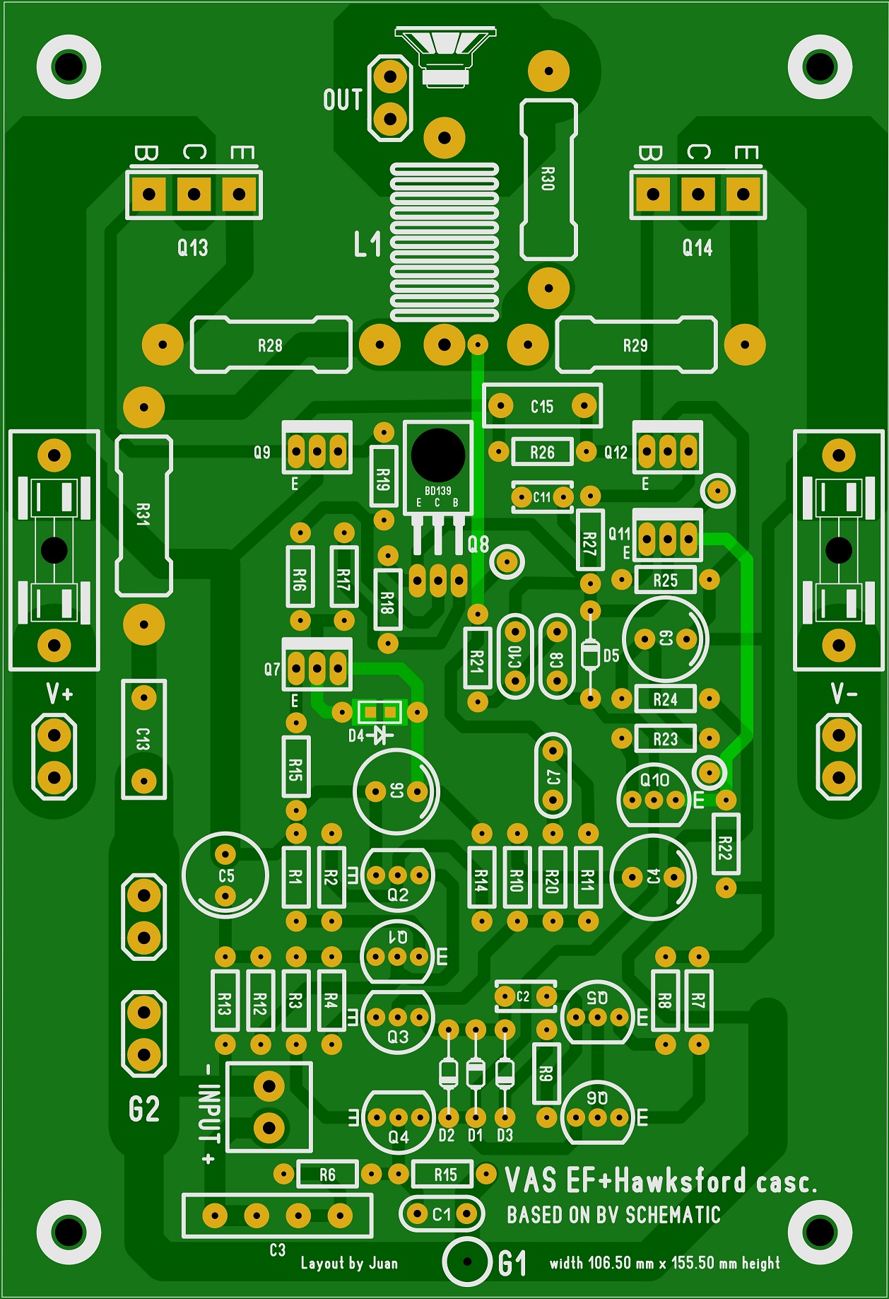

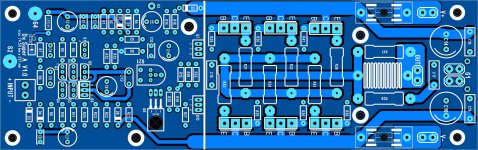

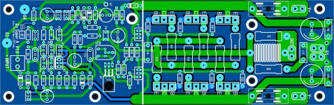

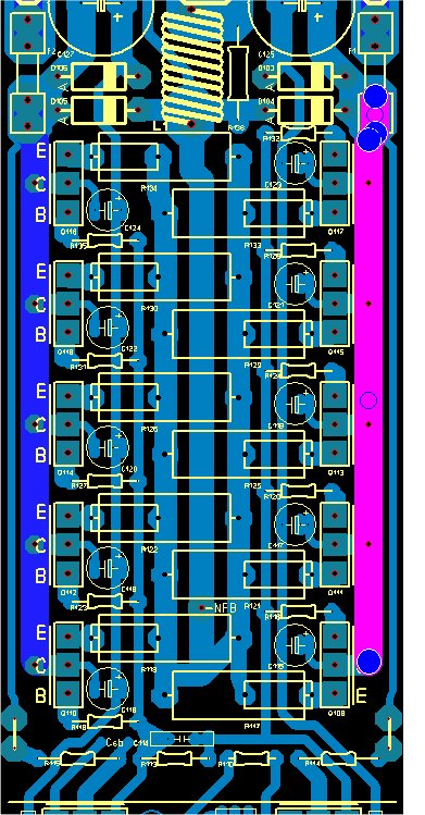

Here is another practice PCB and for the first time I use the top copper area of the board I'm not really use to make it that way, but I guess is ok I have the idea from mister OS "SLEWMASTER" layout style so I incorporate to see how it looks on Dx Super A I will continue to see if I can fix some other stuff :)
Regards
Juan
Juan

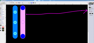

If you send the boards to manufacture ... just use 6mm tracks double sided with
"throughholes" (join the 2 sides). 12mm (both traces) of 2 oz. copper can handle 20A all day :) . (below example)

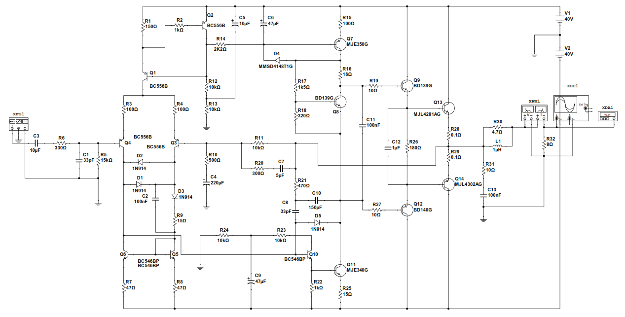

PS - alex's 20 output "super amp" .... that many devices - that close together...
might be a problem. Use an OEM pro amp as a reference ... they will space
> 16+ output devices across a 12 - 18" fan cooled heatsink. (NO "hotspot").
OS

6 mm track cool cool, I will keep that in mind, good idea side top and bottom join by holes pads, wow 20A! that is serious business current right there jejejejeje:p
I was checking the track with 6 mm and it can handle 18.5A according to the software holy smoky man !
thanks OS :)
Juan

Here's the link .... The CircuitCalculator.com Blog PCB Trace Width Calculator
There is the little issue of heat ! 20A with combined 12mm 2 oz. width (s)
will raise the trace temperature 12C above ambient.
Also - the "Vias" (through holes) ... have a rating ... The CircuitCalculator.com Blog PCB Via Calculator
Example - a 1mm plated hole has @ a 4A rating
PS - using the calculators , you can EVEN predict the inductance of the traces to "plug" into a
simulation... To see how the layout would actually respond to that much current.
OS
