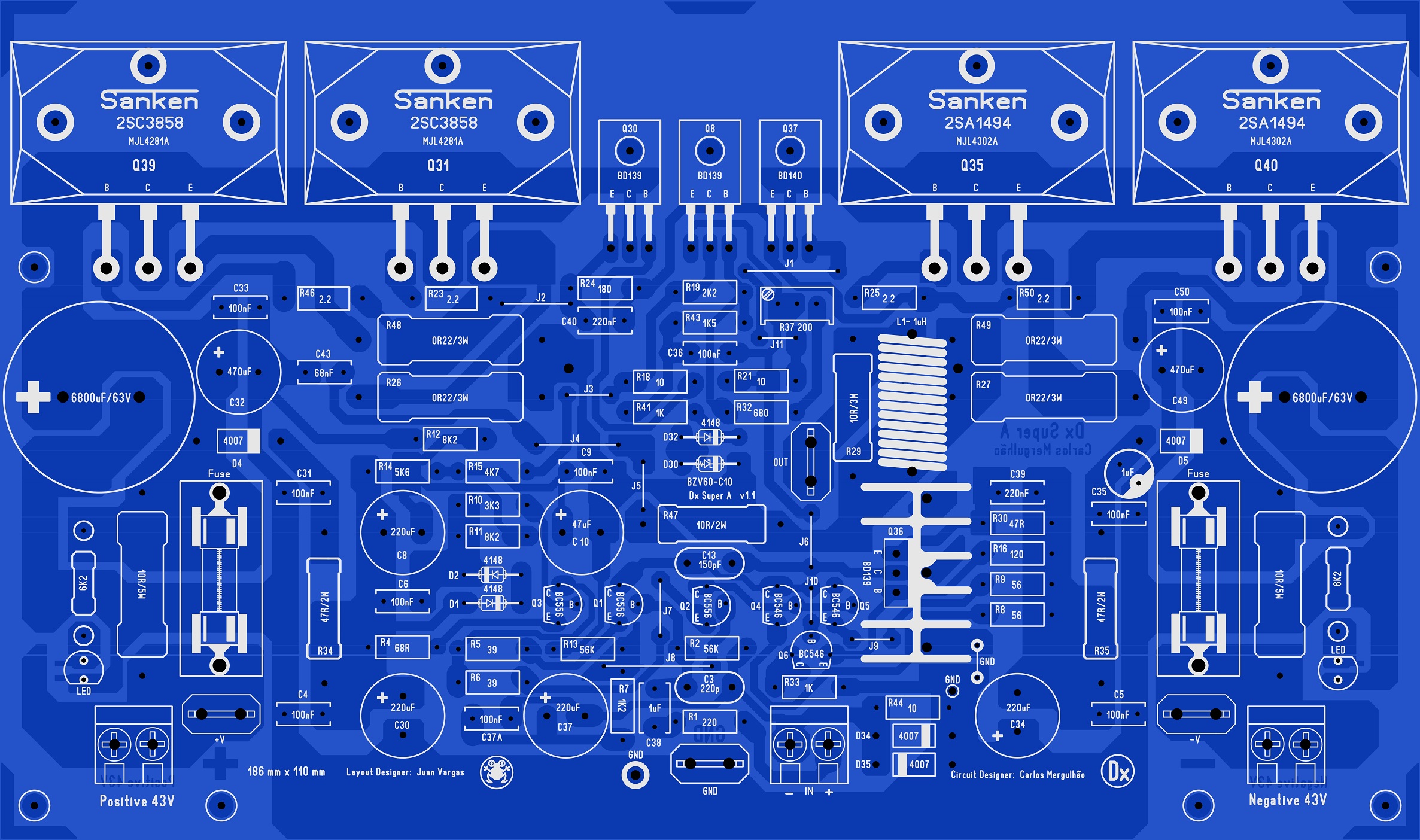

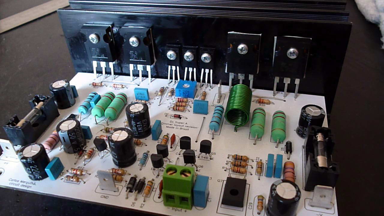

Dx Blame ST together Dx Super A
This one is one of the new models..the last DIY model produced
We still have pcboards...not only Zimmer has but also Juan Vargas ordered new batch of boards.

That is really nice, I bet it sounds really good, offset is very good too, really low, what layout is that ?, also did I see larger Sanken transistors there ? I don't remember :)
Regards
Juan

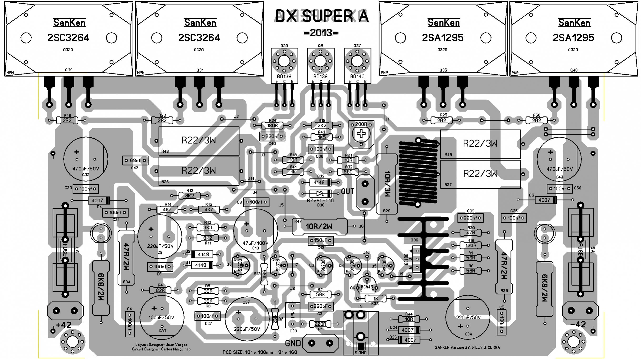

The output transistors are Sanken (2SC2922 & 2SA1216).
The design of the printed circuit is by Willy B. Cerna.
Regards!

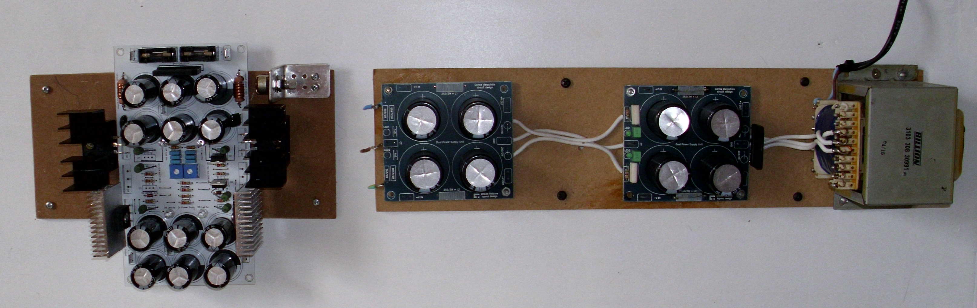

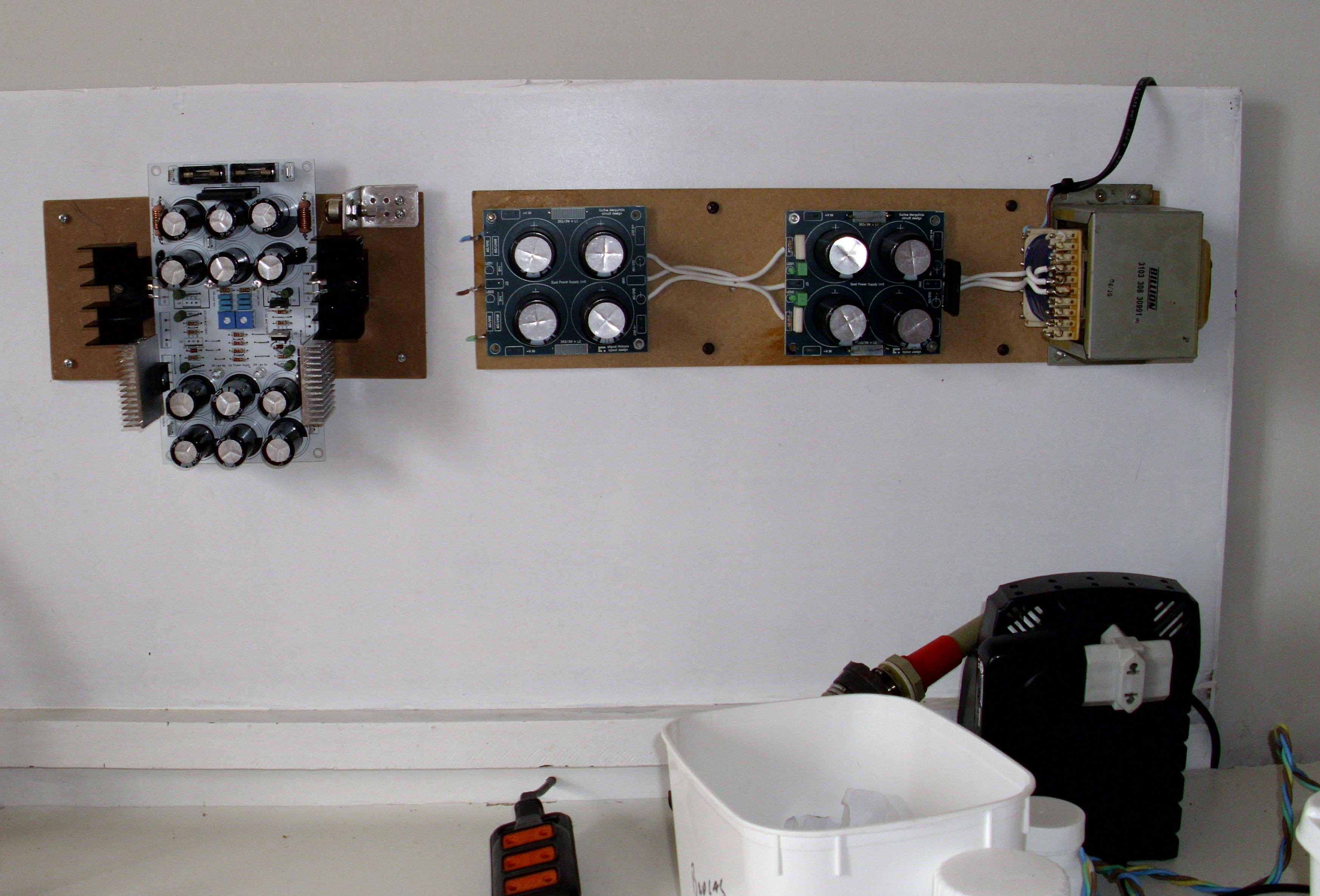

Here you have my supply, the Dx Supply installed to operate in my workbench
Dx Supply installed into my workbench vertical panel...out of the way not to bother my work into the horizontal flat table top... it has voltage adjustment from plus and minus 12 volts to plus 48 and minus 48 volts (5A+5A)...it is adjustable as you already understood, stabilized within 1 percent with electronic filtering (capacitance multiplier effect) to supression of ripple.
Not finished to run cables..i am thinking to run cables from behind the vertical panel...not decided yet.
regards,
Carlos

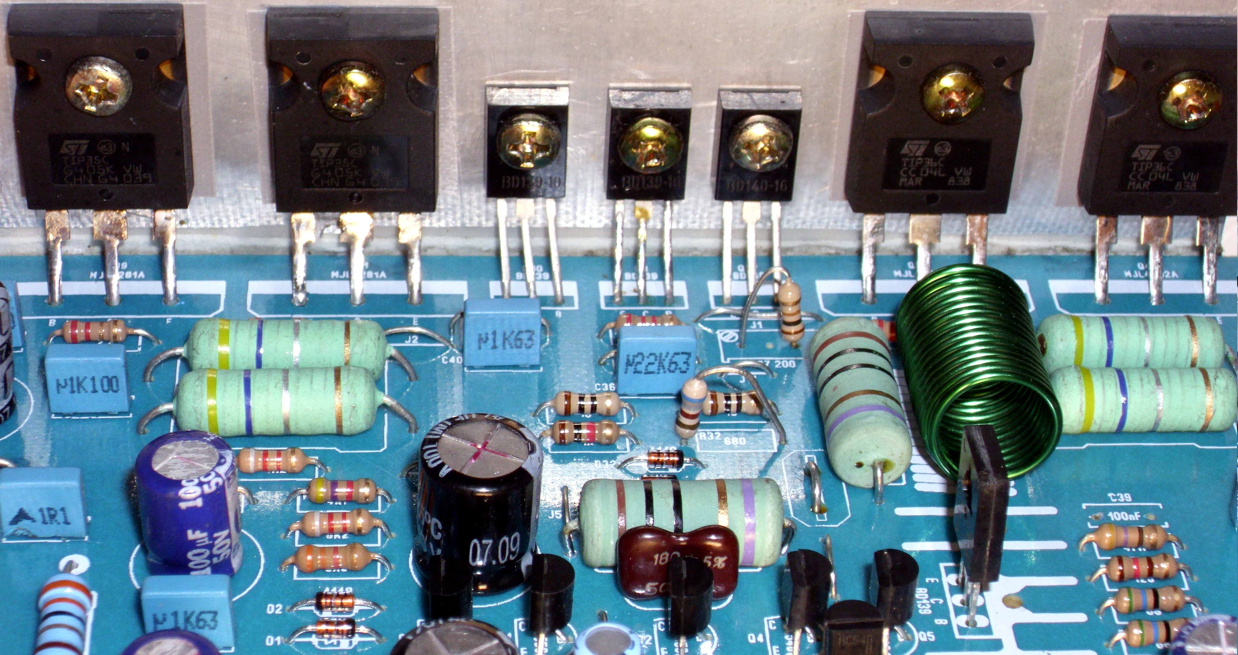

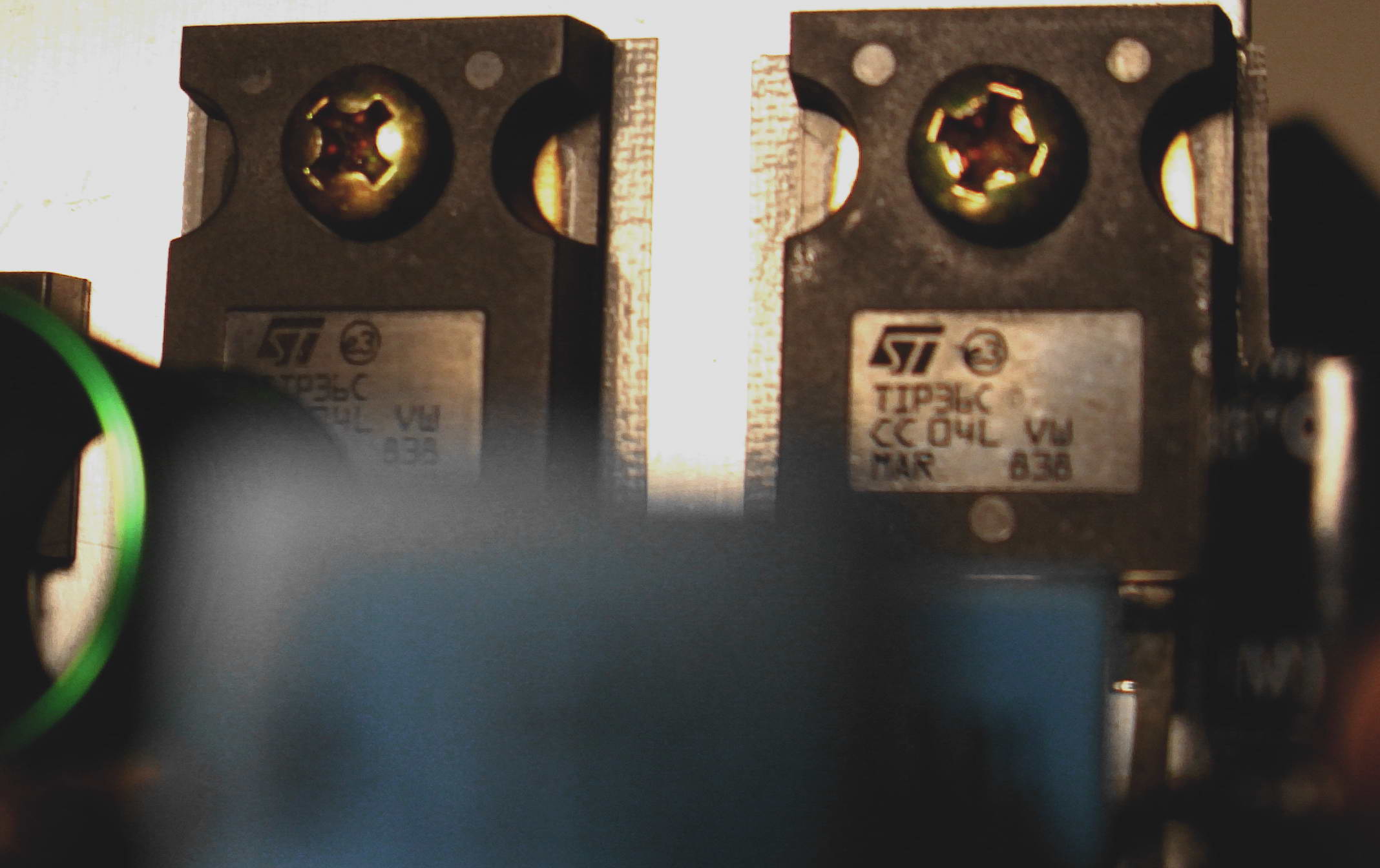

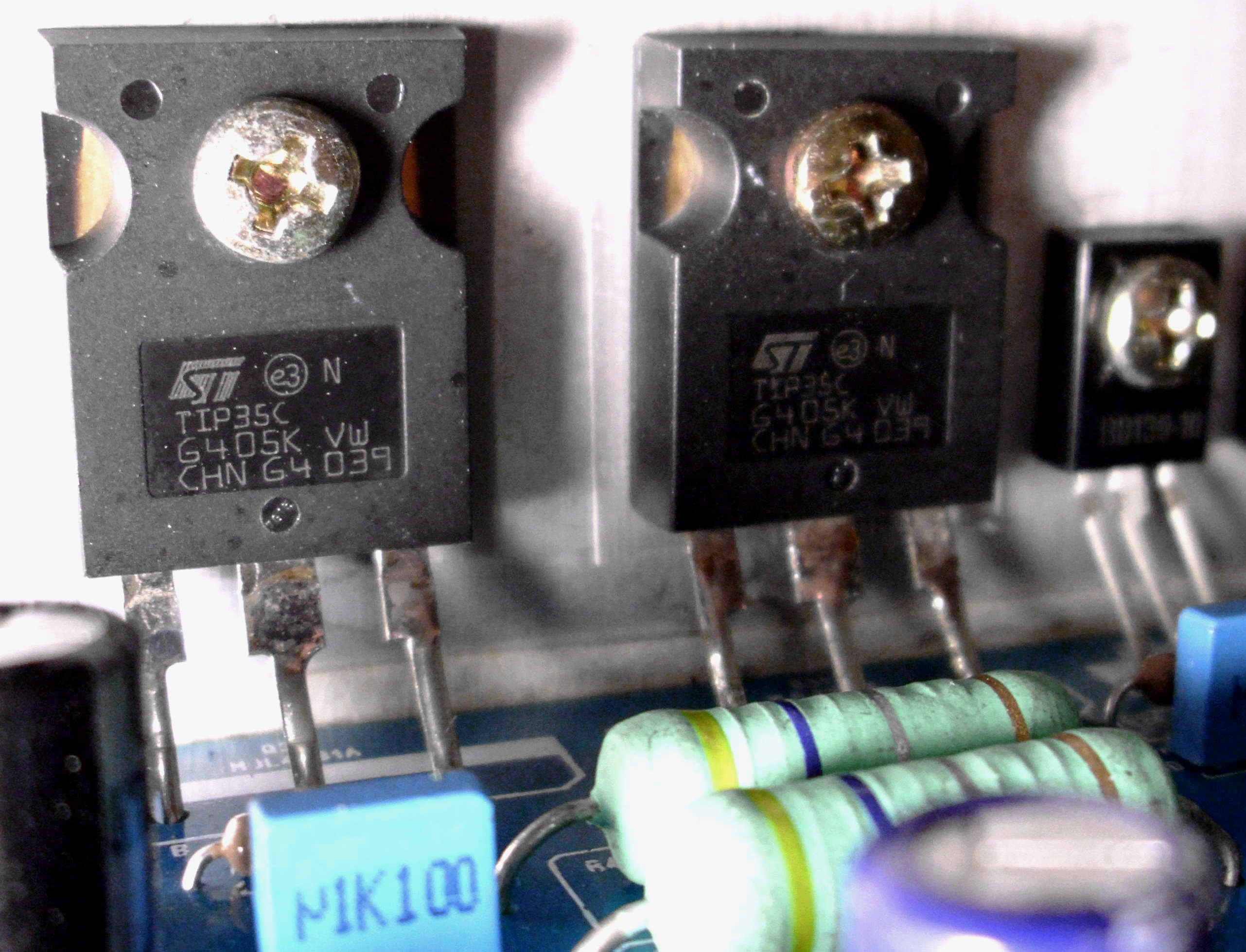

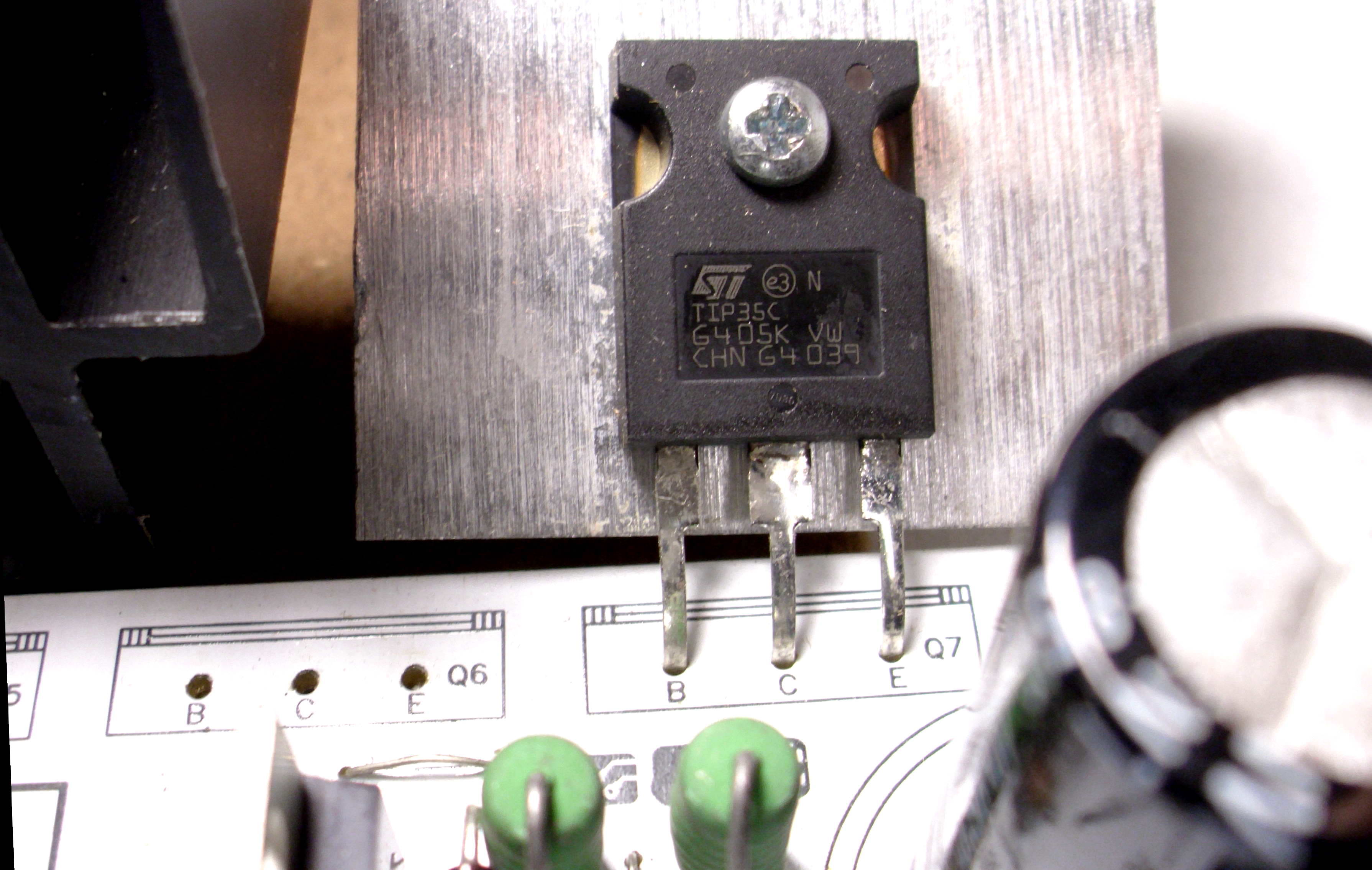

Is it possible to use TIP35/36 Instead of MJL3281/1302 for DX Super A?
I check and actually yes, I'm not sure about performance using those power transistors :) but they are really cheap a dollar and some change on Digi Key Digi-Key Part Number 497-2609-5-ND

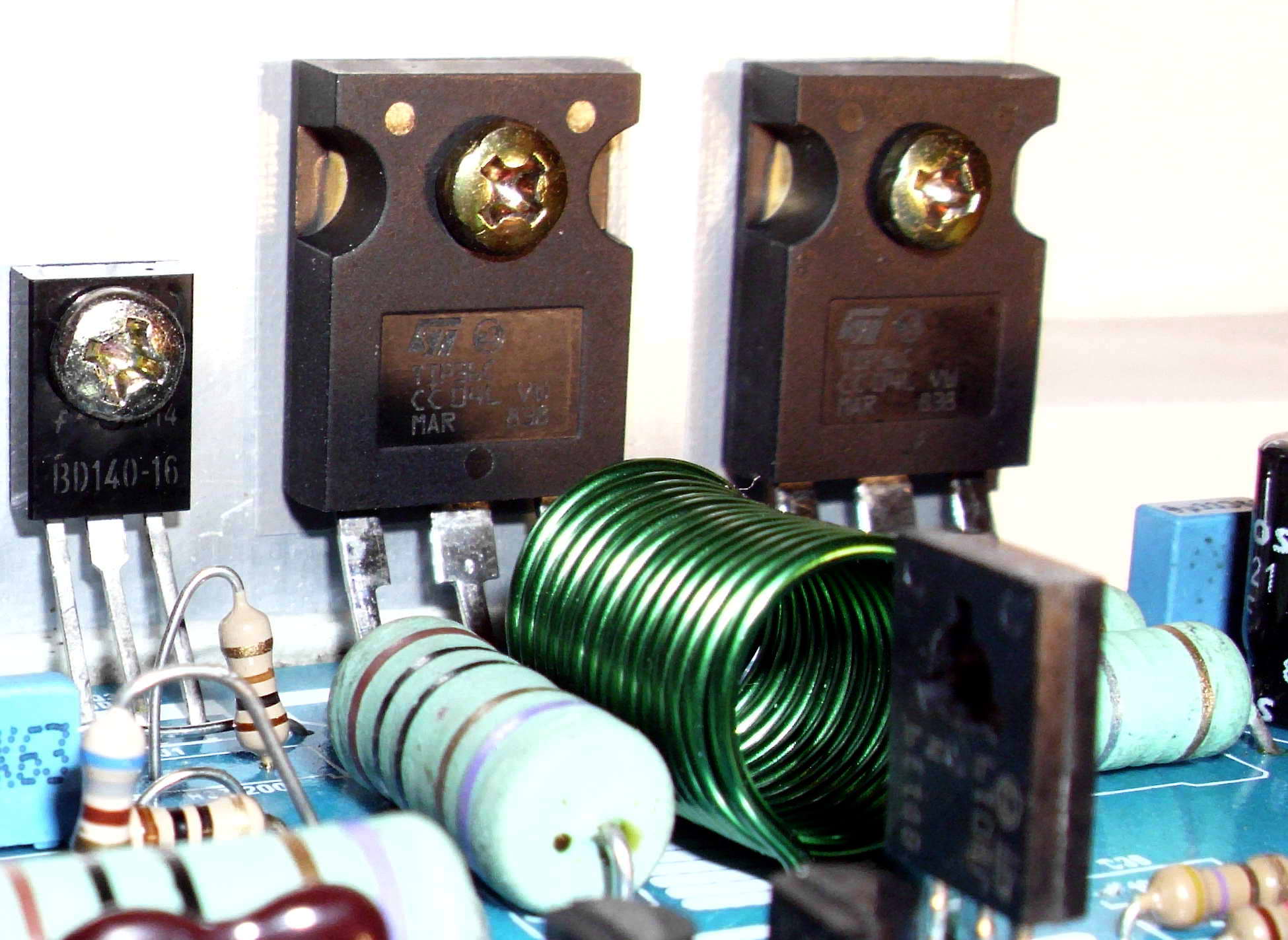

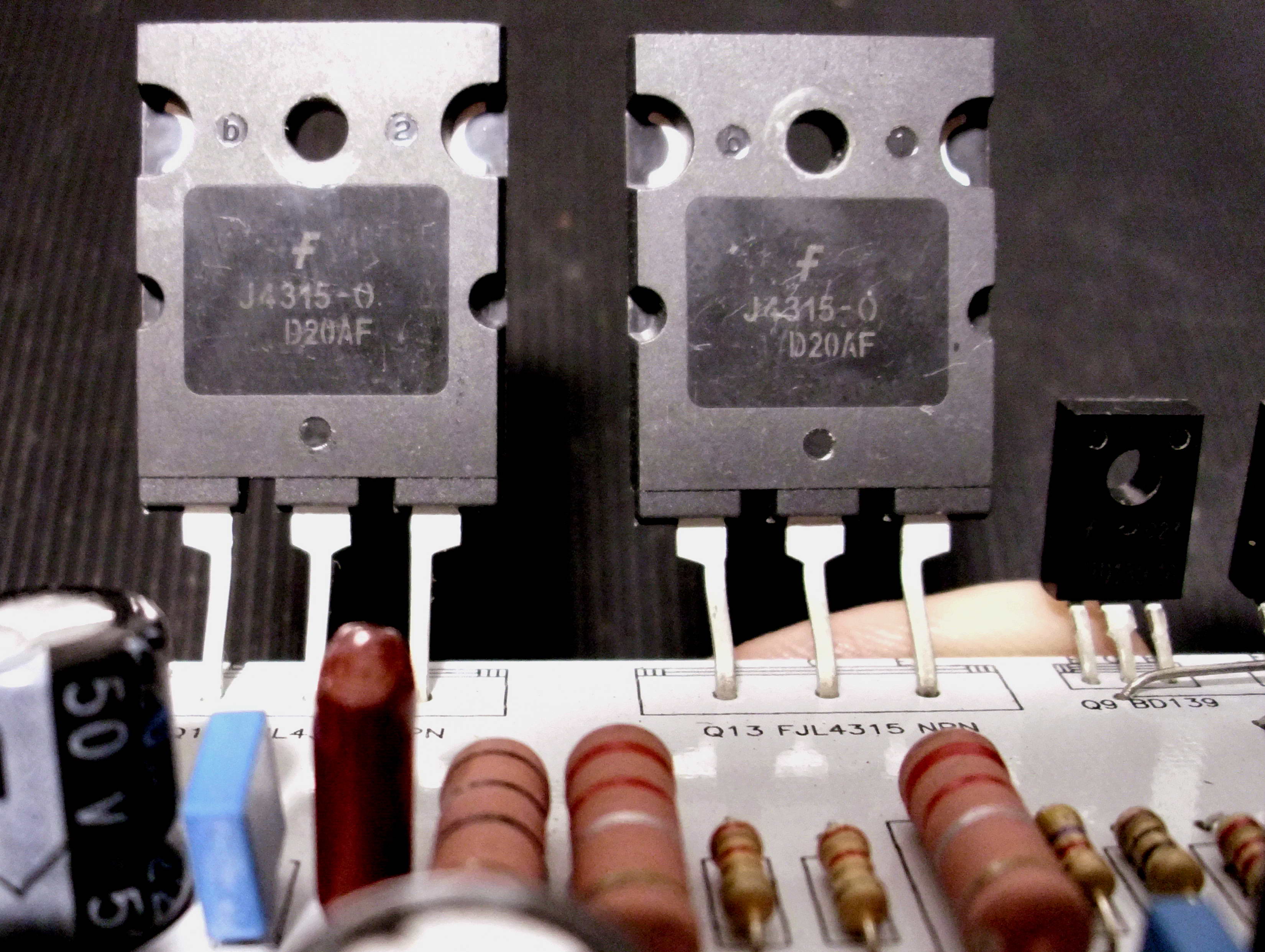

Yes...we are using these transistors in Brazil
I do not think you can go to 2 ohms and very high power due to dissipation limit....they can go maximum to 80 watts each one of them because of temperature. (derated)...so... 4 units represents 320 watts.... 60 percent of that is audio..so...you can go to 4 ohms..but not to 2 ohms.
We use them.... hundreds are using them here in Brazil..they are good, they are cheap, they are fine....the trouble is the capacity to make heat transference..this is the weak point of these ones.
4215 also used...sorry by the pictures.
