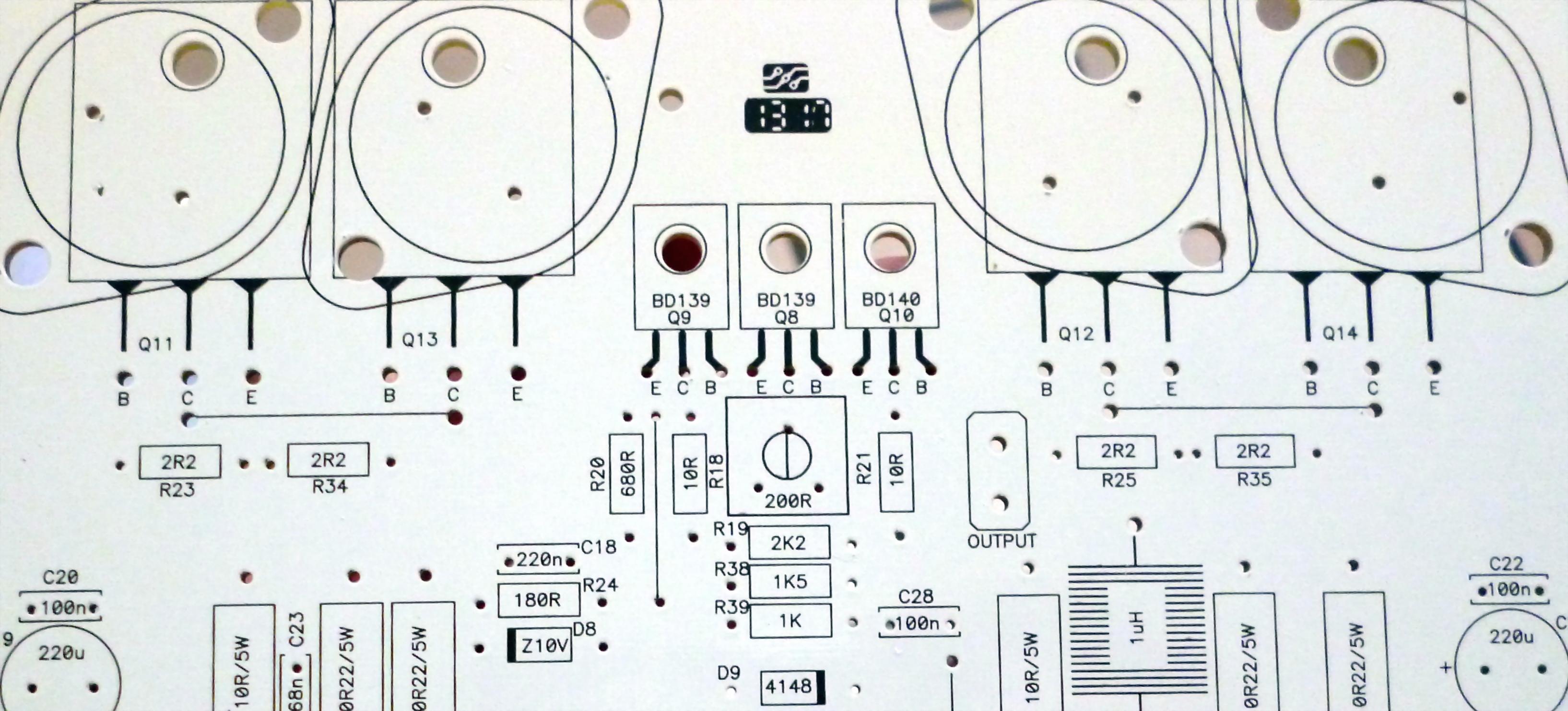

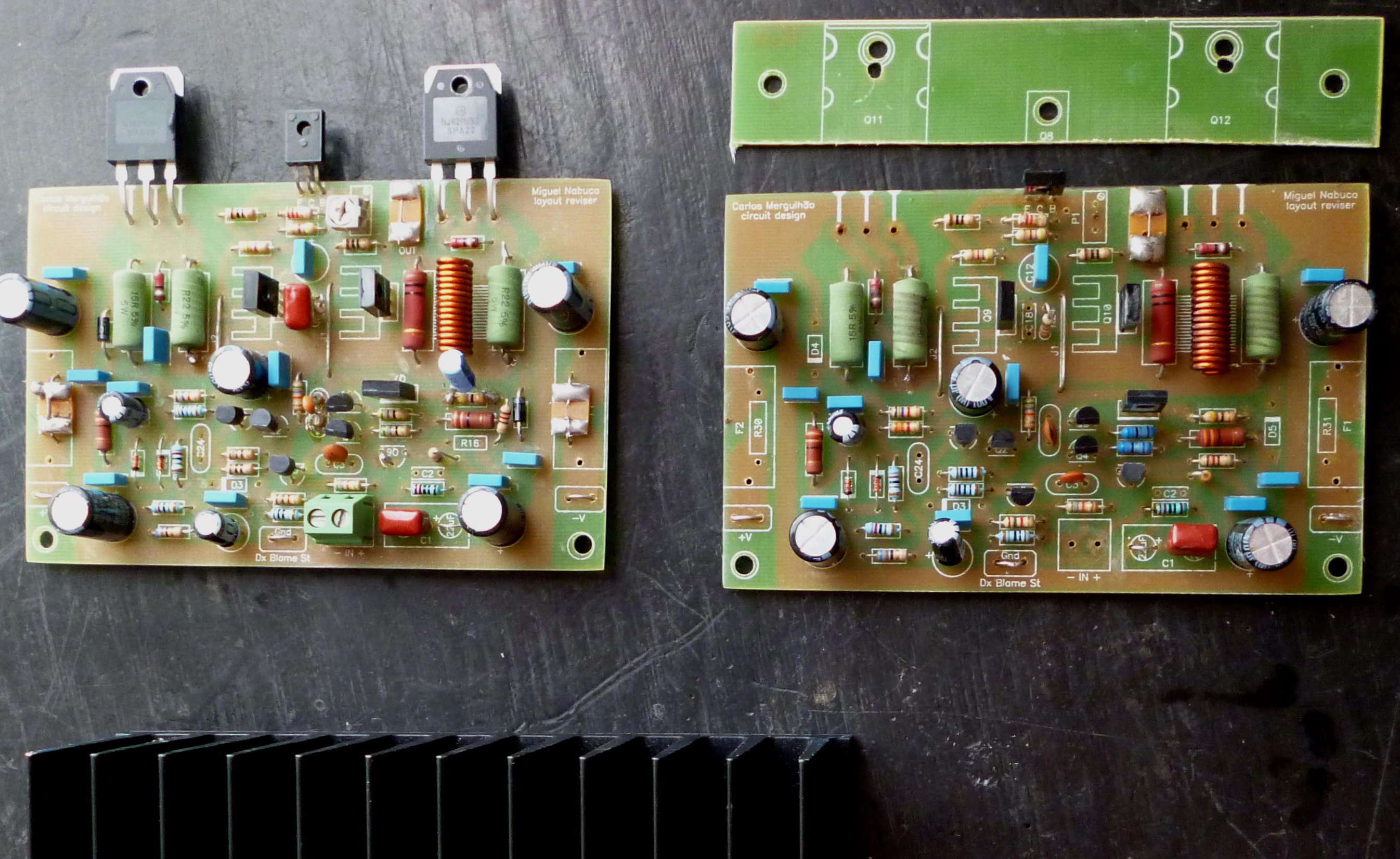

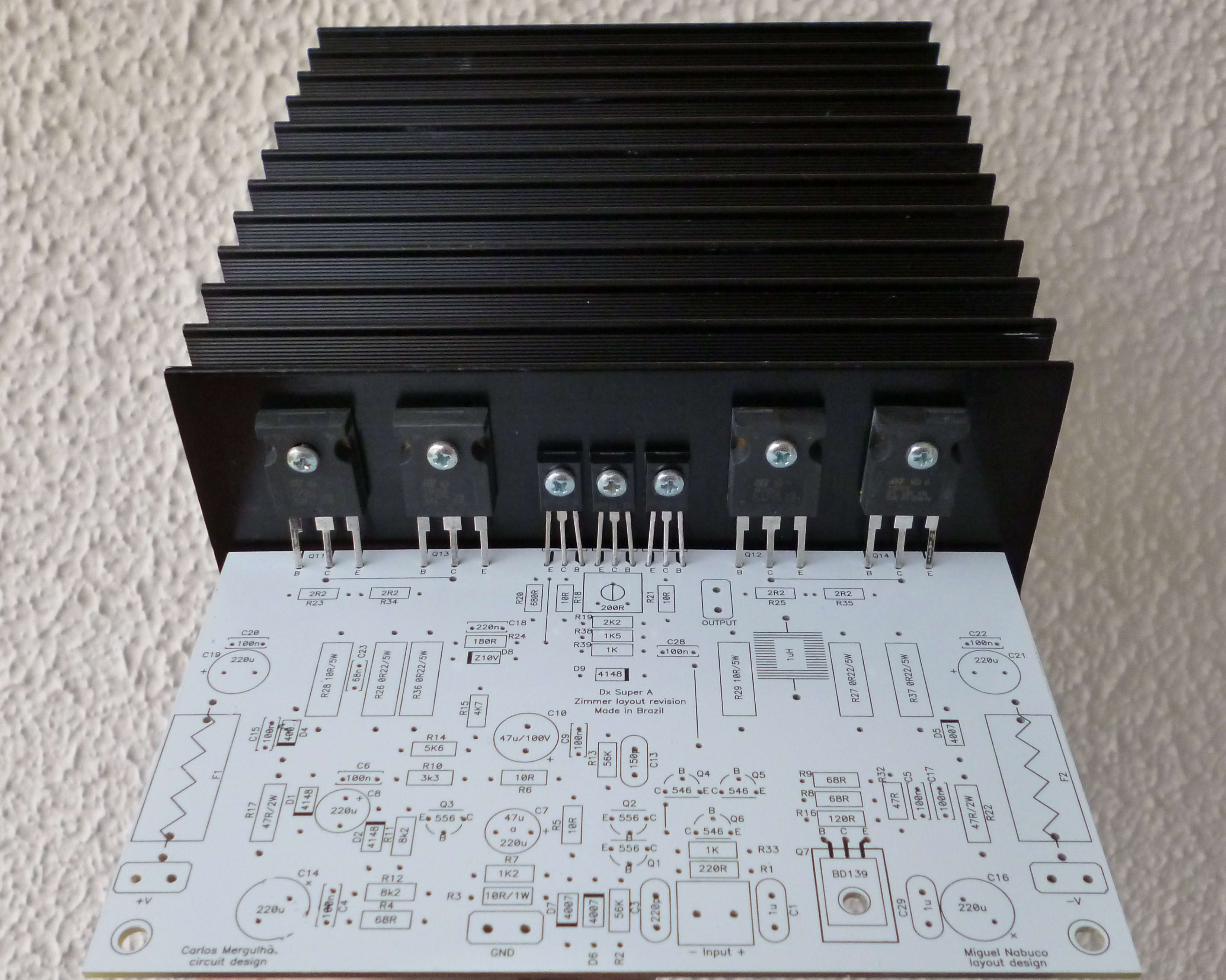

I am suggesting my people to cut the board (saw) this way
My mistake not to forecast this stuff before.
Since the Supercharged, and them the Dx Blame MKIII and some other models...Dx Blame ST included...i was already cutting this piece of pcboard off...i cannot understand my dumbness.
regards,
Carlos

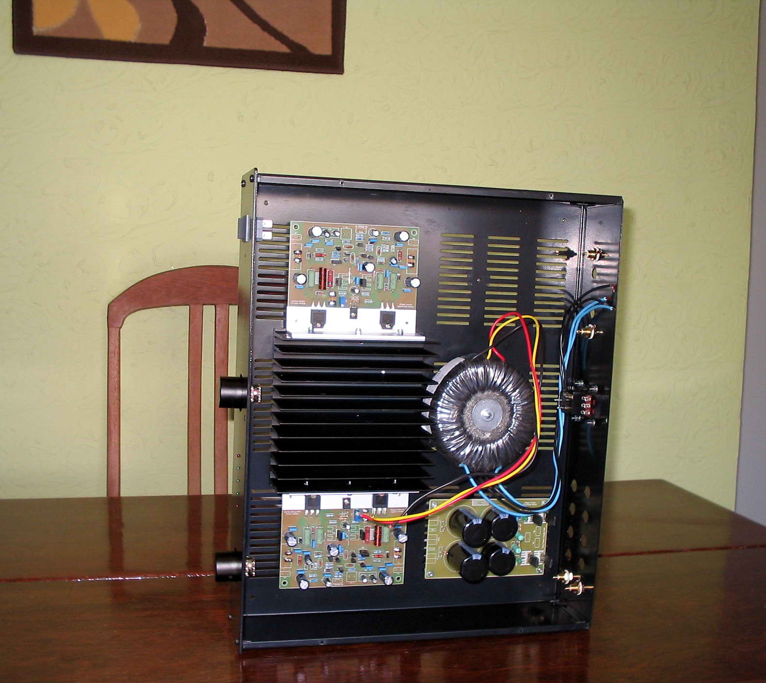

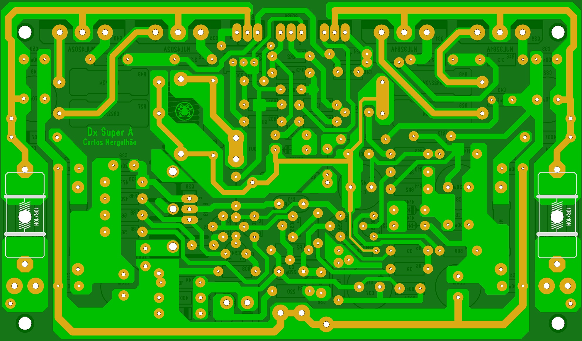

Very nice Carlos! But Why didn't you put the heat-sink on the other side. I think the way you have it now will not dissipate heat too easily since there is a small thin/short blade holding ALL the transistors. I think it should be better if all transistors are mounted on the bottom (thick side) of the base of heat-sink. I hope I get myself understood...:eek:

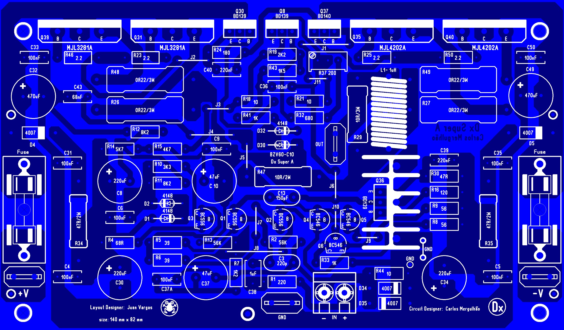

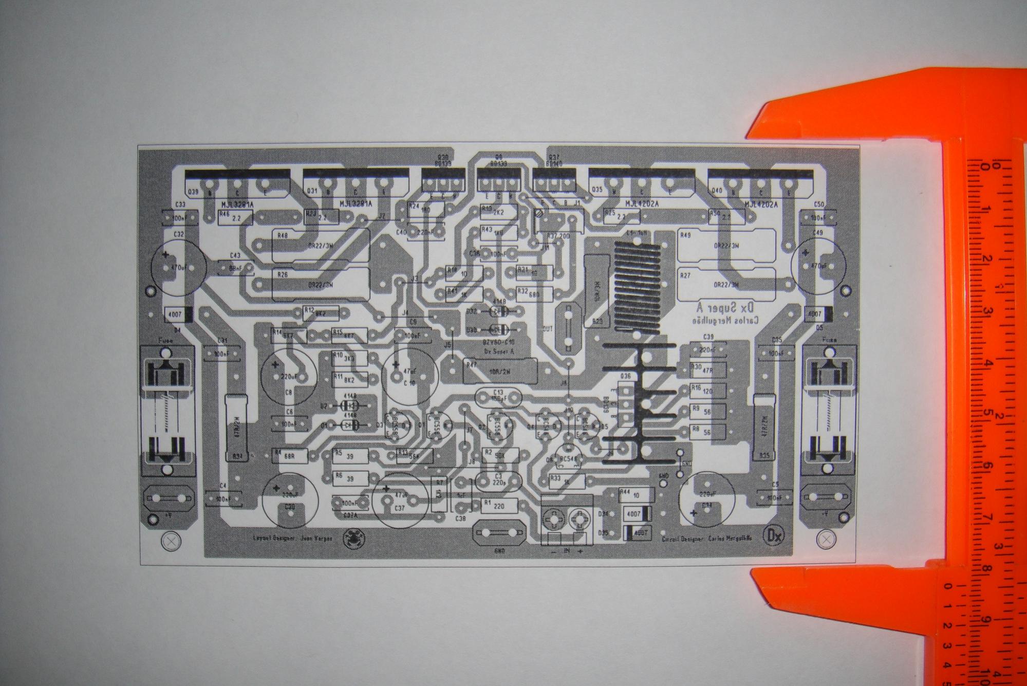

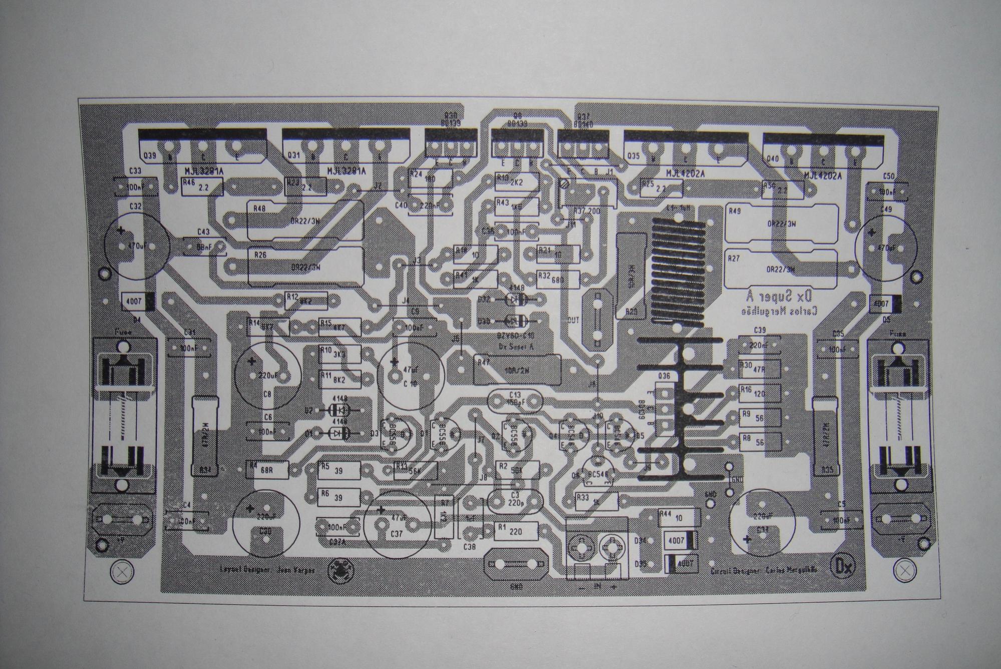

I'm in a progress of update Dx Super A with a "no L shape" do not worried I still have the original gerbers from the original first design in case people like the first version still but here is guys I have to check if all is correct before, here is a print out just to see how it looks . :p
Regards
Juan
I have tested Lanchile.... this way is a little bit worse
Just a little...but this is a very long story...a video explains this in portuguese only.
Here you have....give a try to see if you understand me:
http://www.youtube.com/watch?v=5A0R9SLuj_I
This way is better to me, then i can install two amplifiers along the enclosure and pump air from the upper case....another long story.
regards,
Carlos
Juanito..... having time, please send me gerbers to my files
This gonna be the standard pcboard layout from now on.
We are reducing the Brazilian layout too...transistors must go directly into the heatsink to increase thermal transference.

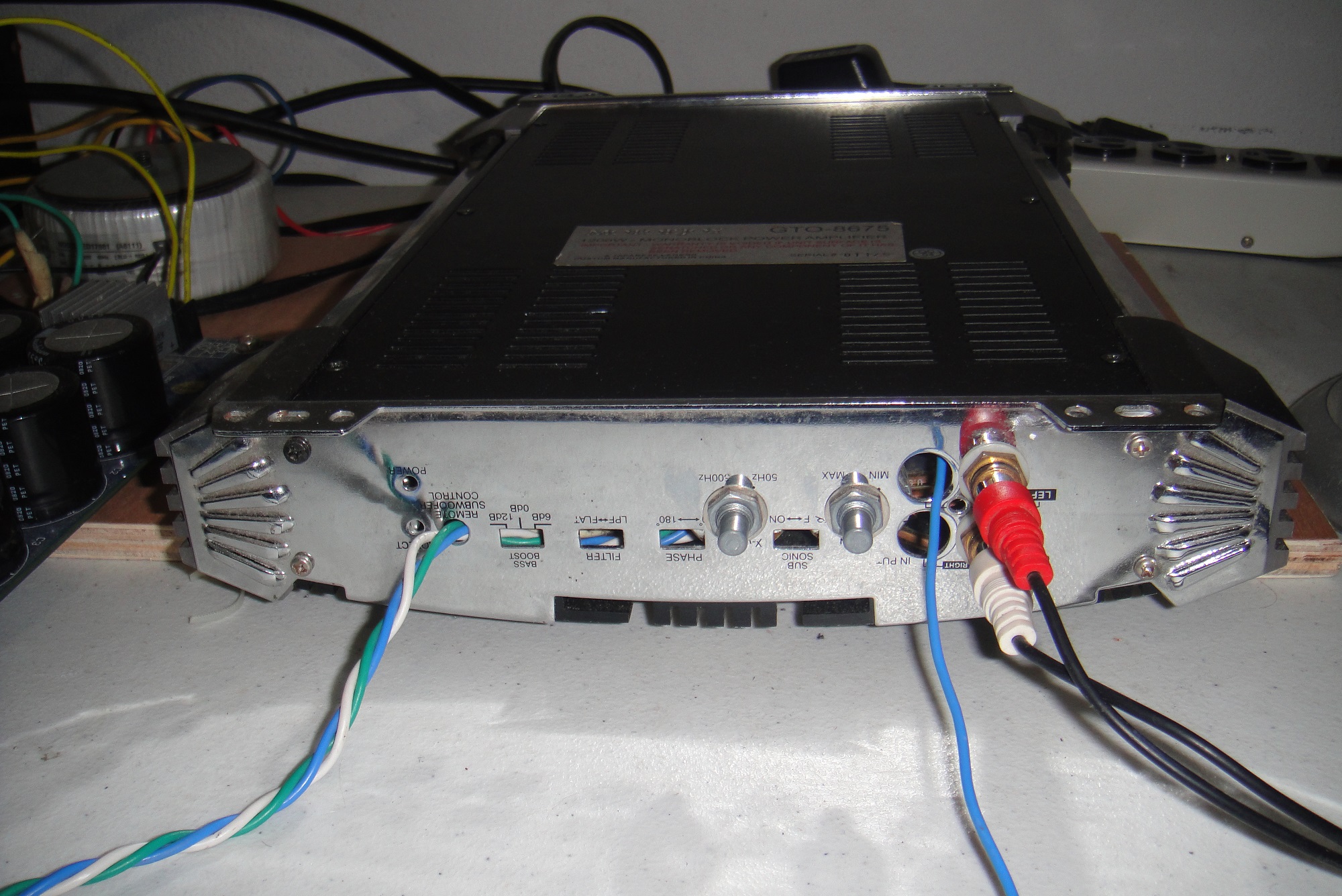

Wow that is amazing ! I never thought that his boards arrive a few days ago is a miracle I'm really happy he got them "late" but he got them man this is special for me I know he will enjoy that nice sound notes I still using my Super A inside the car amplifier chassis looks great! Carlos I'm going to send you the gerbers today let me check to make sure is symmetrical correct :D. this is Super A Amplifier of Steel . :p
Regards
Juan

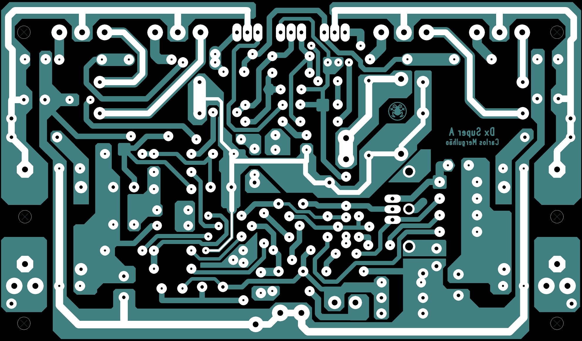

Last updates on Dx Super A
Now that we have made the board even smaller, now we have copper track reinforcements for better current travel into important areas, I hope you guys like this :D .
Regards
Juan
