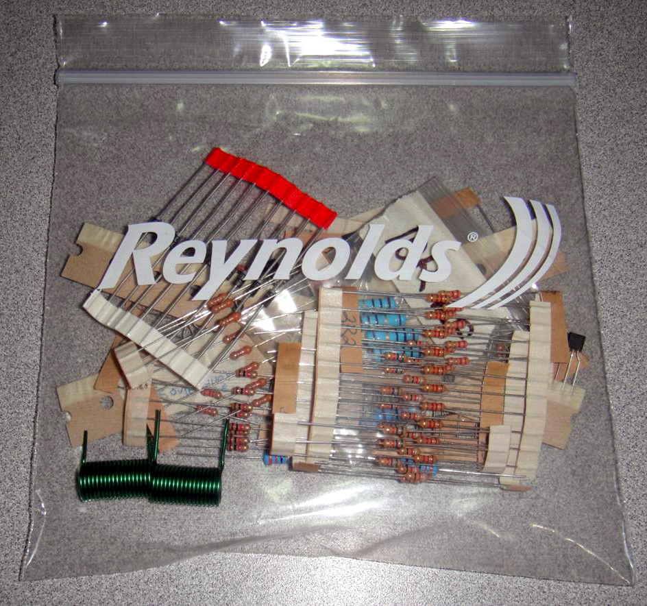

Juan have prepared a gift to me.... a kit of parts
He is waiting some power resistors from his provider and will ship these parts to Uncle Charlie.
This is kind...this is nice...this is friendly.

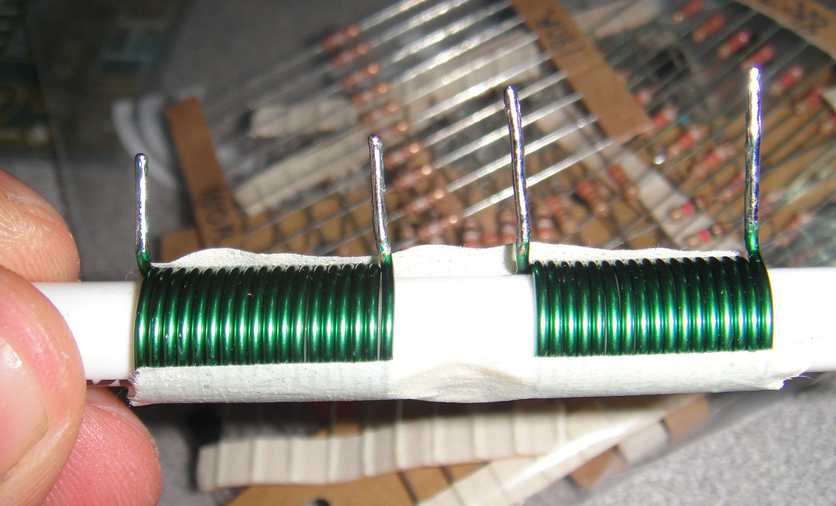

You see coils he made using his bare hands and a pencil as a core.... we have no green enamelled wire in Brazil... despite we have a free importation harbour inside Amazon Jungle, town of Manaus.... where you have river Amazonas.

Yes dear Carlos probably today I might get the package from mail and I send you the complete set of resistors and the coils I already prepare them and thin them too.
I made a quick video updates of my build so you guys can see it too. here is the coil thinned, is that the right word?, I apologies my poor English.

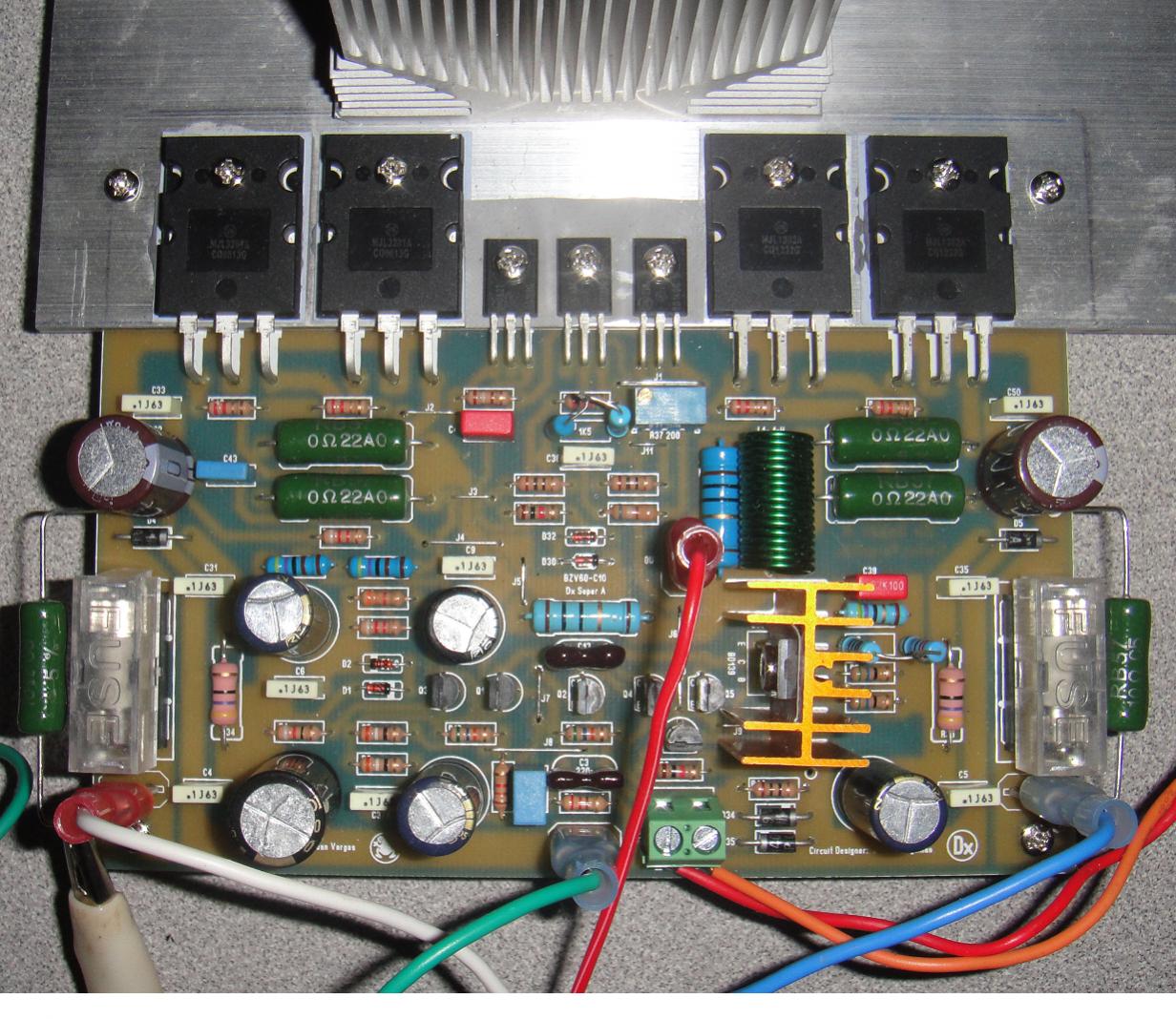

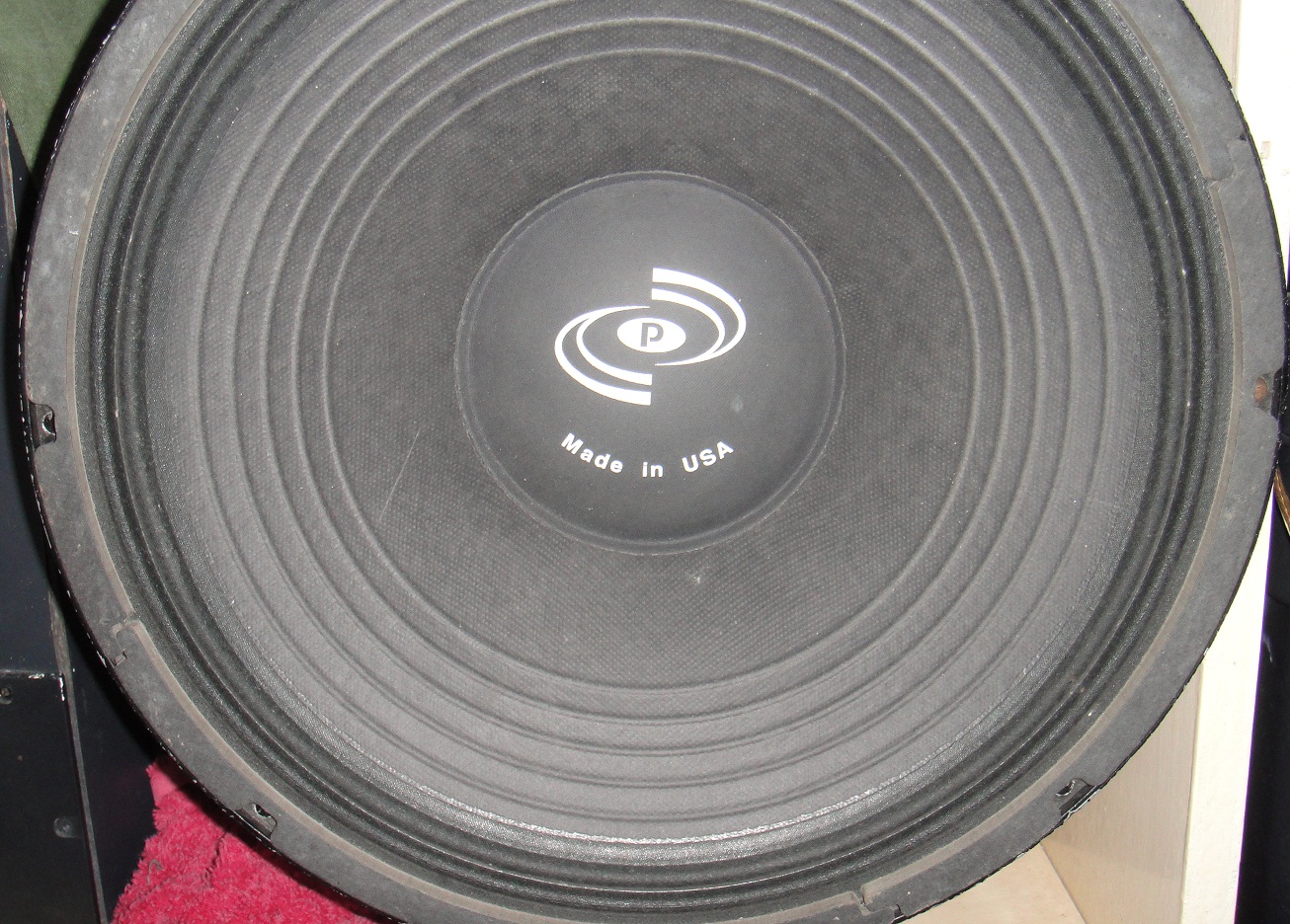

India, Brazil, Puerto Rico, Canada, Portugal, we need one more guy or girl, I still have one pair left one more country are welcome to Dx Super A, I'm not doing this for profit and I'm poor but I do not announce that for that purpose, money is not that important for me, "is need it of course" but I just want to share, but I also need to compensate the payment I did on the order big order I made, also, I can wait to see mister Carlos boards!,well, today I was really busy but I might continue with the other board putting together all the components, and then adjust the bias "standby current" to 2.5V, I know I don't have lot of money to get the chassis for it :( but I'm just happy :Dthat I have it, accomplish and I'm really proud for been part of it, maybe in the future I can make that happen about the chassis. One more note: please do not think because is Class A that this does not have power, yesterday I was playing loud music specially low frequencies and my 15" woofer was pounding really hard and is a beast of woofer!, do not underestimate the size of Dx Super A!, be careful with the volume, I have an image of similar woofer the one I use I have an older model [200 ounces magnet 4" voice coil]. Pyle Pro 15" 1000 watts. and a picture of the older Pyle Pro 1K watt. well guys have a great day.

I see...you have already keept 2 boards for me or Meanman
These are special reserve...i am lucky Meanman have not bougth it...heheheheh..so...they gonna be mine...yessssss!
It is all rigth to sell the other ones you have...i thought your were selling the special reserve.
I am waiting postman to bring the first two units from you....i am already searching for parts.
Go ahead to sell to one of these guys that presented to buy the last available ones.
