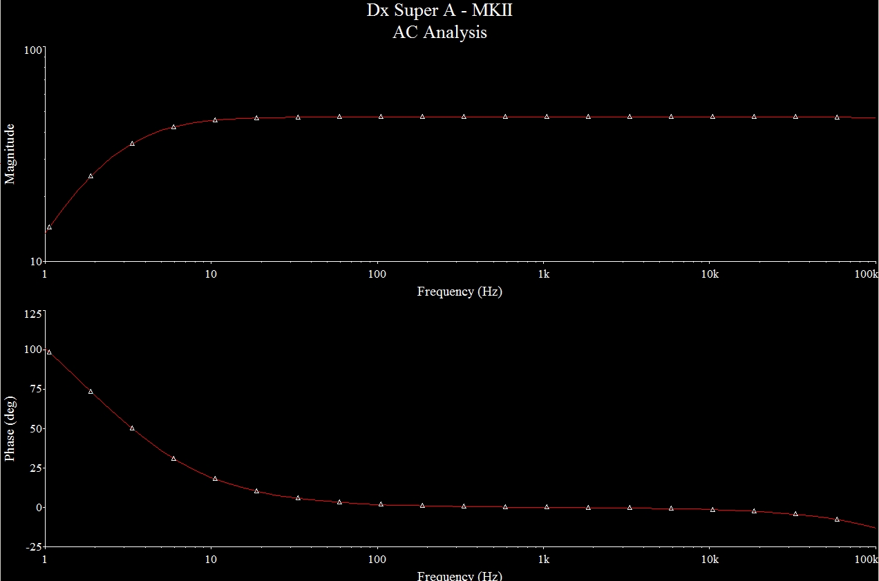

In the simulator it is perfect...or almost perfect
It is flat from 5 hertz to much more than 100 kilohertz... sinusoidal waveform starts to become triangle around 130 Kilohertz ... when you inject sinusoidal and observe it full power on the scope screen.
AC analisis and fourier analisis perfect too.

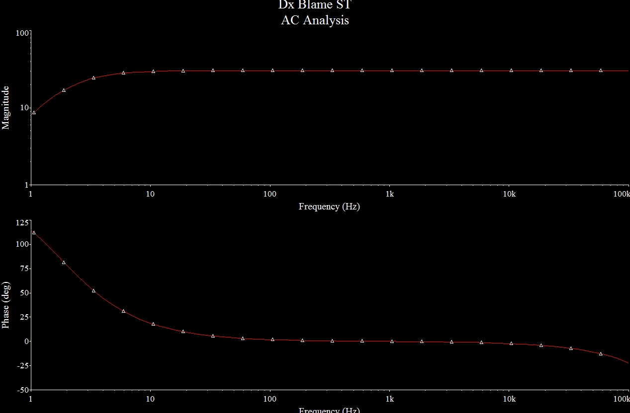

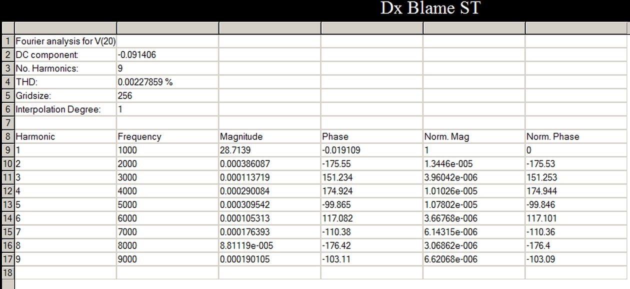

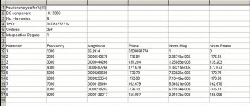

I am glad to inform you, dear friends, i have finished the Dx Super A - MKII tuning
into the simulator...now i will tune it real life (very different).
At the simulator it is glorious, unbeatable, awesome, super, wonderful and marvellous... and what this represents?....nothing!...numbers are just numbers...BUT... feed the believer's soul with strong faith.
Well...all i want was to reduce third harmonic compared to the second harmonic....another targed was to reduce it when compared to the Dx Blame ST, that is (WAS) the best ever made, wide world, audio amplifier.;)
I will post a chart and a graphic from the Dx Blame ST
regards,
Carlos

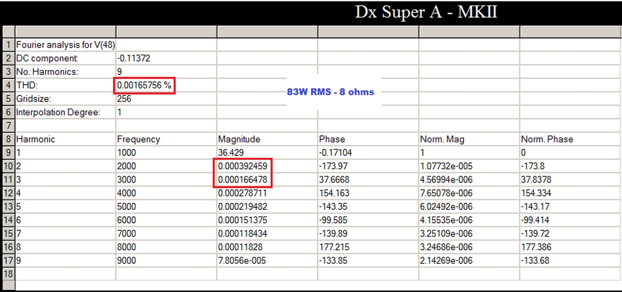

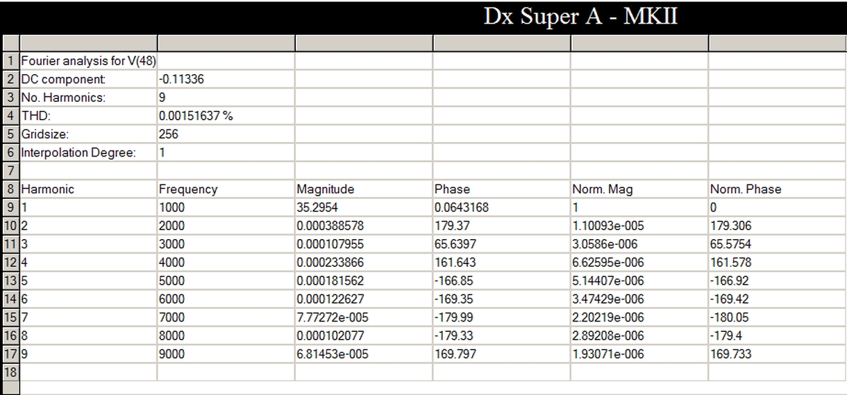

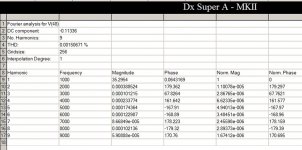

What i had in the first moment, before i have tweaked
I am posting images from the Dx Super A - MKII before simulator tweak.
Observe the small difference from second to third harmonic...this pollutes the sound a lot....not a good result.
regards,
Carlos

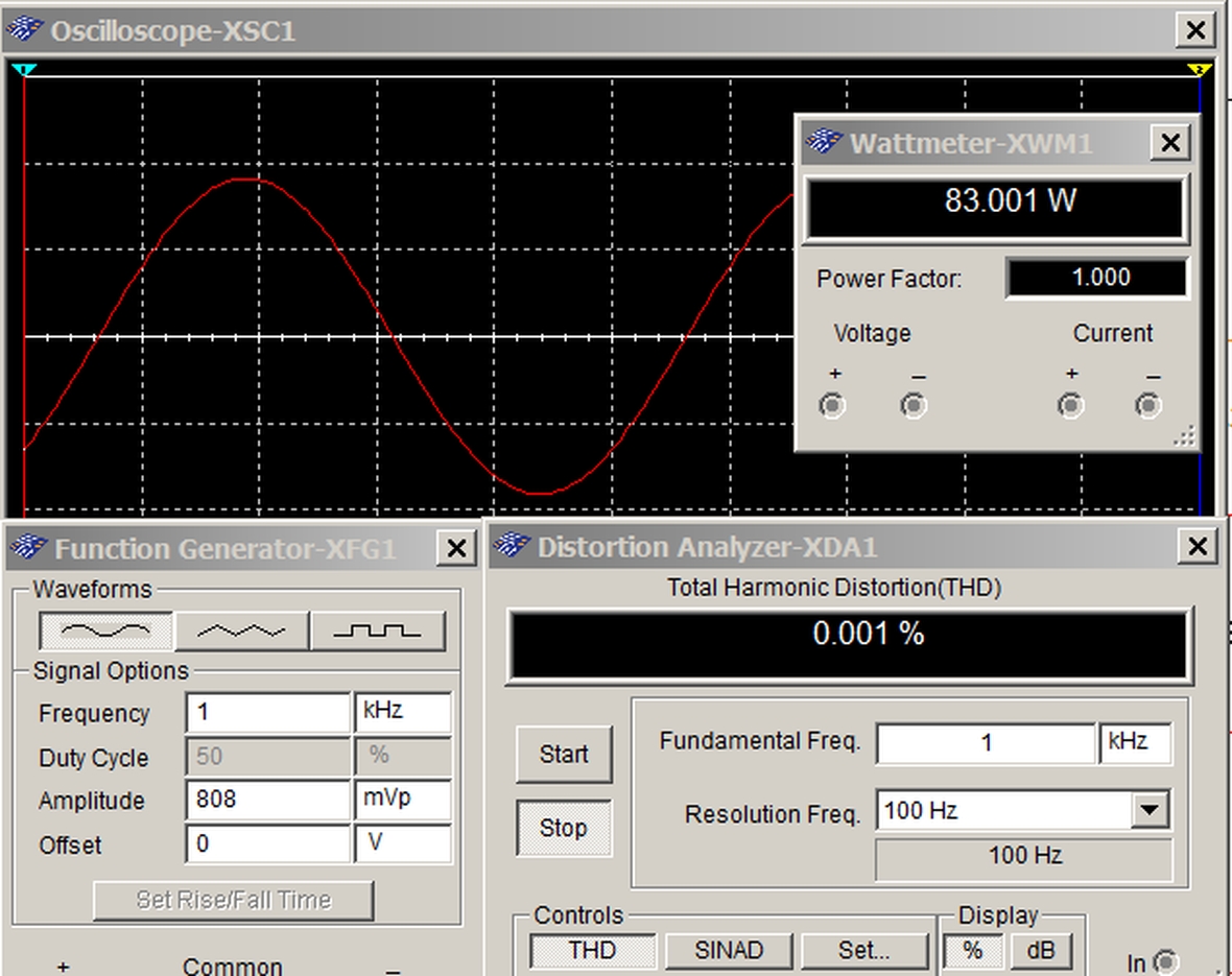

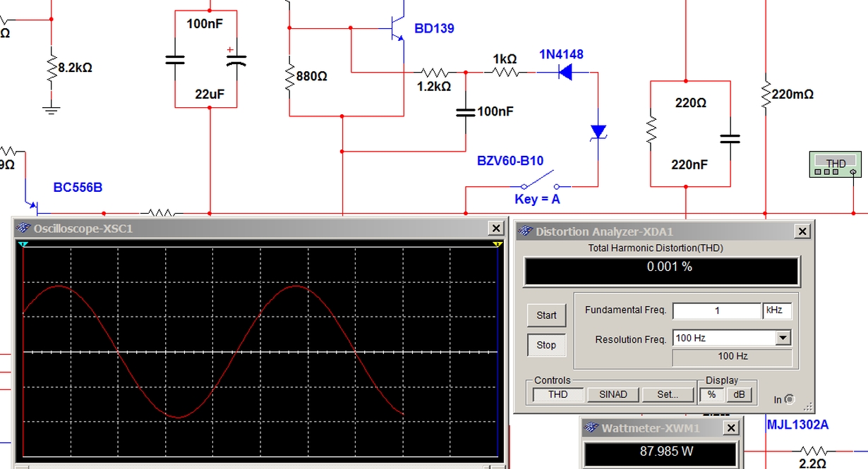

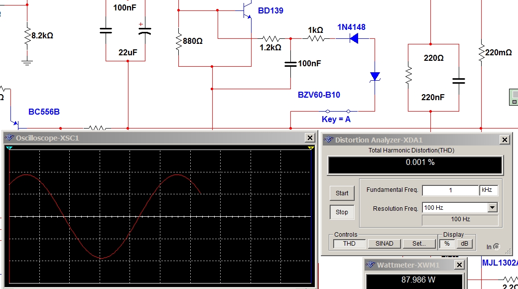

Here you see two images...one with Super A circuit ON and the next one with
circuit Super A OFF.
You see it is not messing the results..we can use it on.... to put a switch into the pcboard ( i will arrange the together Juan Vargas) or to put wire jumper if you decide to use it ON or OFF permanently.
You see...the different when it is on and off does not appear in the THD meter.... because very small.

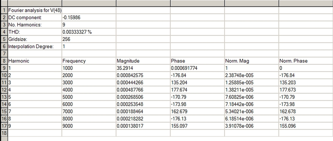

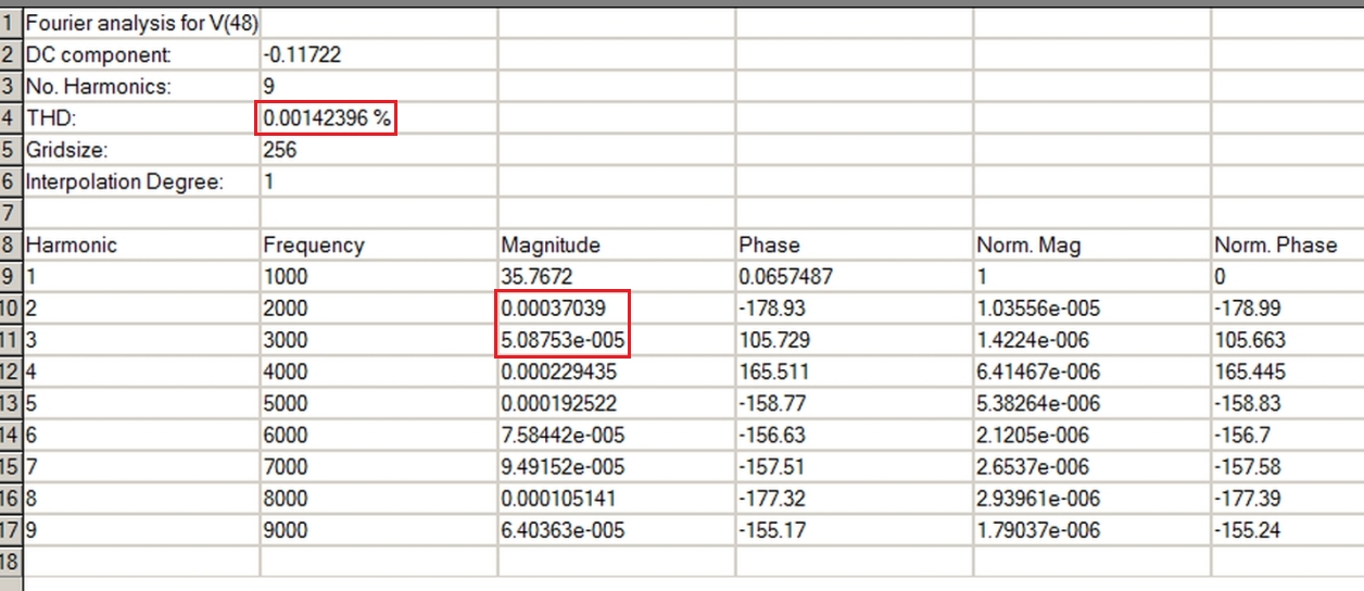

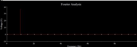

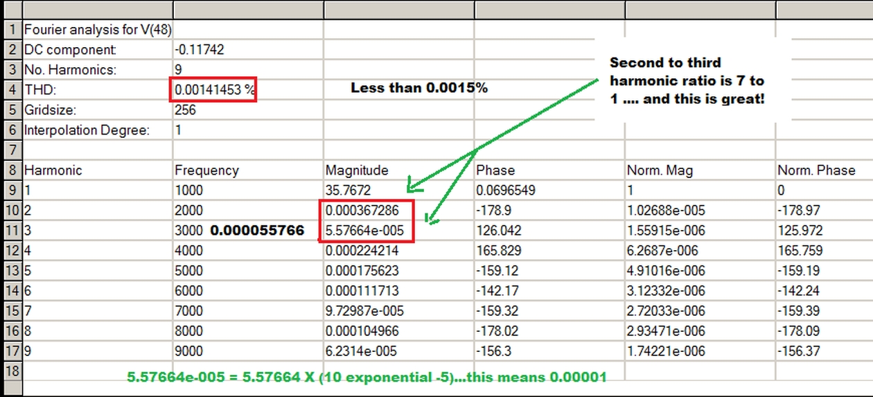

Now a days, performance is almost unbeatable.
Watch the third harmonic folks...... this was discovered tweaking...values are not exactly the ones simulated.... i found sound much more clean, then i return to the computer and i found some modifications could reduce third harmonic.
The most interesting is the input capacitor...if you install 1uf your harmonic your third harmonic goes down...if you put 2uf in place..then become the hell on earth.... very sensitive this amplifier to changes in values... this one looks critical...also to VAS current.
Is this great? ... what does this means?
- Means that due to the component tolerances you can obtain an excellent amplifier or a third harmonic generator.... means that it is hard to build two amplifiers with the same performance...means that integrated circuits, finally, show some advantage to us...their component tolerances are smaller...but also..their performance is worse...but they will be more alike left channel and right channel in performance too.
We have three to one...i can put it to 8 to 1... the ratio related second and third harmonic.
regards,
Carlos
