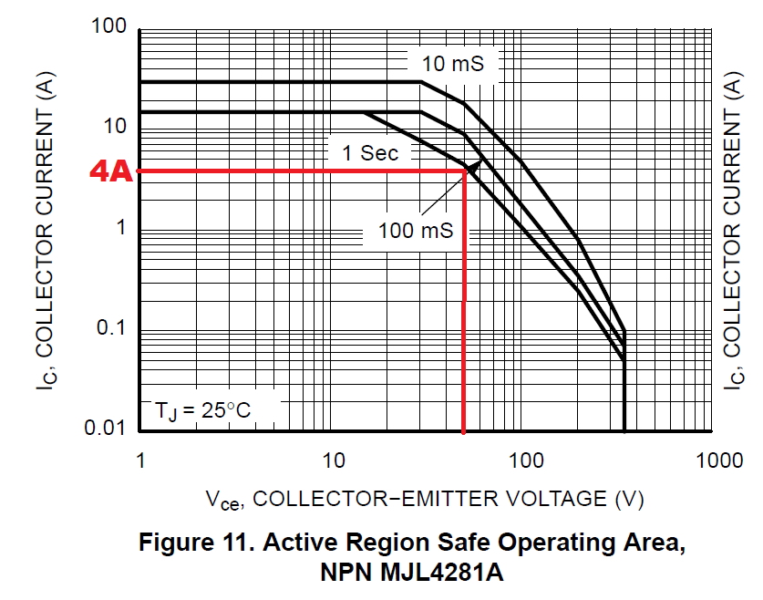

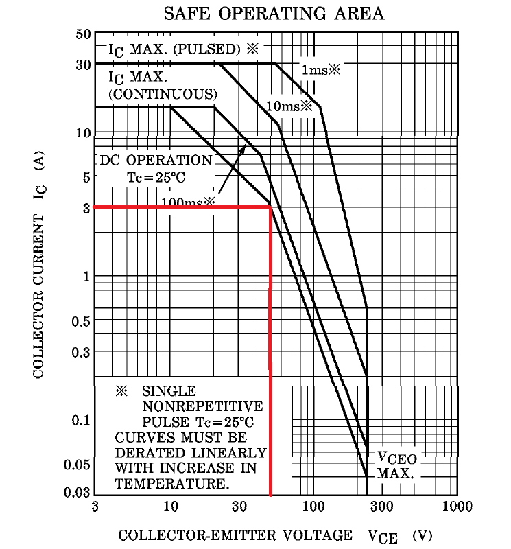

Please...for safety reasons, use MJL4281A
Watch the S.O.A and you will see that it can hold more current when operating 55 or 65 volts compared to the most common competitor.
In special this advice is for you, because you will use only a few transistors.... do not use 2 ohms...use only 8 and 4 ohms loads if your supply is the suggested or lower voltage...if higher..then use only 8 ohms.

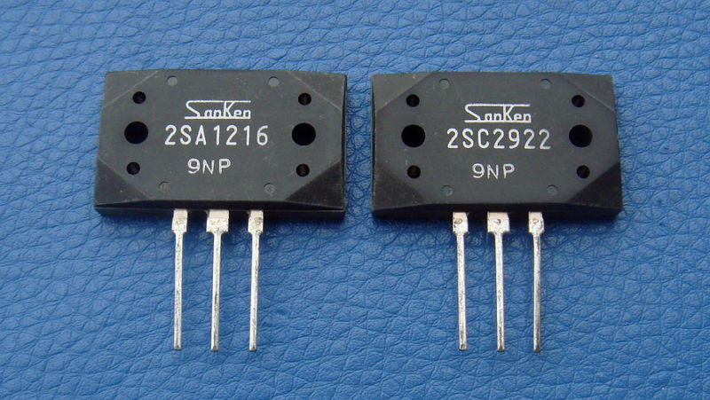

Want high end...want shinny treble..then use Sankens
here you see a beautifull MKIII Hx at one minute exactly.
I am not sure if Sankens will fit in this pcboard...maybe not...but for treble they are the best.... others are all almost the same...small differences.... MJL4281A looks to produce nice bass.... but this may be my imagination only.
I am using these transistors into my PC monitoring amplifier...the treble cuts the air alike a razor..alike a lash of a whip... fast and precise....lovely sound.

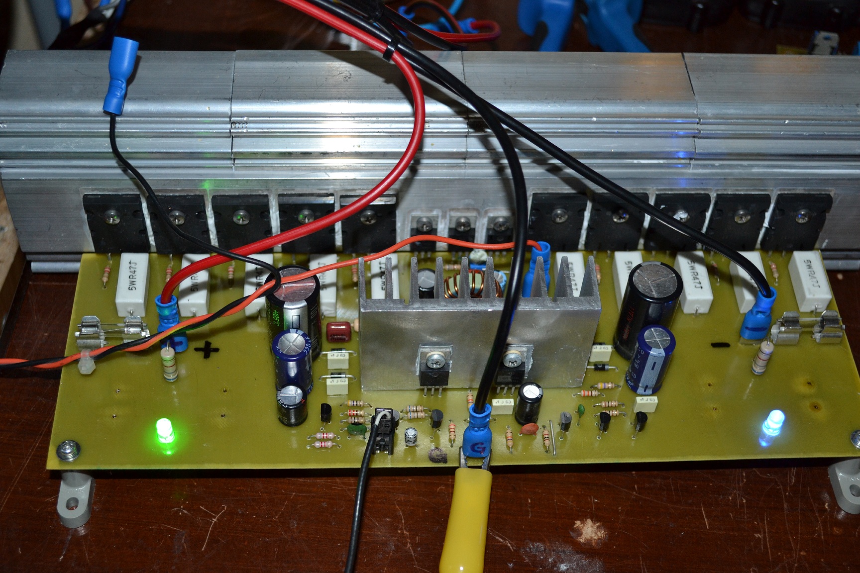

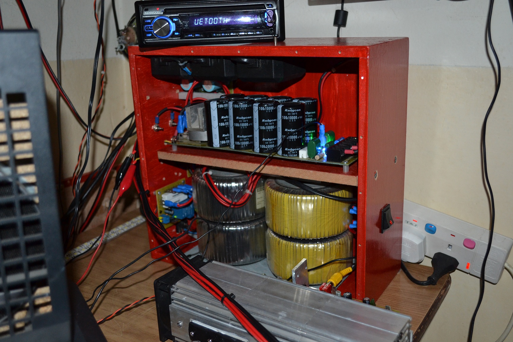

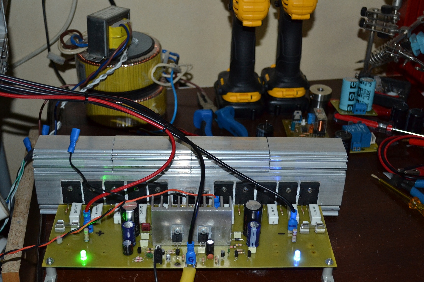

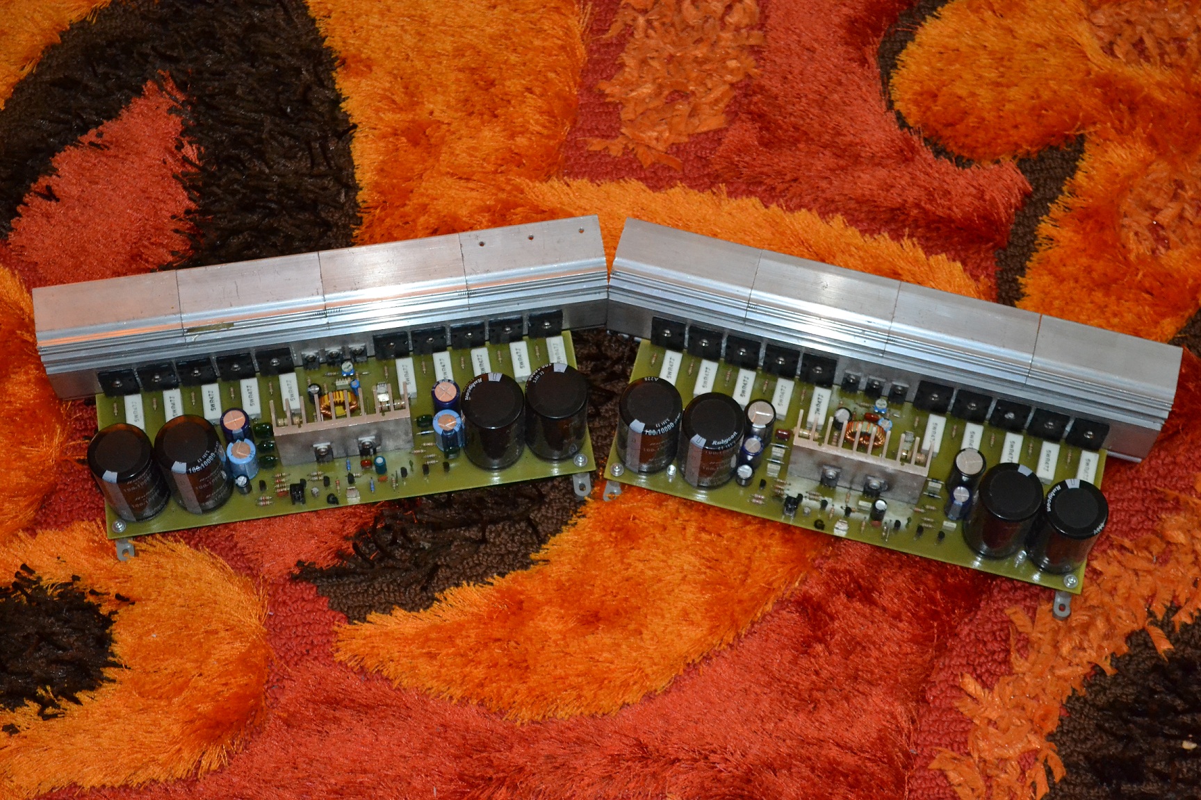

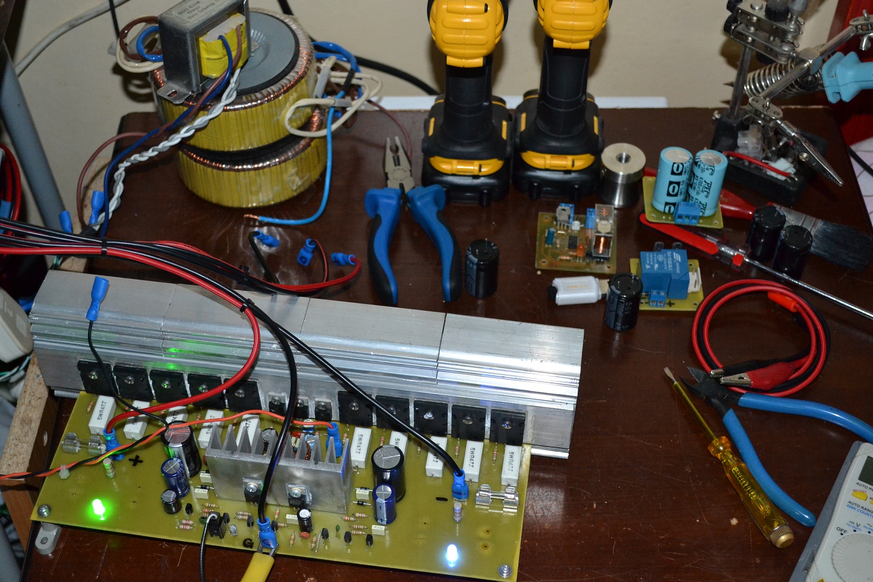

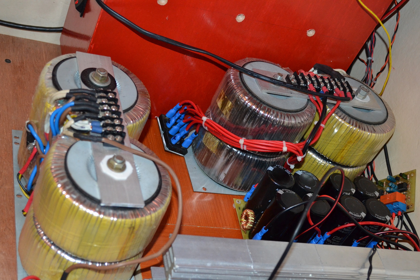

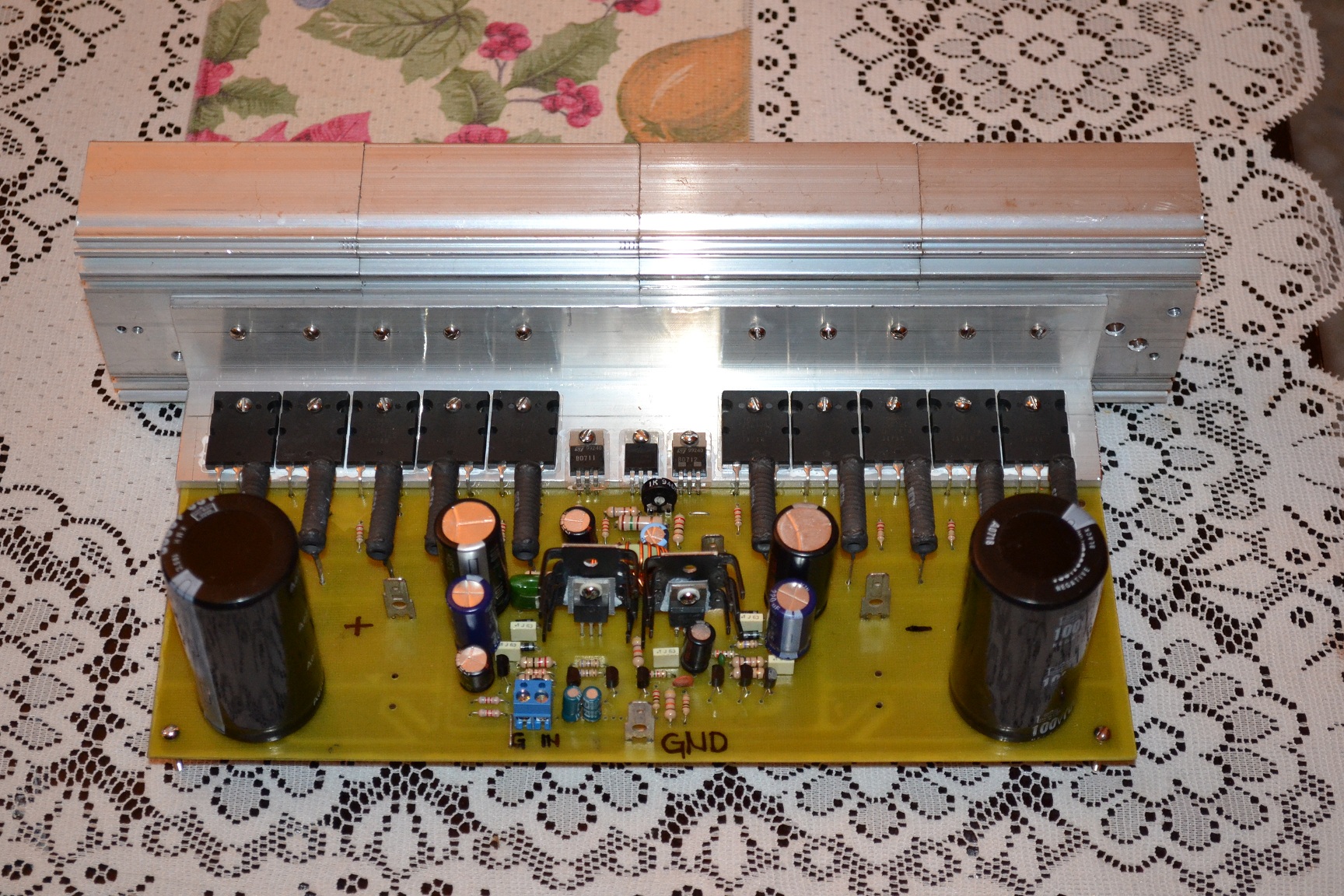

My Old DX MKIII been modified and here's the new look
I really like the performance of this amp in terms of Power, Bass, Mid and treble, but when I try to fix inside the box I realize there is no enough space on the box if the output transistors are in horizontal position, and the VAS transistors are very hot, I try to install a big heat sink but I’m not happy if the heat sink is not mounted on the board, I feel the leads of the transistor will not last long, so I decided to make a little modification base on Alexmm layout to suit my needs, now this amp is perfect for my needs, now temp on VAS transistor are stable even without cooling fan. Very cool amp I really like it…..
Below you can see the image before (in horizontal output) and after modification it's in vertical position with adequate heasink in VAS transistors;) the remaning are the big caps to finish my 1st channel, now this amp is singing with +/-80VDC.
My next step is to assemble the second channel to drive my subs together with my DX Super A …..
excellent
very nice work, very nice work,hermoso acabado :eek:
Wow, do you have enough transformers?

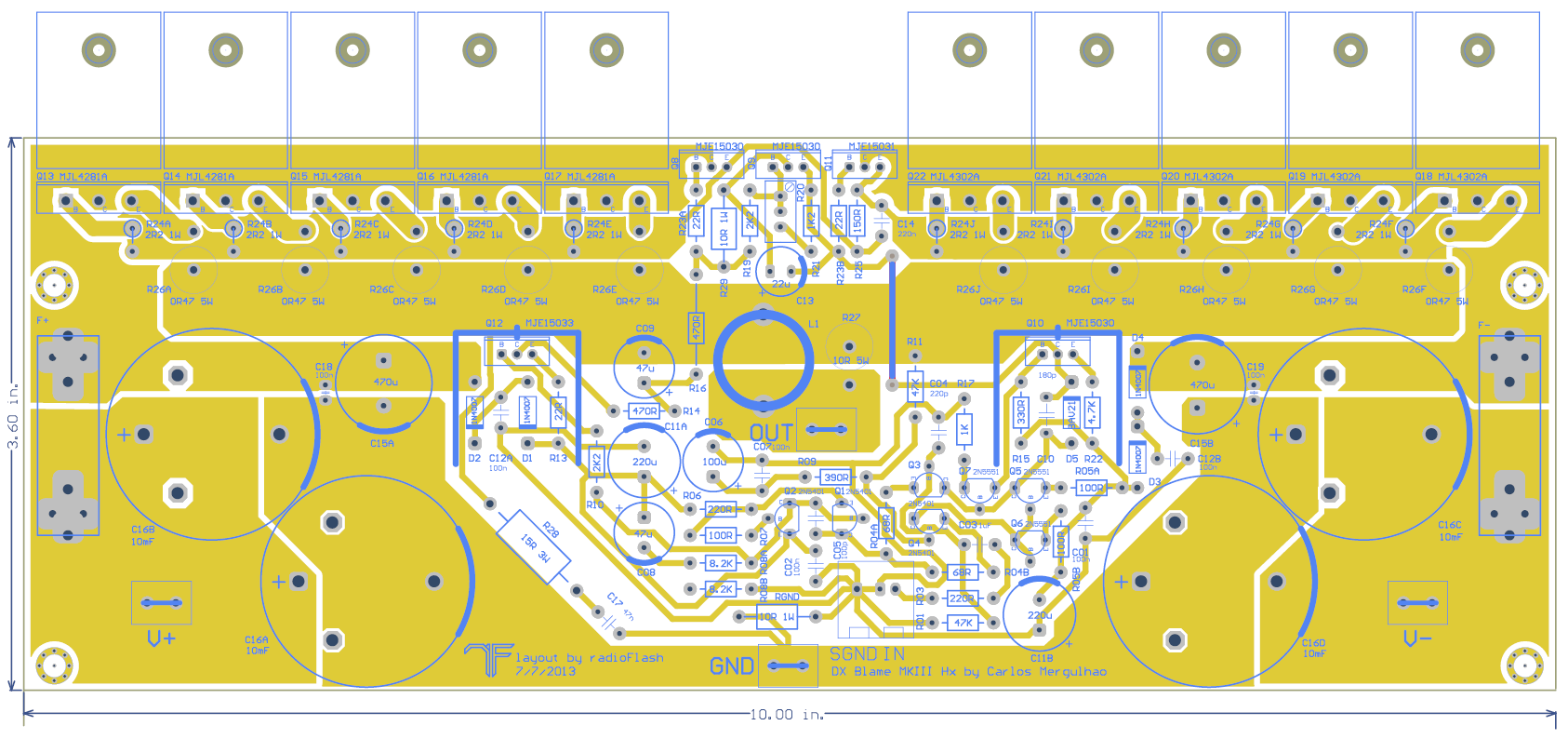

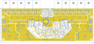

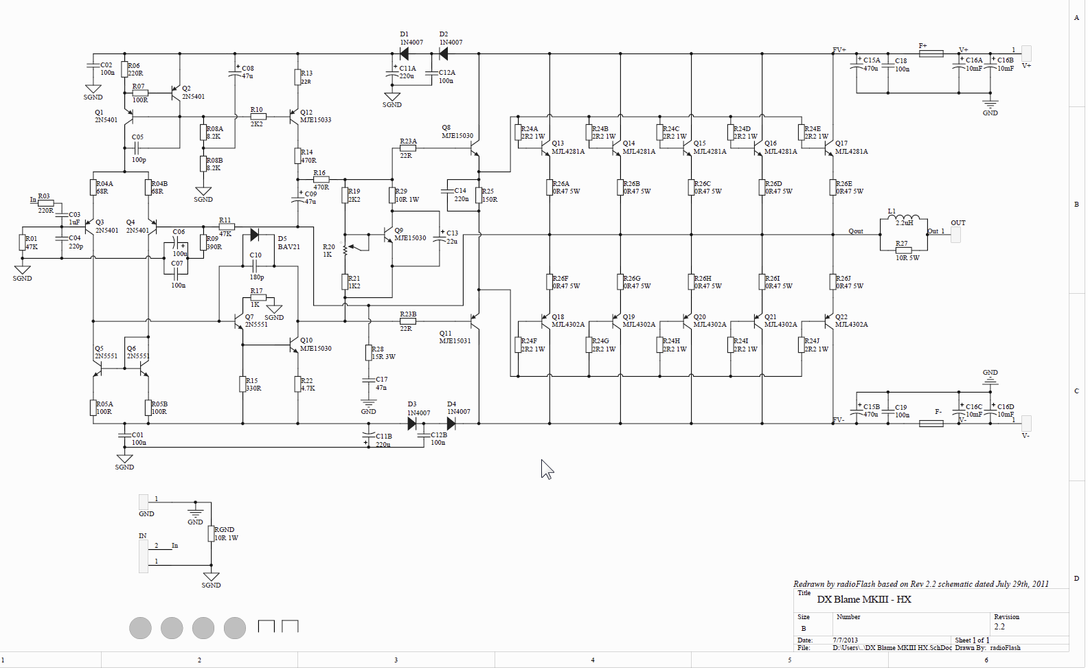

My try at a PCB
Thanks DX and the rest of the community for a very interesting project.
Here's my try at a PCB. It takes much inspiration from the very nice official layout by Alex MM. I just wanted to have some fun trying my hand at it.
* It is slightly narrower at 10 inchces (254mm) vs. 265 mm to accommodate my anticpated heat sink which is only 10 inches wide
* The zobel inductor is intendend to be mounted with the axis of winding perpendicular to the board
Question:
The recommended voltage is +/- 64V. If one had a 50v transformer giving a rectified voltage of about 72v, would that cause a problem?
