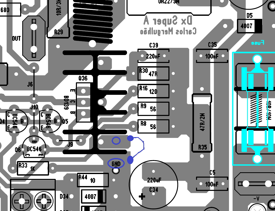

While making the pcboard to the Dx Super A i had this trouble
about the coil position.... it was too much close to the VAS transistors...and there, a huge current would cross...several amperes crossing the coil on the run to the speaker coil... a giant magnetic field would appear there.
Because of that i have asked Juan to move the second VAS heatsink in order to create a kind of wall... a kind of shield, trying to avoid the magnetic field to disturb VAS and early stages operation... one thing we did was to provide earth (ground) connection the VAS heatsink obtains a stronger shield.
Because of that problem we had three main decisions to make...or we remove the coil, or we shield the coil or we move the coil out from the pcboard.
My decision, taken into the Dx Super A board, was the shield providing ground connection to the VAS heatsink...this was the decision, because the coil remotion would never be accepted by builders and to move the coil out from the traditional, ancient and standard position would also not be acceptable.
Decisions when you make amplifiers are not only technicall decisions...they are also political decisions because your gonna try to apply methods to people...and they have their faith, their traditional beliefs about what is correct and what is wrong... we found (Juan and me) the better solution would be to shield the VAS against magnetic field from the output coil instead to move it out or to change it's position related the pcboard..... in all world amplifiers you have the coil mounted into the pcboard...so...move it out would be a scandall... and removing it a crime into folks mind.
See the image.... the heatsink has two mounting posts that goes through the pcboard fiberglass material and crossing it result in a point that can be soldered, because these pins are iron made, so, accepting solder...this way we have the heatsink fixed....the power transistor (second VAS stage) is insulated from the heatsink that goes grounded with a drop of solder or a small wire jumper soldered below the pcboard.
This shows, and proves you our concerns about the subject (see the image) and i will search for the video file to show you my instruction to Juan about the subject... if not deleted because was a series of video private messages delivered to Juan while he was preparing the layout.

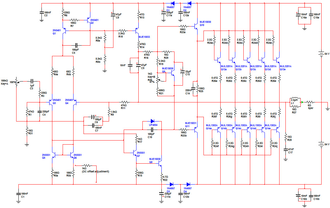

I like my Hx so much! It's powerful, precise and punchy. It's my passtime to discover all of its subtelties and to learn on a real big fat amp how stuff works... That's why I decorticate it so much and I put it to the test so much, both sonically and on my test bench as well.
I think I've found what'S causing the dent on the downward slope that occurrs on my test bench. It seems to be caused by the VAS bootstrap. In the simulator, If I only put a CCS, the dent doesn't appear. If I put a bootstrap only, the dent is present. That dent is there while using the initial CCS/bootstrap configuration. For all the tests in simulation, I arrange to have the exact same 16mA at the VAS emittor, and to have 54mV bias.

These heatsinks we buy are alloy..they are not pure aluminum
because pure aluminum is a very weak material.... too much soft, alike pure gold, reason why gold is made mixed with other material to harden up.
Really the shield used is not that effective, because non ferric material, another kind of shield should be tried to check how much this gonna be needed.
Insulated steel blades should be placed in between the coil and sensitive parts while watching the scope.... i cannot do that, my scope is damaged... to try you need a steel can and a scissor..cut it in a small rectangle, solder a wire on it and the other wire extreme goes to ground..then insulate with electrical tape and go placing into the power amplifier board while watching the scope.... finding the place..hot glued into the place and ready.
To move coils out from the board is neither simple nor practical... first because you will need extra boards to assemble coil and resistor, or they gonna be soldered floating in a ugly way into your output post...second because you will now generate intense magnetic field in other place that cannot be nearby the input connectors or the problem may become worse.
Not that clever solution i think... imagine you build a house and then a tree is covering the sunlight and the place is cold...then will you dissassemble and dismount the house to rebuilt in another place or will cut the tree?... there's an easy and a not easy solution....one is clever and other is not... i do think a try to shield is much more easy, much less ugly and produce much less work than to move the coil out from the board.... this is not a clever idea reason why i have never gave support to this exotic thing...also i imagine people will not like it too...there's an old tradition of coils inside power amplifier pcboard..to break the rule of tradition is hard, some will accept and others will not.

The heat sink I using does not have the solder taps at the bottom last night I was thinking how to provide GND to the heat sink to protect the VAS transistor from magnetic field now mister Carlos even get a new idea of placing a piece of metal material that can be solder to the copper wire that has GND already of course this will apply more to Dx Super A but also can be done in MKIII it does not have the holes like I did to Dx Super A but it can be shielded as Carlos mention on his video, here is the video of the idea.

I agree with your philosophy? of sonic and technical assessment. I'm curious about how you simulate the dent. I have been trying to replicate it using Multisim 12 but it just won't appear. Are you using the original MK III design in your simulations with no changes other than the stopper resistors at 100r and the bias at 54 mv? Also the 16 ma VAS emitter current is lower than what I measure with a probe during simulation. Have you made any mods that would change the VAS current? I didn't see a change in VAS current when I deleted the bootstrap cap.
I've updated some components simulations parameters with the ones provided by OnSemi. I noticed that it made a difference in behavior in simulation. Anyhow, I can send you my simulation file if you wish. Just PM me your e-mail address...

I have the new resistors now 4 x 56R and 4 x 100R.
I have also done a modification R09 390R changed to 2.2 K.
What is the value of resistance will I take for R23A and R23B, the 56R (Bonfis has installed) or the 100R (Martin has installed) ?
Rudy
Hi Rudy-
They both work. I used the 56R because it was a small increase over the original value but still eliminated the parasitic.
Steve
Hi Steve,
Have you also C10 changed from 180pf to 100pf ?
Rudy
Yes but I wouldn't recommend that unless you make the other change I made to the input stage. I think it would also be wise to have access to a scope to make sure the amp is stable after changing C10. I think Cannonica has C10 at 100pf also. Maybe he can comment on how his input stage is configured.
Steve
My input stage is exactly as the pic posted by BMW850. From my simulations, the increased base stop resistor let me confident to decrease the miller cap. I got no issue at all with the real thing either concerning oscillations. I only had oscillations getting out of clip without the baker clamp, but it was not relevant to Cdom value.
