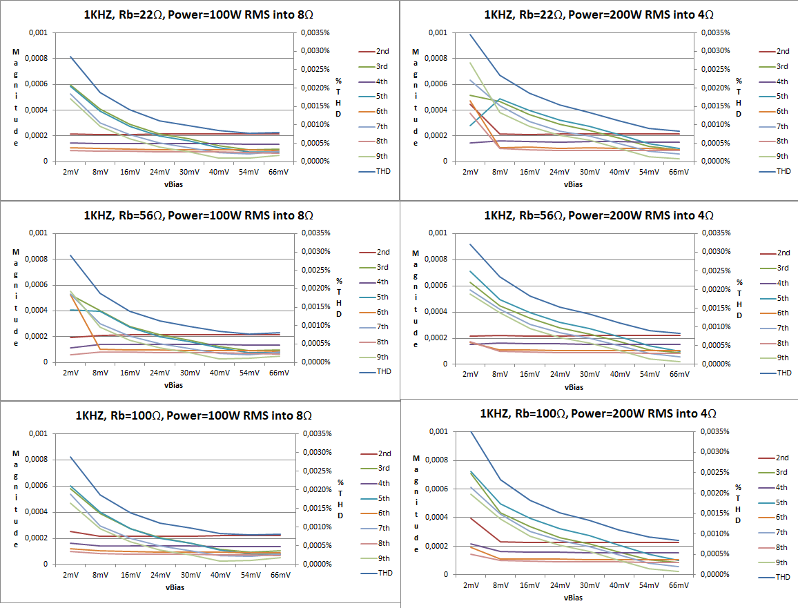

Thanks bonfis for the advice. Also in simulator, tampering with the zobel doesn't change anything about the + side ringing.
I have the necessary components, need some time now to execute. As you mentionned, my only indicator is a sudden jump in bias voltage when adjusting.
As a bonus, here are the distortion figures for 3 values for base-stoppers and for vBias from 2mV to 66mV. As demonstrated, changing the stopper values does not much on the harmonics behavior, but increased bias can reduce odd harmonics significantly but more importantly: below even order ones...
Again vBias is measured between the TWO emitter resistors. The Magnitude scale on left refers to the harmonics while the right scale is exclusively for THD. Left and right scales are NOT related, I just wanted the THD to be present on the same graph.
Mart.

I found that an 56R base stopper completely eliminated the instability and allowed the bias to be increased to 57mv. per pair. This in turn substantially reduced measured THD.
Something I'm not understanding,
You say that with a low base stopper (whose function is to 'stop' oscillation) the output shows ringing on a real ciruit.
But when increasing the base stopper value to >= 56R it completley eliminates the instability,
I agree this is true, base stoppers doing there job.
But then I'm confuced that you say that "This in turn substantially reduced measured THD"
Did you really measure the THD or just simulate for it.
I can't believe that a output full of ringing has less THD than an output with no ringing.

It was the increased bias that reduced THD. Before changing the stoppers I noticed (as have other builders) that oscillation would start when the bias was increased beyond a certain point (I don't recall the exact voltage). I never measured the THD while the circuit was ringing but I agree it would have been quite high.
After inserting the 56R stoppers I measured THD as I adjusted the bias upward. THD came down steadily until about the 60 mv point (measured across 2 emitters) where it pretty much leveled off. THD was reduced to about 10% of the amount measured at the recommended bias setting.
I don't have a personal preference on bias I just follow the procedure of adjusting for minimum THD. My heat sinks seem to handle the idle current just fine so I'm happy.
Steve

I finally neglected my family, friends and responsibilities for a few hours and proceeded with the modifications :)
Here what i've done:
Replaced the 22 Ohms base-stoppers with 100 Ohms.
Replaced the 180pF miller cap with a 100pF one.
Increased the bias to 54mV cold (across both emitter resistors).
Yes the high-bias stability was restored by increasing the base-stoppers as expected and as witnessed by bonfis.
I did all of this with a lot of precautions. I started it first with resistors in place of the fuses and using the light-bulb in serie with the power cord.
I did only one channel to be able to do an A-B comparison.
