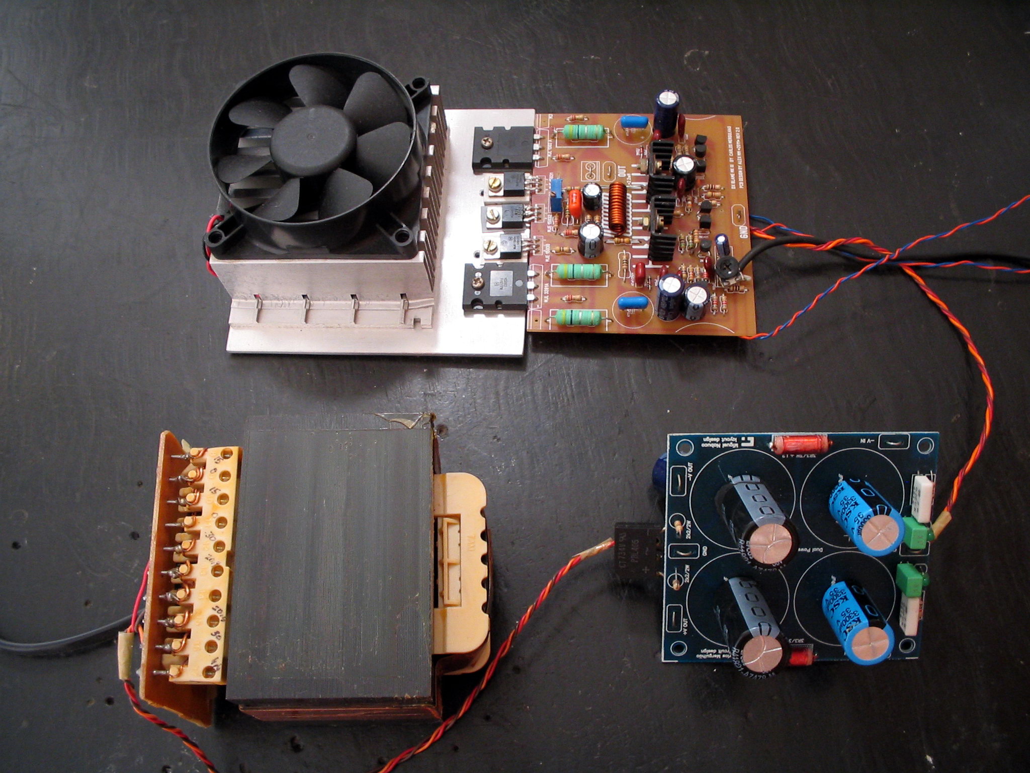

I have tested the Dx Super A into the simulator..to use together the MKIII Hx
I have not approved....too much hot...too many modifications..... i am adapting it to test together the MKIII Hx but with reduced power (41 plus 41V supplies) because easier to me as i have one unit assembled.
The MKIII Hx uses high voltage supply, and some of you are using even more volts than the suggested value..... so, if we try 500 mA as stand by current start up at class A biasing..then we may have too much heat...not a good idea as this amplifier is already hot..... i could see the heatsinks people will use and i do not thing they are good enough even to the standard operation at full power..... if we increase bias till 10 or 20 watts, tracking the operation in class A (high bias)..then we will have much more troubles than we want.
I am uploading a video showing that i have simulated and that worked with some modifications because the VAS current is bigger in this model..... i have to try real life and i gonna do it next week i think...
Will assemble a spider type circuit to connect it to the MKIII Hx reduced power i have already made....to be easier to me.
This stuff is good to lower power units.... the high power amplifiers already have a couple of watts (sometimes one or two) while in class A because of their stand by bias.... the power consumption in stand by mode will be able to generate non switching audio for 1 or 2 watts RMS .
If you want you can try.... i have not succed to adjust this thing to smaller currents than 500 miliamperes....my circuit is not accepting this well.... if you want you can try under your own risk...but put a camera for us to see..sometimes this smokes a lot and you can became an Youtube champion of hits...people loves this stuff exploding.

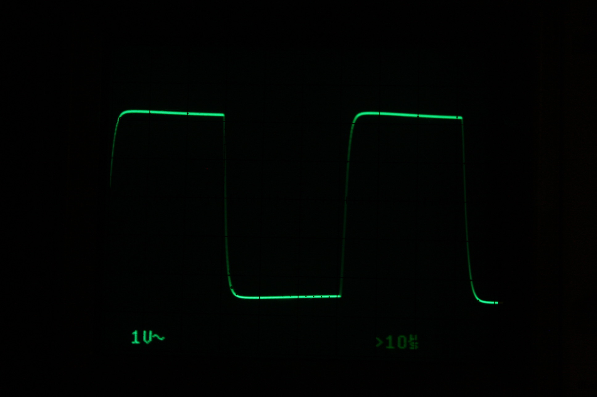

Stability and Gain Issues
Nope. Unable to simulate the instability. I even updated transistors SPICE simulation models in my simulator with the ones from the manufacturer's itself (I use OnSemi).
Although the transistors weren't matched, I ordered them from a big well-renowned USA reseller, so I doubt they'Re counterfeit...
Well, even though my "high bias" test were not conclusive, I still like the quality of what I hear at the low bias setting.
I just completed some mods on my first board and thought I'd pass them on to the forum. I had also encountered some odd stability problems on my first build although they were not related to bias. Instead the amp would go into oscillation as soon as I connected an 8 ohm load. With no load it seemed stable. Since I was interested in lowering the gain anyway I experimented with changes to the IPS and feedback factor in Spice. I ended up with the following component changes:
R4 a&b 100
R6 150
R1 and R11 12k4
R9 470
R3 2k7 and C4 470pf (per Cannonica)
No change to Cdom
I should mention that my build has 4 output pairs and 50v rails under load. I also moved the output coil and resistor off the board to the speaker term.
The amp now produces full output at 1.25v in. Lowest measured distortion was achieved with bias set to give 64.7 mv across 2 emitter resistors! I won't quote the number because I don't fully trust my sound card based distortion measurements. However it does reliably show changes up and down.
Stability seems fine. See the attached scope shot of 10Khz sq. wave (vert. scale is actually 10v/division). The main heat sink at this bias is only warm to the touch. The VAS and CCS sinks aren't even warm.
But the best part is the sound. The amp sounds fantastic. I have built and still have a Leach Double Barrel and a Randy Slone 120 watt amp. Although I haven't done an A/B comparison of either to the Blame it sounds every bit as good to my ears.
Thank you Carlos and all contributors to the thread for your work on this project.
Steve
