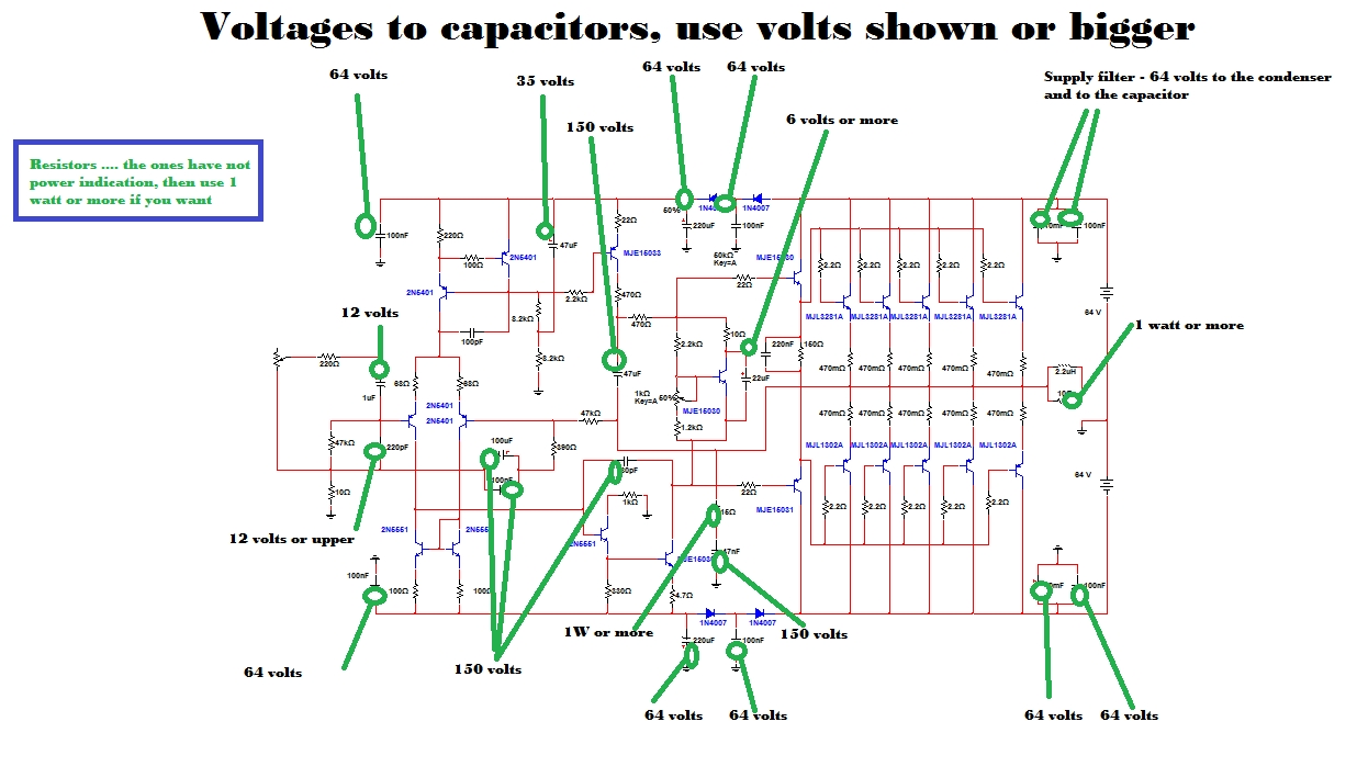

now i cannot find a 100V in a small package for the capacitor circled in red, can i use a 100uF/50v?
Hi Junie,
I hope this helps, drawing from Carlos.
I use 100volt caps.
Rudy

That 100uF capacitor that is the DC block in the NFB path could be a 3Vdc component and the amplifier would still perform well.
If one wants to ensure that the low voltage cap in this blocking position is never abused then add a diode across it so that worst case DC voltage across it is <1Vdc.
You can also add an inverse diode across this same capacitor to protect it from voltage abuse (when something goes wrong) from the other polarity.
Some will report that higher voltage electrolytics perform better than lower voltage electrolytics when passing audio signals.
This DC blocking capacitor should have near zero DC voltage across it, when the amplifier is operating properly and should also have near zero AC voltage across it when the amplifier is operating properly.
A DC blocking capacitor that has no DC voltage and no AC voltage across it cannot contribute to the distortion that the amplifier creates.
i.e. A properly sized DC blocking capacitor cannot be heard.
Make it big and use low voltage if the space/cost requires that.
Use the input capacitors to limit the bandwidth of the amplifier.

Andrew, isn't it adding a diode in NFB will rectify the output signal which lead to DC presence in the input stage? Maybe i'm wrong
You're wrong.
The NFB DC blocking cap should never have any significant voltage across it, when the amp is operating properly.
If there is no voltage there is nothing to rectify.
If the amp develops a fault that creates a voltage across the DC blocking cap then the diode limits the cap voltage to <1Vdc. i.e. the cap cannot be damaged when the amplifier output stage blows up.

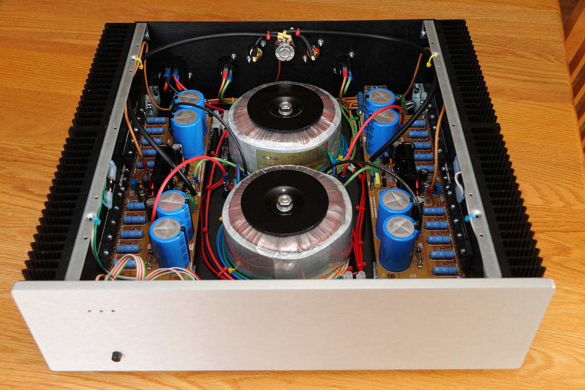

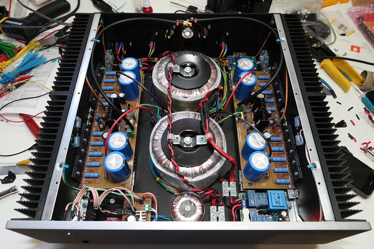

I did some adjustments on my amp.
I wanted to get rid of the high-pitched hiss and the electrical hum when the amp is sitting idle.
So I lowered the gain grom 143x to 32x by replacing the 330 ohms resistor by an 1.5K (I went with a 330r instead of 390r initially :eek:... wrong direction one would say )
I also re-routed the power wiring over the main trannys using some custom brackets. Initially, those wires were running just below the signal inputs. (See the pics below)
So how's it now? Very silent :D and more satisfying. The high-pitched hiss is completely gone as well as the 60HZ buzz...
The sound has changed a bit too, I thought the amp was emphasing too much the high-mids, at the point of being harsh at higher volumes. This tendency is now gone and the frequency response seems more flat and natural.
Pics showing before and after the wiring rerouting:
