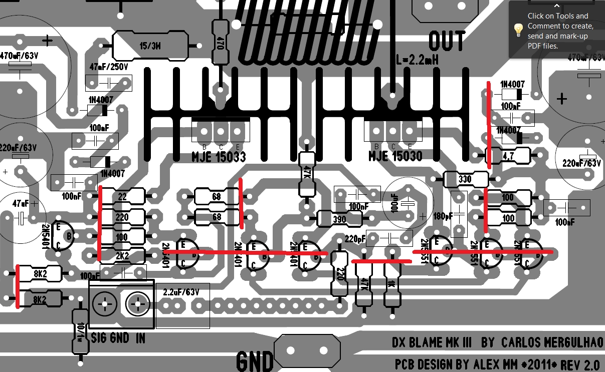

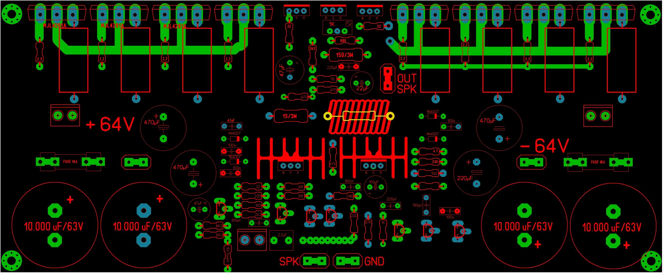

Maybe his layout is not well aligned too.
The big difference of behavior....say, your behavior to ask what i think is not the same behavior other layout designer hav ... he never asked what i think related details....and you did.
Alex made questions about the circuit...if correct or not, and have asked me to check connections....i do not remember if he asked me to say what i think about...maybe because he knows i do not appreciate long strips.
When we work in a cooperative mode, we have to accept that sometimes things does not match our personal taste.
The main target is "to give it a go" .....to make it happens, if matched with our taste or not is a secondary issue... if we want things perfect related our taste, then we should make it by ourselves...as i do not like to make layouts... then i use to be tolerant.... if no wrong technically i give it a go!
The real thing is that does not exist the perfect layout...this depends on taste...we can have the perfect one related technique only.

Do not mind too much about my opinion....you asked and i have answered...you do not have to change your work if you believe it is good.
Alex board is not bad...almost 85% aligned.

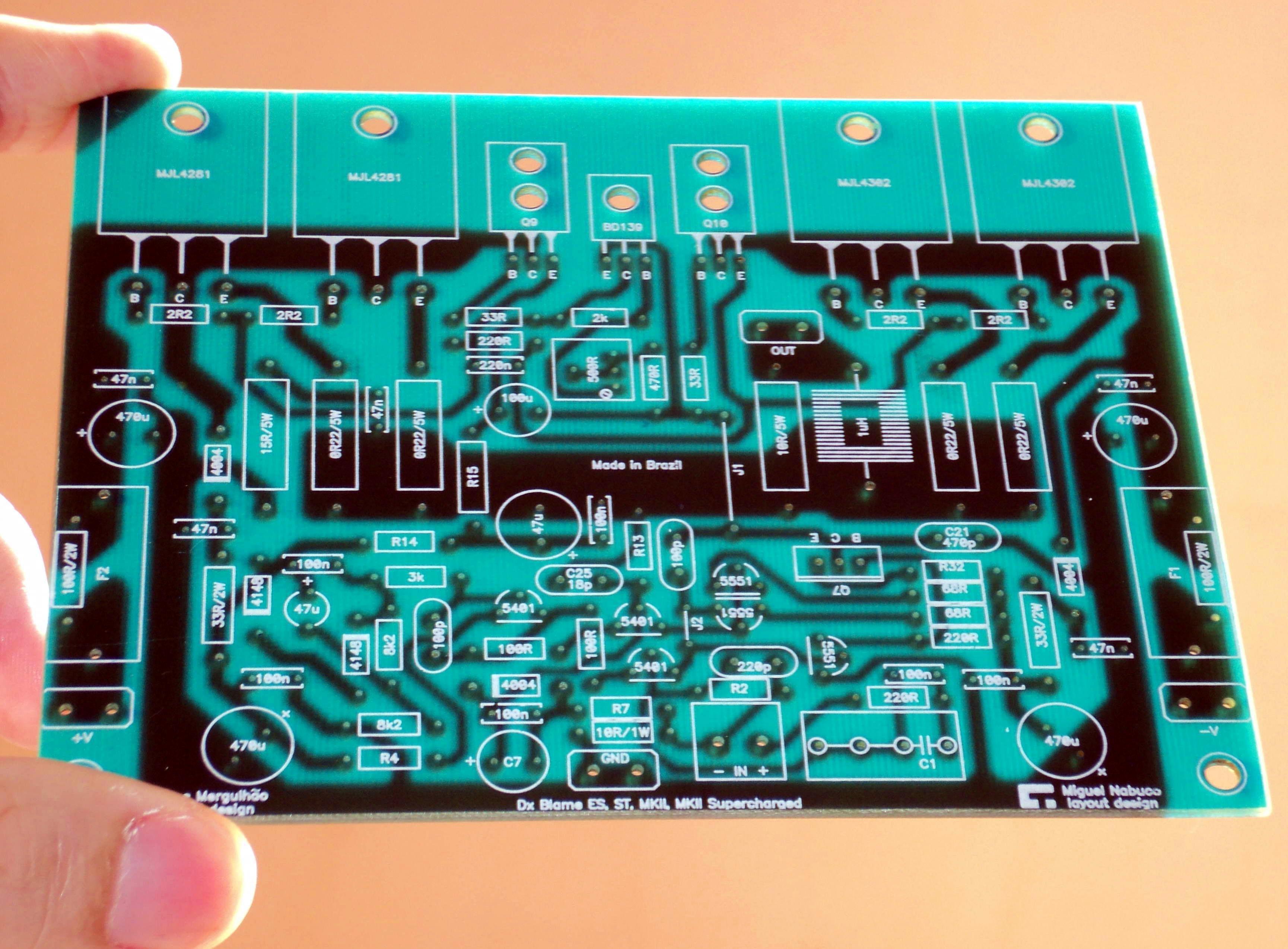

The best board, in my opinion is Miguel Nabuco board made to the MKII Supercharged.
regards,

It is much better ... congratulations, you hava fixed a lot o things
But several other things remained unchanged:
- Supply condensers can go up
- Lettering can have same size....small size
- 10 ohms resistor remained vertical
- Too much holes for the input capacitor is still there
- 150 ohms resistor is too much big
- Power emitter resistors too much big
- Big supply filter condensers continue too much low in the layout...touching screws
- Output resistor continue inside the coil
But the overall image is looking much better this way you have done.

I see... the standard white one.
That floating resistor, the 150 ohms, can be a small resistor...it is an overkill to use such a big one...well..this does not harm the amplifier...it is just a waste of money and space into the board.
Keep it if you want...will not be bad.
Your board is looking great.
regards,
Carlos

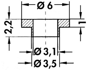

I only need insulation (see picture) for the 3 TO220 housings on the big heatsinks, I don't know the name

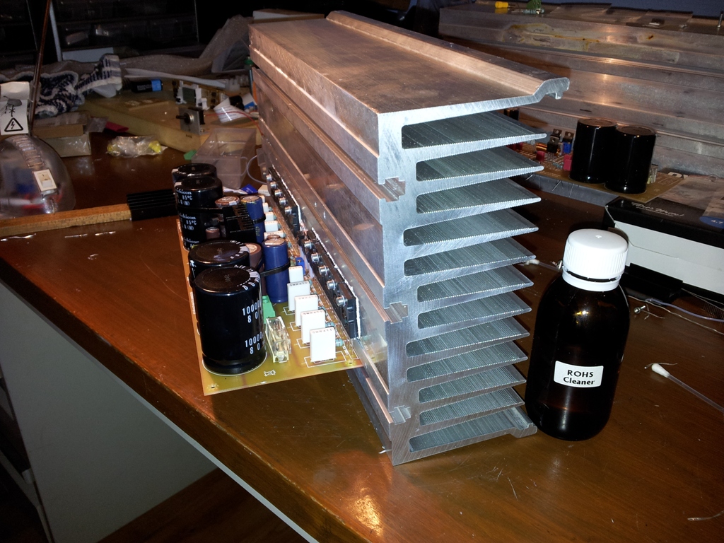

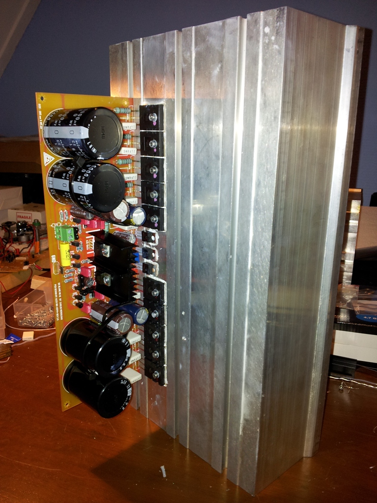

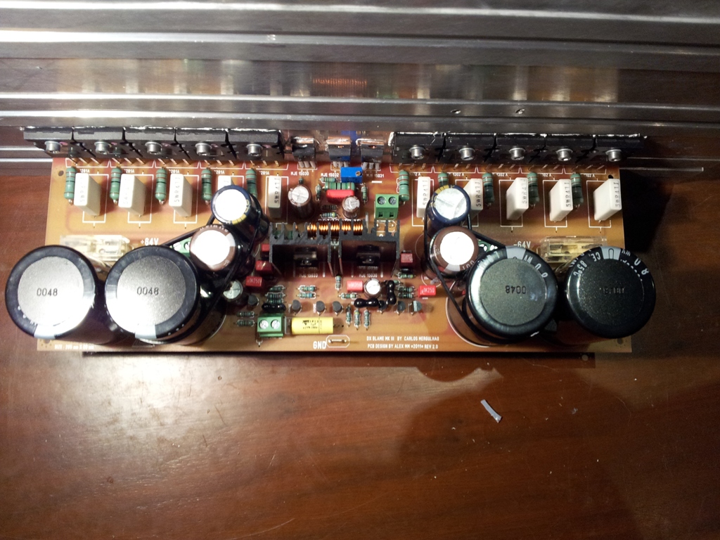

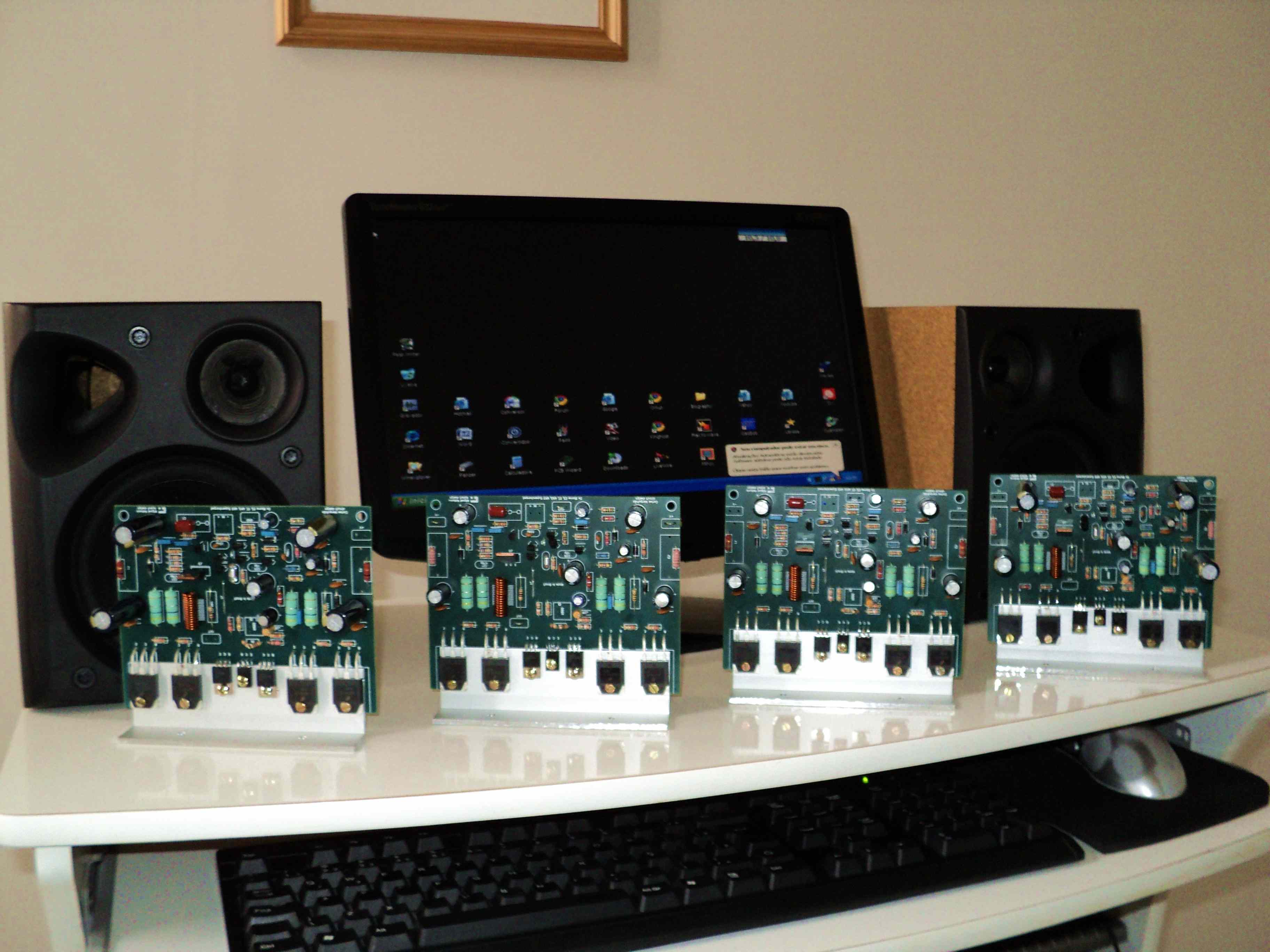

Just a few photos so you all can see how far the construction now is
Please can someone tell me how many Watt's the 100R resistor should be, then I can place the order
Rudy
Rudy
