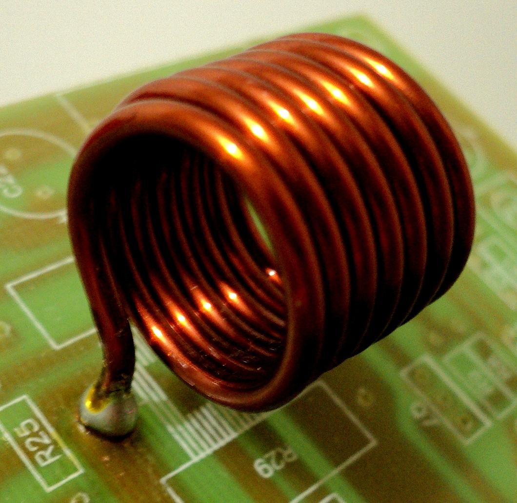

My air core inductor is just a spring, how I get this firmly with glue?
Rudy
That gauge of wire should be rigid enough to simply run down the length with superglue in a couple of places, if close coupled. That’s what I do. Doesn’t seem to affect the enamel coating.
Oh, and your coil is 1000 times too small, according to the silk screen on the board (2.2mH)
Brian.
I have used a thick wire...this way it turns very strong
and stay in place even if you hit it with a hammer.

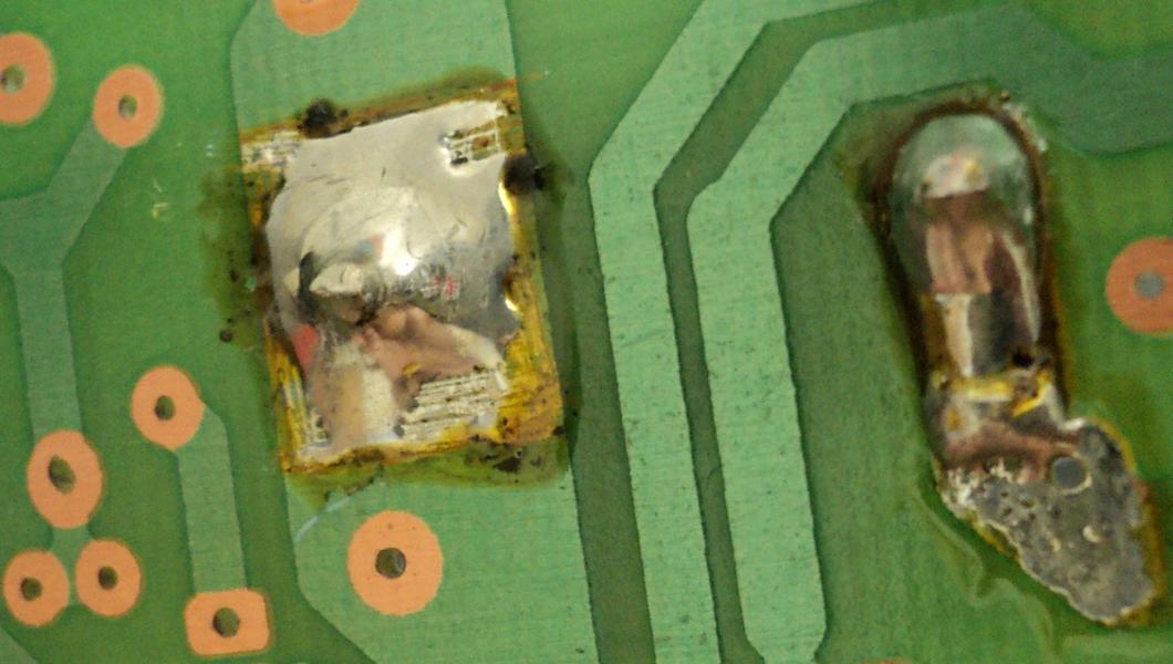

I have drilled larger holes to the coil, and the pad, the island to solder was increased in size scratching using a knife..the a lot of solder keep the thing in place.... yeah.... a little bit exagerated.
This coil is "just in case".... in normal use it does nothing.... we can even use a wire jumper in it's place in most of the cases.... because of that...it is not that critical, the number of turns and diameter can be different.
In some amplifiers we use to correct overshots...not in this amplifier...it is stable.... if no broadcasting station is transmitting nearby the amplifier or speaker cables, then it will not face troubles...if cables are not too much high in capacitance and length then no problems too...if speaker crossover is not that crazy...then everything gonna be all right.... in other words, in "normal set up", you will not need the coil.
There's a lot of thinks we include in audio amplifiers "just in case".... analogy is the air bag...they are included in your cars "just in case".... normally they will not be used.... these things are there for care, for caution.
Bypass capacitors are there for the same reason... they will operate stopping oscillations..but only if oscillations starts... not having rail instabilities or transistors going unstable, then these parts will not work.... also zobel filter is another case, the input RF capacitor is one more... rail condensers and so on.
In other words...if you coil has thick wires or thin wires... there's no problems about
If coil turns is smaller or bigger..then no troubles
Unstable amplifiers needs more care than this one...this is a Blameless with make up, from Doctor Self.... the man!
regards,
Carlos

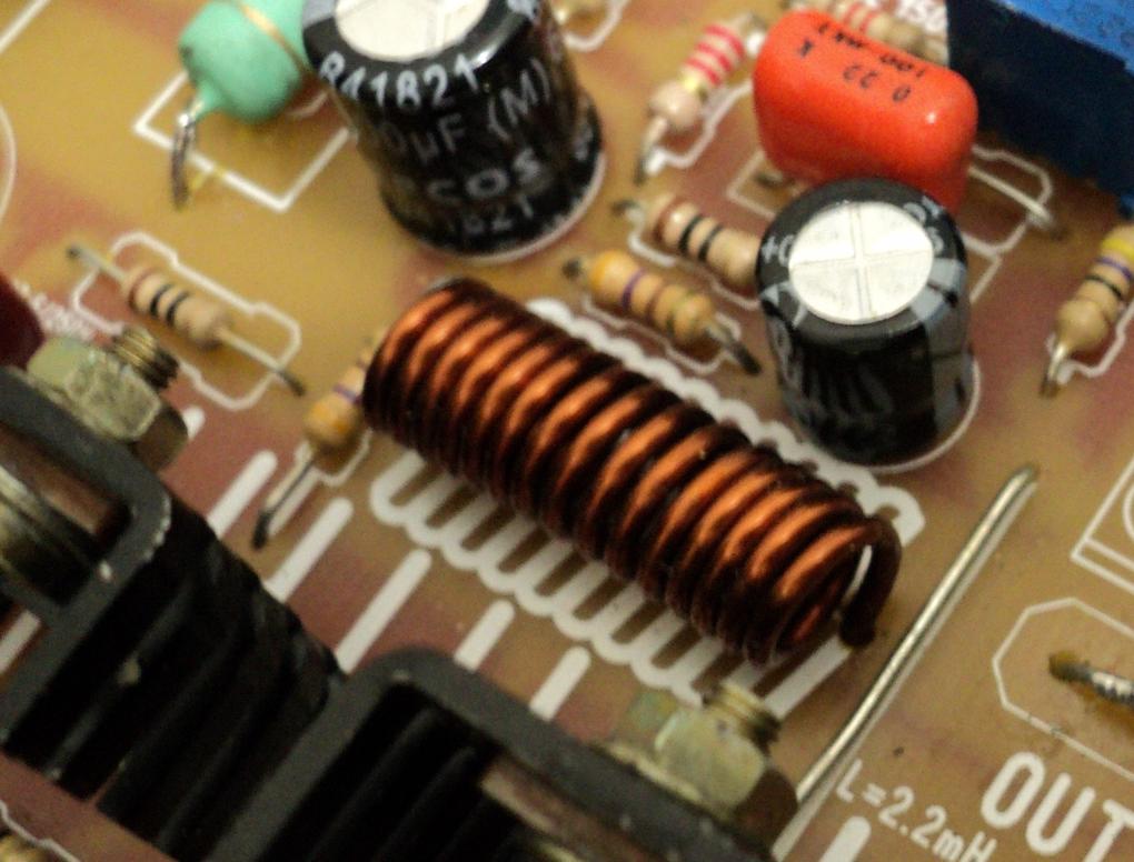

Dear Pingrs.... this 2.2uh is not something deeply studied and calculated
I am not able to re invent the powder without smoke...these things are validated in the daily practice...everybody uses 2.2uH.... 9 in 10 amplifiers use this value...was proven that work fine in most of the cases.....i made the choice copying what Self did and others did... a little bit more or less will not harm the amplifier operation... audio amplifiers use to have tolerances... the supply has more or less 10 percent... resistors are 5 percent or 1 percent, condensers can operate in 30 percent more voltage and transistors can be substituted by several other types...there's not all that precision we think.
You can change if you want and if you need, in special based in the fact that is there "just in case"..... so, we never know if the "case" is a bigger case or small case...we do not know what is the case or it's size.
You know...i am not that different that others...i bother myself to tweak the amplifier to read 0.003% THD..... a foolish as when we connect the speakers the distortion they produce is in the order of 2 to 5 percent to the better ones...so... my concerns are something like blowing in the wind.
This is the most wonderful thing in analog amplifiers... is that they are not that precise..we can make mistakes.
Critical are differential current, VAS topology and VAS current, output topology and output stand by current, Miller capacitor value and your choices how to feed the stages, bootstrap?... CCS?... mirrors?... these things changes performance...small modifications within rational tolerances does not bother the audio amplifier overall performance..will not be the output coil value that will increase of decrease the audio quality in a stable system (without terrible errors described in earlier posts)
regards,
Carlos
The L of the output R//L is definitely not 2 to 3mH, no matter what anyone shows in BOMs nor on PCBs.
1uH is normally a good guide, but DX recommends higher than this.
I tend to use a 15mm diameter mandrel and wind on 8T to 12T of 1.2mm or 1.4mm diameter enameled copper wire. If I wanted low milli-ohms and non vibrating I would use 1.6mm diam wire and wind 3 layers, each with 3T, for a total of 9T. Bind it with some strong sewing thread. Then soak it in three applications of nail varnish.

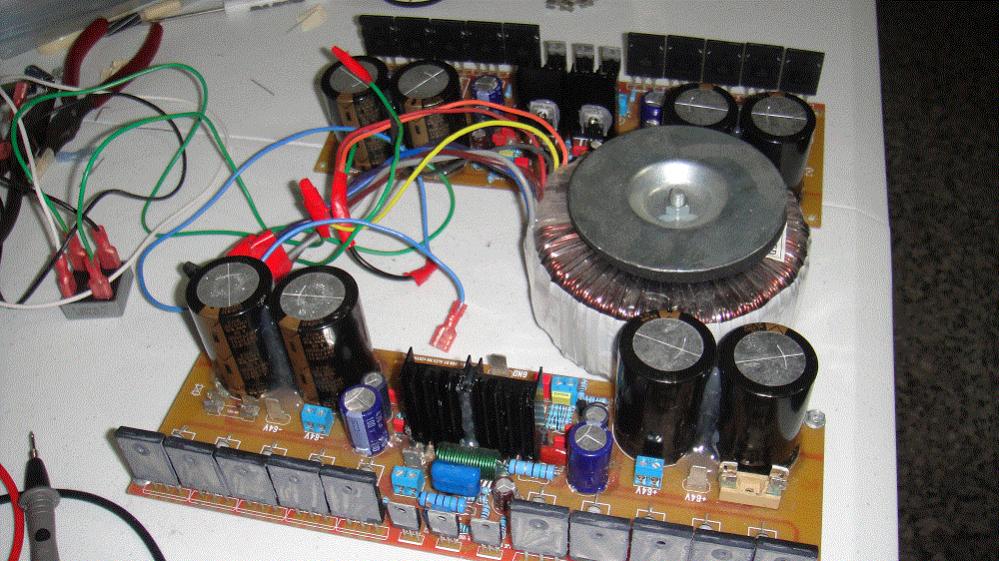

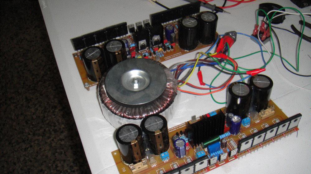

Finally second board done!
Hey guys!
Finally the second board is completed, is a bit different from the other because I decide to place the 1N4007 diode to the bottom of the board I don't think that can be bad also like mister Carlos said to change the 22ohms resistor to 47ohm is done for both boards I'm going to test the second board tomorrow is kind of late but yeah I'm happy that is completed, I have to wash the bottom of the board with some soap to clean all the flux residues and be ready to test, I use some hot gun glue to keep the caps steady not really necessary but is for myself so is all good.
About the chassis for the amp I have problems with the shipping not many web sites send stuff to Puerto Rico so if some one know a good web site that sales amplifier chassis please let me know I do appreciate any information guys, al right guys "Merry Christmas to all of you MKIII Hx builders"!
Regards
vargasmongo3435

Now you have a stereo.... very good Juan
