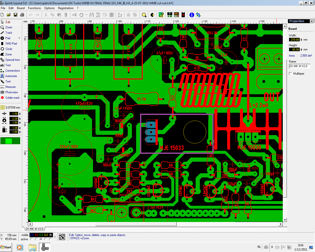

My build has been going slowly. Yes, when I feel like I'm almost finished because all I need to do is throw everything into a metal box, things suddenly get bogged down. I thought i would be finished a long time ago. I had to move the transistors from the top to the bottom of the board so that I can put the board parallel to the heatsinks. I had to re-build my bridge rectifiers so they took up less space. I made a metal bracket to hold my transformers sideways, because that's the only way they'll fit. I built the Elliott Sound System's soft start. I'm having a difficult time getting the transistors pressed against the heatsink. I broke 2 taps trying to tap holes in the heatsinks, so I need to use nuts & bolts. There is always a fin in the way wherever I need to put a bolt, so I'm using metal bars to clamp them against the heatsink.

As youknow I'm changing the layout of the board.What do you think about the following the yellow circle is a cut out of 8mm the reason for that is the possibility to mount the trannie underneed the board
?The holes for the trannies will be plated through
