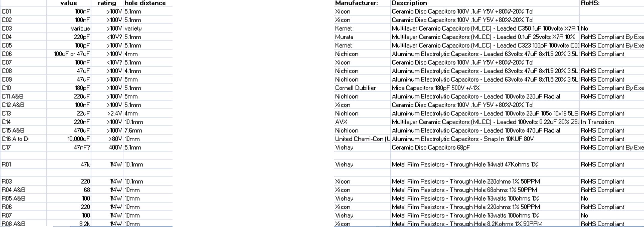

220uF 100 volt 18mm. max 10mm on the board
47uF 100 volt 12mm. max 9mm on the board
I stop now with build because the 100 volt caps do not fit on the board.
I wait or another board is created, or I need to bring the voltage down and buy new transformers.

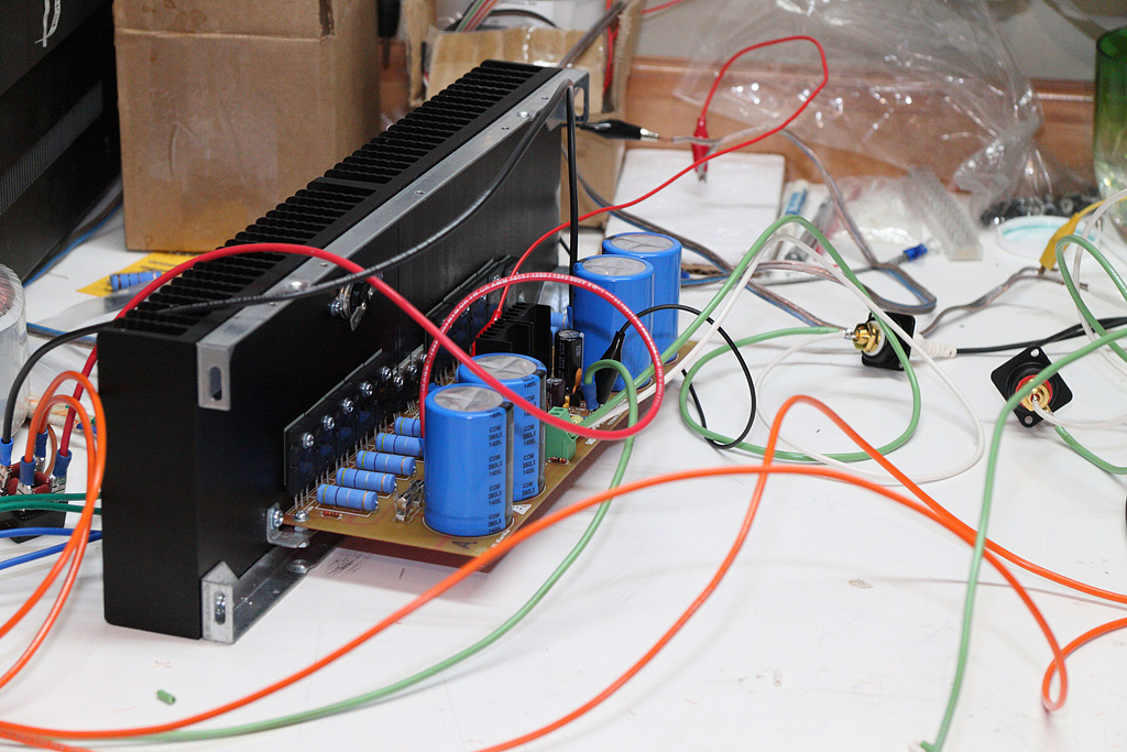

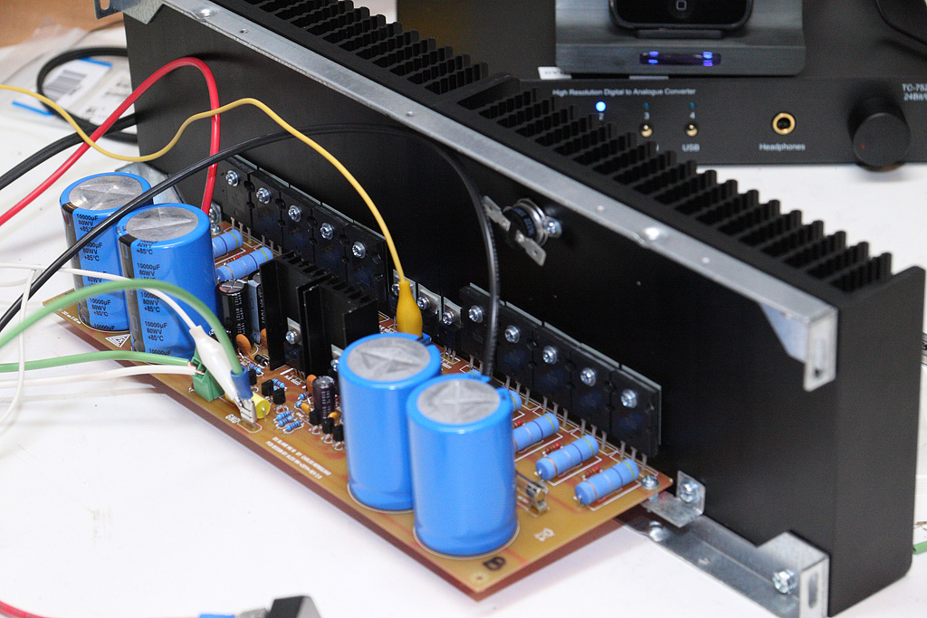

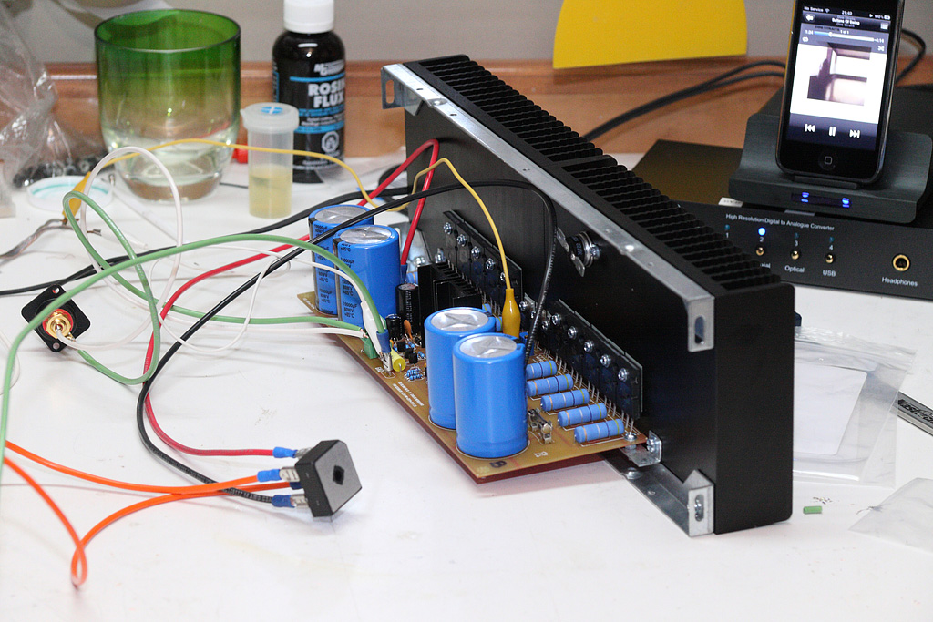

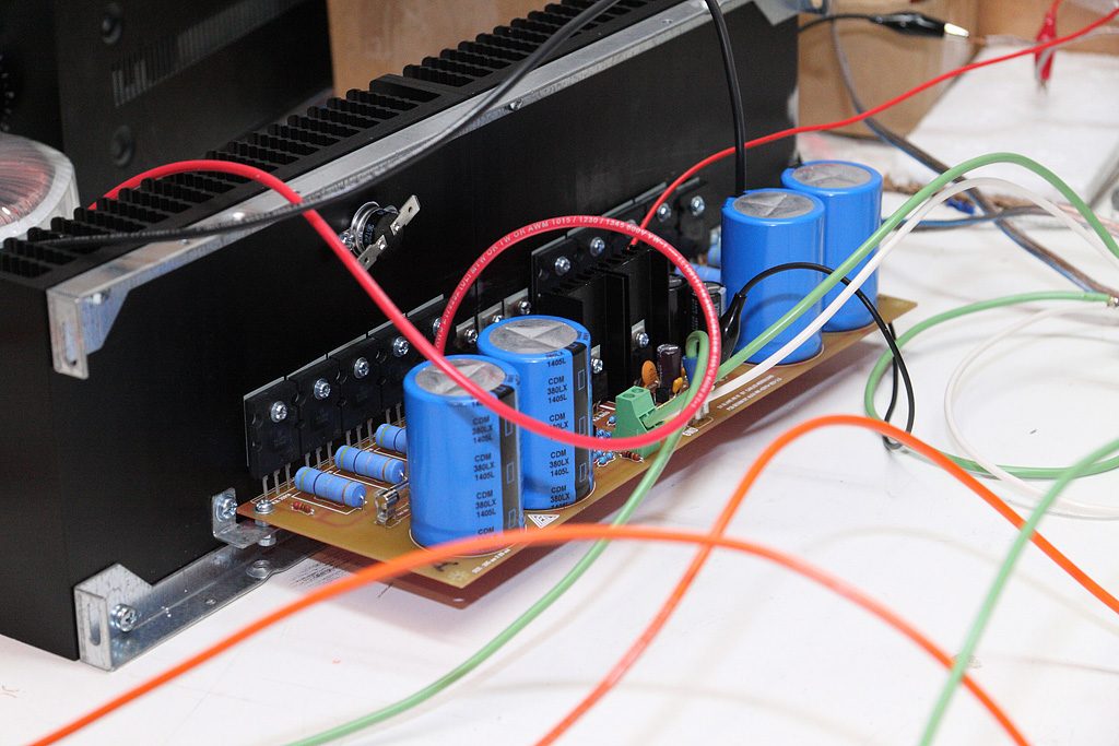

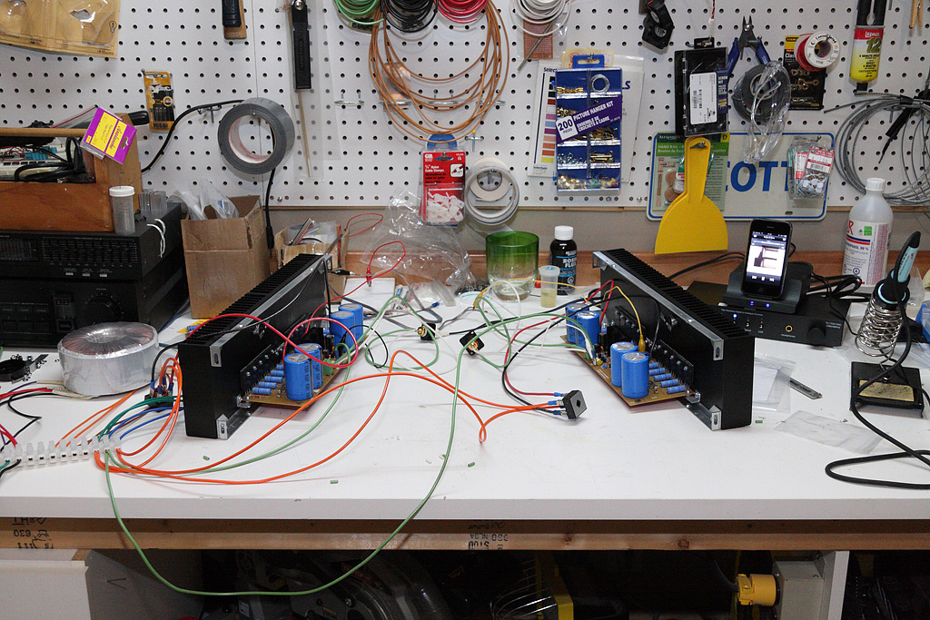

Board 'B' was started tonight. Went silk smooth. Couldn't resist making them sign together in unison.
They're built so identical that all initial readings were exactly the same.
DestroyerX; you were right, the sensivity is a bit on the low side with portable devices, even though I'm using an external DAC with a preamp stage. I may reduce the 390 ohms resistor to 270 or 220 to unleash all the guts this monster is having. I'm gonna do this on a single channel first and compare.
Same for the CCS's resistor. I'm gonna increase from 22 ohms to 47 on one channel to compare the heat dissipation reduction. I will report my findings here. Gimme a few days.
Some pics below. It's a mess of wires for now, I'll work my aesthetics in the enclosure. :D

Ok, I did replace the 22 ohms of the CCS for a 47 ohms. It's definitely getting less hot, great difference, now acceptable level. I'm gonna take measurements in the next few days, I got one amp card with the 22R and the other at 47R. I'm gonna let them run for a couple of hours side by side and measure the temp on these heat sinks.
The thing however is: I had to readjust the bias after changing it... And with the MLE15030 I use for biasing, the resistor-trimpot network was of incorrect value. With the 1.2K resistor, I couldn't get the 1mV required. I had to replace that resistor by a 680 ohms to be able to reach that value.
On the sonics side, I hear no difference. I haven't pushed it really hard, but I think that for my needs, It's gonna do the trick of keeping things cooler. Goooood recommendation Carlos! :up:

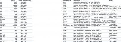

And there is clearly stated at 100volt, and this makes it unclear what to order.
And if you look back you can also see that I have also asked for a clear part list # 126
Rudy
Originally Posted by a.wayne
This is getting very confusing for me, could we please get this all rectified by having the Corrected values and parts necessary for construction , noted by doing an revised BOM/Schematics....?
Originally Posted by BMW850
I agree with that,
I think everyone wants to build a good amplifier, and let's not go cut down on the components.
What brand resistors and capacitors are good for this amplifier?
I suppose the 10000uF is very important.
Please make a good BOM list for this amplifier.
Rudy
I have not made the part list...was Byron that collected some informs
and produced the part lists.
You can use higher voltage if you want...some guys believe this is more safe.
I am saying.... and sorry to be so late...that 63 volts, to the supply electrolitic condensers and on board supply condensers is good.
Also i said that 80 volts and 100 volts is overkill.... but does not cause any harm...if people is wealthy enough or if following the part lists...then go ahead..anything will explode..only your wallet.
My failure...yes.... i should have fixed...doing now...better late than never.
I am not perfect... Byron or the guy that suggested him 100 volts is not perfect too... this happens.
regards,
Carlos
