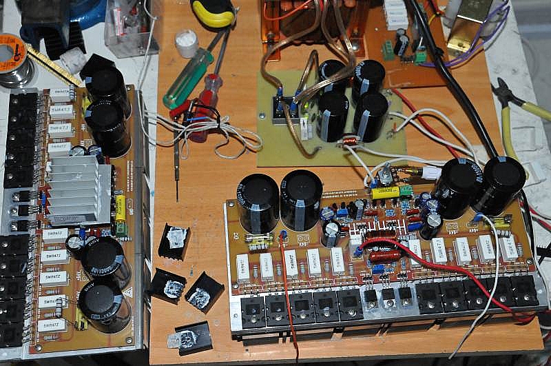

A picture from other forum, another MKIII Hx playing loud and clear.

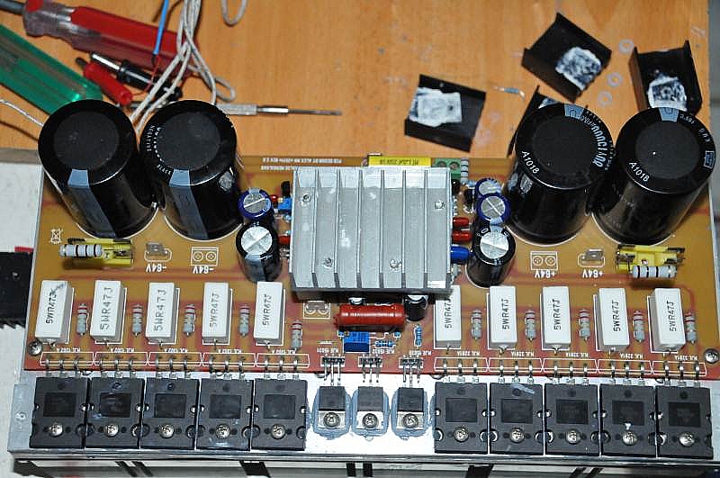

About excessive heat in the vertical heatsinks
MJ777 from another forum tried two different solutions, the first one was increasing the heatsink size that resulted fine, temperature dropped to 42 degrées celsius (human fever).
He tried a second solution installing these transistors below the pcboard, this way they were screwed into the main heatsink and temperature result fine too.

What PSU voltage is he running the MK3 with Carlos ...?
Words from the initial poster on foreign forum:
I'm using a rail voltage of plus/minus 68 volts dc from a 50-0-50 volts ac transformer rated 10 amperes.
People that feel these 2 small vertical heatsinks too much hot can reduce VAS current in order to reduce heat there.... i have simulated and i found the original schematic fine... with the modification you will have changes in performance, but not that huge.
The 22 ohms resistor that sets the CCS current can be increased to 47ohms in order to reduce current...then you will have these transistors mounted into vertical heatsinks (CCS to VAS and VAS transistor) less hot.
I found power there not that big...the left one is the CCS transistor, CCS to feed VAS (Voltage Amplifier Stage) and it is dissipating 1.65 watt.... the rigth side one is the VAS transistor, the second stage, the most active unit, following the buffer and the power there, dinamic power, will be around 1 watt....not that huge power and the small heatsinks should fit in most of the cases... exception is when people is using higher supply voltage... say... really higher voltage.
You can replace the 22 ohms resistor by a 27 ohms, 33 ohms, 39 ohms or 47 ohms.... i suggest you to go to 47 ohms because will really cool down in order to work fine with tiny vertical heatsinks... with this resistor replaced, the performance when using low impedance output loads will clip earlier.... some loss in power...not that huge, not that important.
Carlos
Thanks ...
Maybe it's better to use bigger heatsinks than reduce CCS current ... ?
Yes....better to increase heatsinks than to reduce current
As i said.... audio is almost the same...not the same.... while operating high current (low impedance) we have losses when we reduce current increasing that resistor to 47 ohms...it is an option...but not the best option...better is to increase heatsink size.
