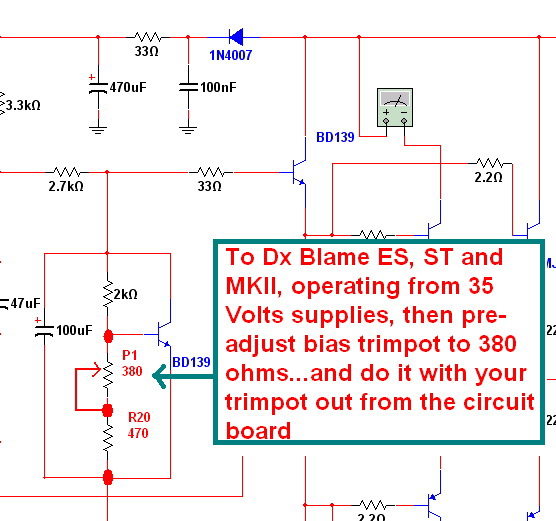

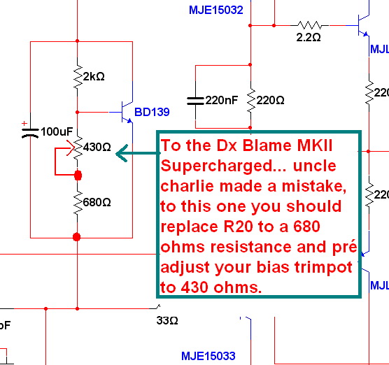

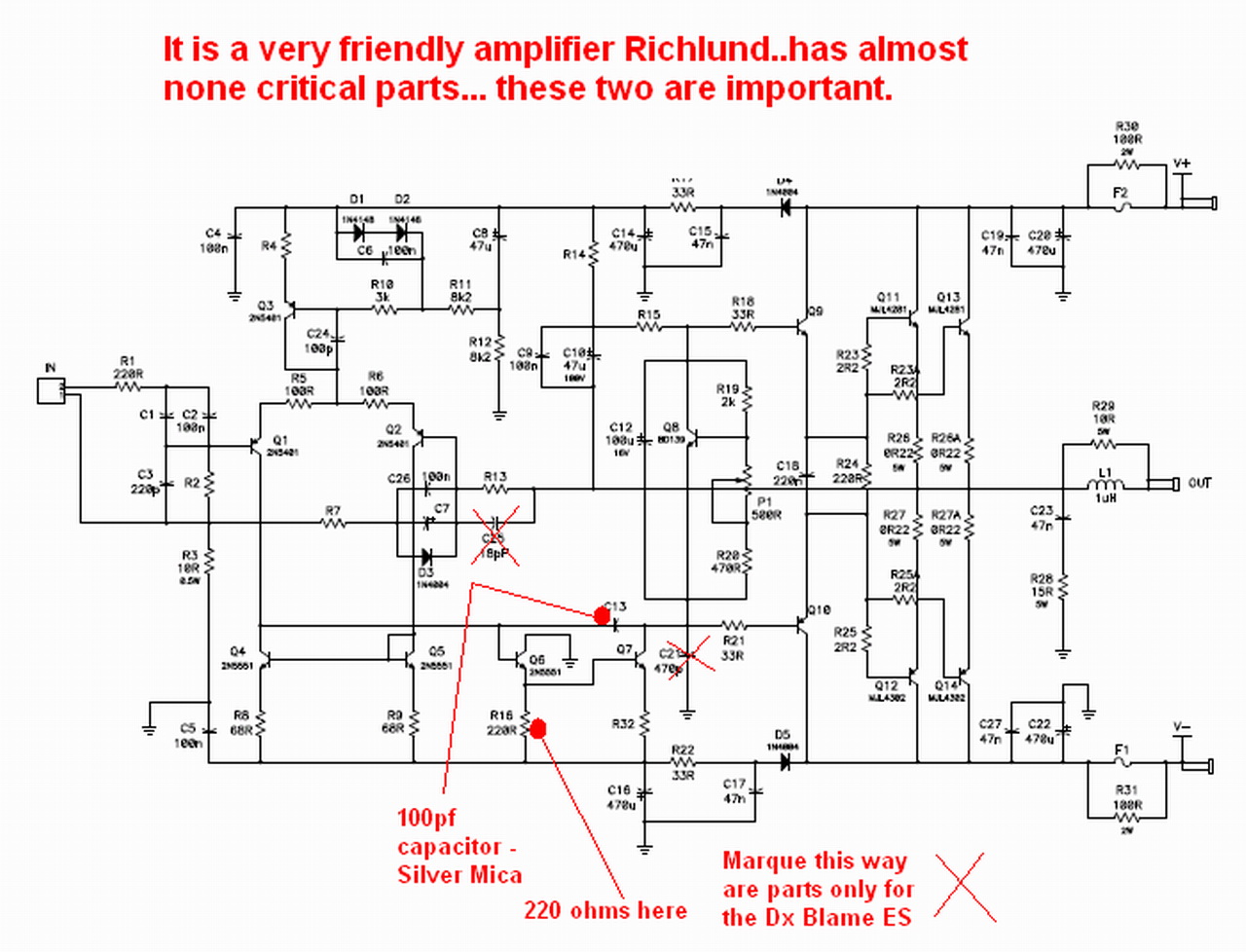

There's an error into the Supercharged bias circuit
R20 should be increased to 680 ohms and the bias trimpot preset goes to 440 ohms.
Another image shows the Dx Blame ES, ST and MKII (35 volts amplifiers) preset resistance.
I am sorry, sites are being updated.
regards,
Carlos

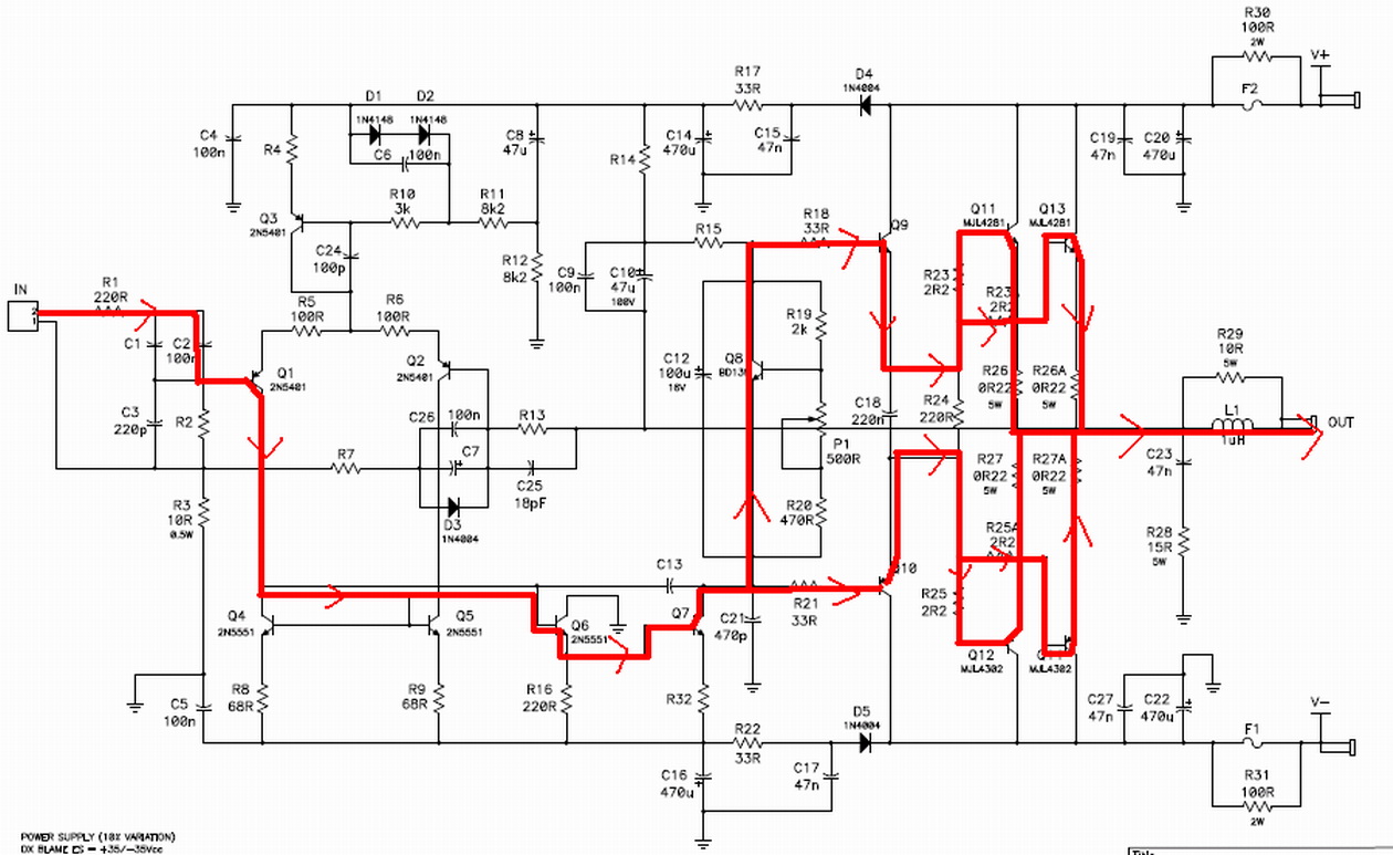

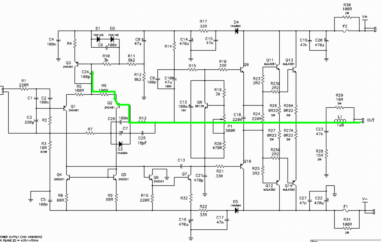

These images will answer you.
Feedback resistors are in the green line.
Audio patch is the red line
There are not too much critical parts...this amplifier sounds great anyway..and accept errors without complain...it is very friendly.
Errors in resistance of plus and minus 20 percent are acceptable...continue to operate fine even this way..also output coil and bypass capacitors.
As bypass capacitors (in paralel with electrolitic condensers) you can use 103, 223,333,473,563,683,823,104,204,224,334,474 and 105.
I am not the one believe capacitor sounds (only errors in value or defective capacitor or wrong polarity sounds)...but if you believe, then search for the best one in your belief.
