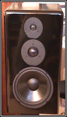

Now to find the drivers to match your box?????
If it was 'I' I would probably go with a 3-way. Depending on what music you listen to????
Us on the web can probably find suitable drivers.

thanks a ton for the advice guys. I had been considering putting another speaker in the box and trying to come up with a nice crossover as well. i opened them up the other day and the entire inside was filled with pink insulation... don't really know what to make of that, the 10 inch speaker was a realistick? if i remember correctly. i will look at the kit mentioned at speakerbuilder once i get off work :p and maybe put up some pics of the cabinets.
small 2 inch tweater on top and a 10" woofer i'd assume on the bottom.
You could do a very simple system with a 2-3" widerange driver like the Tang Band 871, Hivi B3N, or Aurasound NS3, crossed over nice and low, perhaps around where baffle step starts to kick in, to a nice 10 woofer like a peerles CSX series or dayton RS.
This would have fairly low effieciency, but there IMO this type of design can sound very satisfying, especially in the lower registers.
