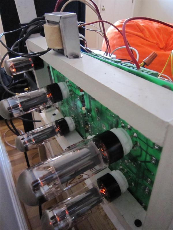

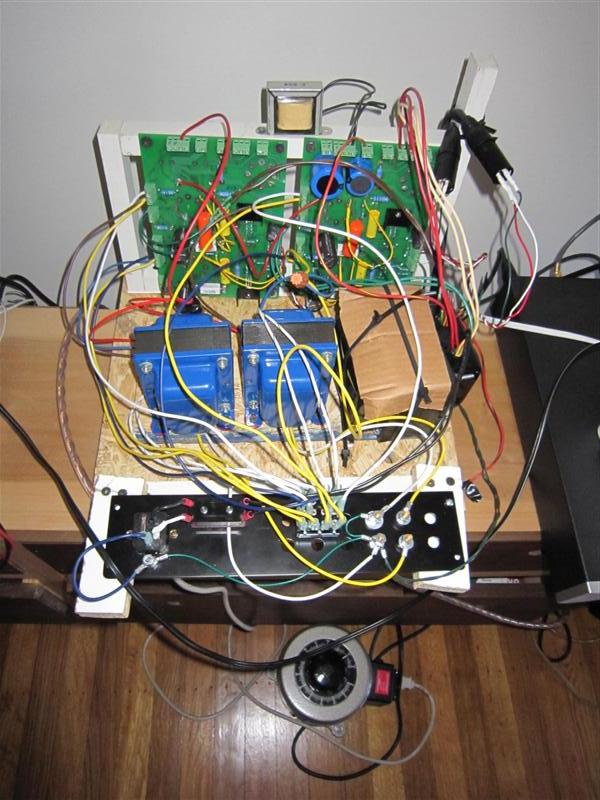

It Works!!
I hooked it all up a on temporary piece of plywood, just to work out all the details, take measurements etc. A friend with a mill is cutting some holes in a proper chassis for me meanwhile.
Anyway, it sounds AWESOME. Absolutely fantastic. Thanks George for a killer design of the SE, and it really works great in PP.
I was a little concerned that the OPT were a little too big for the power I would be running them at, but there is a lot about of detail coming through. And the bass really extends very deep and clear.
In fact, the EL34's are probably way more power than I need. But I will run them for a while to see how I like them. I'll pop in the 6V6-S's later.

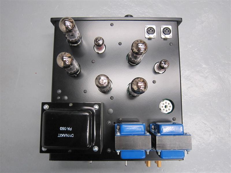

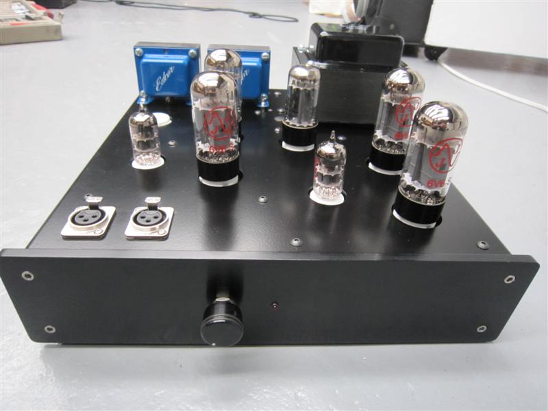

Amp Finished
I thought this would be a fitting post to wrap up this thread.
I finally put this amp in a chassis, so here are a few pics. Also, I did a writeup on it, with some wiring diagrams, so please check it out.
Click here for the link, and go to the electronics tab and click on 6v6 amp. I hope the web page will help whoever may decide to take a similar route.
All in all, it was fun project, and thanks for the help along the way.
