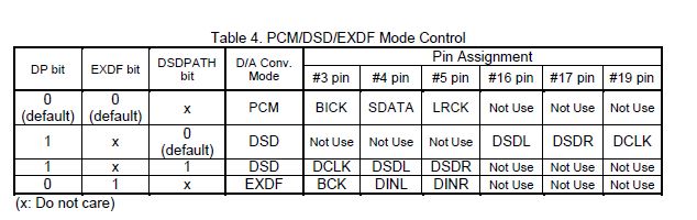

No you have different input only if you are in DSDPATH=0 mode

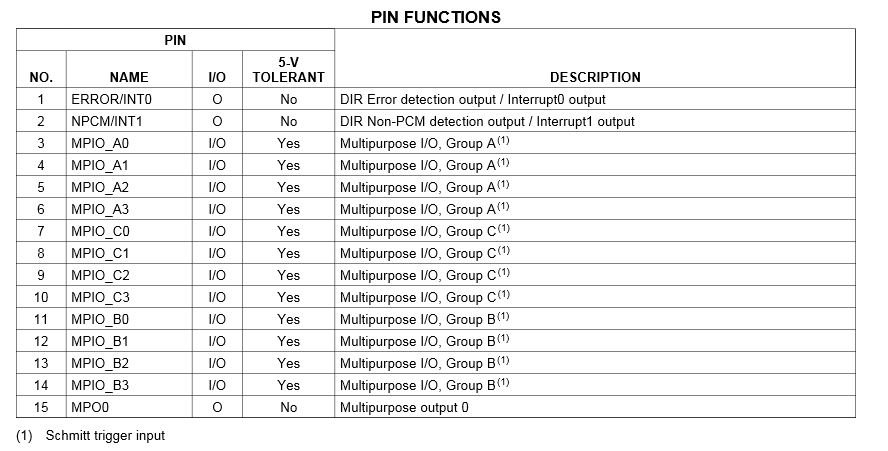

If the DAC use a digital interface transciever like a DIX9211.
Perhaps it could use the DIX9211 PIN output that indicates if PCM or not.

The AK4490/4497 do not support automatic switching between PCM and DSD. You have to know what kind of signal you will be converting and use a uC to set up the DAC accordingly.

Interesting spec and diagram. I had quick look on it and DIX9211. DIX knows nothing about DSD, its only PCM or passthrough. DSD inputs should be connected on Port0 & 1 of the board which are GPIO B & C of the DIX. When switched by the PIC the DIX act as a passthrough from Port0 or 1 to the 4 I2S/DSD input pins of the 4490s.
Two options :
a/ there's no PCM/DSD detection , the port 0 and 1 have to be configured before usage to DSD or PCM, then when you switch to these inputs the 4490 is setup accordingly.
b/ the PIC does the detection by analysing the frequency of BICK connected to port C0 of PIC. Frequency for various fs are well know for PCM and for DSD, this may be analysed via software (I've to do some calculation in order to check if we have differents frequency for each fs and mode). The display on page 14 saying 'Unknown I2S' let me think this is reasonable to admit that PCM/DSD detection is made to BICK analysis. In addition port C0 is connected internally to Timer 1 of the PIC, which may be useful for frequency analysis. If true it's smart ! but those are only assumptions :)

Went too fast on DIX datasheet reading. It has a DSD Mode aimed at suppressing jitter on HDMI connection. This mode act as a passthrough but doesn't seems to provide any kind of detection. So the problem remains unless a more detailed read highlight some interesting feature...
