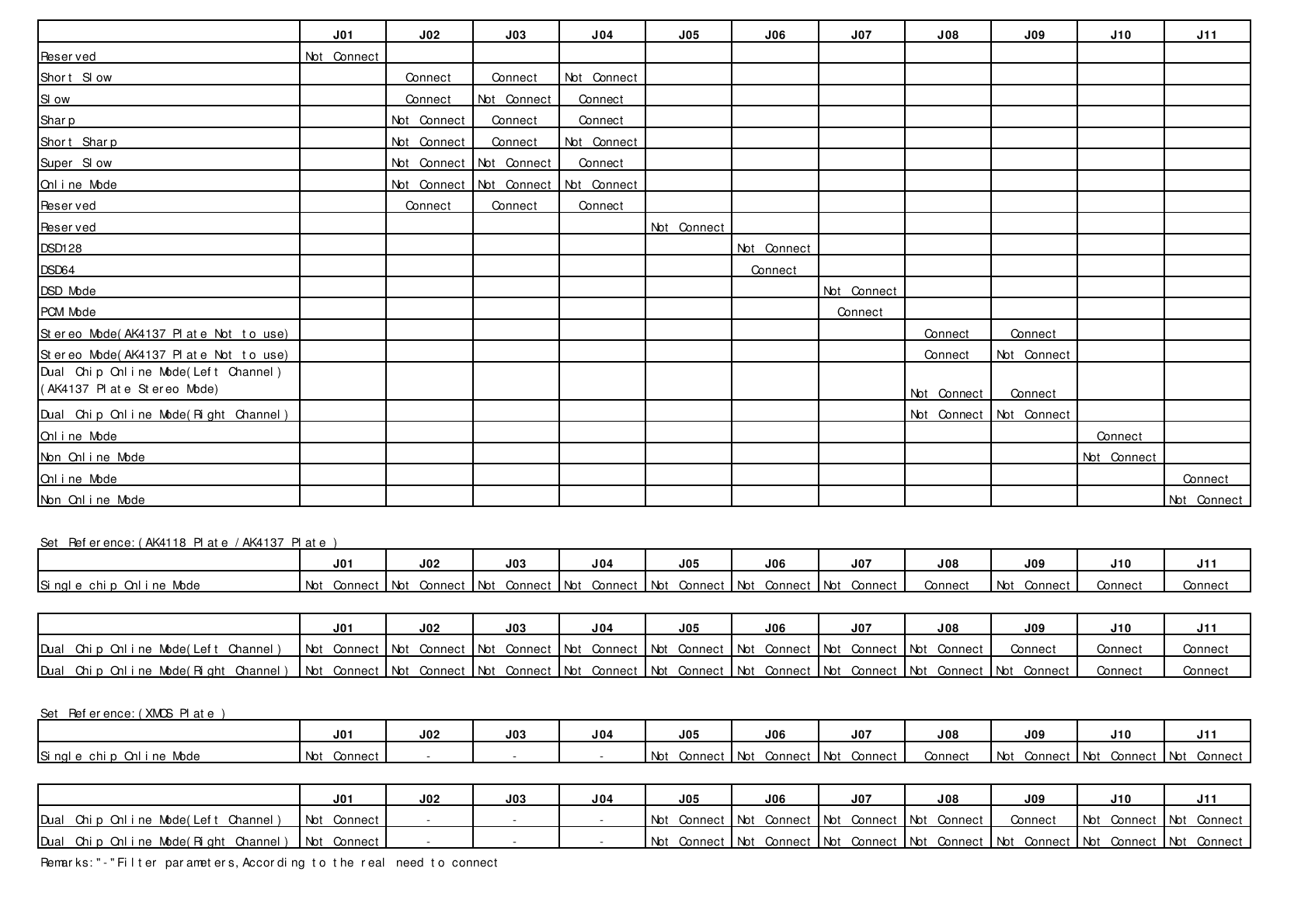

I have the single chip version of this DAC with a JLSounds XMOS device. It sounds good, except that it is currently in mono. That is, the right channel data is coming out of both channels.
I'm guessing that the micro is configuring the DAC for dual mono output, but how can I change this to stereo? The info for the jumpers is in Chinese, which I can't read. Could it be anything else?

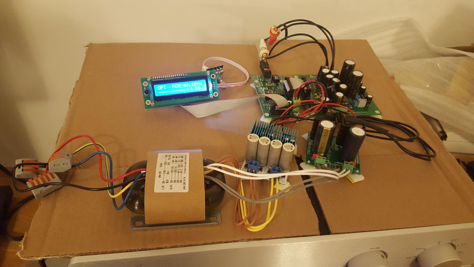

I got the test system up and running and the sound.. wow! This a clear improvement over the previous built-in dac in the integrated amplifier advance acoustics MAP-305. This sounds much more precise and it makes the old dac sound like kind of dirty and stuffy.
However I had trouble with the jumpers as I didn't get any sound when I connected J10 and J11 only. I got it working when I connected J2, J3 and J4, but I think this is stereo mode and not dual mono? Any advice with the jumpers when using AK4118 with the AK4495?

Here you go :
Coding switch Instructions:
Open the key: short press to switch AK4495S filter parameters, long press (greater than 0.5S): switch the input channel
Coding switch right rotation, the volume increases
Coding switch left rotation: reduce the volume
USB module switch: The volume is set to "0", short press key, you can switch (OUR XMOS module / Italy Amanero USB)
Right channel phase: The volume is set to "1", short press key, you can switch (2016 VR2.4
Only after version)
Rch Out reversed: Options suitable for connecting two monolithic 4495/4490 board
Rch Out Positive: Options suitable for connecting a single chip or board 4495/4490
DUAL_AK4495S board
Here you go :
Only after version)
DUAL_AK4495S board
Thanks for explaining this! I manage to change this right channel mode but I'm not able to hear any difference what so ever.. :confused:
I have the board without J08 and J09, so I assume the pin config in your post #89 is correct for this. However when I close J10 and J11 when trying to enable online mode, all I get is complete silence.. :confused:
Even without online mode I'm very pleased to the DAC, but if there is simple way to fix this please let me know :)
Here is my finished DAC project. :)
Overall I'm very pleased with the result and the sound surprised me. I did not expect so clear difference compared to the previous DAC integrated in the Advance acoustic MAP-305DA amplifier. I did expect that changing the amplifier to Exposure 3010S2 would improve the sound more than the changing the DAC but surprisingly it's the DAC that improved it more.
Casing is DIY designed and manufactured with factory tools. The case dimensions are matched to the existing amplifier including the power button and knob locations.. The sheet metals were made at my work "protoshop" and also powder coated. The front plate I got machined according to my drawing by minishow seller in ebay.
In the casing I first went to RAL7016 (anthrasite grey), but it looked too light and little dirty. The bottom part is still painted in this color but the cover is repainted to RAL9005 (matte black). In the back side photo you can see the difference between 7016 and 9005. It looks so much better in black! :spin:
As you can see.. I didn't follow the recommended diameters for the e-caps.. Fitting too large e-caps required all the scarce artistic skills I had! :D
For more photos of the whole project you can check on my website.
