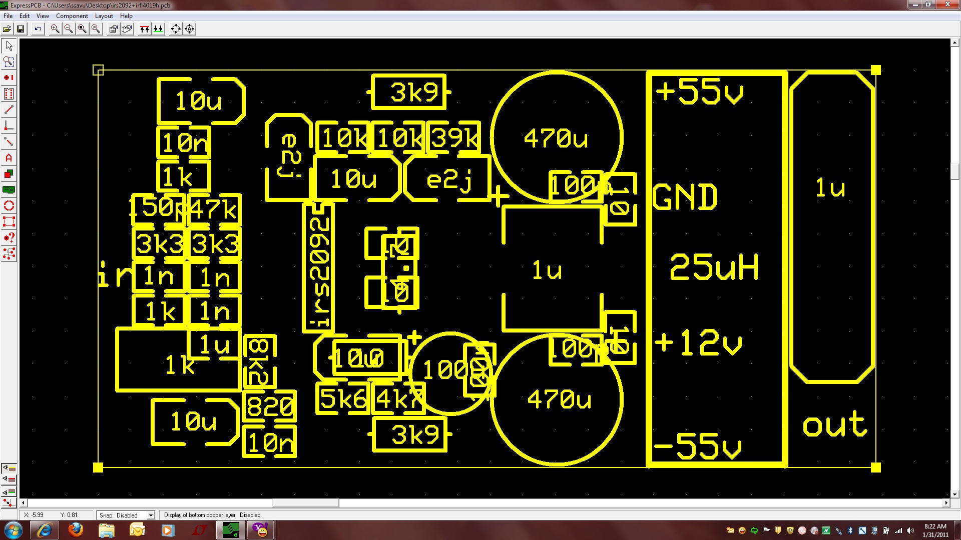

Dual layer PCB with second layer being only ground
After my PCB design for class D failed miserably, i noticed that it would have probably worked good if the ground plane i tried to do (and ended up being nothing but trouble) would have been a dedicated ground plane. And i'm thinking to do just that - leaving the PCB design as-is, just using thicker traces and a dedicated ground plane on the top layer. The design is all thru-hole btw. I can do SMD but since i have all the parts and they have tested working on a stripboard (and not working properly on my current PCB), and just got a little PCB drill which is really handy, i thought it'd be fun to do thru-hole. Improvising vias with a piece of wire going from wherever needed to the ground plane won't be too hard, and it sure is gonna look funky with all that copper on top.
Has anyone done this type of board before and has useful insight about it? If not, i'll probably make it anyway to see what gives.

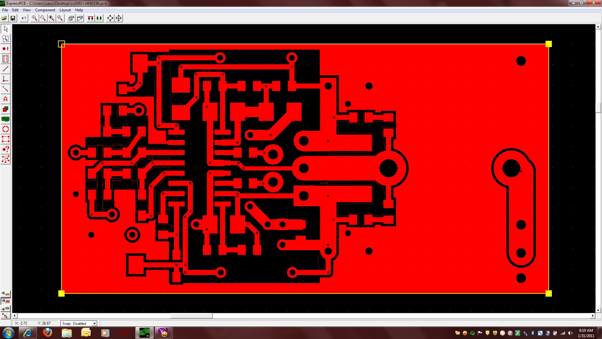

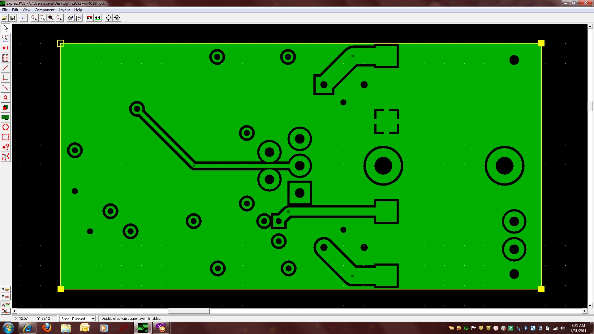

Hello,
Ground planes are mandatory for class D amps. IR has some application notes on IRS2092 describing the importance of ground planes and how they must be designed on different stages of a class D amp.
Attached you will find an example.
regards,
savu

I've done loads of boards of all kinds. A board that doesn't work as-is is unlikely to spring to life just because you pour a ground plane over one side. Sort out the return paths on the board, keeping them as short as possible, and keeping (powerful) switching signal returns away from and definitely not crossing less powerful analog returns before you pour the ground plane. Ground planes can make you lazy in your layout if you are incautious.
w
always ask Where is the current flowing?
when sticking to just 2 layers you should consider added power bus bars and jumpers as options that can improve electrical performance
especially with mixed signal, switching circuits the circuit connection's parasitics and mutual coupling are major determinants of the product performance
if you're not going for at least 4-layer PCB then you need to abandon the idea that you can get all of your connections on the 2-layers at the same time as controling the coupling and parasitics

My PCB worked fine without a ground plane.
I kept things as close as possible to the 2092.
Loads of careful decoupling.
Plenty of decoupling around the 12vregulator.
A class D amplifier may appear to work fine but still suffer from self disturbance at high output currents and extreme duty cycles.
Decoupling becomes useless when only a few cm of PCB tracks are added between the capacitors and the load. A ground plane reduces PCB track inductance considerably and allows for longer PCB tracks (and makes decoupling more efficient even when distances are short). On low voltage supplies, I use local decoupling with high value (1uF) SMD capacitors to ensure that the resulting LRCRLRCR..LRCR string is reasonably damped (or resonates at frequencies too low to cause trouble, (the Cs are the SMD caps, the Ls come from PCB tracks joining them, and the R comes both from caps and PCB tracks).
The problem with a 2092 circuit is much of it doesnt rely that much on ground.
The output mosfets switch from b+ to b- and vice versa.
So I make the b+, gnd and b- tracks as thick as possible.
Add to this careful decoupling and it works fine without a power plane.

It eventually turns out there was nothing wrong with my layout. It was all about decoupling capacitors... or lack thereof. I had 100nF decoupling caps on all parts - opamp, comparator, drivers, mosfets. I had also left spots for rail decoupling caps and output caps for the voltage regulators. Only... i forgot to fit them. Took me a while to realize it. :smash:
I disconnected the gate driving caps and started probing around with my scope. The comparator was still oscillating even without the final stage working. There was about 70mV ripple on the positive 12v rail, 4 volts on the negative... Whaaaaaaaa???? FOUR VOLTS??? The 7912 was oscillating.
I fitted the 1uF output capacitor for the 7912 and it went away like magic. I reconnected the gate driving capacitors. There still was trouble with the pmos gate drive - it would swing back and forth several times during the cycle. Actually the problem wasn't with the gate drive - it was the power rail swinging down! :eek: 47uF caps on the rails and it's gone. The 6800uF main caps are near the transformer, i'm using a mains transformer for testing. A meter of wire between caps and PCB sure makes funky stuff happen.
I still have a little problem - the n-channel mosfet is taking too long to turn off, but i'm sure i just need to adjust the resistors in the driver circuit. The waveforms look clean now.

I traced the slow turnoff (and the fact that the mosfets were still heating like crazy) to a shorted 1N4148 in the pmos drive. I replaced it. Afterwards BOTH waveforms were looking "slow" and things got even more toasty. Which led to the original mistake. That was... wait for it... i had wired the 1N4148s backwards. :eek: Cross conduction ahoy! I fixed that and the amp is now working fine. The heatsink is still getting *a little* warm, but that's the dead time resistors requiring some tweaking, the residual output is a pure sinewave, dead time is zero. :)
Thank god for the lightbulb before the transformer otherwise i would have been looking at a pile of fried mosfets instead of just heating up. ;)
