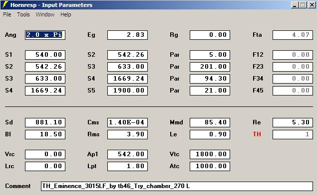

Just one more 3015 TH Sub
Try these values in Hornresp:
ID=28.00
Ang=2.0 x Pi
Eg=2.83
Rg=0.00
Fta=4.07
S1=540.00
S2=542.26
Par=5.00
F12=0.00
S2=542.26
S3=633.00
Par=201.00
F23=0.00
S3=633.00
S4=1669.24
Par=94.30
F34=0.00
S4=1669.24
S5=1900.00
Par=21.00
F45=0.00
Sd=881.10
Bl=18.50
Cms=1.40E-04
Rms=3.90
Mmd=85.40
Le=0.90
Re=5.30
TH=1
Vrc=0.00
Lrc=0.00
Ap1=542.00
Lpt=1.80
Vtc=1800.00
Atc=1000.00
Pmax=500
Xmax=11.0
Comment=TH_Eminence_3015LF_by tb46_Try_chamber_270 L

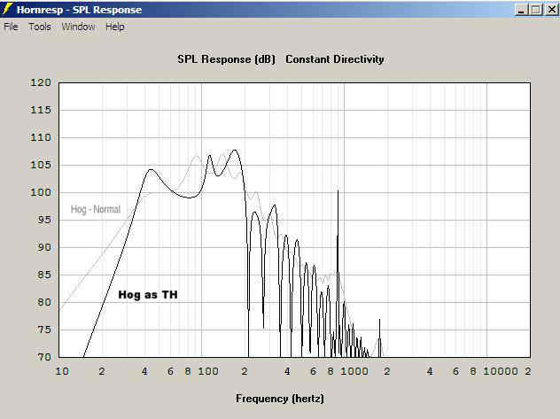

Hi CuttaBoi,
Here are the SPL response plots I had seen before. I don't recall the source for the Hornresp input data. When I get "a round to it" I'll try to take a look at the hopefully up-to-date data on freespeakerplans. Thanks for the link.
HOG Scoop

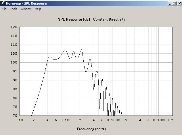

Hi again,
As close as I can simulate: the HOG Scoop has a net volume of 511 liter, is externally about 35.5"Dx25"Wx38.8"H, and the SPL response in Hornresp simulation (using the PD.1850, factory T/S) is attached:

QUOTE=tb46;2308603]Hi again,
Regards,[/QUOTE]
This is probably a closer approximation.

I'll hopefully not show my ignorance on rear loaded scoops here.... However, most scoops I've heard have this weird 'phase' thing going on, where the front and back waves of the driver meet and interact with each other in the listening space. In my mind.... a tapped horn, where the driver is inside the horn path allows that interaction to happen within the horn. What exits the horn has nulled/summed/interacted in whatever manner -- and its output is consistent within itself once leaving the cabinet. It's this interaction that must give a TH its directionality and other properties. It's also what prevents 'horn extensions' 'v-plates' etc from working like they do for front loaded horns.
The hog is an interesting design, because it's almost tapped horn and almost scoop. (at least it is visually)
I'm with oliver on this one though -- With huge respect to staiper, I believe in the same space as a scoop, a well designed TH can equal or beat a scoop for output, and do it with (in my mind) a more pleasing, less 'phasey' output. (as evidenced by danley's commercial designs) This is speaking in generalities only, as scoop/bandpass/tapped horn is a slippery slope, and determining exactly where you are on that slope is an iffy proposition at best sometimes.

Hi CuttaBoi,
I hope that hellonwheels doesn't mind all the HOG Scoop discussion.
To get some, hopefully not completely wrong, data I overlayed the HOG Scoop plan (in ACAD), and scaled it until the height and depth measurements fit. I then made some assumptions as to where I wanted to place S2/3/4 to arrive at a Hornresp Input, what the volume of the troat chamber is, how much volume the driver displaces in the throat chamber,.... Working backwards from a drawing like this, there are actually a few options, and I didn't want to take more time than the Sunday night football game. I got the data for the PD.1850 from the manufacturers website, and used Hornresp to compare how close this data is to calculated values. The result is the SPL response in Post #11, better than the responses posted in Post #10, but I think it can be improved. At similar size jbell's stadium tapped horn is clearly better, and its simulation can be marginally improved too.
This gave me a little extra time to think about the general classification of the HOG Scoop, and my conclusion is still that it is a tapped horn, and not a scoop. A great thread to read up on is screamerusa's thread that resulted in the fury box. The tools for designing tapped horns have been getting better and better, especially because of David McBean's continuing effort. It stands to reason, that at least the box simulations should be getting better too.

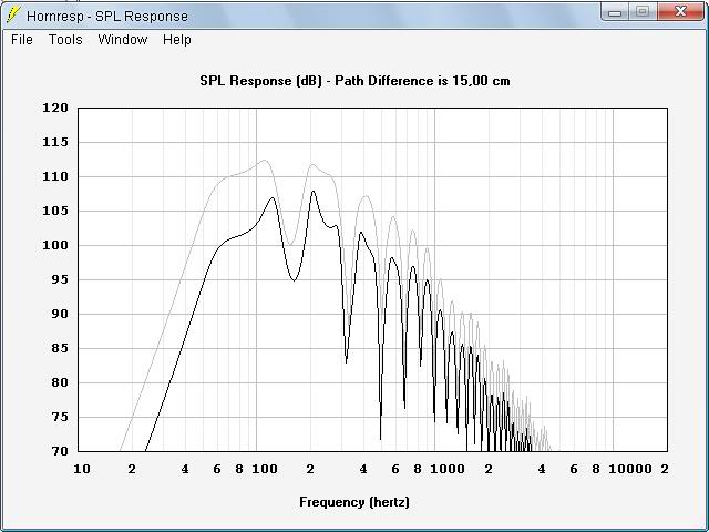

I have no problem with expanding the scope of discussion, esp. when DMcB, WHG, et al are involved. In 270 liters its hard to beat a direct radiator design. With two 8" vents the max air is a leisurely 15m/s. No port compression there...
125db spl@40Hz 130@80...
From what I can see is 2 of the Martinsson boxes will exceed it in only 320l and more than 2x the driver cost... tb46 how come you can't get the same thing with the 3015lf in 160l?? it actually has a bit more xmax. Lumpy is ok if it has the extension.
Of course its not possible for me to move the 150 lb 270l 2x18" vented. I would like to see the 3015lf in a very well braced, extremely light yet stiff enclosure around the size of the martinsson horn. That would be the pound for pound performance winner, also in a small package, yet hitting 125@40 and going up from there.
