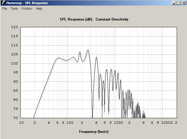

so i narrowed my quest to the Keystone and the SS15
now i am wondering if i can cut dimmensions by 2 or 3 inches
on width or deepth and compensate on height to maintain the volume of the box
is there any comparision around here about a keystone and a ss15
btw, there is a cubo sub also around
does anyone have have seen it
Hi maxo,
"...now i am wondering if i can cut dimmensions by 2 or 3 inches
on width ..."
I did that in the singlesheet thread (singlesheet same as SS15), don't remember where or when, but anyhow, here are comparisons between the Hornresp SPL plot for a standard SS15 v. narrowed boxes (narrowed by 1.5"/3"/5"). (The faint trace in the "background" is the reduced box size SPL.) No make-up necessary. Stay w/ the Eminence 3015LF, and the recommended 1/2"nom plywood.
Thanks oliver,
on the graph with the 5" more narrow cab
you can see a little dip around 100hz of like 2 -3 db
so i can live with that , that dip you can compensate with eq i think right ?
anyway i will cross my tops at 120 or 150 as thye are 12's
THanks Dude you da man for making those graphs possible!!
