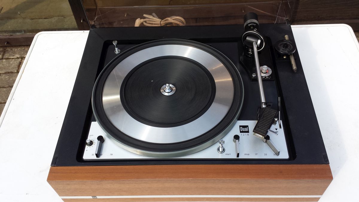

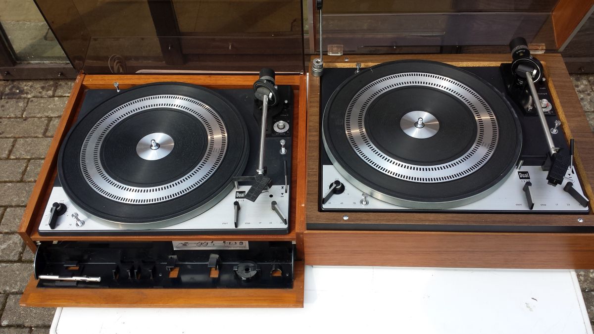

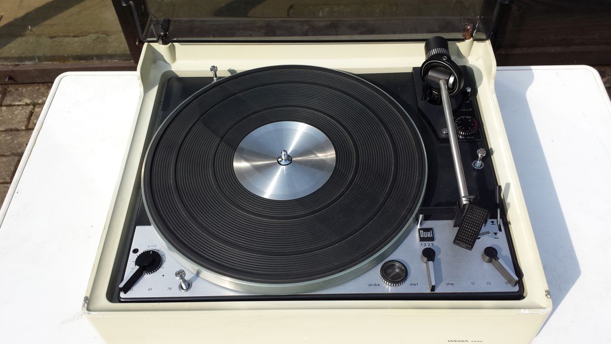

First picture shows a 1218, three speeds, heavy 11" platter.
2nd are both my 1219's, three speeds, heavy 12" platter. Left one in an original Dual CK 21 plynth, right one in a plynth that supposedly has been built by a previous owner by modifying a R2R recorder case.

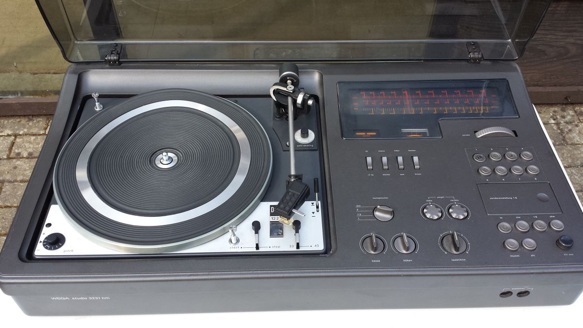

3rd is a 1228 sitting in a Wega Studio 3231 hifi console. Two speeds, heavy 11" platter, in-built strobe. Note the warped mat that I still have to replace.
4th is a 1229 in a Wega plynth. 3 speeds, heavy 12" platter, in-built strobe.

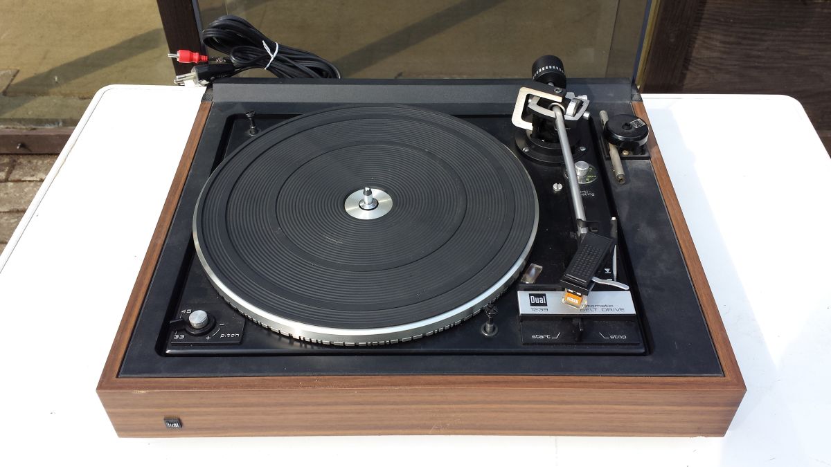

5th is a 1239. 2 speeds, lightweight platter, in-built strobe, belt drive (all the others are idlers).

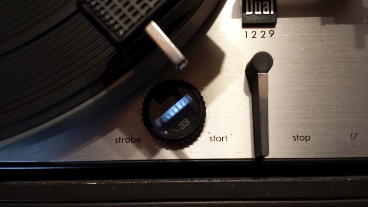

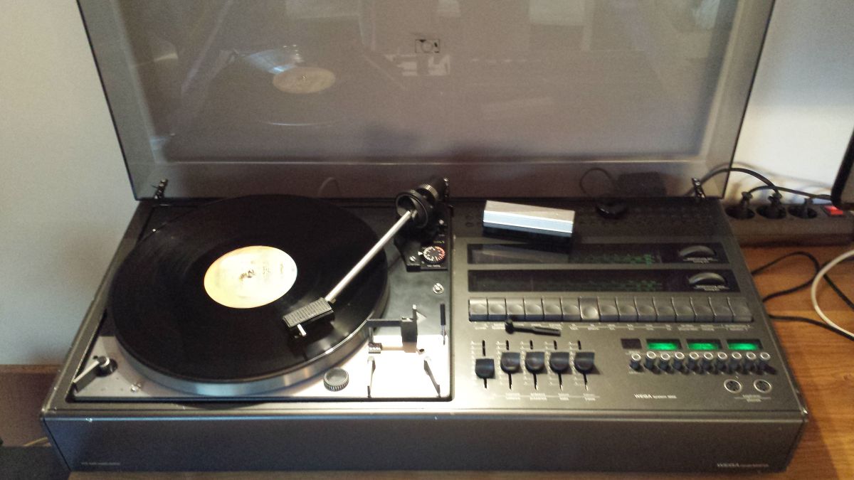

6th is a 1229 in a Wega Studio 3220 hifi console. Note the levers that came from a 1219 and the strobe that I've converted to LED's, due to defunct and obsolete neon lamp. It is shown in pic #7. This presently is my everydays' listening equipment.

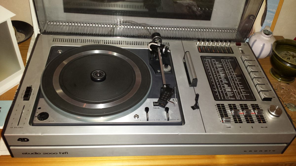

8th shows a heavily modified 1226 in a Grundig Studio 2000 HiFi console. I used the chassis of a 1226 that I've got with a broken tonearm and replaced it by the arm of a 1228. The shadow pole synchronous motor and the platter are from a 1228 as well, so this TT basically is a 1228 without the strobe now.
Best regards!

This tiny plastic cap called Steuerpimpel in German is well known as the most probable reason of a failing automatic function. In TT's of that age, it most probably is broken, worn - or even missing.
Amazingly, the left hand sided 1219 shown in pic #2, which I've pulled out of the local dumpster about a year ago and is one of my oldest TT's with a very low serial number, but it's pimple appeared as new!
Best regards!
