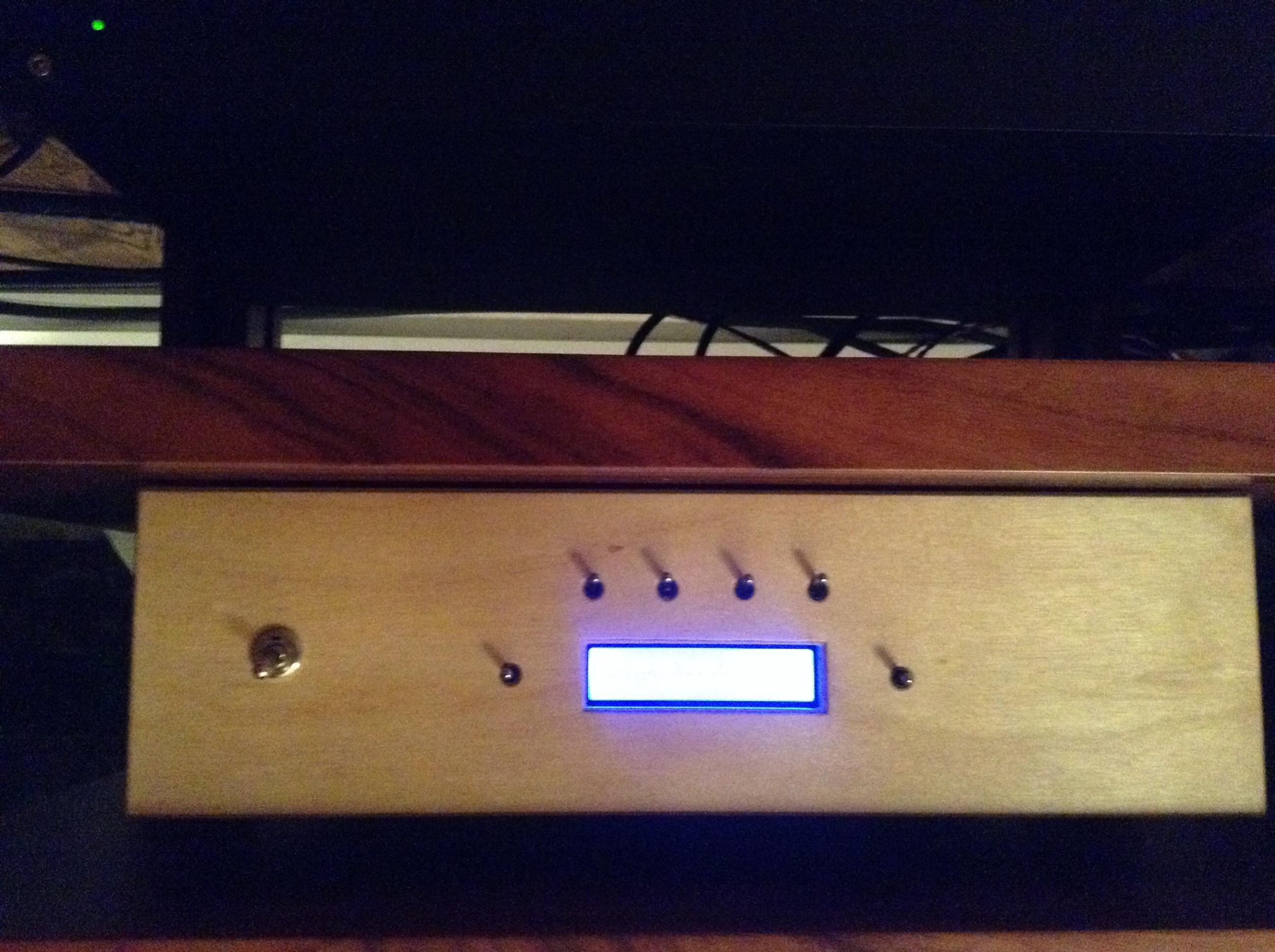

Here's a photo of my Najda. I've now got the hard work of sorting out the filters, but I'm really pleased so far. Thank you so much! (NB: I used the Meanwell 35B power supply - it seems to work well. The 'buttons' are all spring return switches - the up/down and left/right being two way. I've yet to do the IR. The LED is from eb@y - despite the fact that I live in HK, sourcing that was painful!)
Excellent news, it's really great to see your build - and wouldn't mind close-ups! (I actually can't see the leds!).
That's an original front panel you have here. How do you use the switches to navigate through the menu and select/discard items?

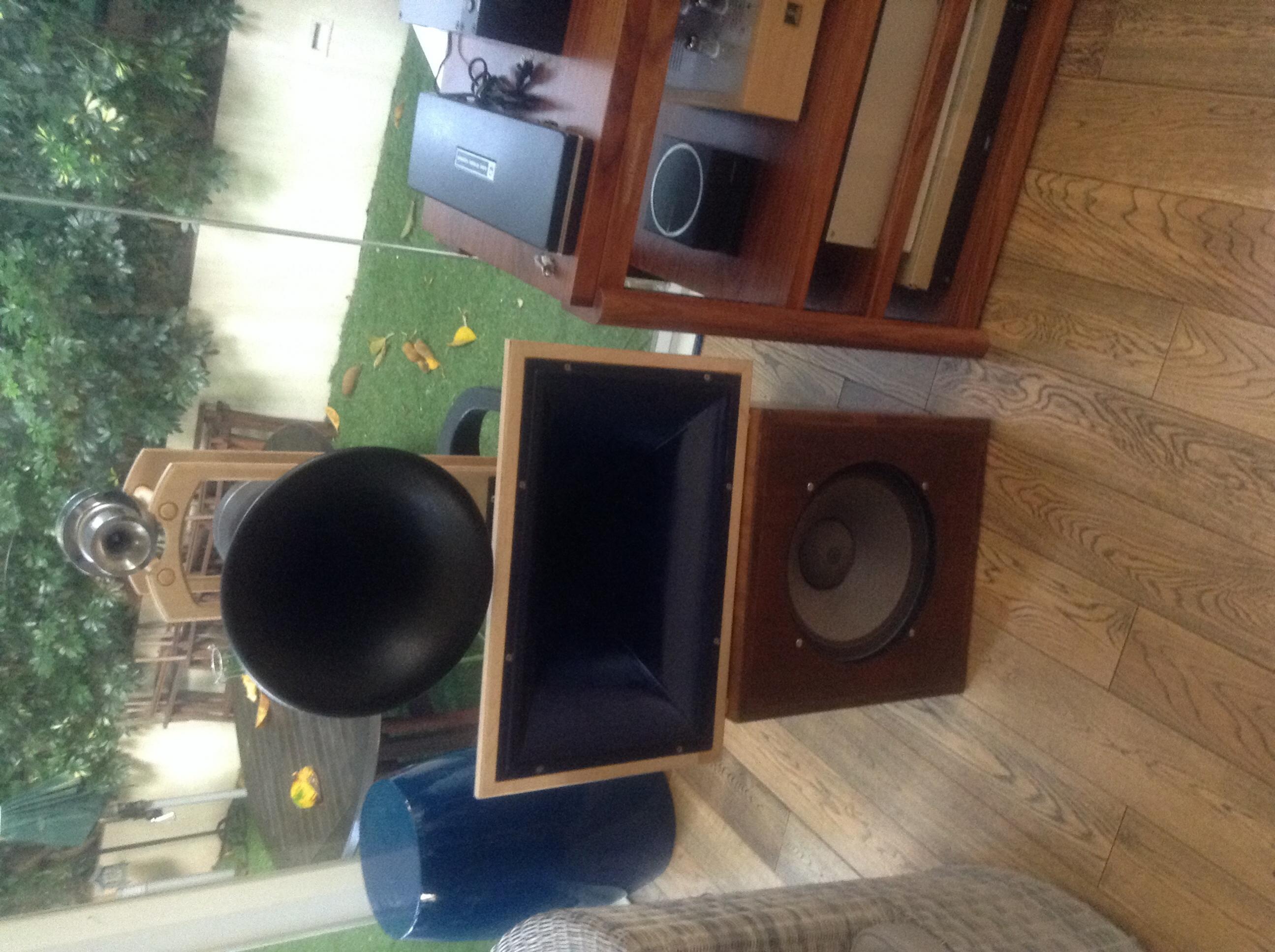

The Najda is now playing music through my "big" DIY speakers (Seas T25CF002, prop 6.5" mids and prop 12" woofers) with my three channel LM4780 amps. If it works out I'll build another amp that will be 6 channels in one.
For some reason the IR receiver is not working but I'm sure that's my fault so I'll fixa that later. First I want to adjust the Najda for a rough initial setup. So far I'm just testing with woofers crossed at LR24-80Hz, mids at LR24-80Hz/2500 Hz and highs at LR24-2500 Hz. Sounds pretty good so far.
Hi - sorry, I should have been clearer: I was referring to the LED display. I haven't put the LEDs in yet, as I couldn't decide on a pleasing arrangement. The switches are in effect equivalent to push-on switches. The bottom four are just one way (push up is on), while the two at each end of the panel are two way - the left is orientated vertically for volume, while the right is orientated horizontally to scroll left/right through menus. It seems to work OK. Again, I just couldn't find decent push on switches here. As for the front panel, it's 18mm birch ply that I brought back to HK last year for another project, which didn't work out. I don't have the tools to mill the needed square slot in the aluminium panel that came with the case, but I have enough to do small jobs with wood, and to drill holes in aluminium (although despite my best efforts the back panel holes are a mm or so off where I wanted ...).

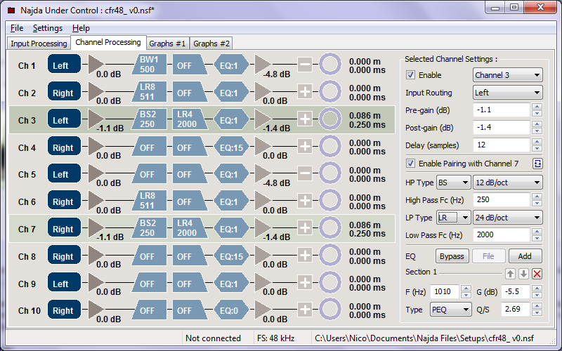

About the pairing, it took me a while to figure out that you actually need to make changes in one channel, for the paired channel to update its settings. It would be far more intuitive if the pairing was automatic, and the paired channel (f.ex. channel 5) was greyed out, meaning that it will mimic the behaviour of channel 1, so no adjustments are possible.
The combination wood panel + old-style switches makes this distinctive 'vintage' look that goes well with the tubes, I like it!
I'm looking at improving the visual feedback of the GUI. I might actually pull out a revision where the paired channel is also highlighted (in a slightly different colour than the selected channel).
Sounds great. If you could also transfer the channel settings as soon as the pairing checkbox is ticked, I think we're all good.Thanks Bo, great to hear that (as much the comparison outcome as the potential new friends in Sweden )!
Alright, I understand now what you meant when you wrote 'automatic' in your previous post
The pairing option is not a copy button. Pairing starts when the option is checked: from this moment everything you change on one channel is replicated on the paired channel. You can anytime uncheck the pairing option and make changes that are proper only to the channel you're working on (then pair again later if you need that).
So it's actually not planned to copy the parameters to the paired channel when the option is checked. If you wish to have 2 channels that are identical in terms of processing parameters, just set the pairing at the start and leave it on all way through. Does this make sense?
