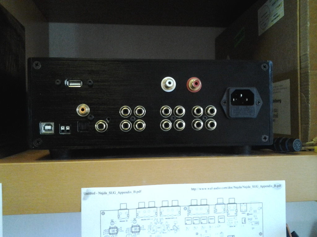

All input alternatives tried and all works like a charm :)
Connected the WaveIO over the uf.l connector as described in
the manual (no 5v needed).
Great to hear mate! Where are the pics? :D
I don't have the WaveIO datasheet details in mind - but probably you didn't need the +5V/+3.3V because the u.fl's are not isolated. Please see with Lucian, he stll has a Najda loaner to play with so he should be able to tell.

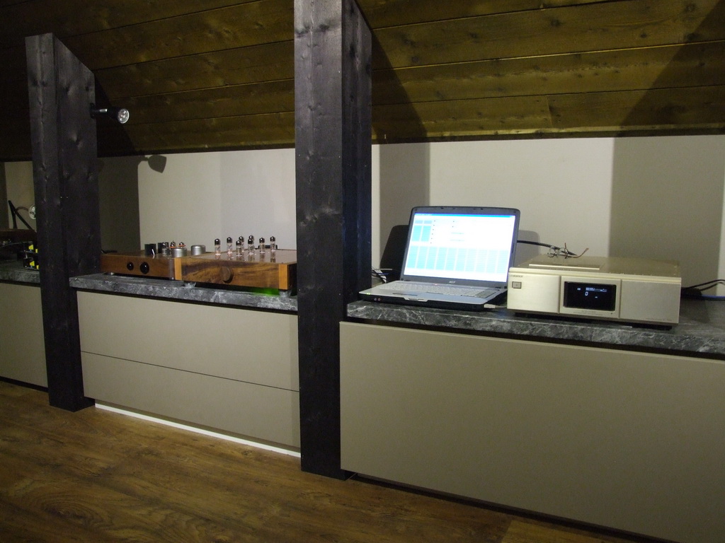

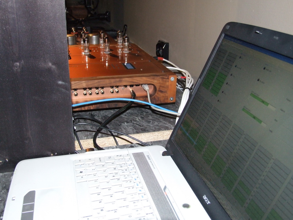

Pictures :)
You are right about the uf.l's, they are not isolated.
