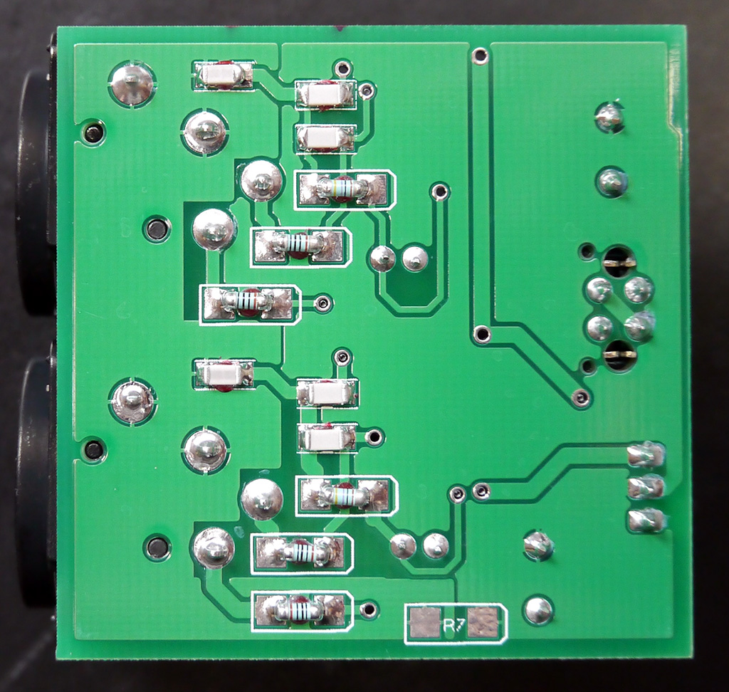

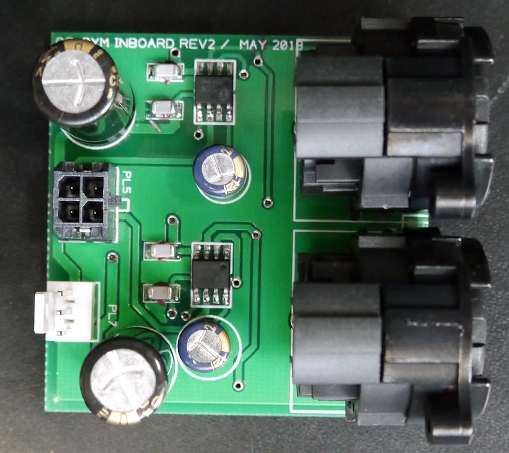

here are the top and bottom of input board
Hope this helps
For the input board,
Nothing fancy here I followed the design sheet.
as I' decided not to touch the Najda board itself, I've just added input- output boards to the existing circuits. So yes, it is connected to the back of the RCA connectors because of its reversibility.
Due to the box I selected I had size constraint so 50 mm max for the 2 inputs board and 100 mm for each of the 4 output boards. (25 mm between each XLR)
I selected That Corporation IC 1200 serie for the input and 1646 for outputs for their good performances.
I added also RFI protection on inputs so I had to use CMS for that specific small board. Output board uses "normal" components.
To increase the input margin from 1V RMS to 2 VRMS, I selected 1206 chips (-6dB) but of course 1200 model (0 dB) could be soldered too.
Hope this helps

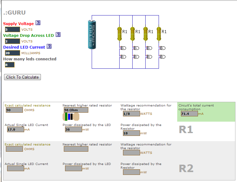

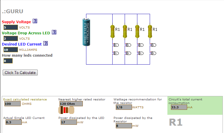

Nick, this is what a web base calculator has come up with for the LED's.
74ma seems to be the current draw so it should be OK?...
It surely depends on the LED used but 8 LEDs with 17,9mA each could sometimes be rather strong illumination in a decently dimmed room. Have you tested with the intended 8 LEDs in real life? Mike
