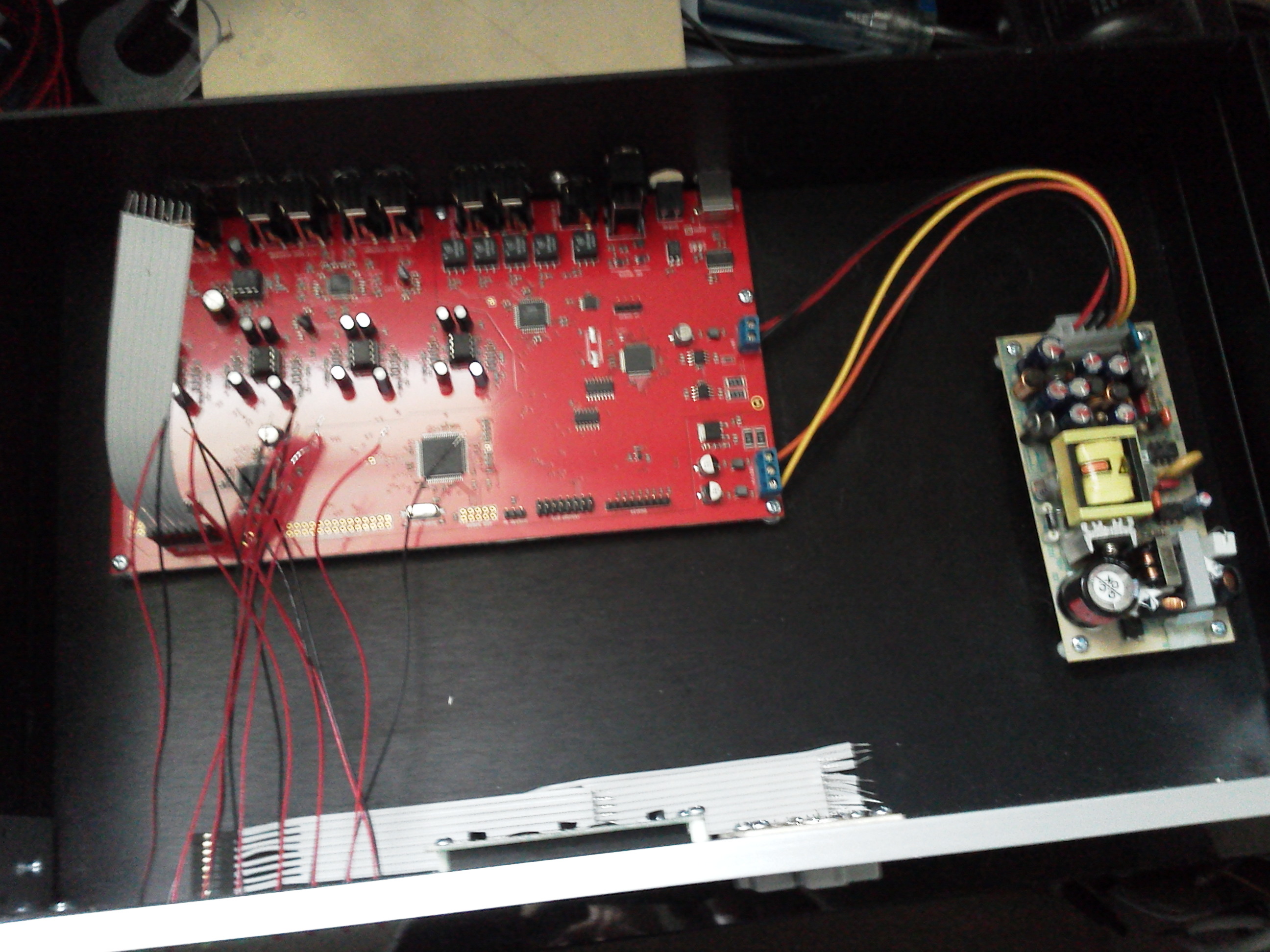

Microtips Technology LCD Display 2 x 16 MTC S16204A 2 Lines x 16 Character | eBay
Pin designation:
Pin 1: Vc----------------?????
Pin 2: Va----------------?????
Pin 3: GND---------------1
Pin 4: VDD---------------2
Pin 5: VLC---------------?????
Pin 6: RS----------------4
Pin 7: R/W---------------5
Pin 8: E------------------6
Pin 9: Data 0-------------7
Pin 10: Data 1------------8
Pin 11: Data 2------------9
Pin 12: Data 3------------10
Pin 13: Data 4------------11
Pin 14: Data 5------------12
Pin 15: Data 6------------13
Pin 16: Data 7------------14
This project has been on the backburner for some time but now I've
started it up. Ran in to a problem rigth away. The display pin connections
wasn't named the same way so now I'm sure I'm putting it together the rigth
way.
Could someone tell me where pin 1,2 and 5 would connect to Najda ?
Seems that the display only has one "gnd" as well. Would both pin 1 and 16 connect to pin 3 at the display?
I found this helpful in mapping;
Najda pinout
Generic display pinout with common use abbreviations
The white on black displayfrom Polish seller, I just fitted was pin for pin the same as Najda.
The Maplin one had pin 15 and 16 as 1 and 2, and the rest following on from there.

I'm going for this, and hoping for it to work:
Pin designation:
Pin 1: Vc----------------16
Pin 2: Va----------------15
Pin 5: VLC---------------3

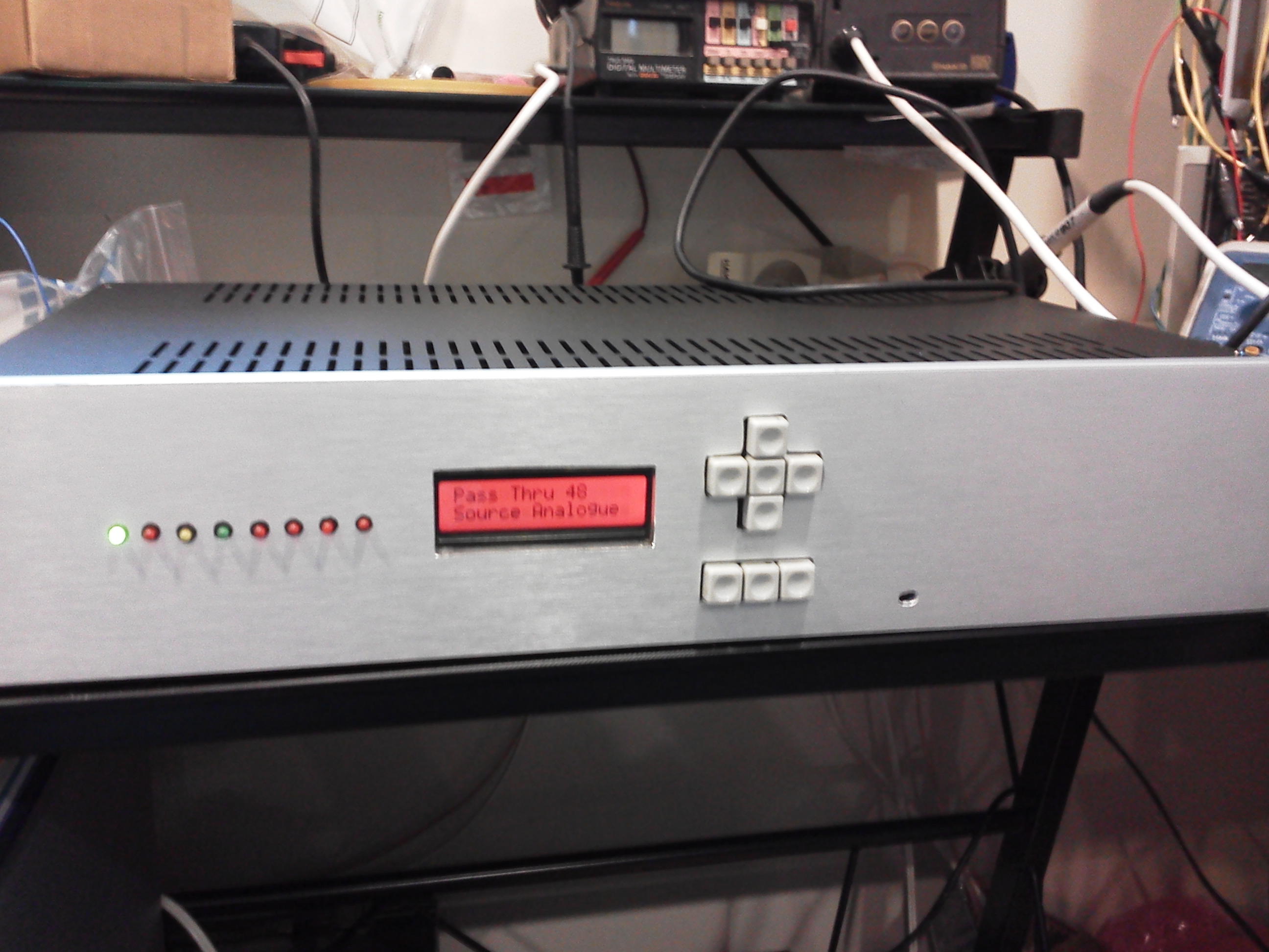

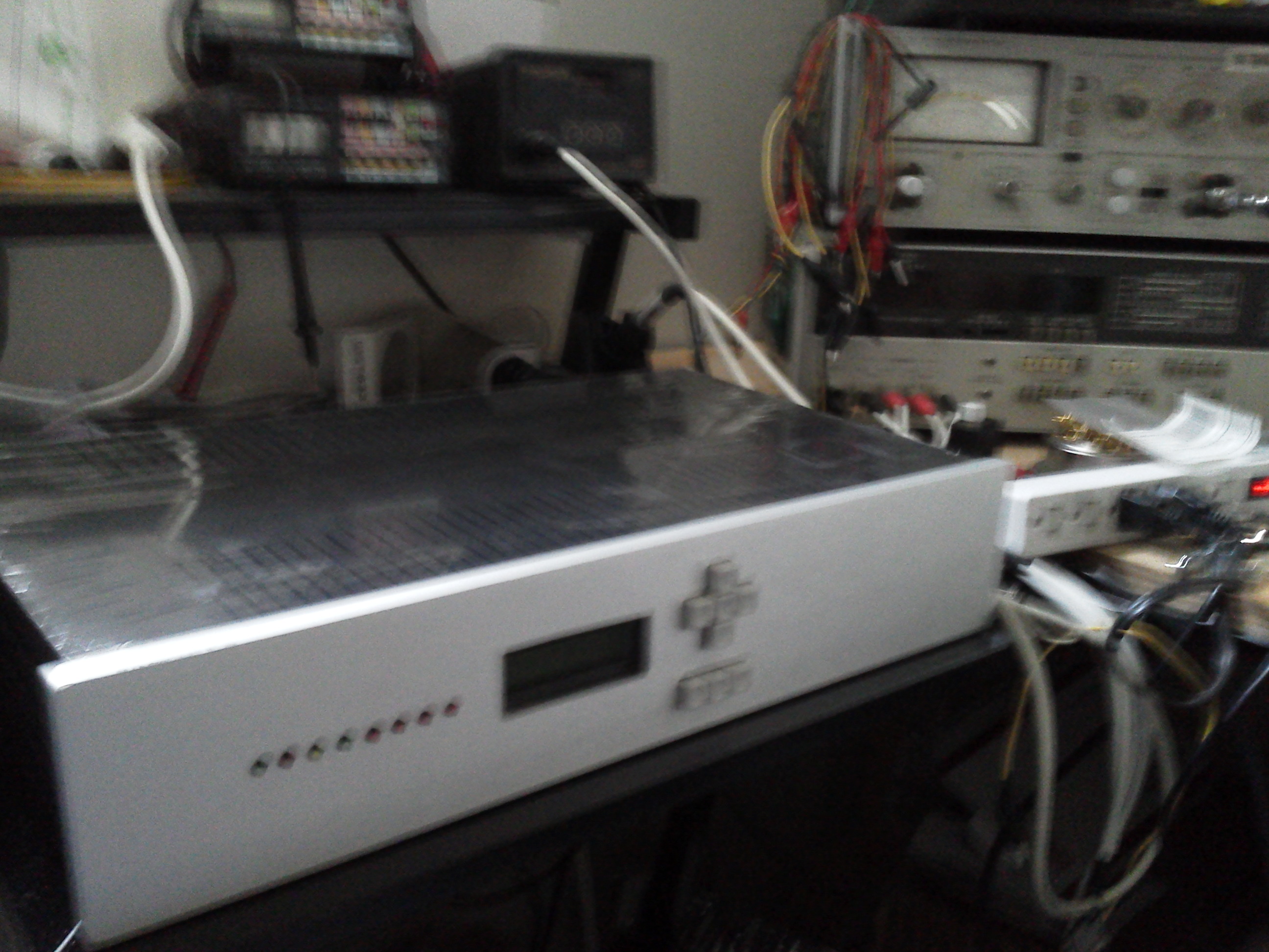

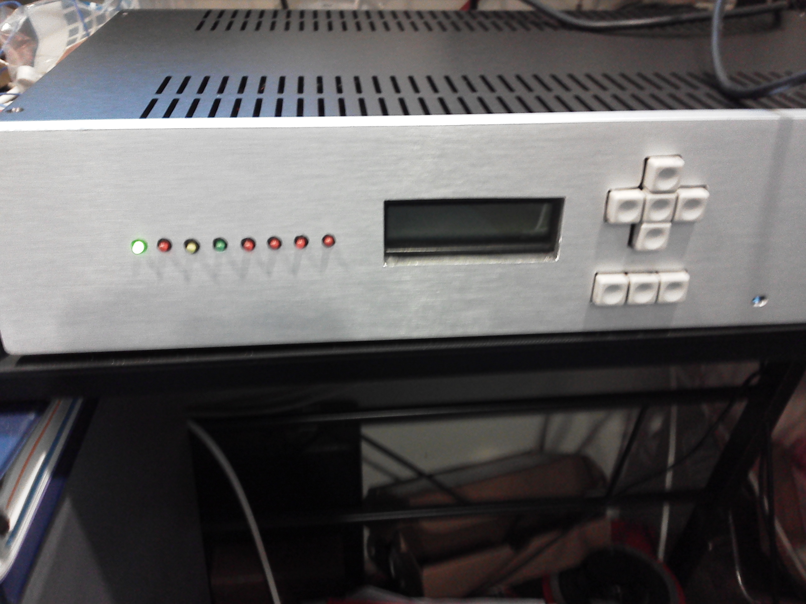

It works
Proof positive anybody can assemble one. Finding my eye glasses was the hardest part. All systems nominal. The green LED on the left is power on light so I know to shut it down when I quit. I searched Ebay for a Hitachi hd44780 compatible LCD, it works perfect. Case is from DIYAUDIO.com Working on filters now.
