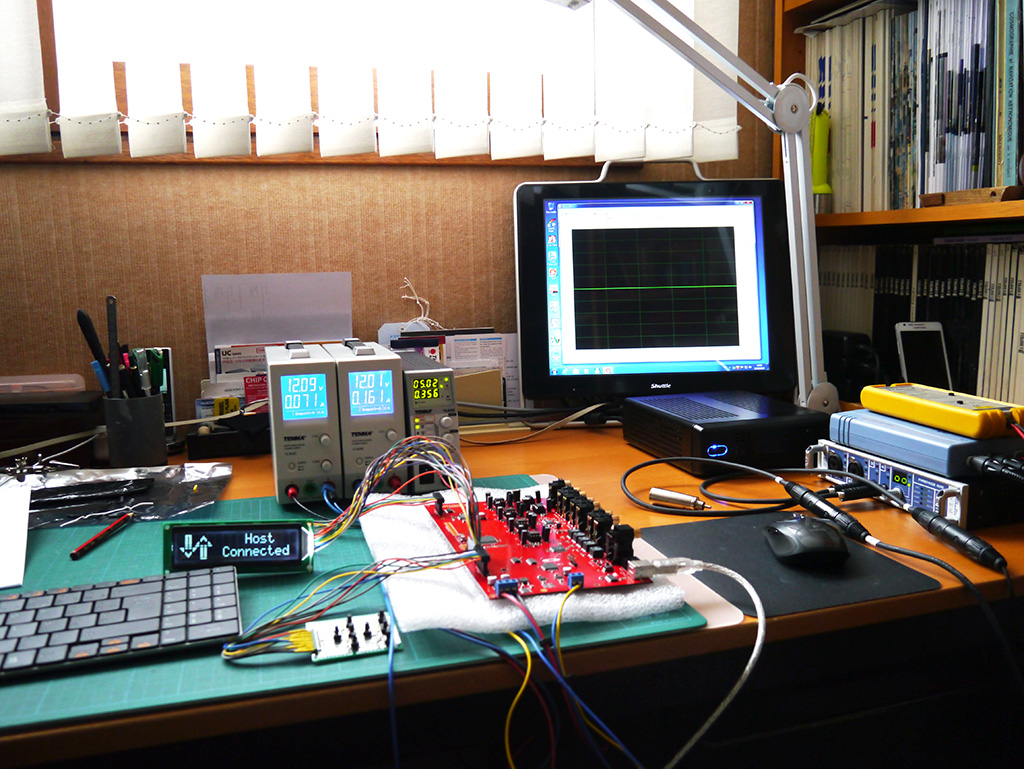

Ladies and Gentlemen,
I received my board yesterday... and fortunately I have a couple of days off. I did some interconnections yesterday evening and here is the first power on !
As you can see on the picture, the idle consumption is about 5VA (3VA on the +/- 12V) and less than 2VA on 5V. I measured 1.5VA in Standby mode.
On the right side of the picture is some of the measurement gear that I will use to check the board now.
Stay tuned
Best from France
JC

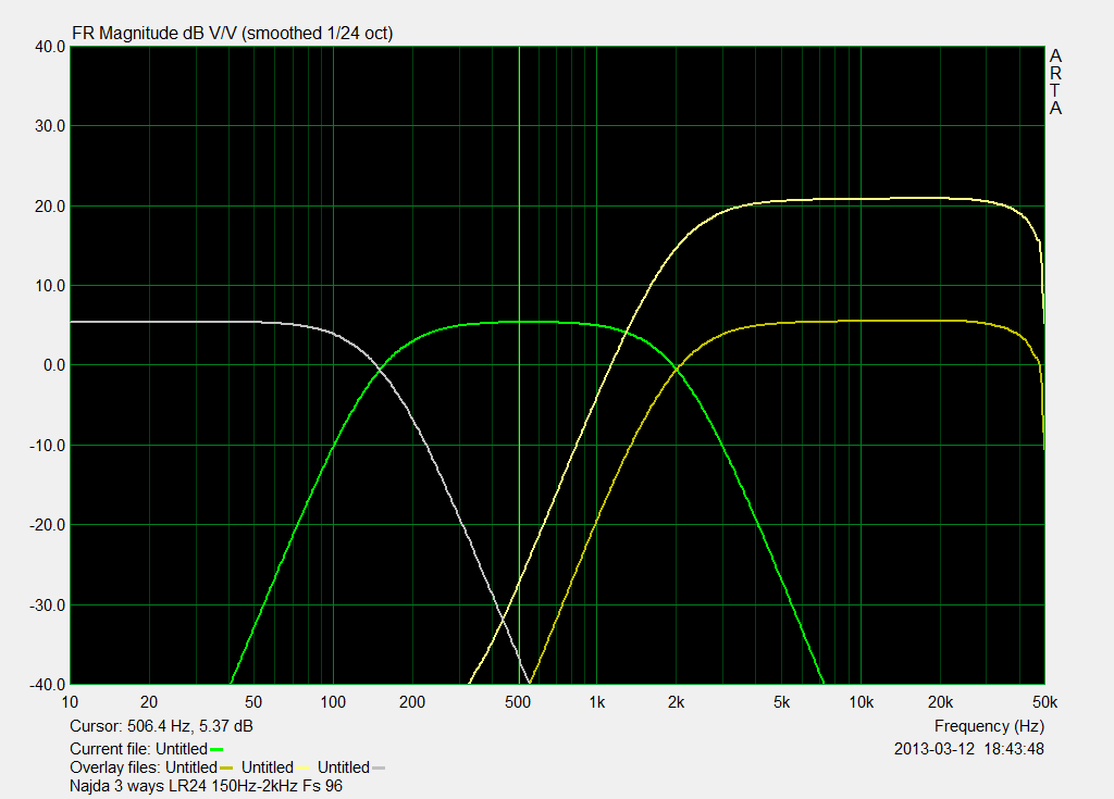

I have started to play with it...
On first picture where you can see measurement of a quick three ways Linkwitz Riley 4th at 150 and 2kHz. The additional high pass curve is the one with the the CS3318 set at 6.0 Vrms. Others are outputed with the nominal output set at 1 Vrms.

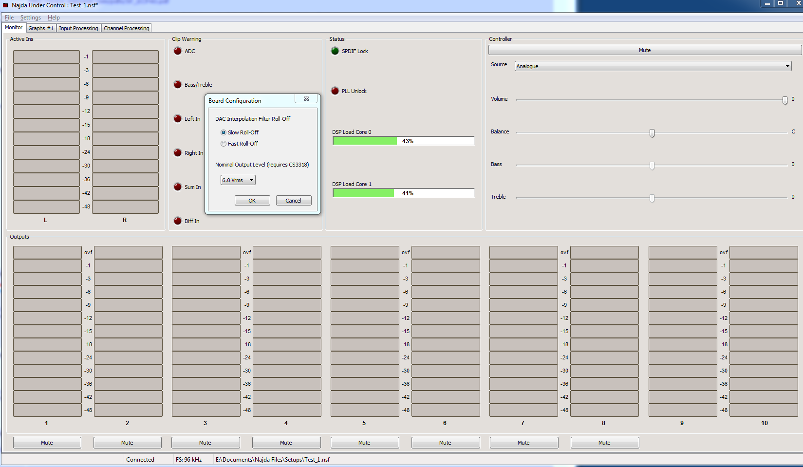

Second picture is to show the board configuration where you can set the DAC interpolation filter along with the nominal output.
Be aware of a small bug with the current version of software/firmware, the Bass / Trebble optional controls introduce a phase aberration even without any correction selected. Well, it took me a couple of hours, scratching my head with some measured phase deviation before tracking that one !

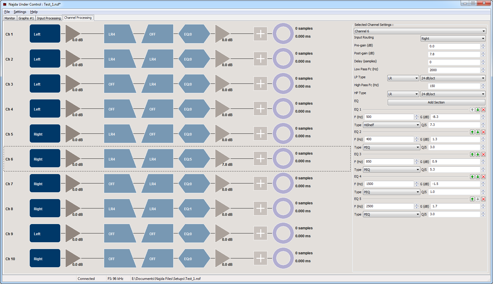

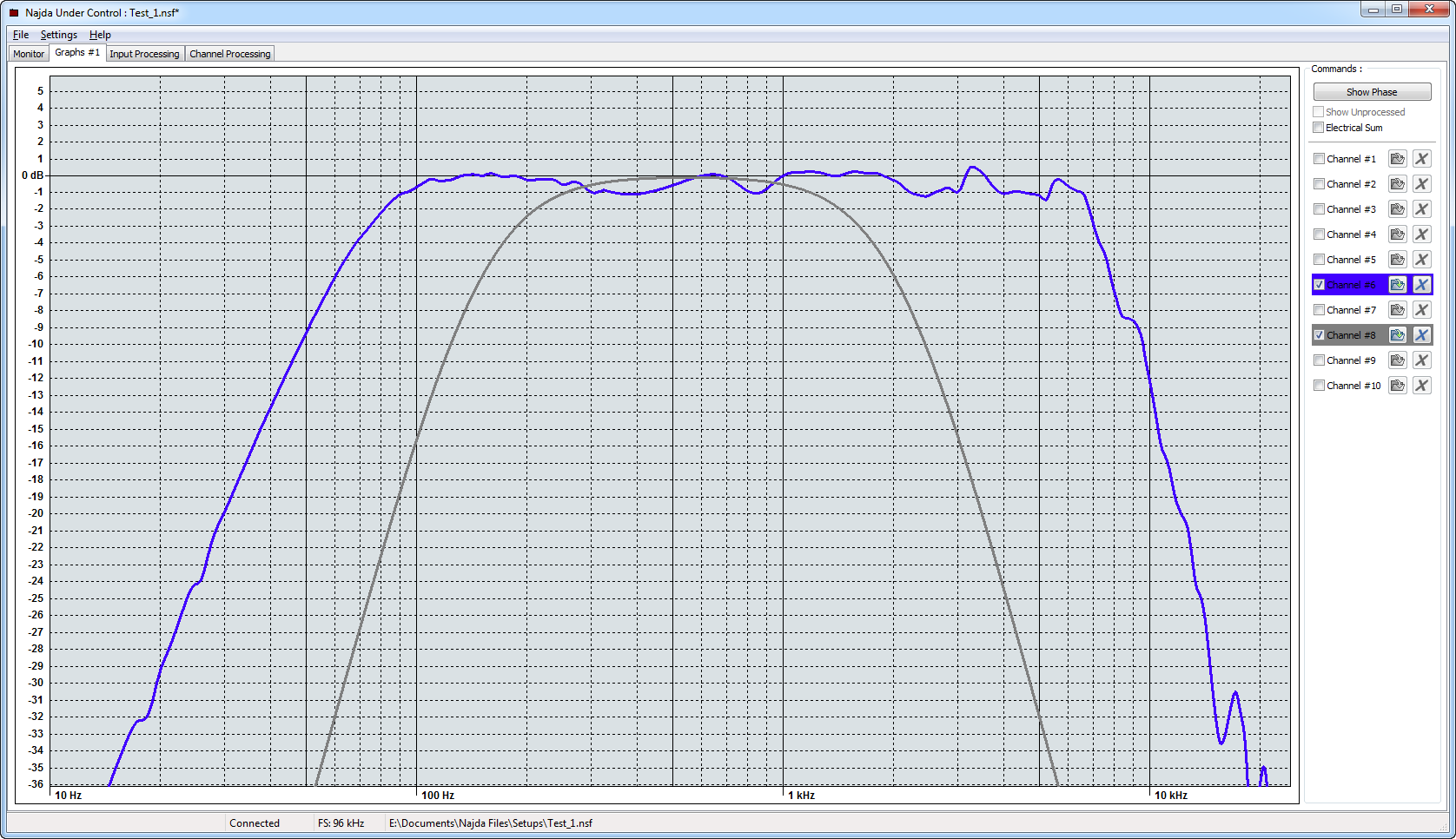

A quick illustration of possible use:
on first picture, I have loaded the frequency response of a small mid woofer (Scanspeak 18W4531-G0 obtained by a combination of a near field measurement up to 250 Hz and a free field above on axis. No smoothing at all. You can see how well ScanSpeak was able to control the break up modes ! I love and use this driver by the way!
Chanel 8 is just here to illustrate the target (LR24 150Hz-2kHz).
The next picture is the same response corrected by only a Highself. not bad already !
xx_4a & 4b show you the same driver with the LR24 filters enabled and a couple of EQ added. Please note the vertical resolution (1 dB/step).
The result is quite good but we can see a deviation from theoretical below 100 Hz (only one half of an octave below the cut off freq).

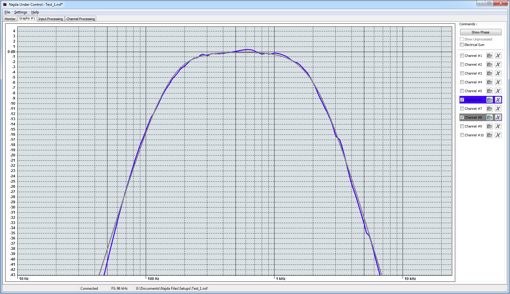

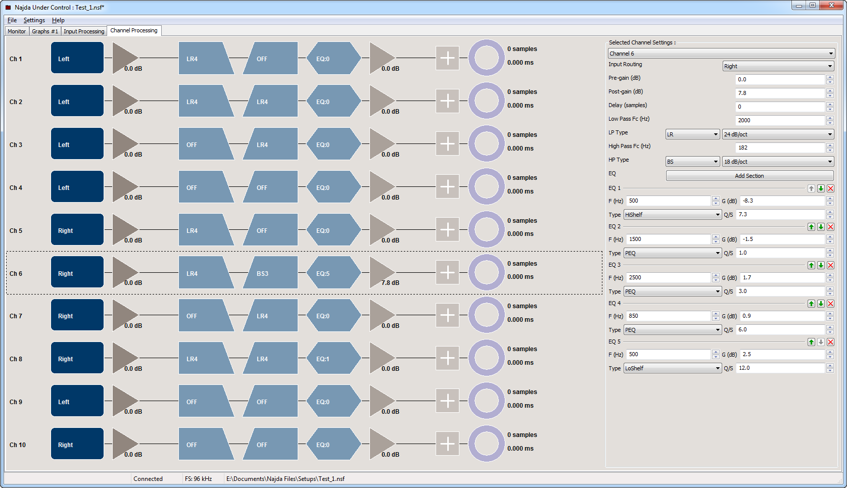

xx_5a & 5b are just to show you that, sometimes, it's better to use different type and order for the filter to meet the target. We are now close to the target down to 60 Hz with the use of a Bessel third instead of the LR24 and all that with only 5 EQ beside the filter by themselves.
So what, at 300€ it looks to me a real bargain, thanks Nicolas. Of course there is a lot of room for improvement but with a firmware labeled at rev 0.3 and a software at rev 0.01 ? congratulation, you have already a winner

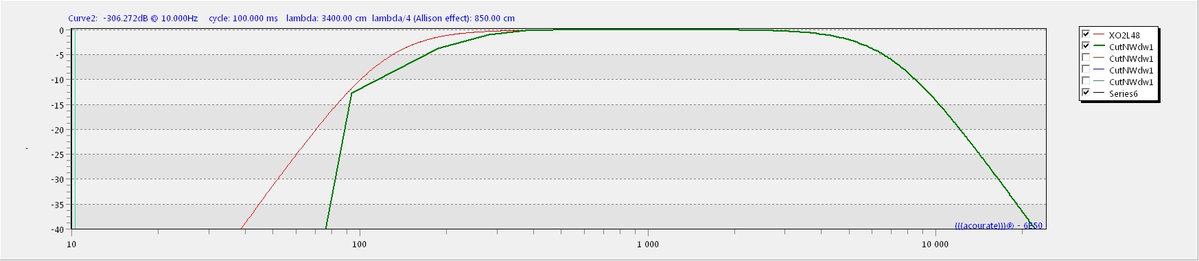

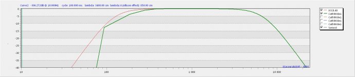

I tried loading a FIR filter that I made in "Acourate". I had to generate a 512 tap filter (1024 is one tap too much) and save it as TDS *.dat file and it loads fine, but the low freq resolution is not good enough at 512 taps:
see attachment...65535vs512 taps
How many taps is possible for each channel?
I see that HOLM HOLM Acoustics is using something they call "16x decimation" that equals 16368 taps @ 44khz.
Anyway, this seems very promising for the first release. Thanks a lot Nick, you have done a great job!
