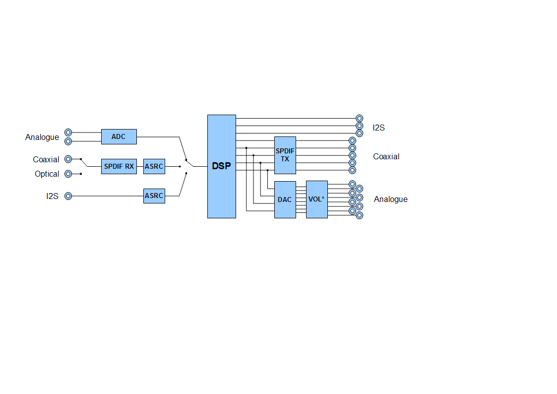

Attached: Electrical signal path (different topic)
