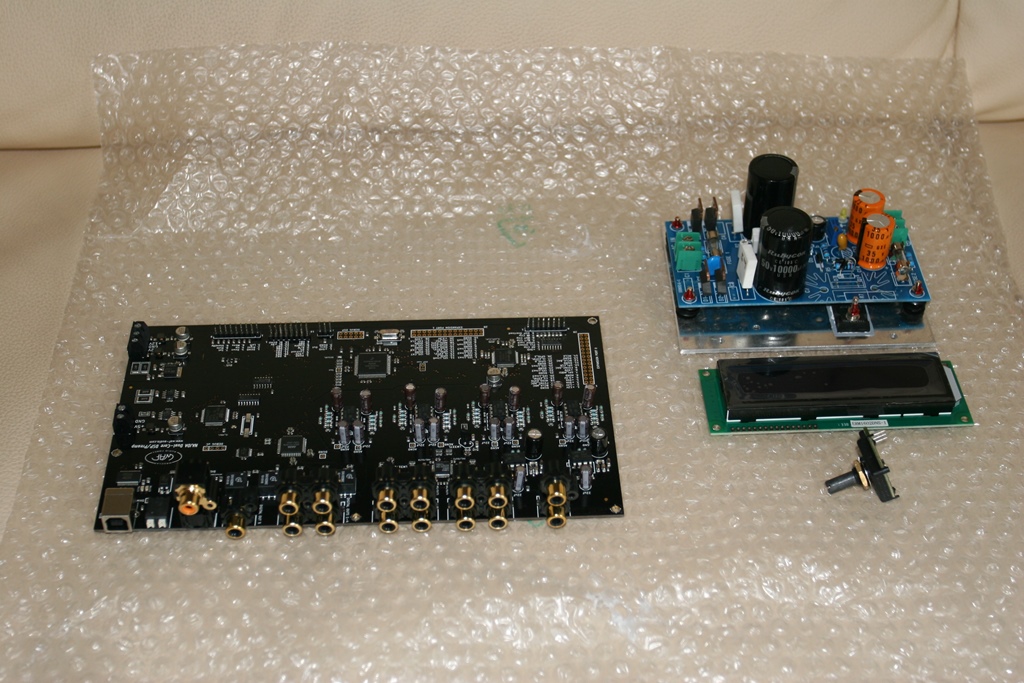

Hello! I just have got from the post office my Najda PCB and few other parts for this project in the same time.
Nick, thank you very much! This is a masterpiece! Now I waiting for the enclosure from Japan and some other missing parts to start assembly.

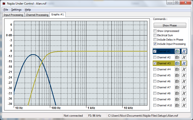

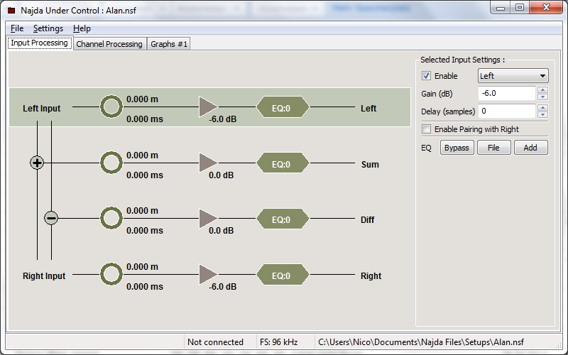

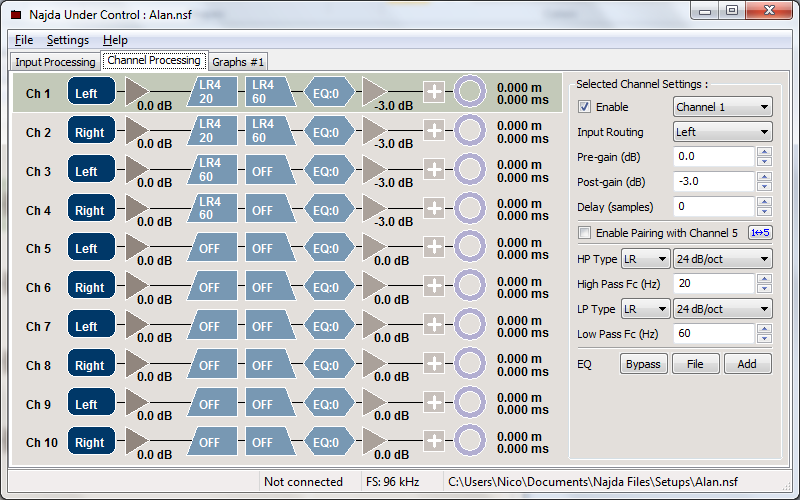

Hi Alan,
I got your setup file.
So you've set a global headroom of 6 dB in the input processing section.
In the channel processing section, you're using only 4 channels and have defined a 2-way LR4. You're also attenuating all outputs by 3dB after the processing (i.e. in the post-gain section).
It's not clear to me why you're having post-gains. If your intent is to add more headroom and prevent clipping, then you should move these gains to the pre-gain stage. Indeed, post-gain is applied to the signal after the filtering. So if it's clipping, the post-gains will not help as they're coming behind.
Anyway, you end with a global processing that's rather simple and looks like this:
Why this is clipping, I don't really know.
The first thing you should do, that's monitor the vu-meters in NUC. The top segment (labelled OVF) will light on when the corresponding channel is clipping.
The 'Output Clip' led is the ORed combination of all OVF segments, i.e. the led is lighting on when any of the OVF segments is on. It tells you that output is clipping somewhere, but the OVF segment tells you precisely for which output this is happening.
For these clipping channels that you've identified, you should add a bit more headroom. Do that in the pre-gain section.
Still I'm surprised: this configuration should not clip.

Nick,
I have now changed my setup completely:-
Inputs down by 3db.
Ch1/2 LR4 at 20 and 55 hz - runs the tapped horn
Ch3/4 no crossover at all.
No gain changes at all.
Analogue Outs set to global 3.0Vrms.
This has very little processing of the signal and for the full range Lowthers the signal should pass through with little or no change.
This setup does not seem to clip, the bass is a little high but that I will reduce slightly.
So I will leave it at that for the time being and build some bigger tapped horns.

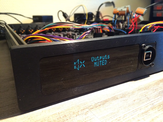

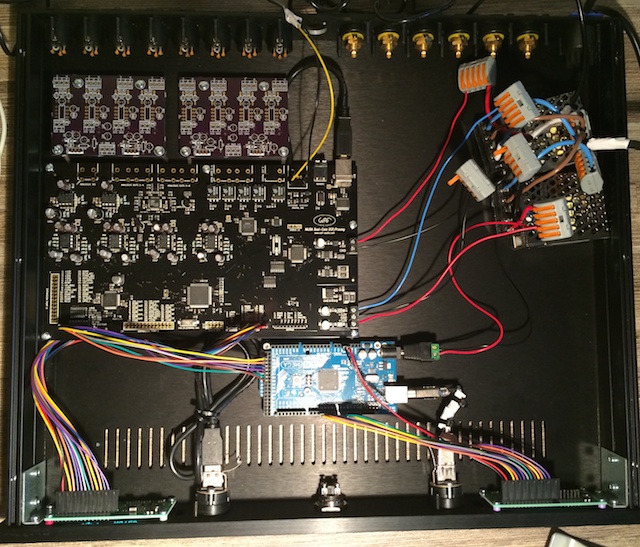

Anyway, here are a few photos of the build so far. I have yet to populate the S/E to BAL boards (detailed here), install power supplies properly, integrate the mux for multiple SPDIF inputs etc. Moving very slowly, as I have a working nanoDigi setup right now, and I want to get everything right.
The display on the right shows the led status pins - it works fine with polling, but I agree with you that interrupts are more proper. Using multiple pins with interrupts on the Arduino requires a bit more effort on the coding side, so I´ll see if it´s necessary to do so. However, I don´t think it will be a problem that the LEDs won´t show exactly the Arduino is processing something else, as the Arduino won´t process anything that takes more than a a split second anyway - but we´ll see.
