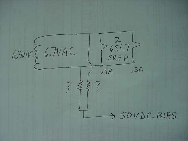

Would like to drop AC filament voltage for a pair of SRPP 6SL7's driving my Fi-Primer Loftin-White. It runs about 6.75V + or - depending on line voltage. A series resistor of about .5ohm would probably do it (.6A X .5ohm = .3V drop) but thinking about another way, which would be a pair of resistors across the line forming a "CT or hum balance of sorts" as in the drawing. How do I calculate the resistors value for .3V drop?
Using formula for hum balance pot: example: 6.3V X 6.3V / 20ohm pot (or 2-10 ohm resistors) = .315A = ? V Drop.

Adding resistors as you propose in your diagram will not lower the filament voltage for you. However, if you made them low enough to load down the transformer, then it would. But it would do so at the expense of needlessly straining the transformer.
You first thought of adding a series dropping resistor is the correct way of doing it. Using two, one in each leg, is nice but unnecessary.
Making a voltage divider between legs to add a DC level is still possibile after the series resistor. But I'd use higher values like 100 ohms or more so as not to load the transformer. You're only adding potential and not dropping anything.
