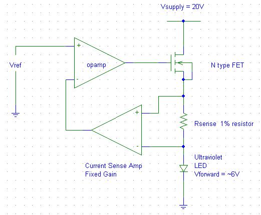

We are trying to drive ultraviolet LEDs with a voltage-to-current converter (see schematic). We want a constant current of about 15mA through the LED. The transconductance gain (current out for a given voltage in) of the attached circuit schematic is set by adjusting the gain of the current sense amp (the current sense amp has an external pot for gain setting that I didn't draw in). The input voltage is from a voltage reference. The output current is the current measured through the LED using a current meter in series with the LED.
This circuit IS functional. When we install one LED, we adjust the current sense amplifier gain so that 15mA flows through the LED. After making this adjustment, when we try another UV LED in the same circuit, the output current is different. We have measured currents from as low as 12mA to as high as 18mA without making any changes or adjustments to the circuit.
Why is this? I know that LEDs are nonlinear resistive elements, but if we are using voltage-to-current converter, shouldn't the same current flow through any LED that we try (assuming we have enough voltage headroom, which we do)?

Why put things in this order anyway? Wouldn't it be better to have the LED connected to the supply voltage, then the MOSFET, then the sense resistor referenced to ground?
--> Between the cathode of the LED and ground, there is actually an N-FET switch that I didn't draw in the schematic (to keep the schematic simple). This N-FET switch is very low resistance (about 20 milliohms, according to the datasheet), but it is low-side referenced, meaning the LED itself can't be ground referenced because this Nfet switch is "in the way".
(I know, it sounds like a complicated way of doing things, but it was the circuit we were given, and we have to work with it at the moment)

Are you not allowed to rearrange anything? You could at least do what Geek said and swap the resistor and diode, then the common-mode voltage will be reduced and be independent of the number of diodes. If you are feeling clever, you could even choose a FET for the switch with an on-resistance a bit higher and use it as a sense resistor instead of an actual resistor.

Correct, because we have to demo the circuit next week. For future versions, we do intend on changing this circuit (this circuit has some obvious flaws), but we can't change anything now due to time constraints.
The V-to-I gain of this circuit is given by this equation:
G = finite gain of current sense amp (adjustable by external gain pot, not shown)
I out = (Vin/G) / Rsense
OR
Iout = Vin / (G * Rsense) [simplifying above equation]
The current sense amp measures the voltage across the sense resistor to get the current through the sense resistor, which is the same current through the LED. In an ideal circuit, this current is independent of the load, but in practice, our output current IS showing some dependency on the load.
