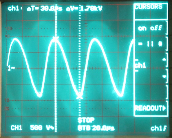

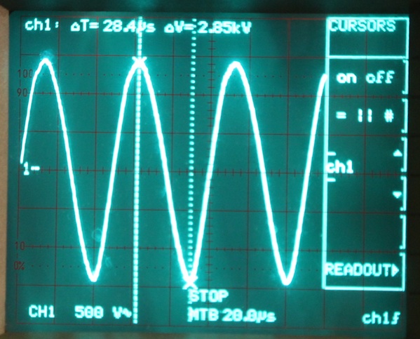

I experimented with SRPP stage with GU48 & 250TH in lower part and GMI11 & GU81on the top. Cascade supply 4200V-50mA. SRPP with two GU48 didn’t give me enough gain. Best that I’ve got was with 250TH & GMI11. GMI11 isn’t the best choice of course also, Idea required some indirect heated pentode, but I just had these. There are oscillograms with 180 & 1680pF of load on 20kHz. Not too bad for first experiment.

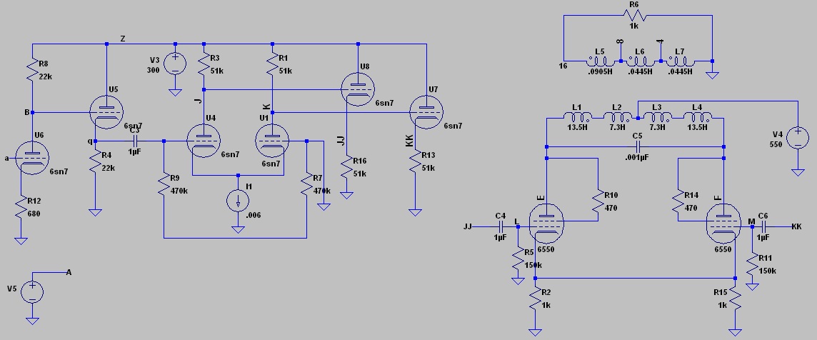

ESL Direct drive
I have owned a pair of Acoustat speakers for over 7 years . I've tried many different amplifiers throughout the years to drive them to bring out the best sound. Tube amplifiers deliver the best sound so far. I built a pp amp using 6550 output tubes and 6sn7 as the drivers. Using a long tail pair phase splitter with a 6SL7 triode. B+ is at 500 volts in UL mode. Using Hammond 1650R transformers. I have eliminated the step up transformers in the MK121 module and connected the stators directly to the plates of the 6550's. I reversed the diodes in the bias power supply so that the B+ from the amplifier adds to the bias voltage. The sound level is more than adequate for above normal listening levels. The measured bias voltage is at 5700 volts with the amplifier voltage added. West Marine has high voltage wire available rated at 15000 volts. This was the best modification I have done for these speakers.

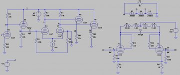

Thanks for the Amp Schematic
Joined 2005
Bzal - very interesting - I have been thinking of doing this myself - the stator taps on your schematic - where exactly? Are they at 8 and 4? What is 16?
The 13 and 7 H inductors - have any additional info or anything special about them? Where is the Hammond tranny?
The plates ride on top of the 5kv bias?
Whole shabang looks like an amp I was already planning on building (without second 6SN7)
Sorry for all the dumb questions...just curious...
The stators are connected directly to the plates of the 6550's. I also connected a common connection from the amplifier to the ESL housing. The inductors are a representation of a Hammond transformer 1650R. I reversed the diodes on the bias supply to generate a negative bias. The voltage on the plates now adds to the bias increasing efficiency. The cathode followers used in the phase splitter help increase the high frequency response to the grids of the 6550 tubes. This was verified on an oscilloscope.

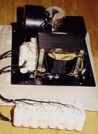

Some of the guys with SoundLabs came up with a tranfourmer setup i am using now on my Acoustat ....lot more output.... can drive the panels with 60 wattt of tube power ..........No res on the secdary side of the bass tanfourmers .....just 1.5mf 6k caps on the hi-tranfourm sed side...
Best sound an most output i have ever got out of the Acoustats...

John..........thay "mix" together like the Acoustats? Thay have only caps in something thay call a mixer box.....the think the caps are 1.5mf 10kV An this is my setup now in my Acoustats No REs....Just caps...Best sound ever.......well for ME
SL Panels are Just one Big Load of mass to drive!
In the pic see the black Box on the right front.
