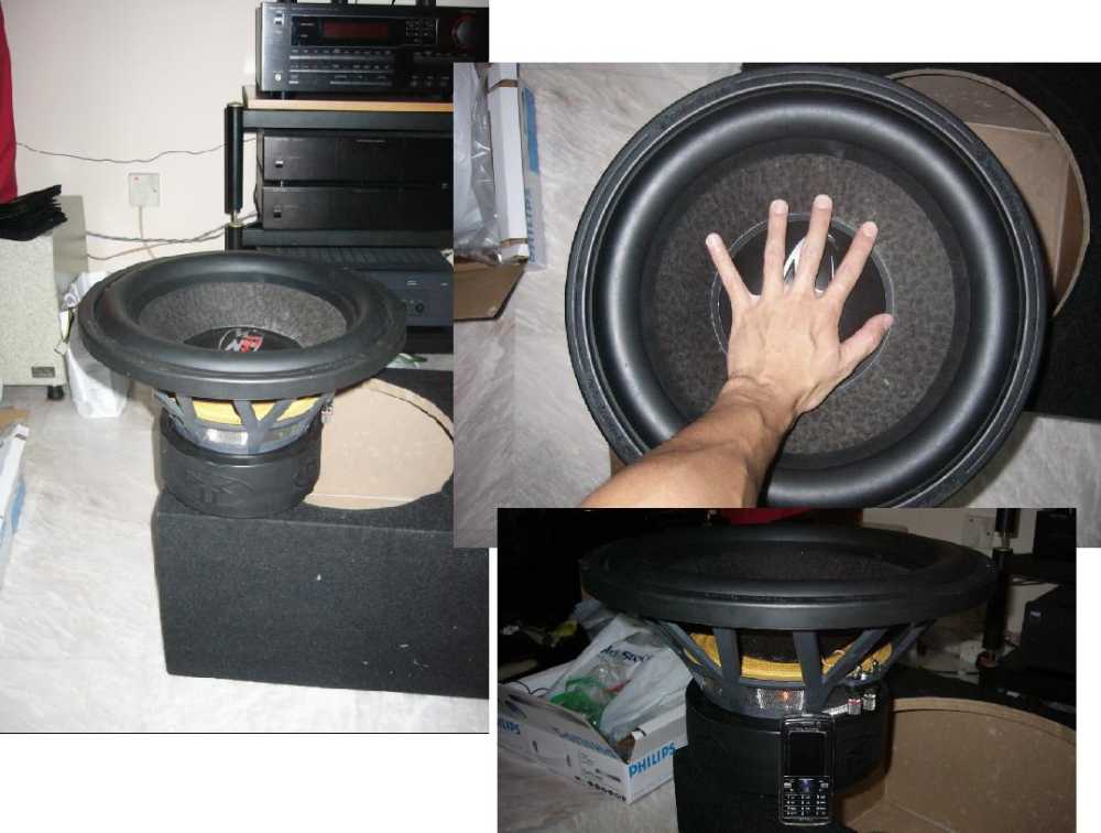

Hi everyone,
I got the sub from a friend and thought i could drive it with the NAD, which has quite a respectable output (150 wpc, 400 wpc bridged into 8 ohm).
My first attempt with the 2ohm DVC in series to give a 4 ohm load and the NAD bridged did not give much output and power delivery, had to crank up the sub level on the receiver to get it level with the mains. The other possible conection would be to connect each channel of the NAD to a 2ohm voice coil separately. I did an estimate of the power delivery (with a limited understanding). Would option 1 or 2 be better ?

Sorry for double posting...some additional info on the sub.
It is currently in a 1.25 cuft sealed box per suggested design by Rockford. From my tests, it is not really fantastic, could be due to the connection issue to the amplifier.
Belief this sub is basically a car audio SPL monster, it weights like 20 pounds and can handle 1000 watt continuous, 2000 w peak. I bought it thinking i could make it into the ULTIMATE transmission line sub, with a 15 inch driver and 19mm of linear excursion.
So that's the story, hope i could get some insights on the connection issue, and hopefully get some help on designing a transmission line for this monster of a sub. Spec attached.

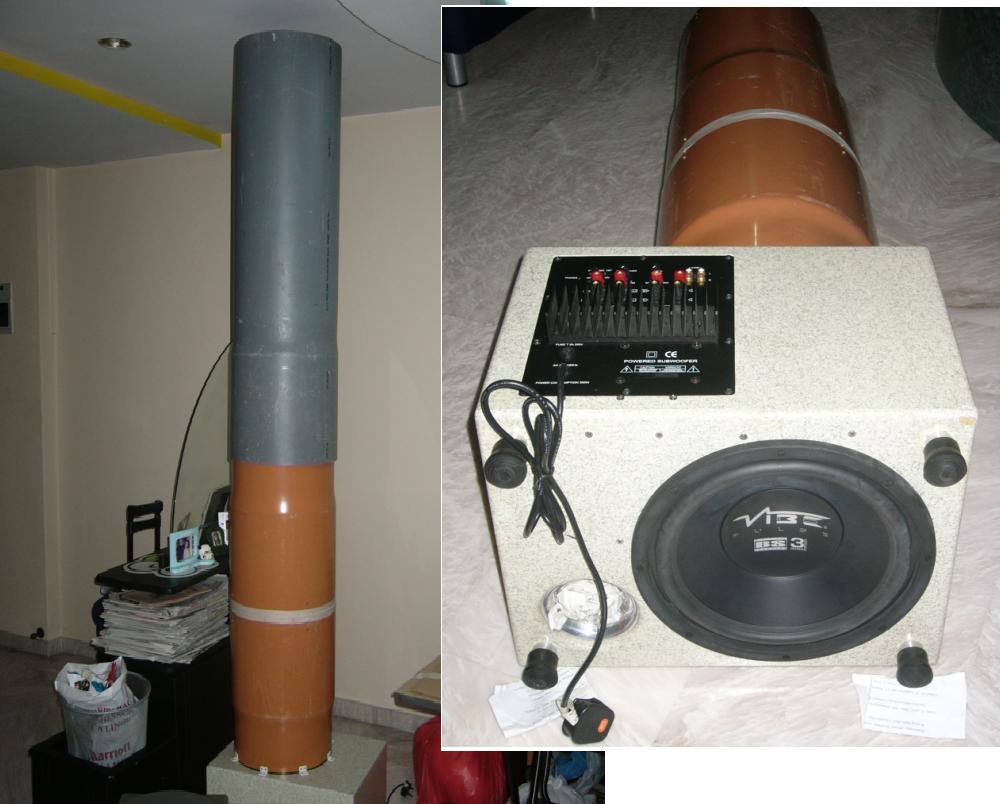

I'm currently using a 12 in sub, Vibe alpha 2.
http://www.homecinemachoice.com/cgi-bin/displayreview.php?reviewid=5229
I modified it into a transmission line by attaching a 12 in diameter 76 inch long PVC pipe ( cut a hole in the top of the enclosure hehe). The driver is downward firing and is aligned with the pupe.The height is no rocket science, limited by the height of my ceiling, but i reckon its about 40 Hz tune including the height of the box.
It sounds great, no boomy and congested sound. and i can't wait to hear how the rockford sounds in a proper TL.

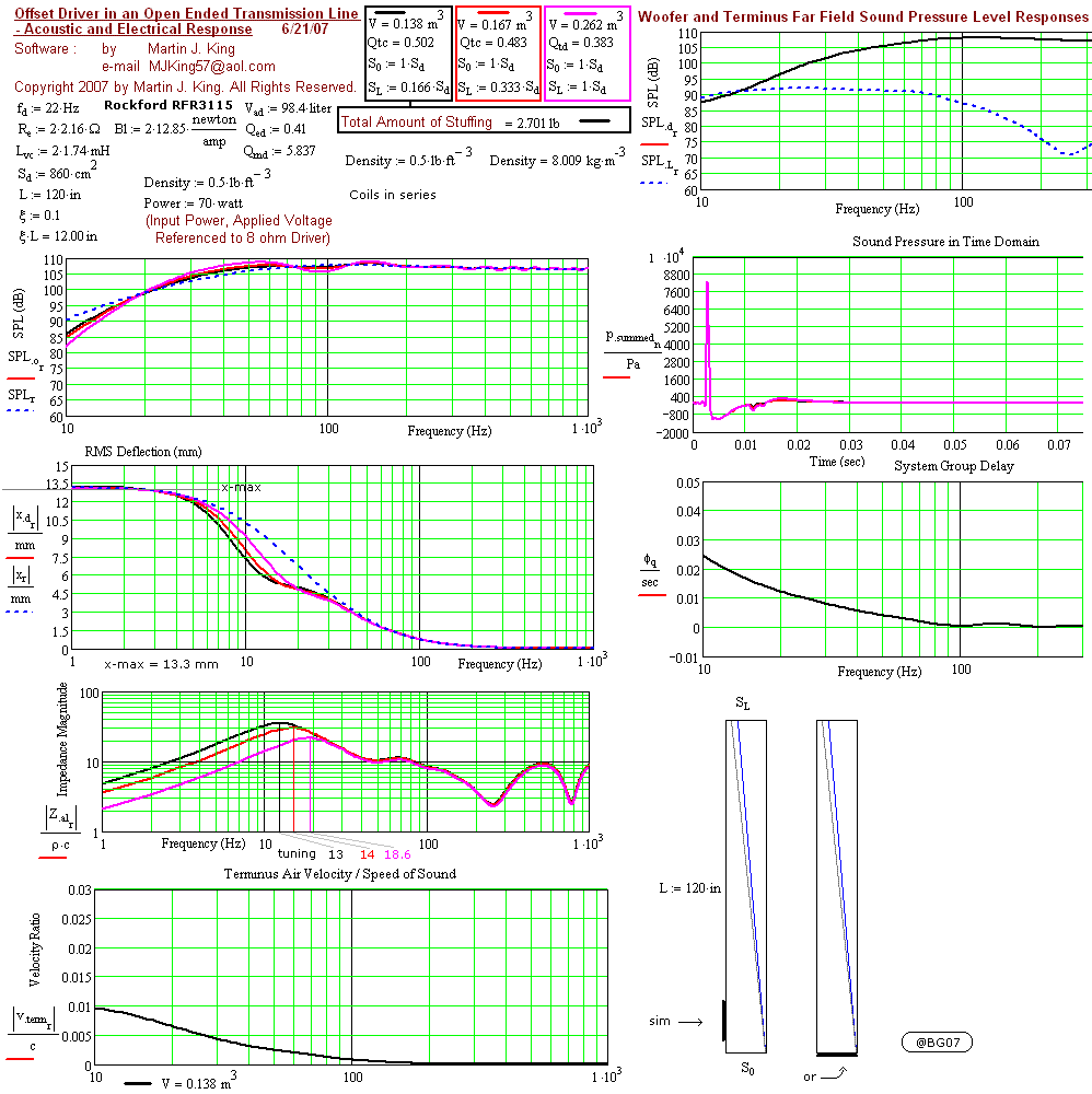

Wow!!, thats awesome. At work now and i can't wait to get back home to look through the sheet properly!! Thanks a lot bjorno!!
Does it make a difference to the simulated response if the 2 voice coils are each driven separately instead of connected in series?
I also noticed the Xmax was 13 mm, should be 19 mm? Guess it only affects the max output.
Regarding the impedance curve, with the voice coils in series to give 4 Ohms, impedance from the chart for the 6:1 taper ranges from 10 to 35. Is that Ohms seen by the amp, or it is acoustic impedance of the system? Can i drive it in parallel for a 1 ohm load? Might fry my NAD lol.

Here's a picture of the sub for scale. Its huge!!
Bjorno, i have a couple of question if you don't mind. Looking at the acoustic impedance chart in your calculation, i'm assuming the max impedance corresponds to the tuning frequency. That means the 120" 6:1 taper TML is actually a 13Hz tuning? Per my calculations, 120 " should give about 28 Hz with no taper, and close to maybe 20 Hz with the 6:1 taper?
Is there any benefit of increasing the line length to 12 or 14 feet or even more? I'm contemplating making it into a side table of some sort, so a single fold, side firing config would give a length of about 6-8 feet. I could even place it in front as a TV table, between the main speakers. Has anyone tried that before? using the subwoofer as a TV table between the mains?

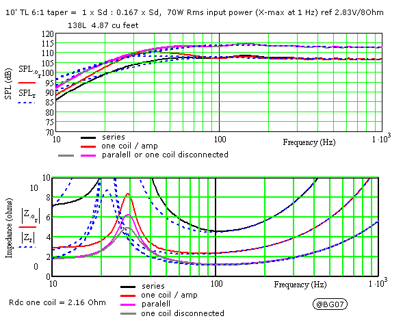

Answers to posting # 5:
…Does it make a difference to the simulated response if the 2 voice coils are each driven separately instead of connected in series?…
Yes it does, look at picture 1(2)
…I also noticed the Xmax was 13 mm, should be 19 mm?
Guess it only affects the max output…
X-max peak is 19 mm but x-max RMS based on 0.74” = 2.54 x 0.74 = 18.8796 mm peak = 13.29 mm Rms = rounded off = 13.3 mm Rms.
…Regarding the impedance curve, with the voice coils in series to give 4 Ohms, impedance from the chart for the 6:1 taper ranges from 10 to 35. Is that Ohms seen by the amp, or it is acoustic impedance of the system?…
Yes it’s the amplifier complex load seen, that is what’s really counts, forget nominal advertised loads like 4,8, 2, 1 and so on, focus on your XO: ed maximum/minimum load and compare with the amplifier capability to drive that load.
…Can i drive it in parallel for a 1 ohm load? Might fry my NAD lol…
I don’t recommend you to load your amplifier with less than 4 ohms, i.e. use the coils in series and if you choose to crossover at 50 Hz – 60 Hz max, then you can safely use the bridged mode of your amplifier.
…Anyway, the frequency response looks pretty strong down to 20 Hz, in other words awesome!!…

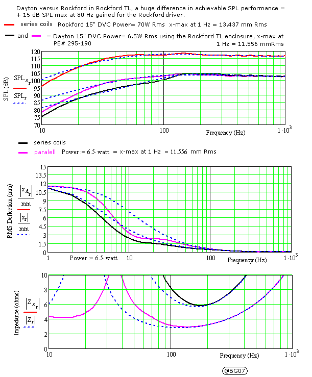

…How does it compare with, say the Dayton 15 " sub from Parts Express in a similar optimised TML ?…
First I don’t use the aberration TML for a traditional TL but only for quarter-wave based speakers using (a) separate port(s) where the tuneable port air mass can be separately defined as for a ML-TL mass loaded transmission line.
This is what I can show you, draw your own conclusions: picture 2(2)

posting #6:
…That means the 120" 6:1 taper TML is actually a 13Hz tuning?…
Yes.
…Is there any benefit of increasing the line length to 12 or 14 feet or even more?…
No, if you do you will loose the possibility to damp the TL properly; the speaker turns in to an empty ripple rich quarter-wave pipe.
b
1(2)
Bjorno,
I noticed the hump in frequency response between 30-50Hz for 1 coil/amp connection; is there any way of smoothing it out since i'm planning to drive the sub this way?
I know you recommend using the 2 coils in series to give a 4 ohms load, however this brings me back to my first question regarding power delivery. I don have satisfactory results with a 4 ohm load in the 1.2 cuft sealed box that came with the box. Any idea what could be the problem? I thought 88 db/watt sensitivity is pretty normal, and the 2600A is no slouch. Was very puzzled at the lack of power into the 4 ohm load. Car audio forums talk about needing at least 1000W to 'wake up' this driver.
The electrical impedance curves peak at 29 Hz, instead of the 13 Hz peak for the acoustic impedance. Is the tuning 29Hz or 13 Hz?
Also, the electrical impedance peaks are quite 'sharp', i have read that well designed transmission lines are characterised by very mild impedance peaks due to the nature of the design.
Regarding the 13.3 mm Xmax at 1Hz limiting input power to 70 W rms, does it make a difference if a rumble filter is implemented at about 12Hz? Does it give the sub even more headroom for higher SPL from 18-80 Hz?
Now that there's quite a bit of details in the design, i hope to hear any other comments from the community. Thanks a lot.
