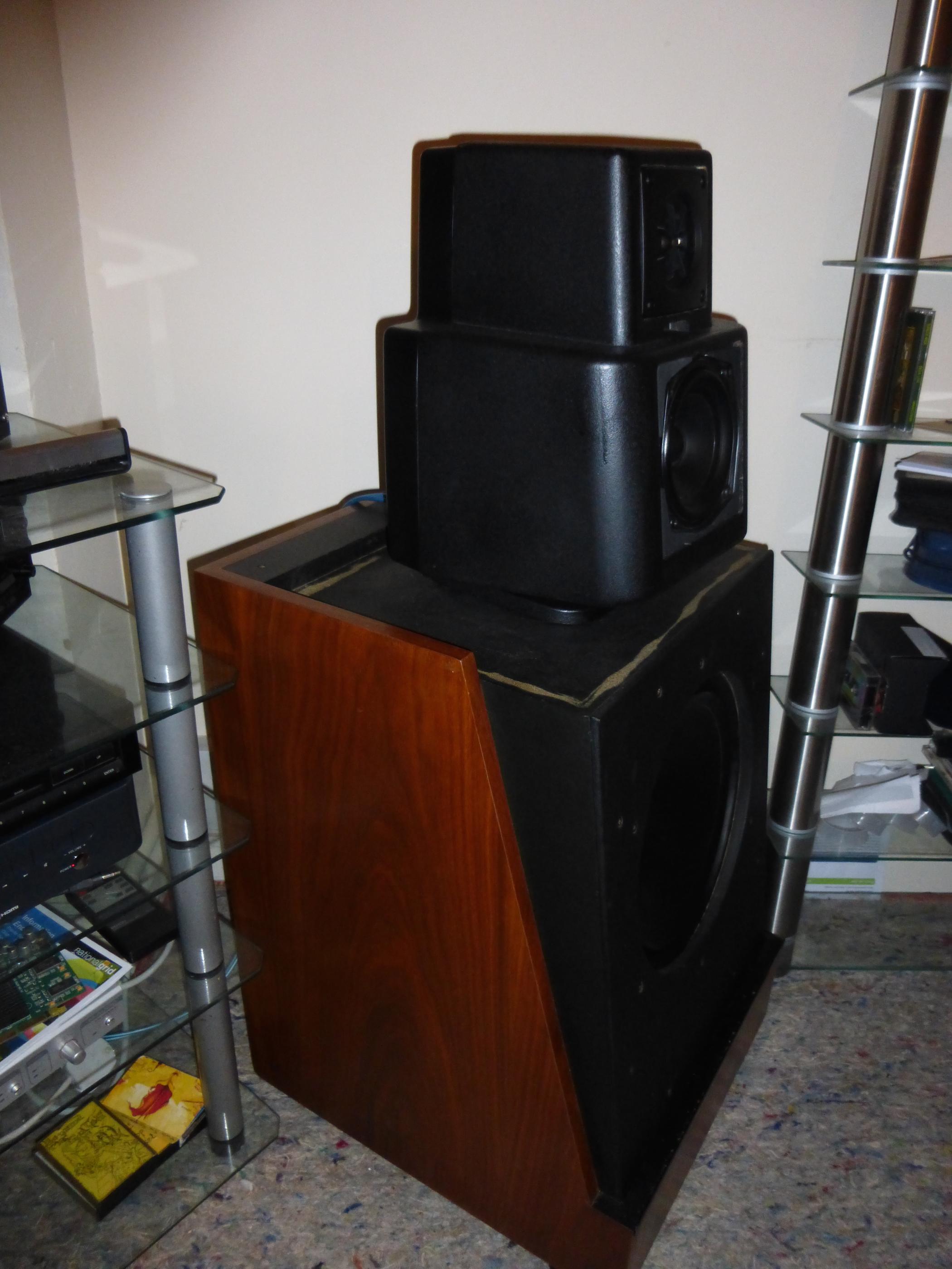

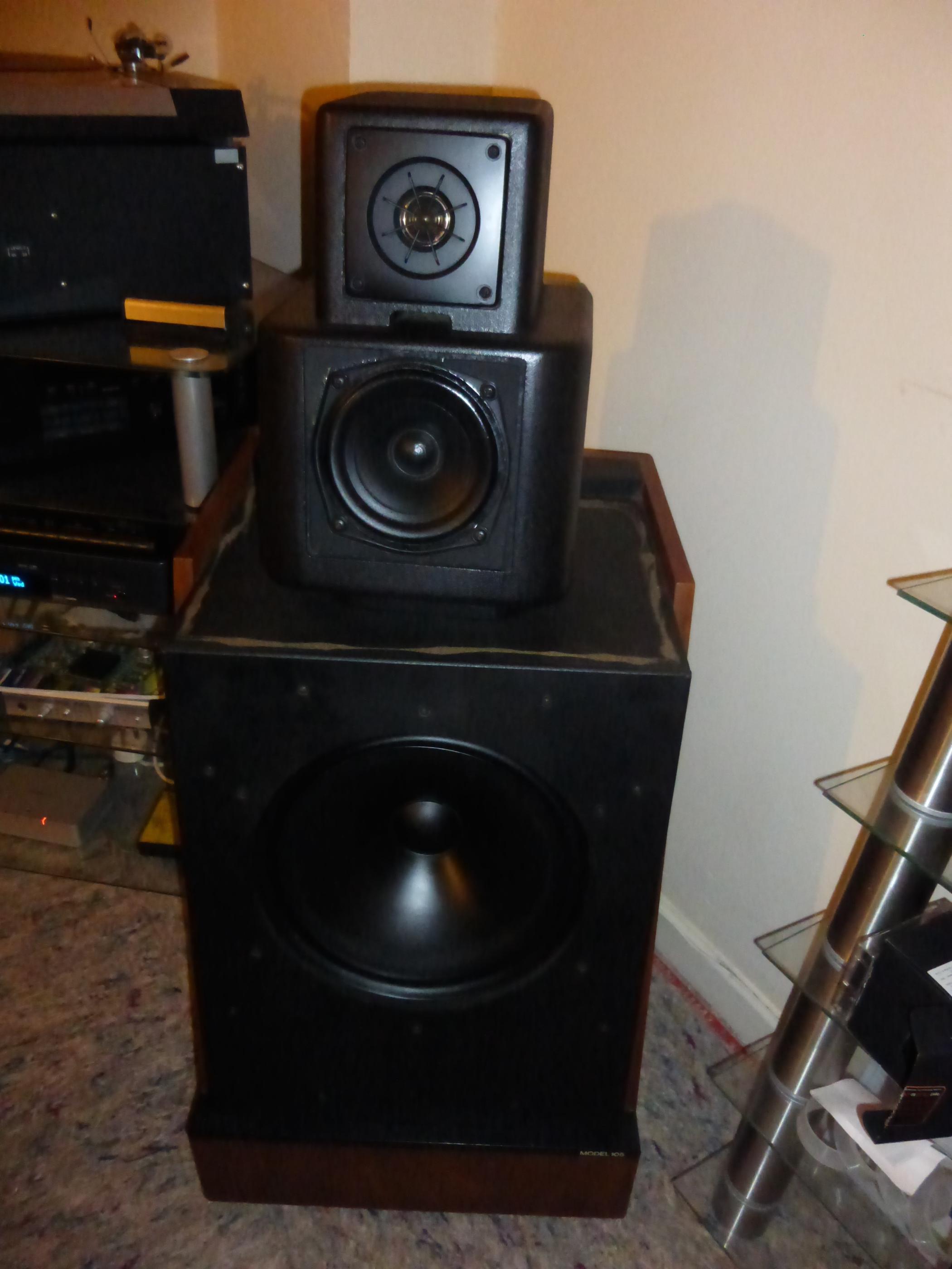

I want to repopulate my KEF Reference 105 speakers: figuring that the cones and crossovers are all operating off spec and so not delivering the quality of sound I'm after. I drive them with a Mastersound Compact 845: so a bit more sensitivity won't hurt either (I'm no moneybags: the secondhand Mastersound cost less than any DIY 845 option or indeed any half decent Chinese 845 amp: and is obviously way better than either: plus I get gravel!).
The KEFs are interesting, 12" woofer in 71 litre closed box with nicely sloping baffle.. 5.25" midrange again in its own dedicated enclosure 3 litres or so.. and the tweeter sitting at the top. Sloping front lines the magnets up nicely and each driver has its own baffle and none of the enclosures are simple square cut boxes. Crossovers at 400 and 2500 Hz. They were top of the range in 1977 and were used in many a high end recording studio at that time.

I'm going to experiment with the various sections' damping/sound deadening materials- they are all overdamped/misdamped at present (much easier to voice as they are all separate): BBC regulation bitumen sheet in the mid box.. and a little foam; this will liberate more airvolume in the box, I'm trying to get to a BBC regulation 2 litres. The bass box again loses loads of volume to thick foam, which is going... I'll start by installing damping in line with an article at 6moons (for a bass bin) and tinker from there ... I can always just return them to standard.. but I want to liberate some crispness and dynamics in the bass, and calm down the mids (another reason for more modern mid range drivers).

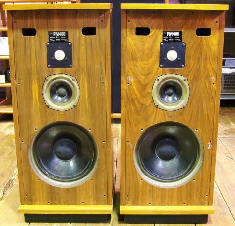

I used to have some 12" bextrene coned 3 ways, the Chartwell PM400 monitor.

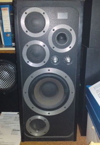

My flatmate had the paper Wharfedale E70 speakers.
They were SO different! My BBC Chartwell's were smooth and a bit dull, the Wharfedale's were incredibly lively and dynamic. :eek:

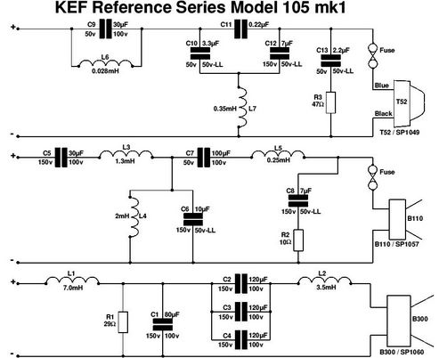

What's hard about THIS? :confused:
For the DIYaudio forum that claims to be the brightest on this planet, frankly I am disappointed. :rolleyes:
But I'd concede that filter is very driver specific.
Say, with a new tweeter, you could simplify it a great deal into a regular third order tweeter filter. KEF got a bit over-elaborate at times back in the early days of computer modelling.
