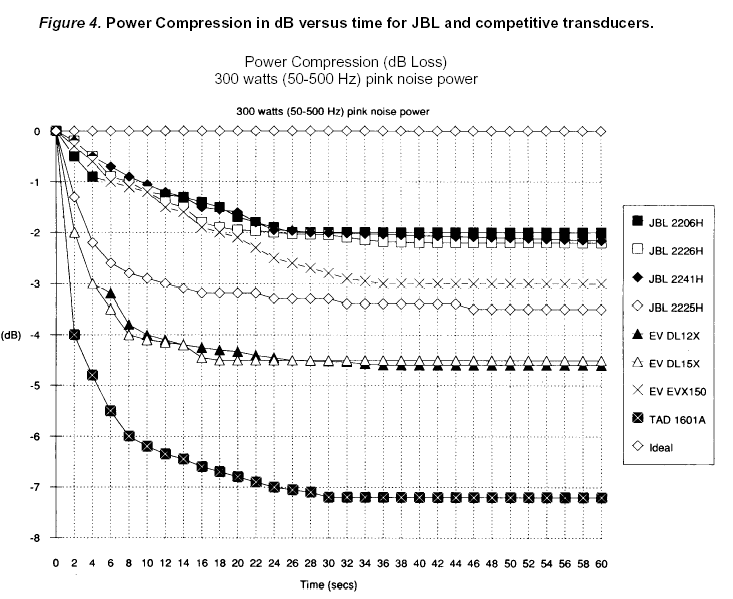

How do you know there is little or no power compression. If a 250w pro driver designed to deal with thermal compression has 2db of compression at 40w and 5 db @ its rated power, surely a hifi driver will have at least the same if not inferior performance. I'd expect the hifi driver would range from 2db at low power levels going up to about 5db at full rated power. The hifi driver will normally have more excursion related compression I'd guess, since it relies more on excursion which is not linear, while a greater portion of the pro driver's compression is related to thermal effects.
I don’t believe that power compression is an issue with your setup. You simply don’t have enough amplifier power to cause power compression in your midrange driver. For example, consider that the JBL 2226H incurs 2dB of power compression when driven by band limited pink noise at 50% of its rating. For the 2226 with a rating of 600W that’s 300W average. Considering the crest factor of pink noise is 11dB, that means the driving amplifier is putting out undistorted peaks of 1kW! Admittedly the 2226 is a very well designed driver with a very high power handling ability.
At these power levels special techniques are needed to dissipate the heat. For a Hi-Fi driver the problem of heat dissipation is much less severe as the power levels are much lower.
For a 50W amplifier the average power level of music will only a few watts. That amount of heat is easily dissipated by any modern driver.
If you’re convinced that power compression is an issue for you, you can measure by how much. Using pink noise, measure the RMS power fed to the driver and the SPL at a low power level, say 1.5WRMS; and then repeat the measurement at 15WRMS ( the maximum for a 50W amplifier to reproduce undistorted peaks in pink noise) and measure the deviation from the expected SPL. I doubt you will see a measurable difference.
