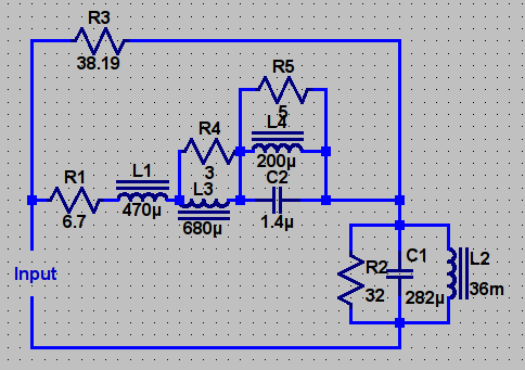

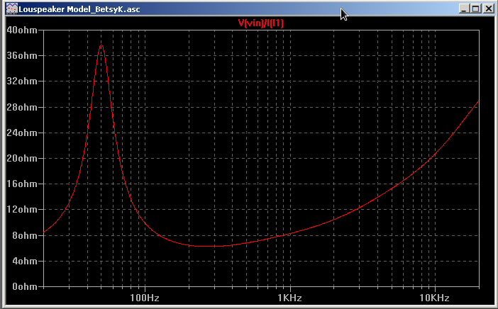

Hey everyone. Here is a SPICE model for the BetsyK, for those who can use it. I used the impedance plot Paul gave me for a reference. It will work in any simulator, just copy the values in.
I don't know how correct the phase is since the reference didn't have this information.

The model shouldn't be regarded as the last word, since speaker impedance depends on nonlinear mechanisms such as air resistance which can't be modeled conclusively with passive components. Still, I think the match is reasonable.
(wait, IS there any use for this? I'm not sure. Gah. Anyways, it's the best speaker model I know of for SPICE in any case, because of the accuracy of the curve from 500Hz onward. I haven't seen a SPICE model do this realistically before.)
