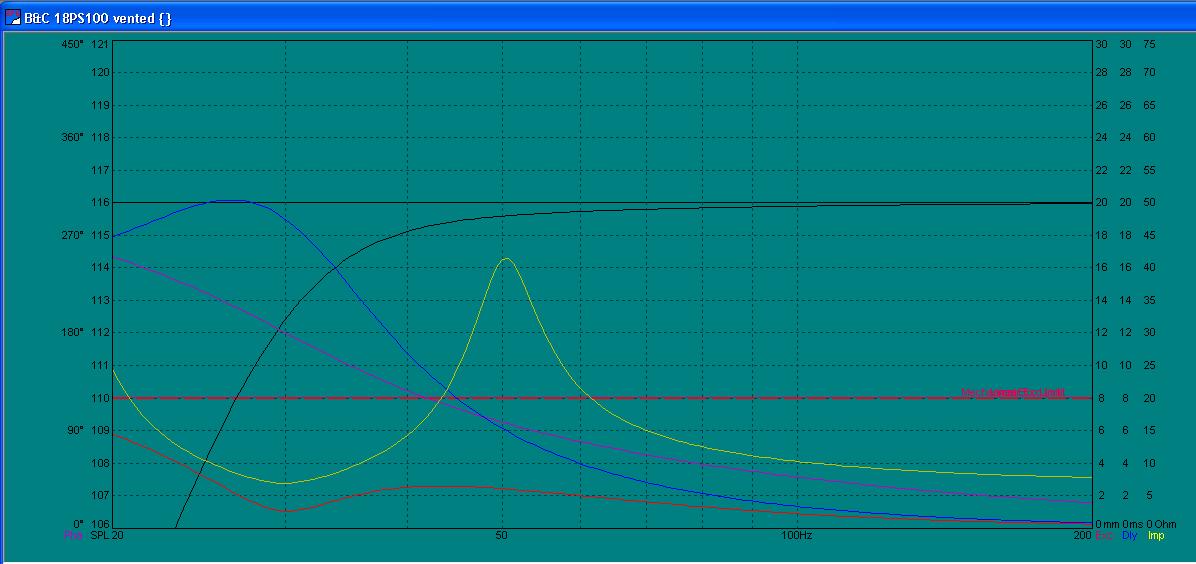

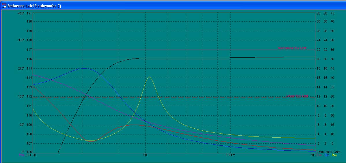

So, it seems to me that the 18PS100 (together with using the same amplifier as the LAB15) is going to produce a lot less distortion than the LAB15.
Not necessarily, it depends on the driver's design/construction, ie. at what point thermal power compression [part of AMD] sets in and where the VC is on its BL curve. Unfortunately, historically, few manufacturers publish this data, so this kind of simmed comparison is pretty much worthless for high power apps without it.
FWIW, the historical rule-of-thumb was to design based on 20-25% of rated power for the BW below its mass corner if its 10% distortion rating wasn't known.

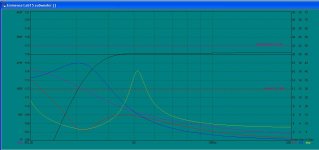

OK, here they are producing 116dB each. The LAB15 requires 600 watts and the 18PS100 requires about 100. The 18PS100 is still barely breathing and the LAB15 is out of breath. This is a simple simulation so maybe the LAB15 requires even more power to achieve 116dB, I don't really know. Anyway, cone excursion is exceeded in the LAB15 at subsonic frequencies, and is over twice that of the 18PS100 at other frequencies. Certainly, I'd think the LAB15 is getting a bit warm now, don't you think? Distortion products must be very high at this point as well, but still fairly low in the 18PS100.
Depends on driver construction. With twice the displacement, a vented pole piece driver may well actually be running cooler because of more airflow.
They both have that, as far as I know.
OK, then what reason have you 'seen' that 'proves' the less efficient driver must heat up quicker?
GM
All other things (ability to remove heat from the motor structure being one) being equal, if you have two drivers of different sensitivity playing the same tone at the same level, the less efficient driver will be receiving more power. As >90% of the power fed into a loudspeaker is dissipated as heat, the lower sensitivity driver will be trying to get rid of more heat than the higher sensitivity driver.
Of course, things are never so simple in the real world - VC ventilation, thermal mass of the coil, magnet, and everything else that sees any heat will all have an effect, so comparing one driver to another won't be so easy.
